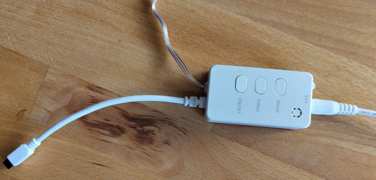

    I am trying to use the BNETA Smart LED Fairy Lights with the OpenBeken firmware.
    This is what it looks like:
    Controller with three buttons for LED lights. Circuit board with three red buttons and several electronic components. Close-up of a circuit board with markings GND, LED, and V+ along with a BK7231TY chip. Interior of a casing with electronics, showing a circuit board with components, wires, and a connector.
    I have managed to flash the firmware!!!

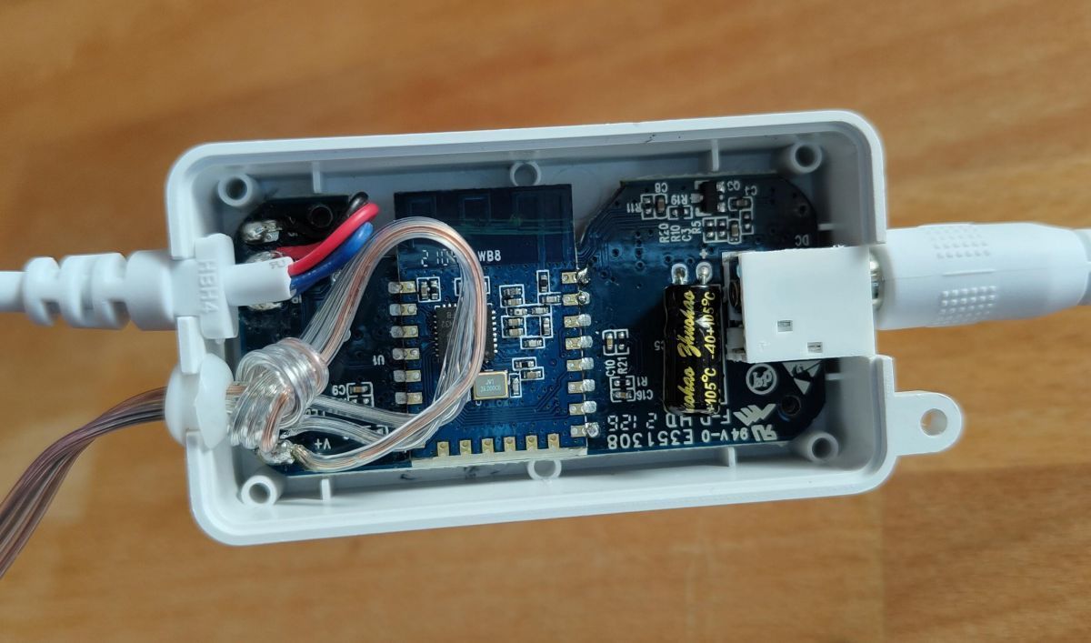

    So far I have established:
    1. BK7231T
    2. LEDs have V+, LED and GND
    3. LED is connected to PWM1 only, it seems
    The Leds are addressable.
    When trying to extract the config for Tuya:
    I doubt that it is using a TuyaMCU but not sure how to confirm this. (See bootlog attached)
    Sorry, no meaningful pins data found. This device may be TuyaMCU or a custom one with no Tuya config data.
    No module information found.
    And the Tuya section starts at UNCOMMON POSITION 0
    So I am unclear on how to proceed with this.... Any assistance will be appreciated.

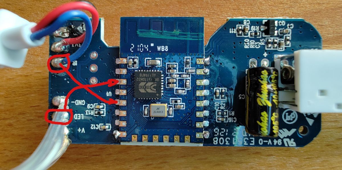

    Hello, have you tried GPIODoctor to just guess which GPIO pins are used?
  • WB8 pin mapping suggests P7 is shared with LED data
    #3 20796611
    FirosD

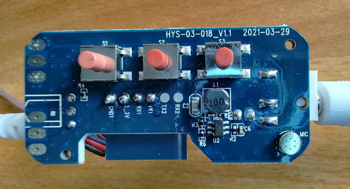

    Yes, I started with the three buttons, slightly confusing.
    I have set an internal pull-up to test
    Music Button -> P7
    Colour Button -> P9
    On/Off -> P24
    IRecv -> P26
    LED Driver -> P16
    The interesting part, it seems P7 is also where the LED Data pin is....
    The board is WB8, I am working under the assumption that this is the same:
    https://developer.tuya.com/en/docs/iot/wb3l-module-datasheet?id=K9duiggw2v8sp
    #4 20796641
    Posts: 14770
    Rate: 12911
    I don't think the LED data pin can be P7. If they are like WS2812B, they need a very precisely clocked data, which on Beken is only possible with P16, through the SPI.
    Futhermore, I am not sure if this device has the same pads as WB3L, you should check some pins where they go, we have a QFN pinout here in that topic:

    I can see that the board is also not the same as initially thought. WB8 drives the LED from P16
