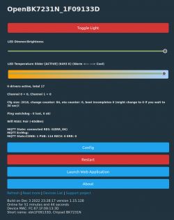

    aargvark
    Posts: 6
    There was indeed such a problem, I fixed it now, can you update to latest build and check?
    I just loaded OpenBK7231N_1.15.136 and it seems to be fixed. Thank you!

    #4 20319880
    Posts: 14792
    Rate: 12937
    Thanks, feel free to request any features you want, also remember that any IoT device teardowns are welcome here. We need to make our database bigger.
    aargvark wrote:
    One item I would like to see adjusted is the dimmer setting. It goes from 0 (off) to 100. For the dimmer, I'd rather see it go from 1 to 100. This way the dimming function does not turn it off. I'd like on/off to be controlled by the power button and not by setting dimming to 0.
    Actually, we already got it, but it seems that the value 2 is too small to be visible in your case.
    [BK7231N] BTF-Lighting FCOB CCT Strip: OpenBeken Setup, Pin Configuration & Physical Buttons
    Hmm can you check and tell me which smallest dimmer value is visible for you?
    Try in console: "led_dimmer 5" etc and check if it's visible
  • #5 20319904
    aargvark
    Posts: 6
    I can go as low as led_dimmer 1 without it shutting off. It will shut off at led_dimmer 0. It seems with the slider it will take it to 0.
    #6 20319908
    Posts: 14792
    Rate: 12937
    @aargvark ah, so your suggestion is to make the slider on our HTTP page start at 1 instead of 0?
    Well... that's a good idea.
  • #7 20319940
    aargvark
    Posts: 6
    Yes, I guess that is my suggestion! :D

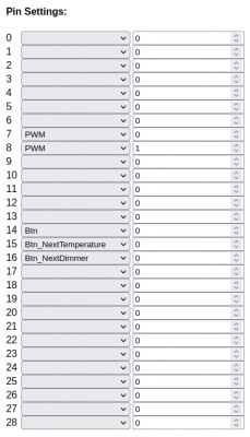

    #9 20325360

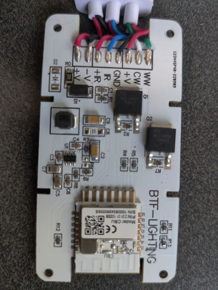

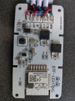

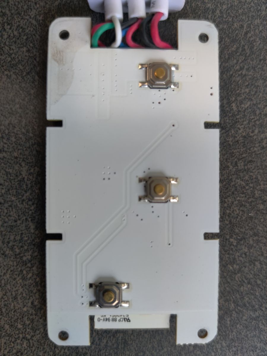

    aargvark
    Posts: 6
    I've had a chance to map out the pins and how they correspond to buttons and IR.
    Top is the button furthest away from the connection wires and Bottom is the closest. The IR and IR have continuity with the corresponding wires coming from the IR receiver at the base. I guess I'm a bit confused how this maps to the pin fields in the web interface:
    This setup makes the Top button the power, Middle the color temperature, and Bottom the dimming.
    Button behavior is a bit difficult because it registers actions for Button_OnLongPressHold, key_short_press, key_double_press, etc. For example, if the middle or bottom button issues a key_double_press command, the lights will turn on but can't be dimmed or have the color change. If it's powered on with a standard press, the other buttons work as they should with Button_OnLongPressHold dimming or changing color.
    At least in my case, ideally I'd have:
    Top button: Power on press (no other functions, no long press, double press, etc). Middle button: Press and hold to change color temperature (does not power the lights on or off). Bottom button: Press and hold to dim/brighten (does not power the lights on or off).
    I guess to be a little more advanced, a double click of the middle or bottom button could take the lights to the highest color temperature or brightness, but my usage is for under cabinet lighting and I'd like it as simple as possible if someone in the family wants to adjust it.
    I'm happy to run any tests or gather more data if it helps. Next I need to figure out the IR but first need to find the correct mapping.
    Thanks!
