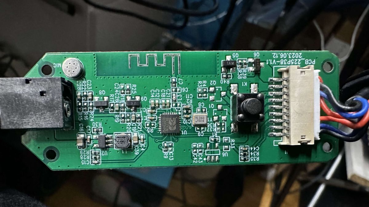

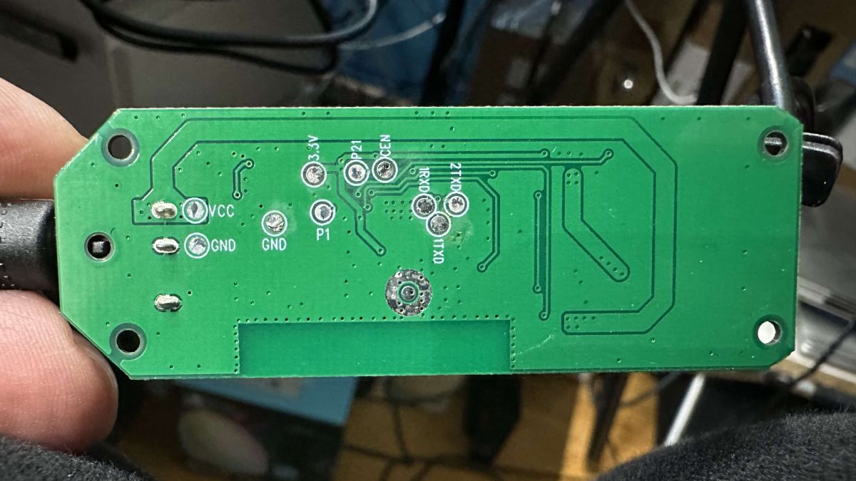

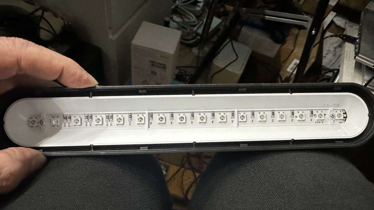

    i bought today this game bar at Action store.
    It fits 16 RGB leds, i didn't find any drivers on the led bar pcb nor on the main circuit .
    I've dump the fw directly as the pins are exposed, and reflashed with latest OBK .
    I'm a bit stuck for now as i can't find any valid config to get this game bar working .
    Here are some pictures and a dump of the original fw .

    - Microphone (TODO) on P23
    - IR Receiver is on P26
    - SPI MISO17
    - Control Pin (TODO) on P6
    Device seems to be using CBU module, which is using BK7231N.

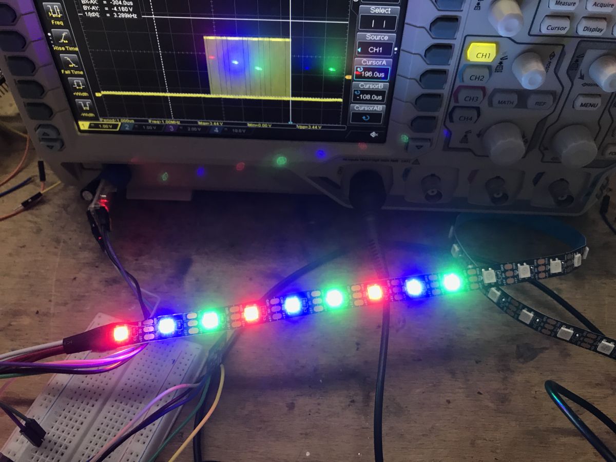

  • #4 20943881
    Posts: 14755
    Rate: 12880
    Then it's not WS2812B, because WS2812B works for me, altough there is still little instability that we need to fix:
    LED strip emitting different colors, connected to an oscilloscope.
    Is the power reaching the strip at all? Maybe you need to enable something more?
    PS: setting SM16703P_DIN role will not change anything, it always uses P16 now, as it's the hardware SPI out pin

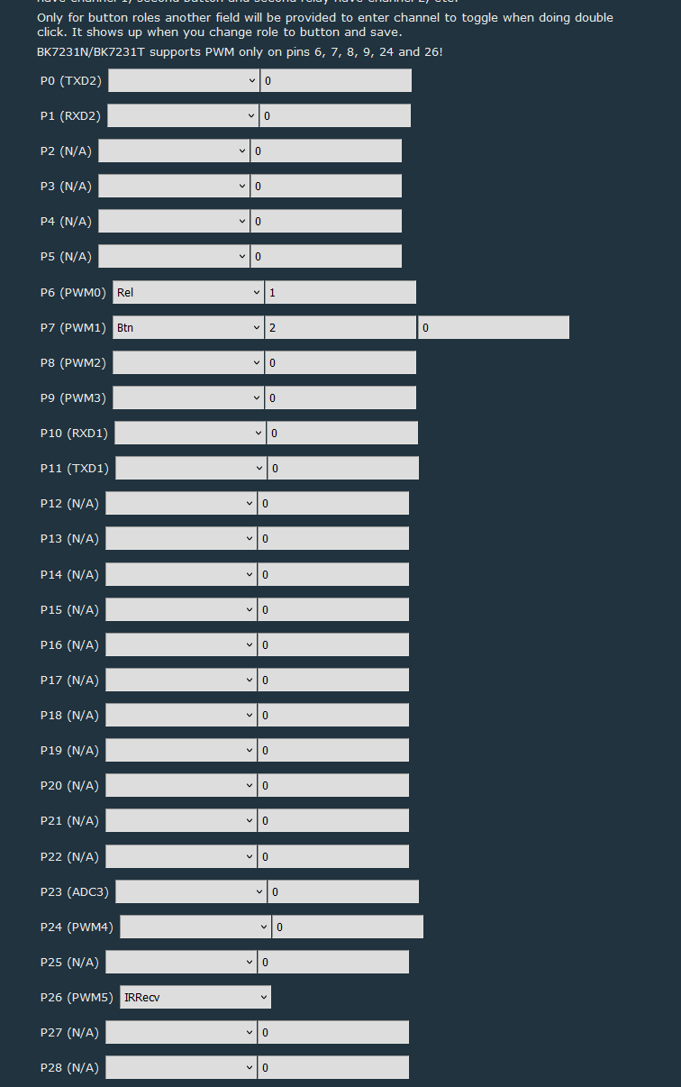

    I will solder the LED bar on a D1 mini and test with WLED to identify the LED type. I will let you know.
    Edit: You're right, I've just checked the voltage on the bar and I have 0V on GND/VCC, so it seems one pin is used to power the LED bar.
    Edit 2: By switching P6 to 1, now I got some answers and LEDs are lighting with SM16703P_Start command.
  • #6 20943936
    Posts: 14755
    Rate: 12880
    Maybe it's P6? Can you try setting P6 to relay?

    Yes , indeed , P6 is ok ton control power on leds bar :
    here is my actual conf :
    Screenshot of BK7231N/BK7231T controller pin configuration.
    and the autoexec.bat with your test script i'm using :

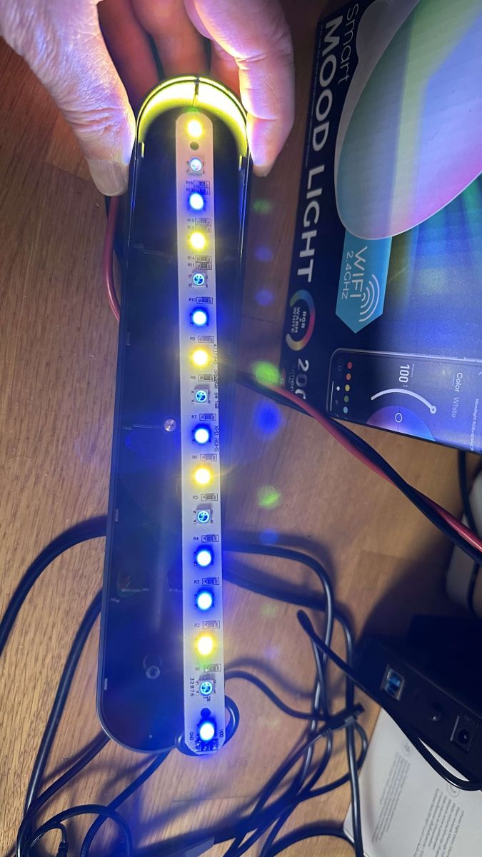

  • #9 20945659
    Posts: 14755
    Rate: 12880
    Are the colors displayed correctly? Do you have a scope?
  • #10 20945681
    snakesrules94
    Posts: 37
    It seems okay for the color:
    LEDs shining in various colors on a simple electronic set held by a hand.
    I have a very basic Chinese scope kit, not sure if it can be helpful but tell me anyway if you want me to monitor something.
    Added after 14 [minutes]:
    If I rerun the script after first start, all the LEDs are on but with false colors this time:
    LEDs on a strip from a Chinese lens kit displaying colorful lights, with a Smart Mood Light box in the background.
  • #11 20947355

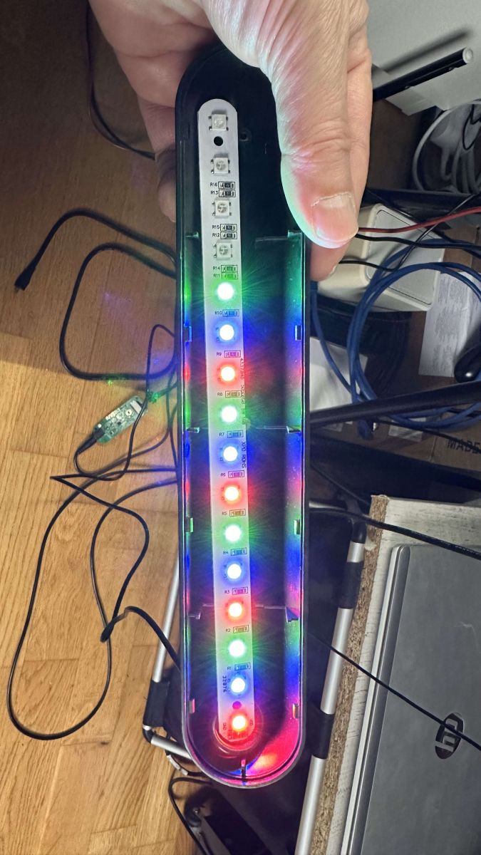

  • SM16703P mapping shows offset and color errors
    #12 20947403
    snakesrules94
    Posts: 37
    Ok, so with this script:
    startDriver SM16703P
    SM16703P_Init 16
    SM16703P_SetPixel 0 0 255 0
    SM16703P_SetPixel 1 0 255 0
    SM16703P_SetPixel 2 0 255 0
    SM16703P_SetPixel 3 0 255 0
    SM16703P_SetPixel 4 0 0 255
    SM16703P_SetPixel 5 255 0 0
    SM16703P_SetPixel 6 0 255 0
    SM16703P_SetPixel 7 0 0 255
    SM16703P_SetPixel 8 255 0 0
    SM16703P_SetPixel 9 0 255 0
    SM16703P_SetPixel 10 0 0 255
    SM16703P_SetPixel 11 255 0 0
    SM16703P_SetPixel 12 0 255 0
    SM16703P_SetPixel 13 0 0 255
    SM16703P_SetPixel 14 255 0 0
    SM16703P_SetPixel 15 0 255 0
    SM16703P_Start
    Just after reboot, the first 4 LEDs are red, the next 8 are in the right color, and the last 4 are off.
    If I rerun the script just after, all the LEDs are ON but with false colors, mainly blue and green.

    OK, while scrapping the original LED system, I replaced the original LED bar with a genuine 16 LED band of WS2812B.
    Now, every time I run the script:
    SM16703P_Init 16
    SM16703P_SetPixel 1 0 0 255
    SM16703P_SetPixel 2 255 0 0
    SM16703P_Start
    Colors R V B are good, but not in the right order, I got this result:
    R B V R R B G R B G R B G R B G

    Bought a few weeks ago a Battletron monitor strip.
    https://allegro.pl/oferta/battletron-monitor-led-strip-0-9m-14861284138
    Just managed yesterday to flash it with ESPHome.
    Drivers are not compatible. So switched this morning to OpenBeken and can tell at least:
    P6/P24/P7 are the button inputs from the box. So Power/Music/Mode Button.
    P7 = Power for the LED Strip.
    After setting this to high, the strip reacts to the SM16703P Driver.
    So the driver commands in fact work and the strip lights up in white.
    Didn't manage to get much further right now.....
    SM16703P_Start
    But the result is the same, only 12 LEDs out of 16 are ON, the 4 latest keep definitively off.
    Rgds.

    Also, I have tested a bit more after figuring out that I must set pin 7 on my strip to always high and how to do an autoexec.bat.
    My strip has 72 LEDs.
    If I set the LED init to 76, the strip always shows correct colors after a boot.
    If I run the autoexec.bat manually a second time, the colors will be incorrect and not shown at all.
    So I changed the always high bin to a controllable one.
    Even if I cut power to the strip and rerun the autoexec, the strip lights up again but colors will not change.

  • Release 462 fixes WS2812B color mapping
    #19 20961957
    snakesrules94
    Posts: 37
    We've applied a fix on GitHub, can you try now?
    See related PR:
    https://github.com/openshwprojects/OpenBK7231T_App/pull/1055#issuecomment-1943976504
    Hi, this is good news! I will have a try tomorrow morning with this new release.
    Added after 11 [hours] 53 [minutes]:
    Hello, quickly checked the release 462 this morning and it seems to works fine .
    Colors are now OK , each led is ON with the correct color when invoking script .
    for your info, i'm using right now 16 WS2812B on the controller, i will try later with the original leds bars of this game bar .
    Anyway , good job to all the peoples involved in this mod .
