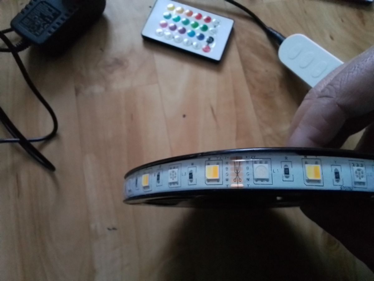

  • LSC Smart Led Light Strip RGBCW from Action store in the Netherlands, branded LSC and identified as article number 3000342.
  • It uses a BK7231T chip and a chip-on-PCB module.
  • The strip cost about €20, and the available settings are RGB CW without buttons or remote.
  • IR remote support and three buttons on the module are still TODO.
  • LSC Smart Led Light Strip RGBCW bought at Action store in NL at arround €20,-
    Brand: LSC
    Chip: BK7231T
    Module: Chip on pcb
    Article number: 3000342
    TODO: ir-remote and 3 buttons on module

  • #7 20394580
    alfakenzo
    Posts: 32
    I got the same LSC Led strip, but I got a BK7231N. I set the PWM but I can't get working the Ir remote. Maybe you can help. I add some photos. [BK7231T] - LSC Smart Led Light Strip RGBCW 20W(Action store) [BK7231T] - LSC Smart Led Light Strip RGBCW 20W(Action store)

    #11 20516988
    upin
    I bought the same device as @dannyx323 in an Action store in DE at around €20.
    Brand: LSC
    Chip: BK7231N
    Module: Chip on pcb
    In my case the chip is a BK7231N (not ...T) like @alfakenzo reports.
    On the backside of the PCB is a board ID and a date. It reads: "K225P10-V1.1" and "2022.03.25"
    I used multimeter, PCB tracing, and oscilloscope to find the following assignments:
    Questions to the forum:
    * The PWM assignments work all nicely. But I cannot get the Btn and IRRecv to work. I am pretty sure the pin assignments are correct.
    * The PCB has a microphone which I have not traced, yet. How do I configure a mic and how can I use it?

    #12 20517225
    Posts: 14768
    Rate: 12911
    @upin is the packaging/versionining the same? If not, please attach device/packaging photos so I can add it to templates list.
    upin wrote:
    * The PWM assignments work all nicely. But I cannot get the Btn (...) to work.
    Use the "Btn_SmartLED" role, it gives full control over the device with multiple clicks etc, see:
    of course, in your case you don't have to solder a new button, just use existing one
    upin wrote:
    * The PWM assignments work all nicely. But I cannot get the IRRecv(...) to work.
    You should see IR events in Web App log after reboot, see:
    Not much work has been done for that kind of feature, but I would guess that it may be connected to ADC.
  • BK7231N pinout and config for LSC LED strip
    #13 20517656
    upin
    Thank you, @p.kaczmarek2 , for your quick reply and helpful pointers.
    Yes, the packaging is the same. Even the article number is still 3000342. I attach some pictures of product packaging below.
    With your help I got IR and the hardware button working. Here is the configuration:
    Please find the images of product, packaging, and PCB attached.
