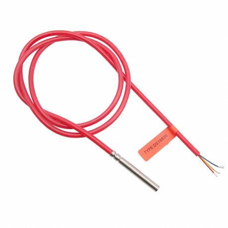

    Hi, I have been interested in the Sonoff TH Elite THR316D controller. I plan to buy it but would like to save money and use a DS18B20 sensor in a waterproof housing that I already have. The original sensor is connected to the controller with an RJ9 4P4C connector. If anyone knows how to connect this I would appreciate help. There are 3 wires coming out of my sensor: yellow, red, blue.
    On the AVT website where I bought this sensor there is this information about the leads:
    VCC - red - I have,
    GND - black (or blue - depending on the supplier) - I have blue,
    DATA - white - white I don't have so it will probably be yellow with me.
    I also found a sensor like this:
    https://allegro.pl/oferta/czujnik-ds18b20-termometr-sonda-15m-15-metrow-rj9-10454440687
    it's on an Rj9 plug just like I need however there it's yellow/green/black and in the picture it's still red so I don't know what it's about but maybe this will be helpful in answering.

    Pinout and description in the link
    https://wiki.jmehan.com/display/KNOW/Temperature+Sensor+with+Sonoff+Basic
    In the link you provided you have the pins in the plug, so don't look at the colours in the photo just the positions in the plug, and match them to your sensor.
    And just to be 100% sure, dismantle the controller and check where the various socket leads go.

    @ducker1 thanks for the reply but I didn't understand anything. How can I not look at the colours when I have the sensor built in and don't know what is connected to what?

    Don't look at the colours in the auction on eBay, but at the markings, from the photo you can deduce which pin of the plug goes to the power supply and which to the date.
    Now match it to your sensor, according to the colours
