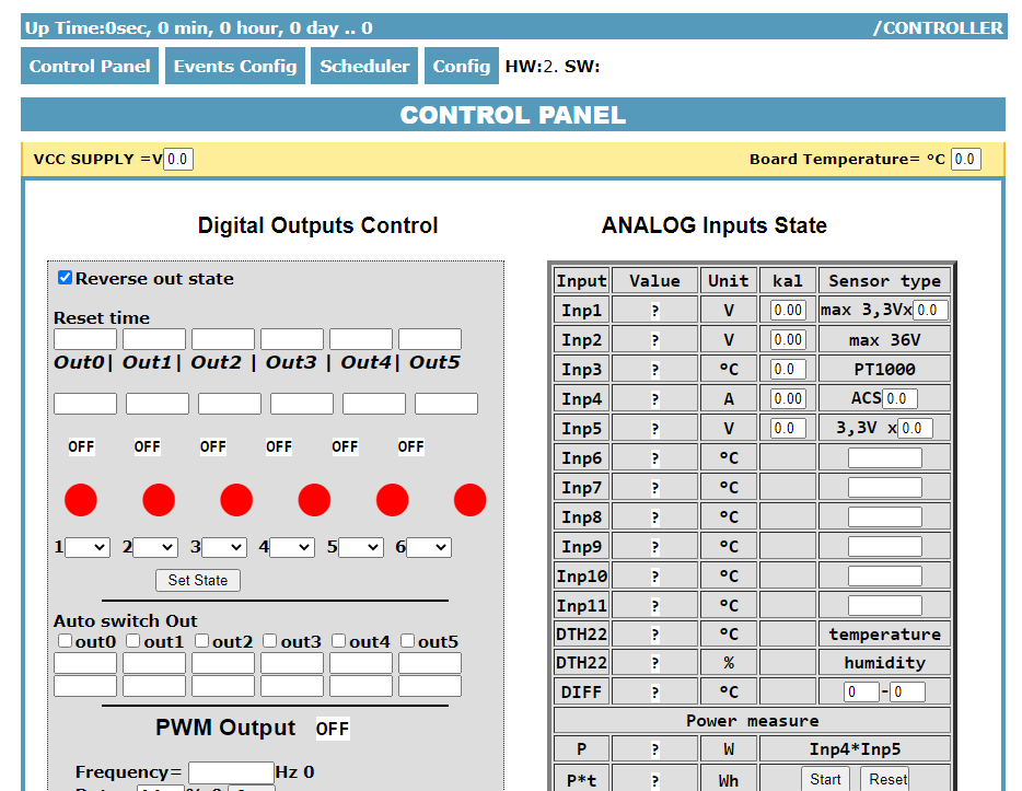

    Hello, I have this Tiny Control Lan controller v2.5
    I dug it out of the cupboard and decided to use it a bit. It reported nicely in the network, but I decided to connect the DS18 temperature sensor (original with cable and plug) but it did not give any value to the controller, so I decided to move the plugs there and now I have only question marks. I have reset and uploaded the soft but it does not help. I certainly don't remember how to use it and this is the problem. Please tell me what I am doing wrong. I am attaching a picture of the screen.

    What are the plugs that have been moved?
    The photo shows several temperature inputs...
    Which one was the DS18 connected to?

    There are two plugs: an RJ45 as network and power and another to RJ11 from the sensor. The input to the sensor is one because it is a 1-wire sensor.

    I asked about the input number of the temperature sensor,
    because you may need to fill in the InputType field,
    so that the controller knows how to read the temperature

    But he doesn't need it. Nothing is set, it fills in a random field by itself. I mean there are no values Date time version HW SW voltages jumped and currents and temperature onboard and now nothing no values . Everything worked without connecting sensors. Now whether they are connected or not is just a question mark.
