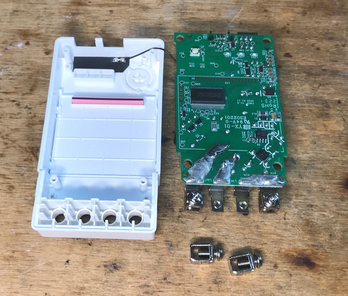

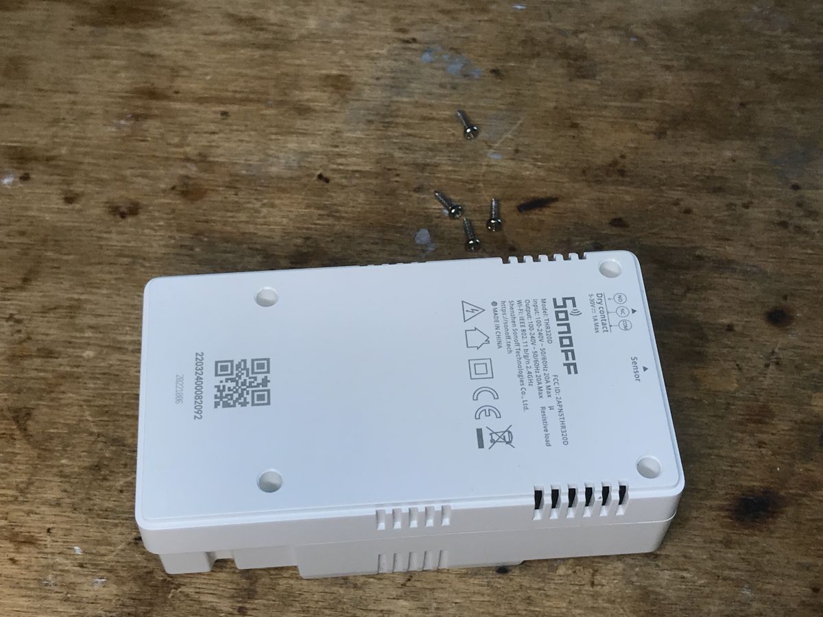

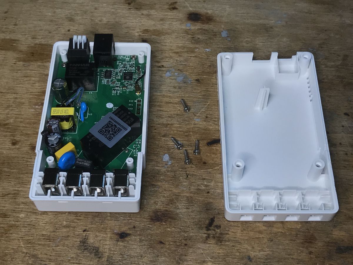

    THR320D interior

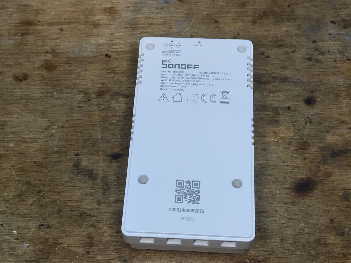

    This product is distinguished by its solid construction. There are no breakable hooks. Unscrew the screws:
    Back cover of the Sonoff THR320D thermostat on a wooden surface. Sonoff THR320D thermostat case lying on a wooden surface.
    At first glance it's not that bad, there are some protections at the input, there is even a varistor, a filter capacitor, you can also see a relay, a programming connector and a small transformer with a characteristic Y capacitor, i.e. there is a flyback power supply inside..
    Interior of a disassembled Sonoff THR320D thermostat with visible electronic components. Interior of the Sonoff THR320D device with visible PCB and electronic components.

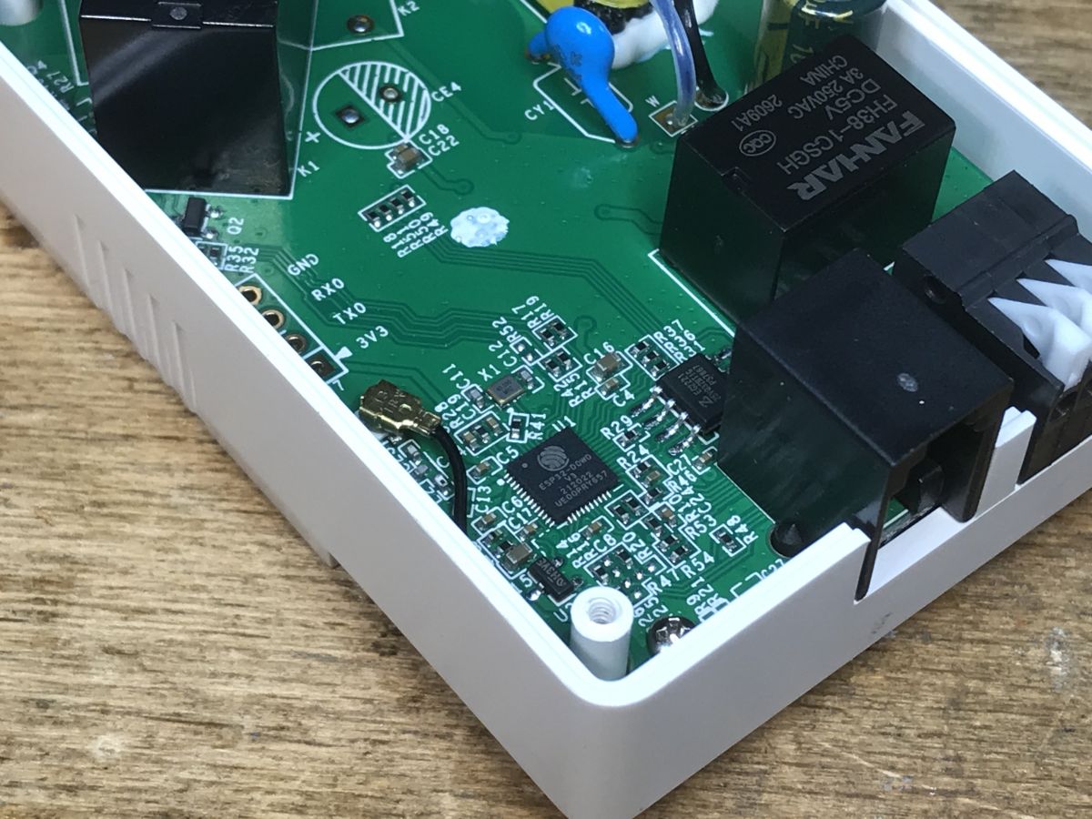

    There is no WiFi module inside, ESP32 is located directly on the PCB, you can see the flash memory right next to it:
    Interior of the Sonoff THR320D thermostat showing the PCB.

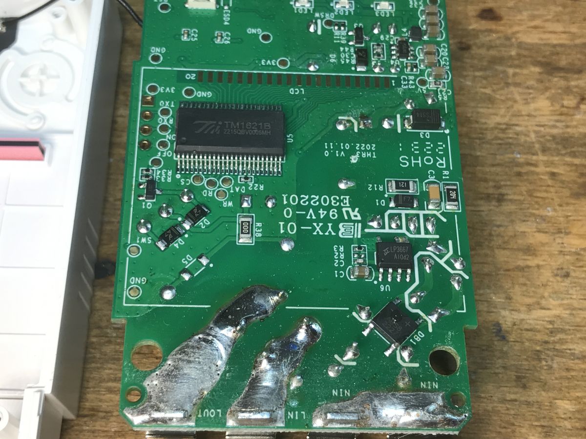

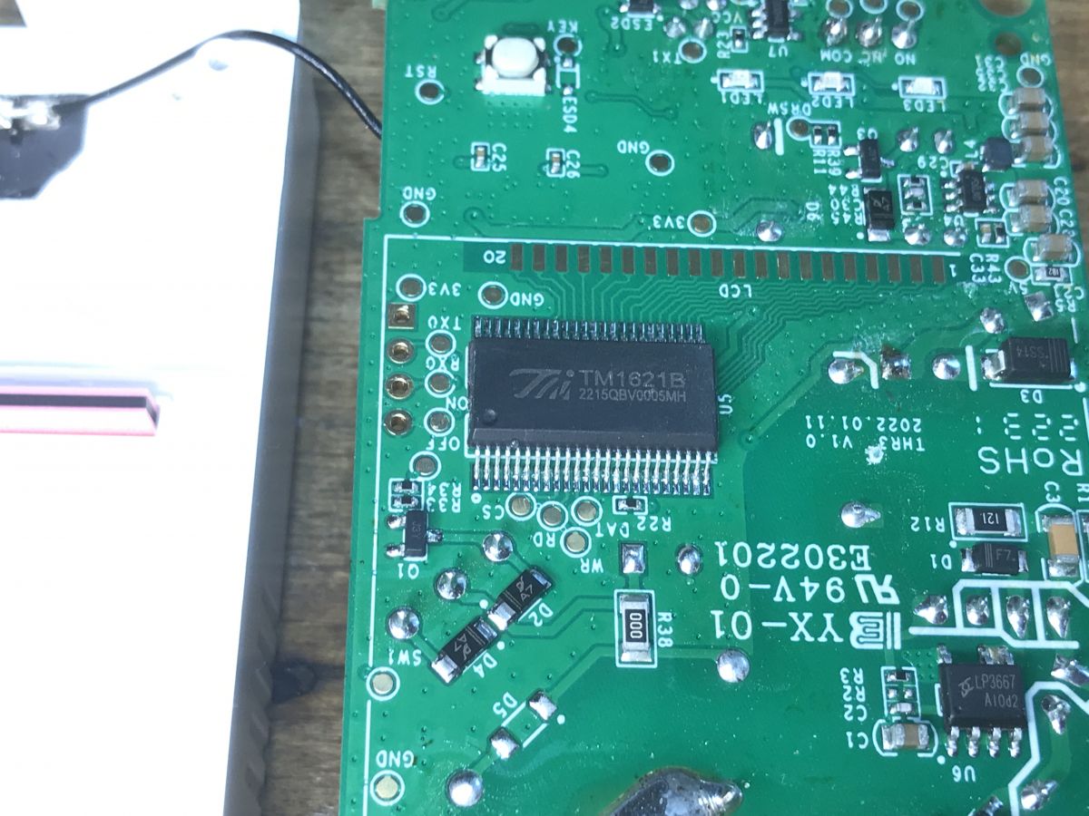

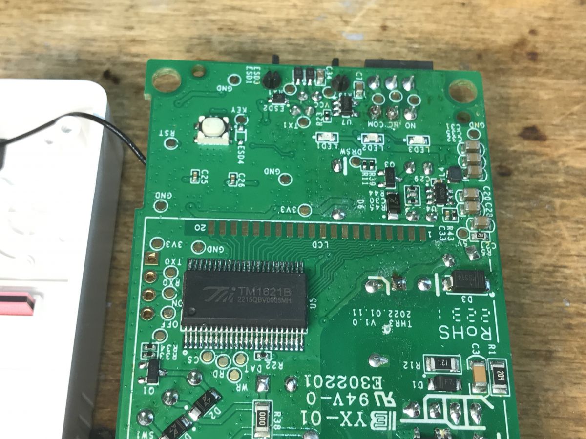

    The PCB can be removed and we will see the display controller and the WiFi antenna:
    Sonoff THR320D circuit board with TM1621B chip. Image of the interior of the Sonoff THR320D thermostat showing the PCB and casing.

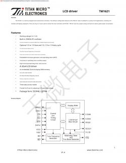

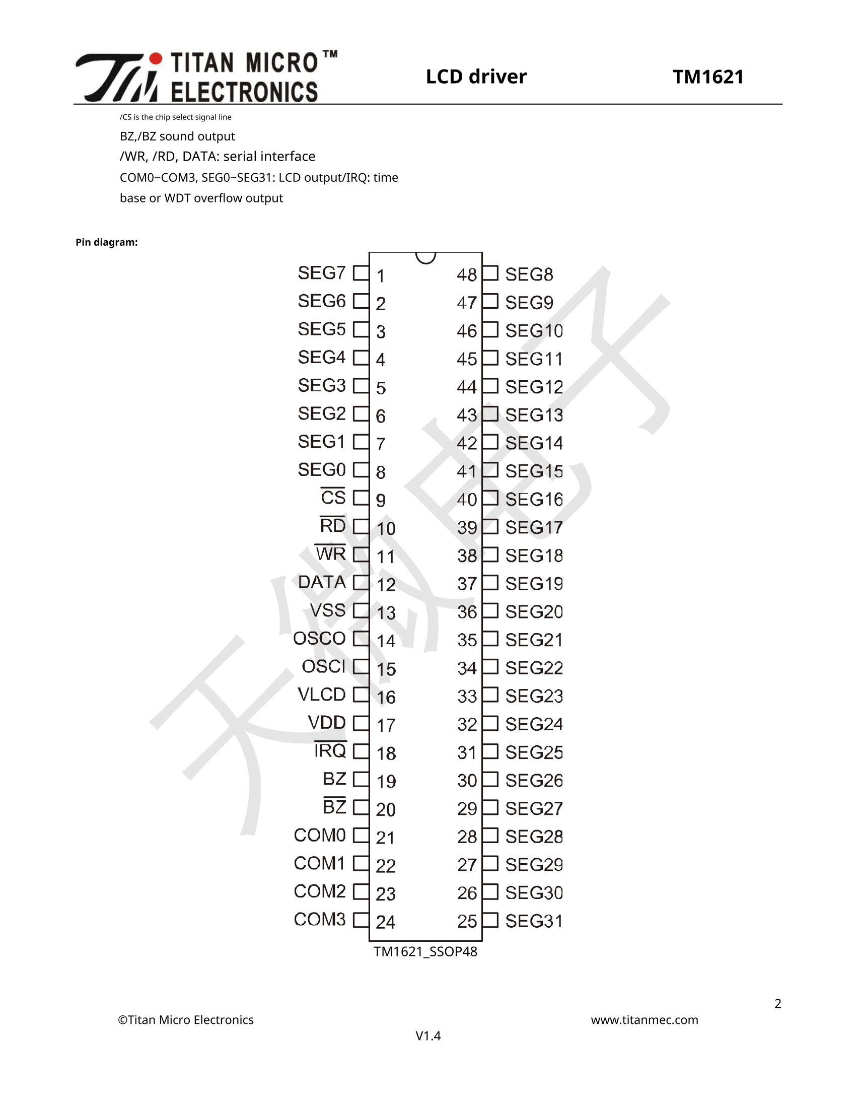

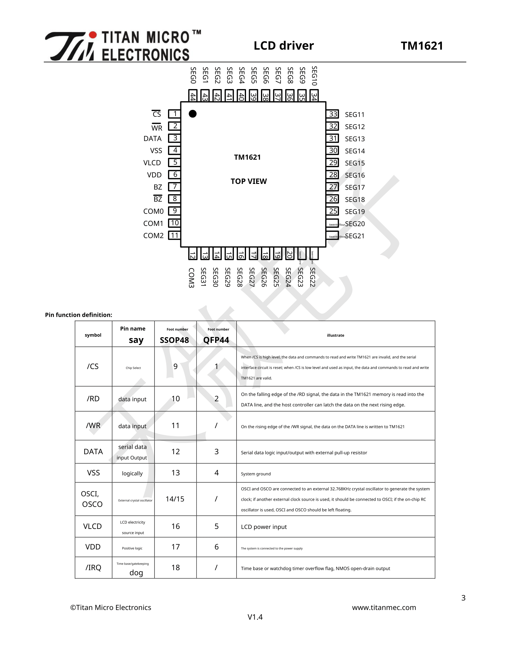

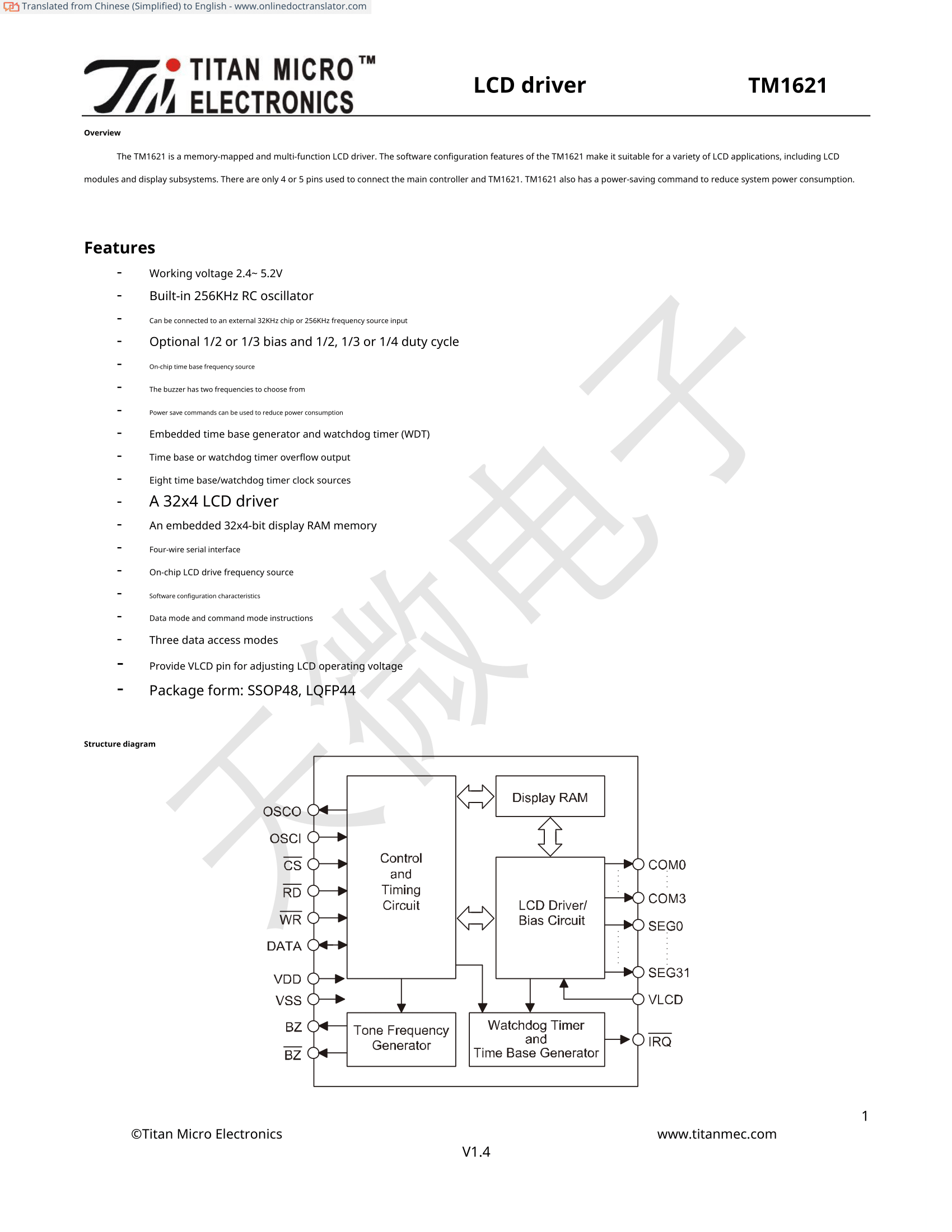

    The display supports TM1621:
    Documentation page for the TM1621 LCD driver from Titan Micro Electronics. Pin diagram of the TM1621 LCD driver from Titan Micro Electronics. Diagram of the TM1621 LCD driver by Titan Micro Electronics
    We also see details of the power supply section and the LP3667 controller:
    Close-up of the Sonoff THR320D thermostat PCB.

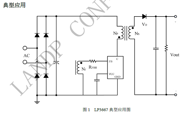

    A simplified diagram of such a converter:
    Schematic diagram of a flyback converter with LP3667
    In the corner I also see a step down converter generating 3.3V for ESP, you can also tell it by the presence of a choke, by the way, it's interesting that they put so many ceramic capacitors there:
    PCB of Sonoff THR320D thermostat with TM1621B chip. Sonoff THR320D circuit board with visible electronic components

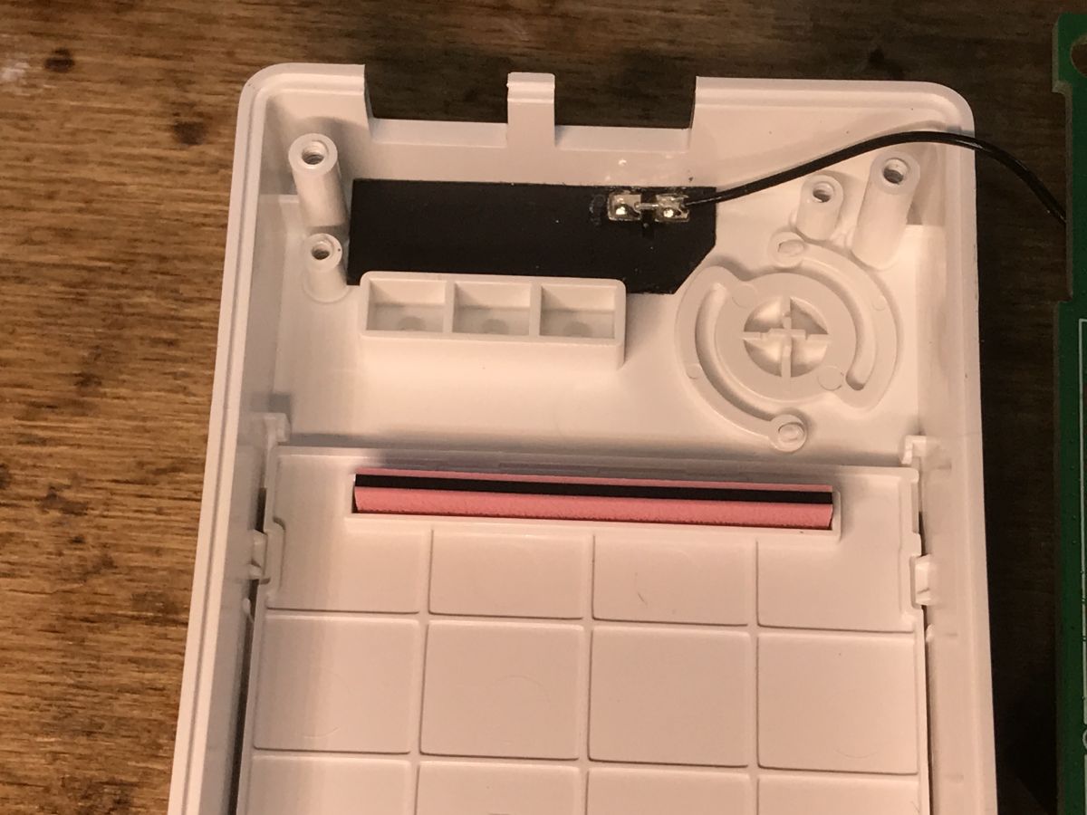

    The already mentioned WiFi antenna:
    Interior of the Sonoff THR320D thermostat casing with visible components.

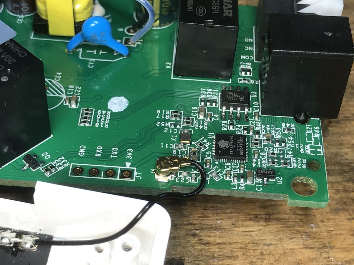

    ESP:
    Close-up of the PCB from the Sonoff THR320D thermostat with visible electronic components.
    The photo above also shows programming pads, but there are only 4...
    Firmware change
    You need to start with the fact that IO0 is located on the button, so we solder 4 wires, not 5. As standard, a USB to UART converter (RX and TX) and ground and power supply (3.3V). To load the firmwarwe, first press the button and then connect the programmer's power supply so that IO0 is at low level while the device is booting.

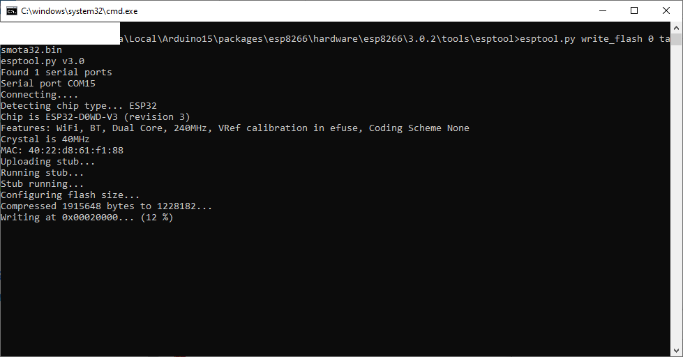

    Then you can upload Tasmota, e.g. using the online installer:
    How to easily install Tasmota - online installer tasmota.github.io/install via a web browser

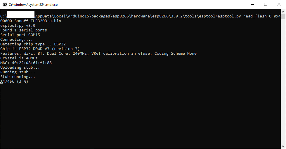

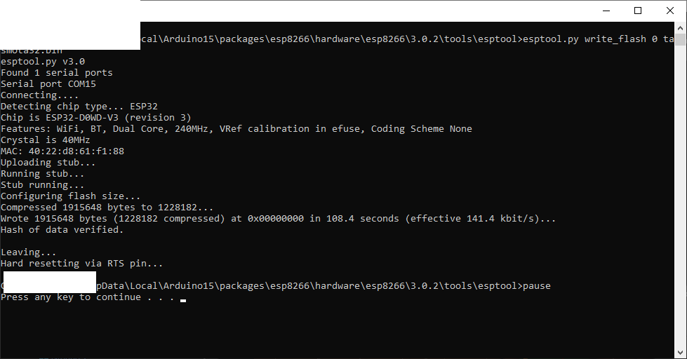

    However, I used esptool myself:
    Windows console with esptool program running for ESP32. Console with firmware loading process on ESP32. Console output showing the flashing process of an ESP32 chip using esptool.

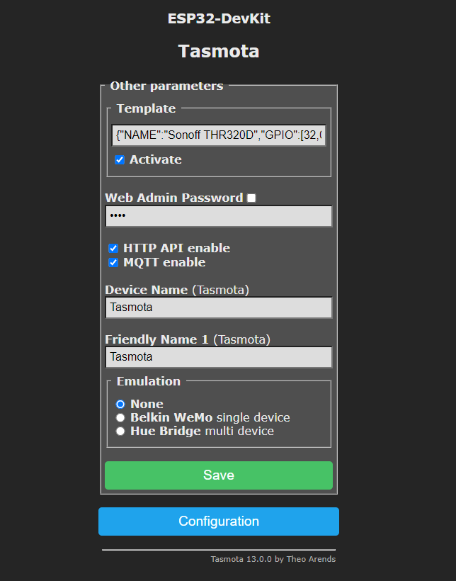

    The THR320D template is available online:
    {"NAME":"Sonoff THR320D","GPIO":[32,0,0,0,226,9280,0,0,0,321,0,576,320,9184,9216,9312,0,0,9313,9248,0,1,0,3840,0,0,0,0,0,0,0,0,0,0,0,0],"FLAG":0,"BASE":1}
    GPIO roles:
    - GPIO00 - Button 1
    - GPIO04 - Relay 3
    - GPIO05 - TM1621 DAT
    - GPIO13 - Led_i 2
    - GPIO15 - LedLinks
    - GPIO16 - Led_i 1
    - GPIO17 - TM1621 CS
    - GPIO18 - TM1621 WR
    - GPIO19 - Relay_b 1
    - GPIO22 - Relay_b 2
    - GPIO23 - TM1621 RD
    - GPIO27 - Output Hi

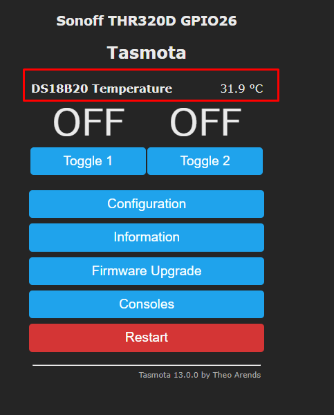

    Template activation:
    Screenshot of Tasmota interface on ESP32-DevKit

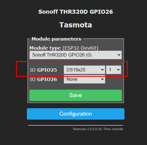

    Then you need to select the roles for the GPIO sensors, because there may be different sensors, I only checked with DS18B20:
    Screenshot of the Tasmota configuration interface for Sonoff THR320D.

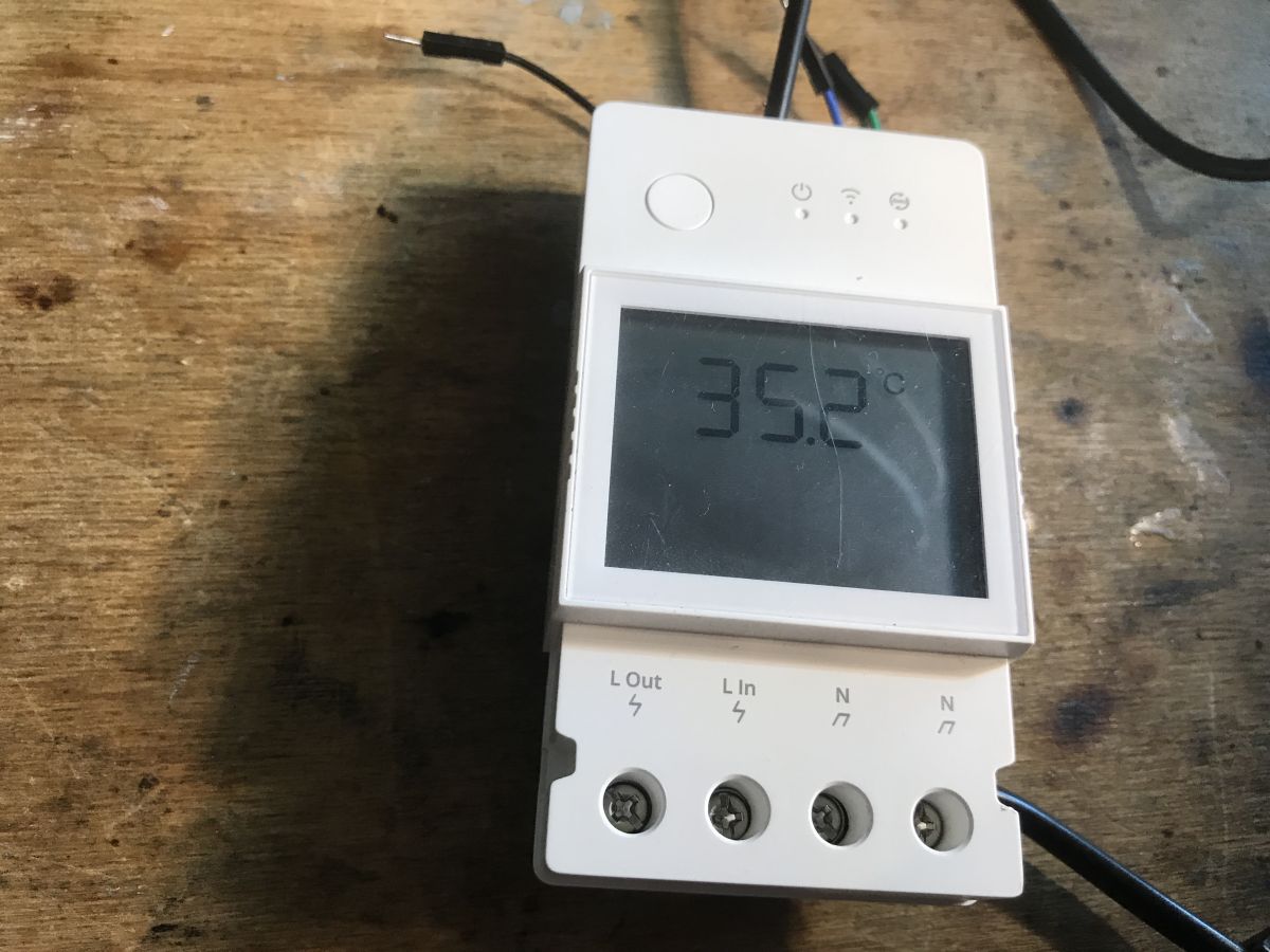

    Result:
    Tasmota user interface with DS18B20 temperature on a Sonoff THR320D thermostat

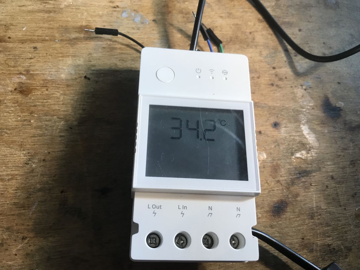

    Of course, the display still works, the template takes into account its operation, although now it no longer displays anything about humidity like the original firmware:
    Sonoff THR320D thermostat displaying temperature 34.2°C Sonoff THR320D thermostat with display showing a temperature of 35.2°C.
    And the temperature in the photo is high because I heated the sensor with a lamp to test:
    Close-up of a hand holding a wire next to an LED strip.
    Everything seems to be working.

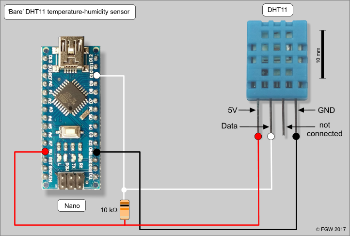

    What kind of sensor would you like to connect? I'd suggest to choose the resistors for the sensor you have.
    For example, here is how a DHT11 connection should look like:
    Diagram of DHT11 sensor connection with a Nano board, showing wiring and a resistor layout.

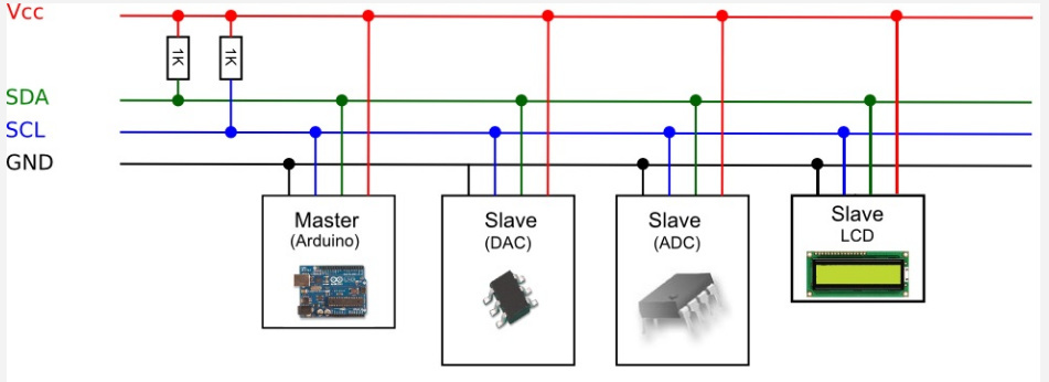

  • #10 21201532
    HellG
    I want to connect several sensors via I2C, that’s why I need an additional GPIO.
  • #11 21201629
    Posts: 14701
    Help: 656
    Rate: 12747
    Both I2C lines will require pull-up resistors, here is some random sample from the web:
    I2C circuit with pull-up resistors and devices: master and slaves.

What spare GPIO options are available on the Sonoff THR320D if I want to add extra sensors over I2C?
The thread points to an unpopulated route from the sensor connector toward GPIO26, with a neighboring path tied to GPIO25. That means extra I2C wiring may be possible, but not as a ready-made spare header. If you need both SDA and SCL, you may have to populate missing resistors or repurpose an existing function such as a relay line. [#21201178]
How do I use the sensor connector test pad linked to GPIO26 on the Sonoff THR320D, and what resistor values should I choose for that mod?
Use the sensor connector’s PIN3 test pad marked RX1 as the access point, then populate the missing resistor path toward GPIO26. The thread says that node runs near R16 and R25, which are not populated. No exact THR320D resistor values are given; the advice is to choose values for the specific sensor you plan to attach. A DHT11-style example is shown, but not an I2C-specific BOM. [#21201469]
Which pull-up resistor values work best for I2C sensors on a 3.3V ESP32-based board like the Sonoff THR320D?
Typical I2C pull-ups are 1 kΩ to 10 kΩ, with 2.2 kΩ to 4.7 kΩ used most often. The thread also gives mode-based guidance: about 1.5 kΩ to 10 kΩ for 100 kHz, 1.5 kΩ to 4.7 kΩ for 400 kHz, and 1 kΩ to 2.2 kΩ for 1 MHz. Start near 4.7 kΩ on 3.3 V unless bus capacitance or speed forces a lower value. [#21201640]
