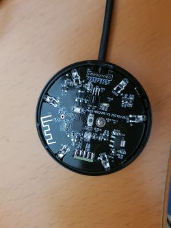

    Hello, I just got this device and it works perfectly with the Smart life application. Unfortunately, the HA tuya integration does not support the IR devices.
    I have disassembled the device and checked if it is tasmota compatible, but I've found that it's a BK7231T based device. Googling, I have found this forum and I want to share my experience.
    [BK7231T] Tuya Smart IR NAS-IR02W6 v3: Flashing & Compatibility Issues with Home Assistant
    I have tried to read/flash the device with a USB to TTL adapter and with an Arduino as a TTL converter. For both cases, the Windows tool simply does not detect anything. I have tested the two points labeled as RX and TX. Then I load the firmware and click program, the short CEN to GND to reset. The device seems to reset, but nothing is detected. By the LEDs in the USB to TTL adaptor, it looks like it's not getting any data from the BK7231T.
    I have spent some hours on it and I was not able to make it work; I don't see what else could I try.
    Does somebody was able to flash this device? Or have any advice? I have run out of ideas

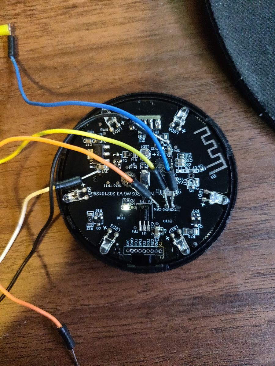

    Have you tried different baud rates? Lower or... a higher, it also might help? What kind of USB to TTL adapter do you have?
    Have you ensured that device has enough current to run?
    How did you exactly connect the device?
    I'd do:
    1. power the device from the cable as usual
    2. connect Rx, TX and GND from USB to UART converter
    3. Start flash operation in bkWriter 1.60
    4. temporary disconnect and reconnect power
    It should proceed. If power reconnect method fails, then CEN should work, but CEN method is tricky, it requires you to short CEN to GND for about 0.25s

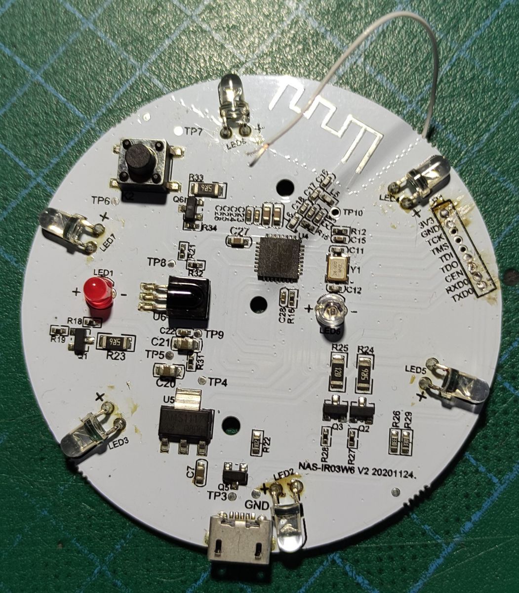

    I have the same IR Blaster made by CoollSer which is the same as the Tuya.
    I have successfully flashed the device by using the CEN -> GND trick. Naturally I did a lot of trial and error but finally I made it.
    The issue is that the support by the BK7231T project is limited but you can try.
    As a reference use Pin 8: IRrecv , Pin 26: IRsend .

    Thanks for the reply. I've tested almost everything: different baud rates, power device from different sources, power on connection and CEN connection to ground...
    I don't know the USB to TTL I have, but I have used it to tasmotize other devices before. Also, I have tested with the Arduino as an adapter.
    I'm going to try again next year following your instructions, I think that probably I had a bad wire connection and I messed up while trying to fix it.

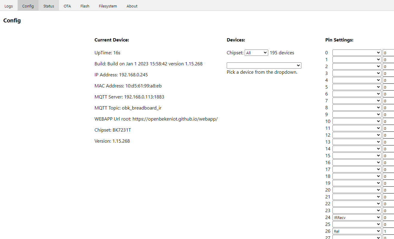

    Are you sure that 1.15.253 works and 1.15.254 is already broken? I would need to narrow down which change broke.
    EDIT:
    Well, according to my quick test with my test device on breadboard, it still works... at least for Samsung.
    Chipset: BK7231T
    Build: Build on Jan 1 2023 15:58:42 version 1.15.268

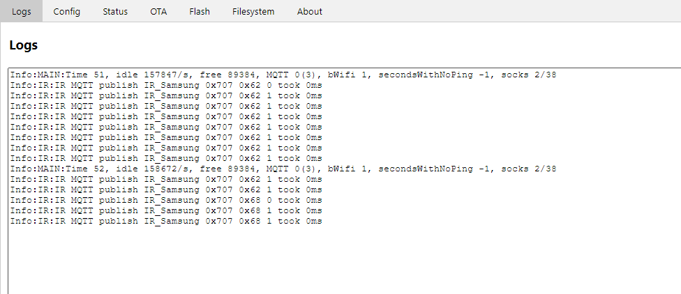

    Using the logs tab of the flashed IR blaster OpenBK7231T_app web page I decoded all the relevant IR codes for the Samsung TV and the Apple remote and mapped them to MQTT commands of the TV using SmartIR with the provided MQTT integration. I just had to provide the IR codes in a JSON file and change the SmartIR config to read that. After that I had a new media-player representing the TV. Here is the JSON file for the Samsung TV:

    Thought I'd share my experience and info for those wanting to flash this device:
    P6 (PWM0) - The button
    P9 (PWM3) - The WiFi Status LED
    P8 (PWM2) - IR Receive
    P26 (PWM5) - IR Send
    Photo of test pads used for flashing:
    I'm still working out how to work with this device. I have found https://developer.tuya.com/en/docs/iot/bk7231t-cob-hardware-design-guideline?id=Ka97u6dz0h8b8 which shows the chipset details.
    Firmware version 1.15.639 seems to be working for me.

    As mentioned in the quoted text, if you simply go to the OpenBK7231N_app web page and click on the 'logs' panel (deselect everything except for CMD, IR, and MQTT to declutter the noise) : and then point an IR remote at the device and click a button, you'll see a readout on the logline of what IR signal was received. Let's use an example of an IR signal that I've been working with. On my soundbar, the 'Volume Up' Button on the remote sent the signal "IR_Samsung 0x2C2C 0x17 0 (32-bits)" (as recorded in the logs).
    To have the IR blaster send out this signal using Home Assistant -- I made a new script, and the action was 'MQTT Publish'.
    Topic: cmnd/IR-Blaster/IRSend
    Payload: Samsung-2C2C-17-0-32
    Then I simply made a new button on my dashboard which activates that script each time I press it.
    So far, I have my little IR blaster controlling some electronic candles, the TV Power ON/OFF, and the soundbar volume.
