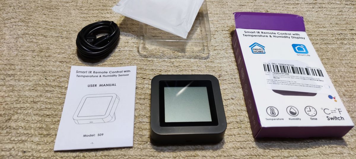

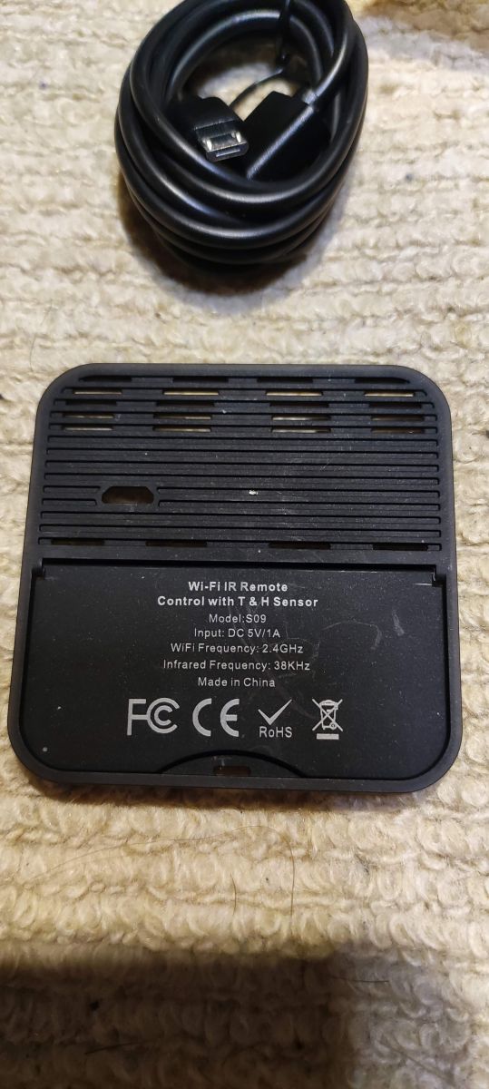

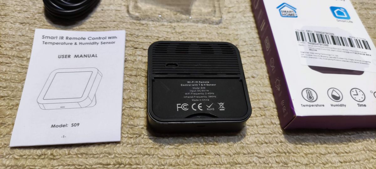

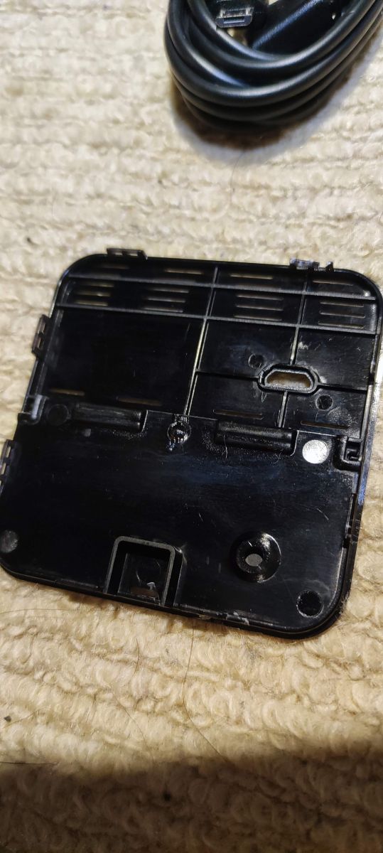

    Packaging and externals
    View of S09 device packaging with LCD display and technical specifications. Product label with printed barcode and description of a smart WiFi remote control. Components of the IR remote control set with temperature and humidity display Smart IR remote control with temperature and humidity sensor S09 with manual and packaging Device displaying temperature, humidity, and time, with a user manual.
    Back of S09 device with temperature and humidity sensor, along with USB cable.

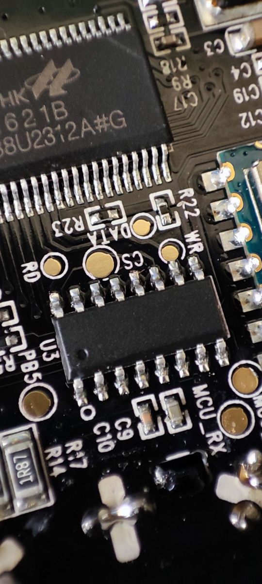

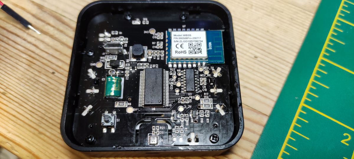

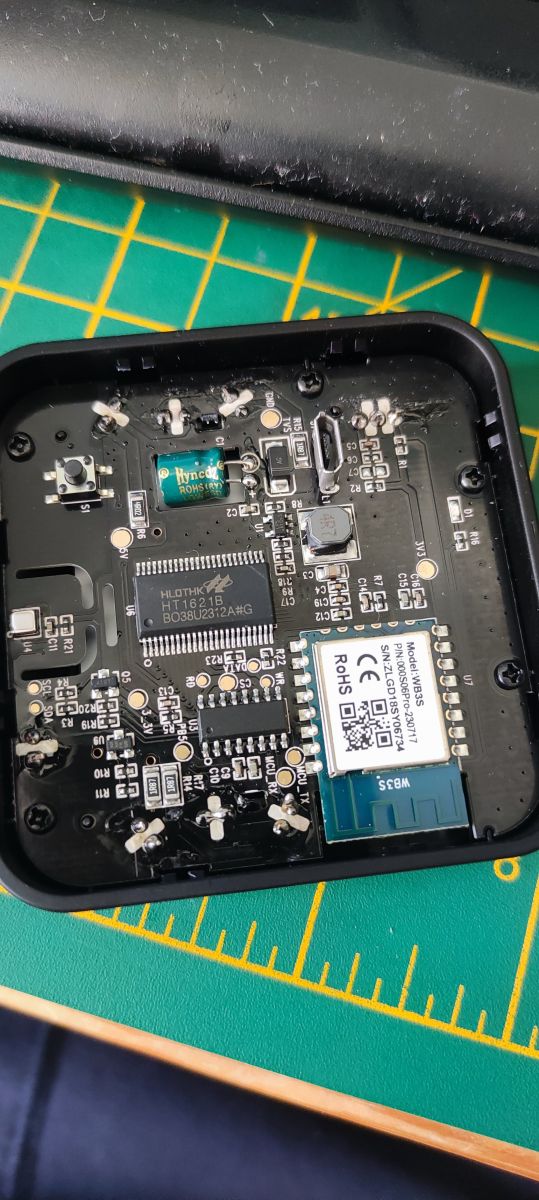

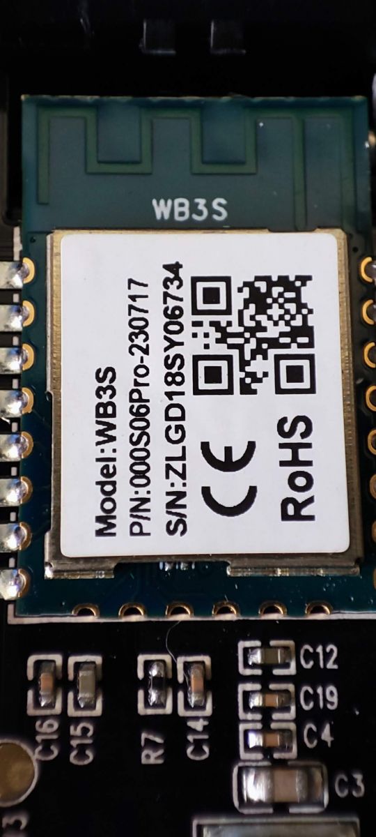

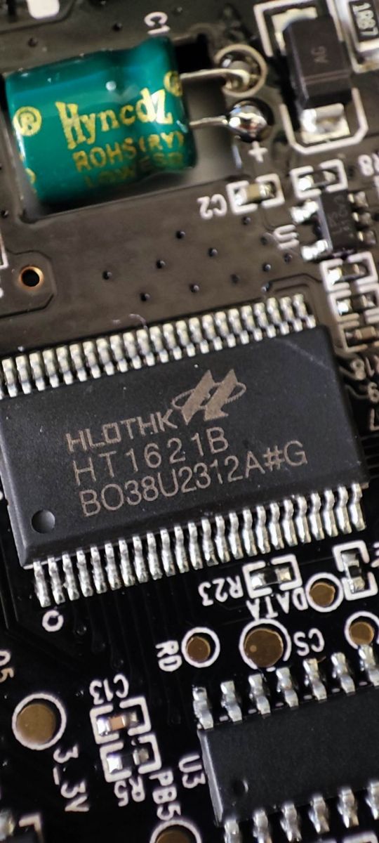

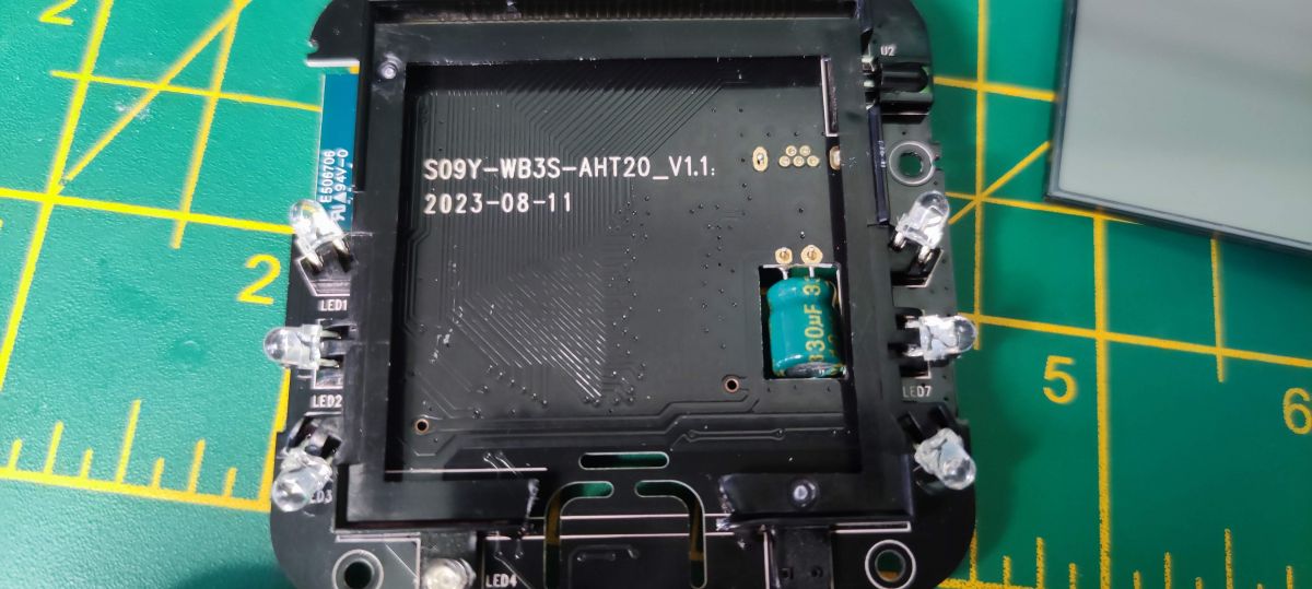

    Upon opening you can see the BK7231T based WB3S module, as well as the TuyaMCU and LCD controller controller chips and then the tiny AHT20 sensor. Silkscreen text S09Y-WB3S-AHT20_v1.1: 2023-08-11
    WB3S module on a PCB with visible QR code and CE, RoHS markings. Close-up of an HLOTHK HT1621B integrated circuit on a circuit board. Close-up of a PCB with visible microchips and track labels. Interior of an electronic device with exposed components, including the WB3S module. Close-up of a printed circuit board with electronic components. View of the S09Y-WB3S-AHT20_V1.1 module with components mounted on the board. Interior of a device with a WB3S module and other electronic components. Black plastic device cover with visible mounting features and holes.

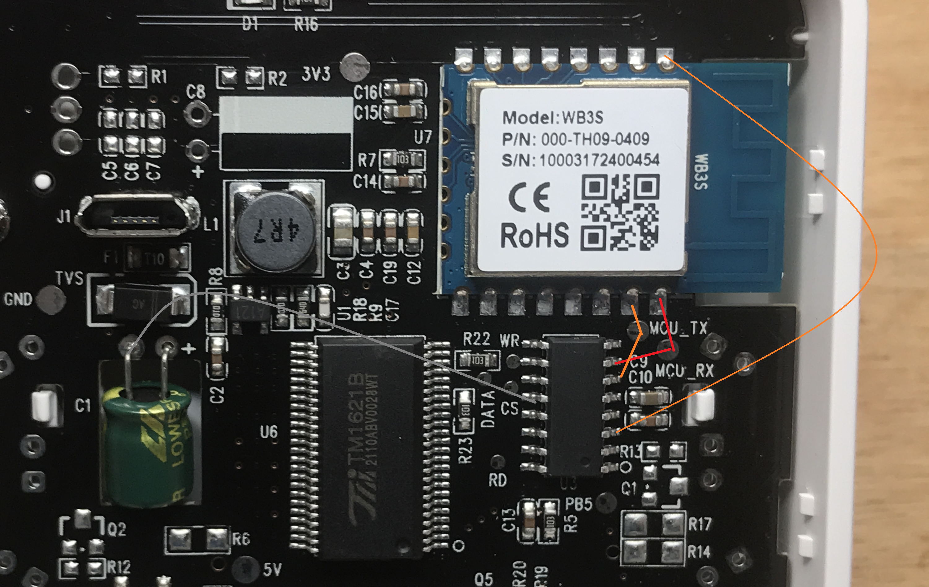

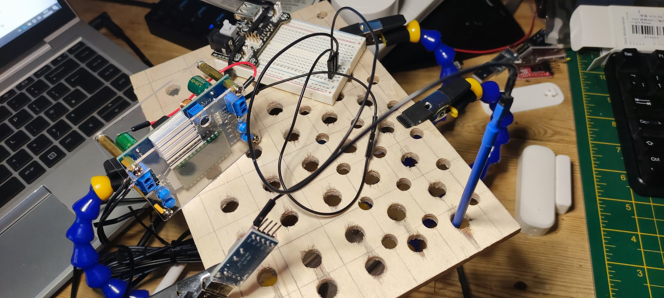

    Unlike experiences in the TH06 thread with other S09s, I was not successful flashing dumping and flashing the Beken chip without cutting TXD1/RXD1 to the TuyaMCU, despite many attempts. Pogo pins and then soldering, different USB-TTL adaptors, different cables. No joy. Using the TuyaMCU Analyser I could see the MCU sending and receiving commands, so it seemed this was getting in the way.
    I confirmed continuity between TXD1/RXD1 and the MCU pins with a multimeter and with the aid of this image from the TH06 thread.
    Close-up of an electronic board with a WB3S module labeled with its model and serial number.

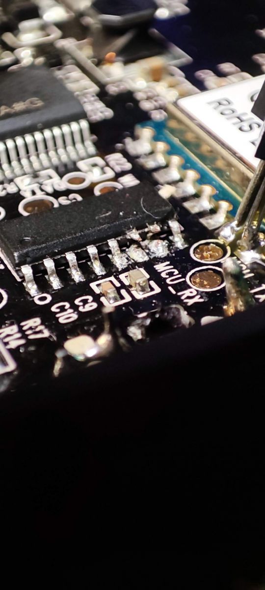

    I cut the two pins at the MCU end using some small pincer pliers, though maybe desoldering and lifting is a nicer solution.
    Close-up of a circuit board with integrated circuits and pins labeled MCU_RX.
    with those gone, retrieving fw backup, boot log and flashing OpenBeken was easy

    Because of the TuyaMCU, Easy Flasher was not able to automatically determine any GPIO assignments
    Sorry, no meaningful pins data found. This device may be TuyaMCU or a custom one with no Tuya config data.
    Baud keyword found, this device may be TuyaMCU or BL0942. Baud value is 9600}e
    No module information found.
    The correct details can be determined using settings already mentioned in the TH06 thread and with the GPIO finder.
    P6 Btn
    P8 IRRecv
    P26 IRSend
    and the autoexec content required
    startDriver TuyaMCU
    startDriver NTP
    ntp_timeZoneOfs 00:00
    // dpID 101 is tempererature div 10
    setChannelType 1 temperature_div10
    linkTuyaMCUOutputToChannel 101 val 1
    // dpID 102 is % humidity
    setChannelType 2 Humidity
    linkTuyaMCUOutputToChannel 102 val 2

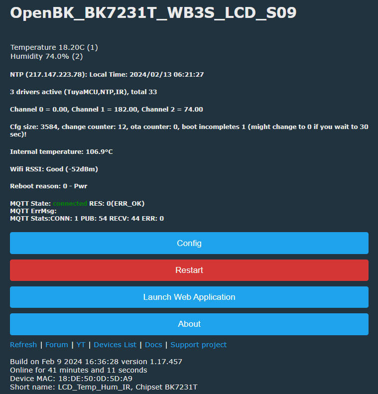

    With that in place we have a working device
    Screenshot of the user interface for the OpenBeken S09 device.

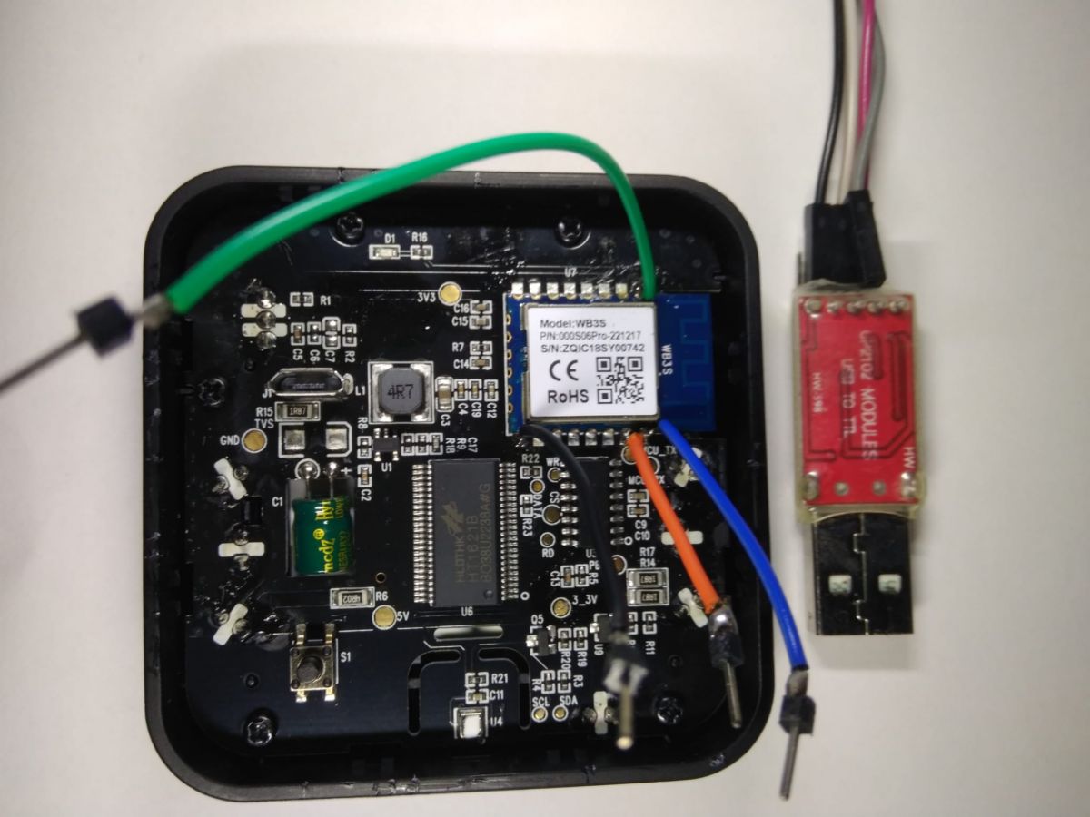

    Would you mind commenting on how you connect the ground of the USB converter?
  • #4 20961566
    Posts: 5062
    Help: 438
    Rate: 893
    it does indeed look to be identical, so I'm not sure what I was not doing that meant I had to cut the rx/tx.
    I had two setups, initially longer GND from
    USB-TTL GND -> breadboard
    PSU GND -> breadboard
    BK7231N GND/pogo -> breadboard
    pic shows GND only connected in this example.
    Breadboard setup with electronic components and wires connected to a laptop.
    but then I shortened it all, cut out the pogo and soldered to the GND pin on BK.
    so, dunno. I kind of want to get another to do it all again.
  • #5 20961593
    spin55
    Posts: 209
    Help: 17
    Rate: 42

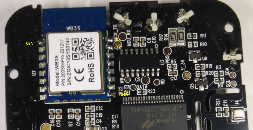

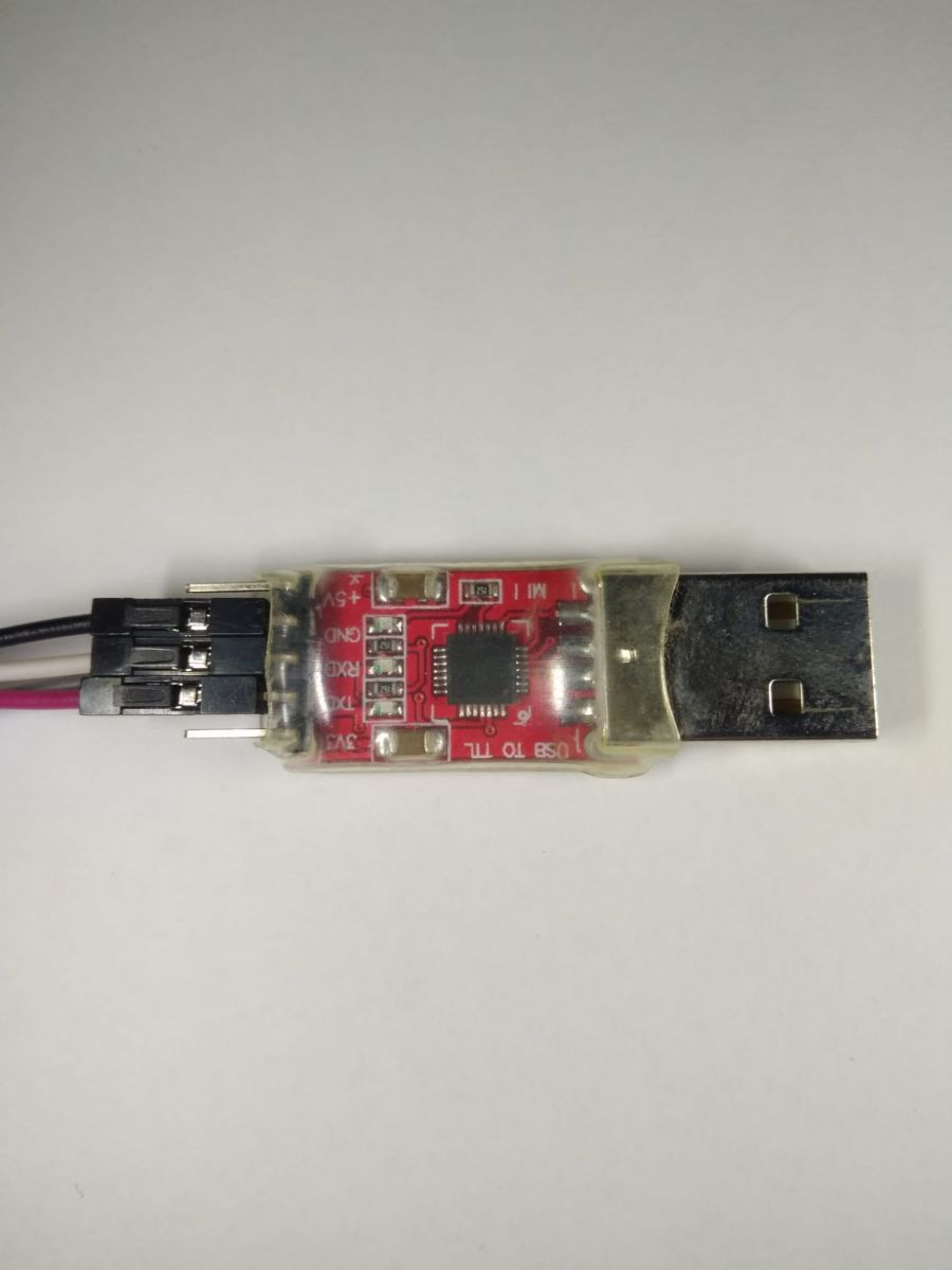

    Solder some cables directly to the pins of the WB3S module that I point out in the image and connect the USB converter to them (Rx to Tx, Tx to Rx, and GND). Use CEN as usual.
    Close-up of a circuit board with a WB3S module and marked pins Rx, Tx, GND, and CEN.
    Added after 28 [minutes]:
    WB3S module with soldered wires connected to a USB converter. USB to TTL converter with black wires on the left side. USB to TTL CP2102 converter with attached cables.
