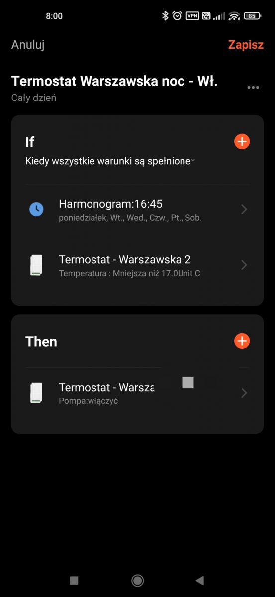

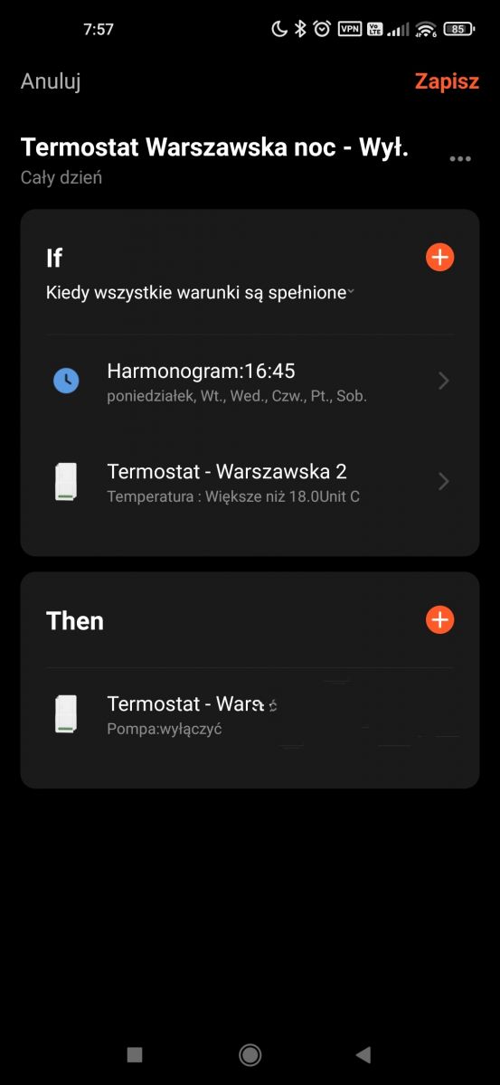

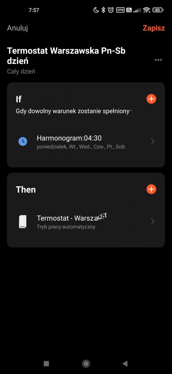

    Hi.
    I have a thermostat that I want to control the heating with:
    Monday - Saturday from 4:30 am to 4:45 pm auto mode
    Monday - Saturday from 4:44 pm to 4:30 am and throughout Sunday I want to keep the temperature between 17-18 degrees.
    I have set up the thermostat as shown in the screens, but I wonder if the 2 separate conditions (night - on and night - off) will be mutually exclusive.

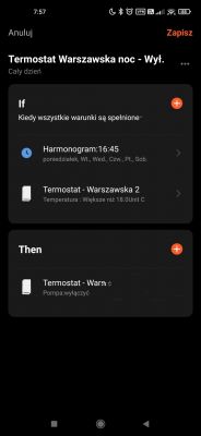

    In my opinion, no.
    The temperature part of the condition separates these cases.
    I think you have set the days wrong.
    In the description you write that it is supposed to run on Saturday and in the schedule condition you have set the whole week.
