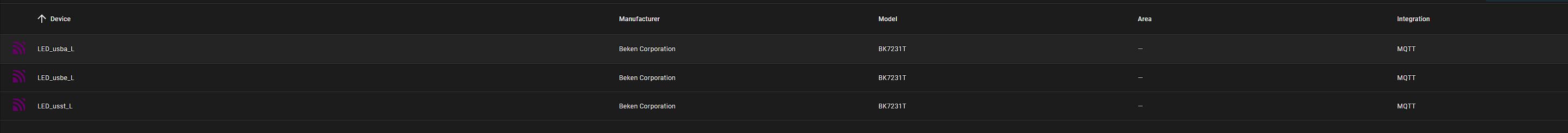

    However I cant for the life of me get discovery to work. The only way I can connect via HA is by manually adding via YAML conf. But when I do this only an entity appears, no device.
    I am still learning HA and MQTT but I'm only having this problem with BL602, I've got many ESP and BK7231T devices working fine and with discovery.

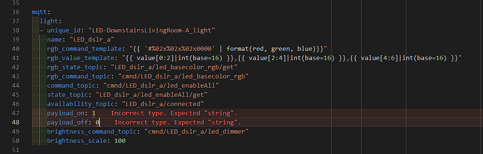

    Here's my conf for this device:
    mqtt:
    light:
    - unique_id: "LED-UpstairsBedroom-BedLights_light"
    rgb_command_template: "{{ '#%02x%02x%02x0000' | format(red, green, blue)}}"
    rgb_value_template: "{{ value[0:2]|int(base=16) }},{{ value[2:4]|int(base=16) }},{{ value[4:6]|int(base=16) }}"
    rgb_state_topic: "LED_usbe_bed/led_basecolor_rgb/get"
    rgb_command_topic: "cmnd/LED_usbe_bed/led_basecolor_rgb"
    command_topic: "cmnd/LED_usbe_bed/led_enableAll"
    state_topic: "LED_usbe_bed/led_enableAll/get"
    availability_topic: "LED_usbe_bed/connected"
    payload_on: "1"
    payload_off: "0"
    brightness_command_topic: "cmnd/LED_usbe_bed/led_dimmer"
    brightness_state_topic: "LED_usbe_bed/led_dimmer/get"
    brightness_scale: 100
    Apologies is this is a newbie question. But any help would be much appreciated.

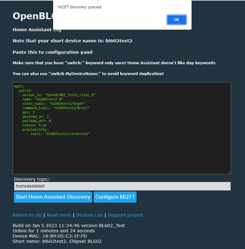

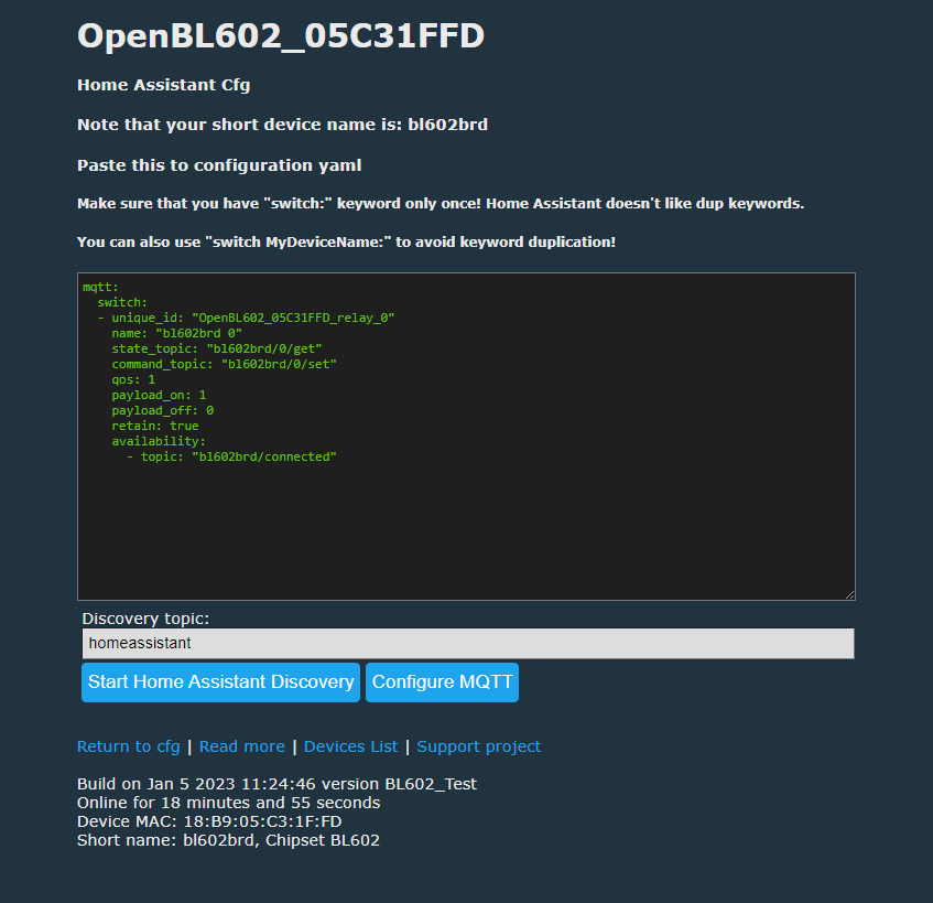

    Hello, sorry for late reply, I saw your post but didn't have time to test it yet.

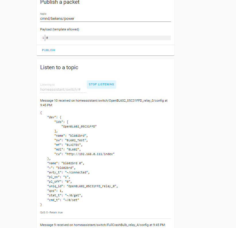

    I have tested it on my dev board:
    BL602 MagicHome LED Controllers: Discovery Issues and Manual YAML Configuration
    According to the UART log from the board, the discovery happens:
    Info:MAIN:g_startPingWatchDogAfter 0, g_bPingWatchDogStarted 1
    Info:DHTDHT start, pin is 4
    Info:DHTDHT timeout waiting for pulse.
    Info:MAIN:Time 1048, idle 0/s, free 101240, MQTT 1(1), bWifi 1, secondsWithNoPig
     -1, socks 2/21
    Info:MQTT:Queued topic=homeassistant/switch/OpenBL602_05C31FFD_relay_0/config, 1
     items in queue
    Info:MQTT:Publishing val (304 bytes) to homeassistant/switch/OpenBL602_05C31FFD_
    relay_0/config retain=1
    Info:MAIN:Time 1049, idle 0/s, free 101240, MQTT 1(1), bWifi 1, secondsWithNoPin
    g -1, socks 2/21
    Info:MAIN:_startPingWatchDogAfter 0, g_bPingWatchDogStarted 1
    Info:MAIN:Forced channel publish! Publishing val 0 to 0
    Info:MQTT:Publishing val 0 to bl602brd/0/get retain=0
    And HA gets reply:

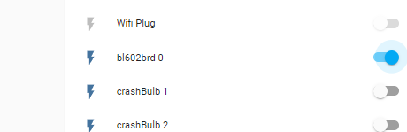

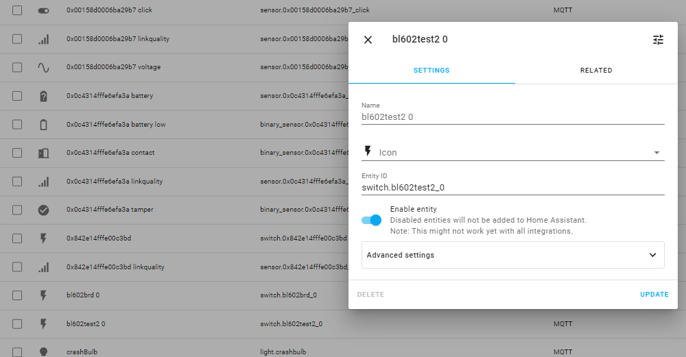

    But... huh, it doesn't appear on the list! You are correct! That's very strange. I will forward it to @iprak , maybe he can tell us more about it.
    Very strange, thank you for reporting!
    Ok, your second issue is related to Home Assistant and not to OpenBeken, so I am not sure if I can provide you support for that, but I will try to figure it out anyway.
    but I have most likely older HA version than you..

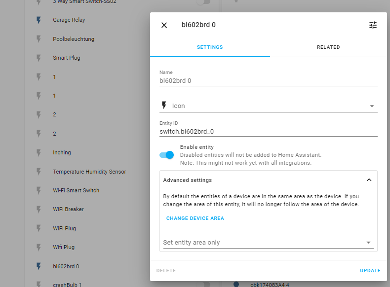

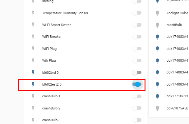

    It appears on HA...

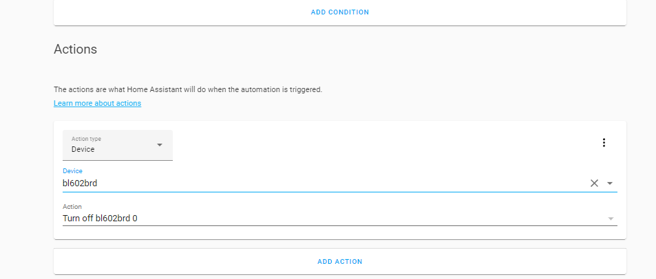

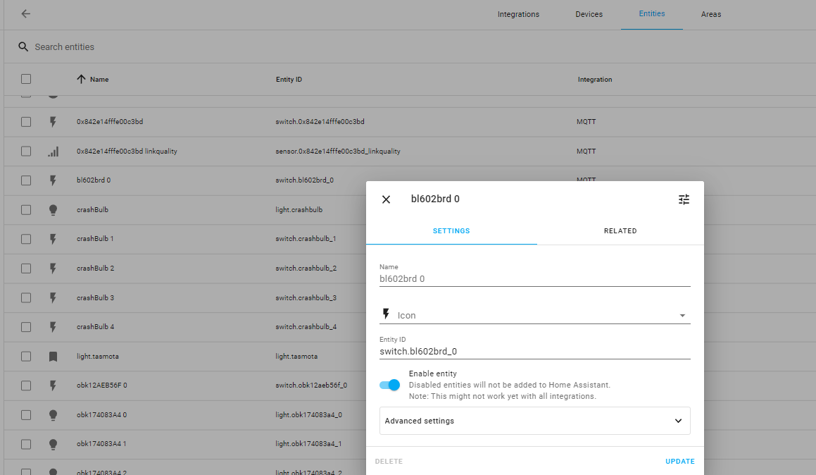

    I have bl602 board easily accessible on automation list:
    Are you saying that it's missing for you?

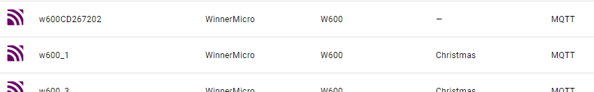

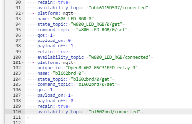

    @leifmjcb since you're saying you don't get entity ID for your device, what do you have here?
    I have it on my entities list, but again, I am using older HA....
    It was added by hand, in Yaml code.
    I also tested again Discovery now and... I was wrong.
    Discovery WORKS on BL602.
    Discovery on BL602 works for me now, the yesterdays test must have been some kind of mistake on my side or a fluke

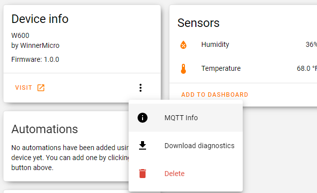

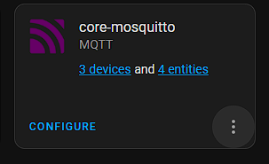

    Another quick and good way to check the overall status would be from the Integrations page.
    Here one can also cross-check the MQTT payload which HomeAssistant received.
    Sometimes HomeAssistant might have received the value but discarded it due to parsing errors. That unfortunately can only be determined by going to HomeAssistant logs (Settings > System > Logs > Load Full Logs) or opening up the logs file in the editor.

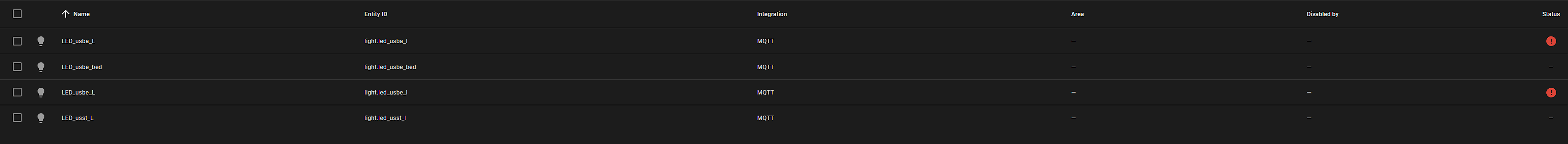

    leifmjcb
    Posts: 7
    @p.kaczmarek2 If i manually add to the YAML yes, i get a correct entity ID, however no connected device for that entity and the entity will not operate.
    With your information & tests i've been able to compare my findings. Please note that my original device (LED-UpstairsBedroom-BedLights_light) can't be powered on at the moment as i've had to move some things around in the bedroom. However it still has the same issues as my other BL602 devices so i will be using another for this example on FW: 1.15.149.
    So after restarting the BL602 I can see it connects to my MQTT broker

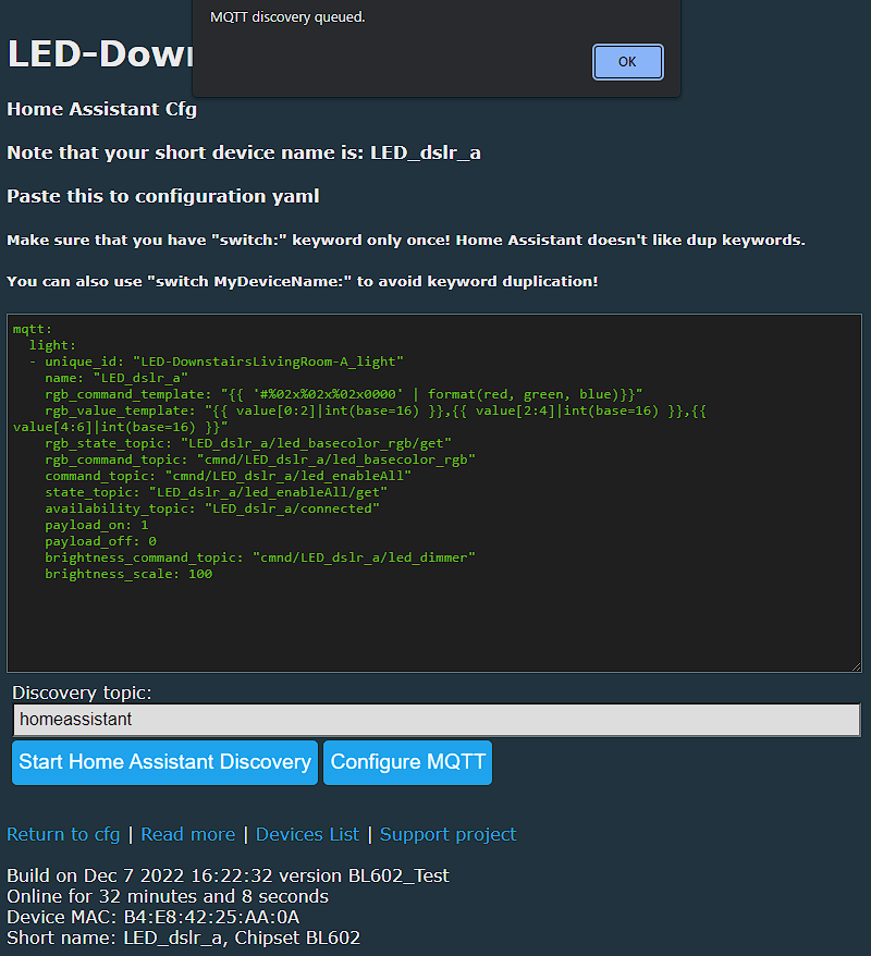

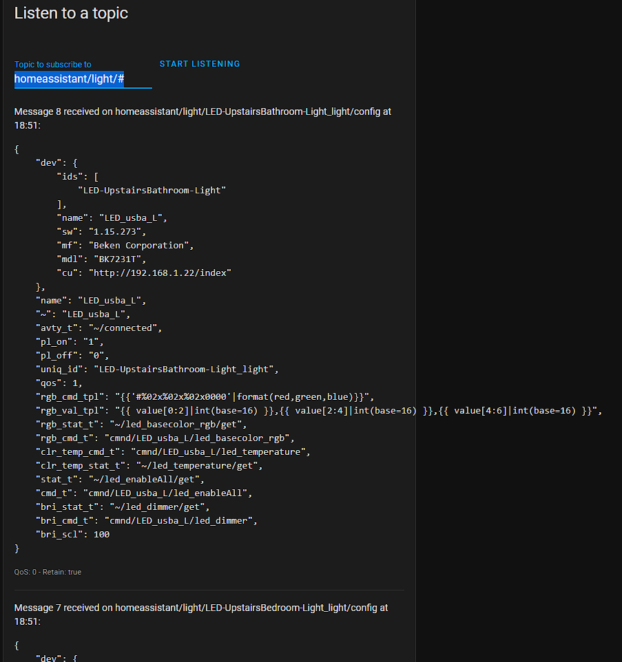

    Then I start HA Discovery

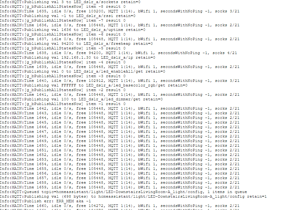

    At the bottom of the SS below I can see it returns an error.
    Publish err: ERR_MEM aka -1

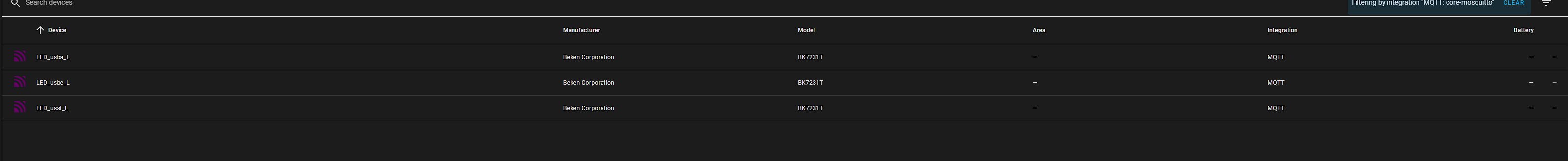

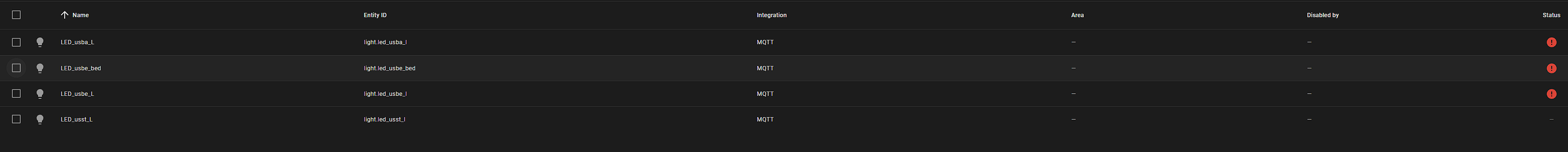

    Listening to the topic only my BK7231T devices are shown
    Checking for devices and entities but none are shown
    BL602 MagicHome LED Controllers: Discovery Issues and Manual YAML Configuration BL602 MagicHome LED Controllers: Discovery Issues and Manual YAML Configuration

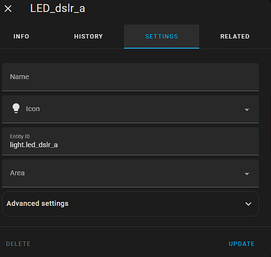

    If I manually add the conf to YAML
    mqtt:
      light:
      - unique_id: "LED-DownstairsLivingRoom-A_light"
        rgb_state_topic: "LED_dslr_a/led_basecolor_rgb/get"
        rgb_command_topic: "cmnd/LED_dslr_a/led_basecolor_rgb"
        command_topic: "cmnd/LED_dslr_a/led_enableAll"
        state_topic: "LED_dslr_a/led_enableAll/get"
        availability_topic: "LED_dslr_a/connected"
        payload_on: "1"
        payload_off: "0"
        brightness_command_topic: "cmnd/LED_dslr_a/led_dimmer"

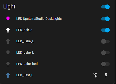

    An entity appears but no device, however the entity is offline and unusable
    I hope this sheds a little more light and information for you and @iprak on the matter, thanks again for your assistance.

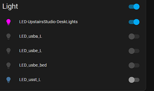

    Added after 3 [minutes]:
    Well i'll be damned, I've actually just seen this appear on my dashboard now and it works! However it doesn't have an associated device unlike my BK7231T Devices. Is this expected?

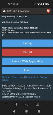

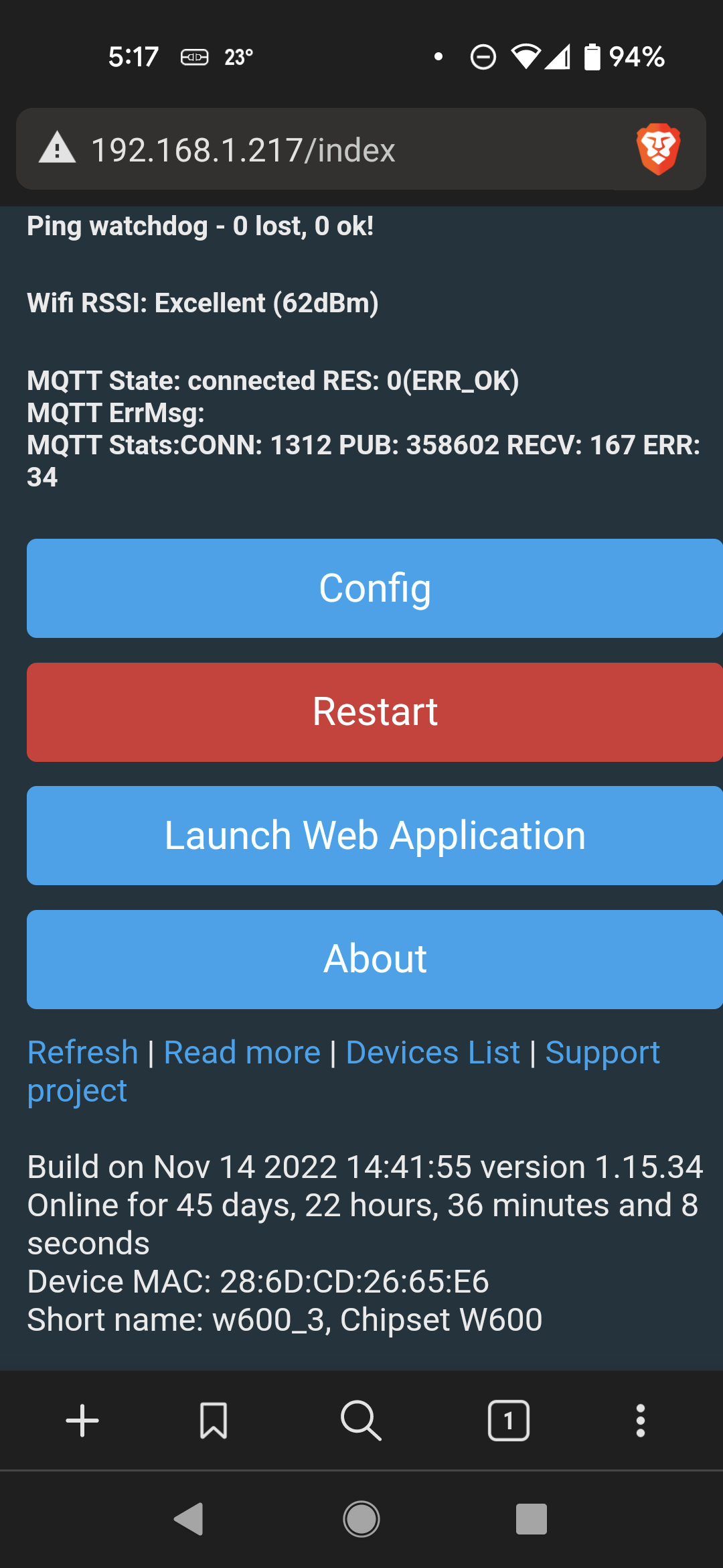

  • MQTT publish ERR_MEM suggests buffer or threading issue
    #13 20372089
    Posts: 14728

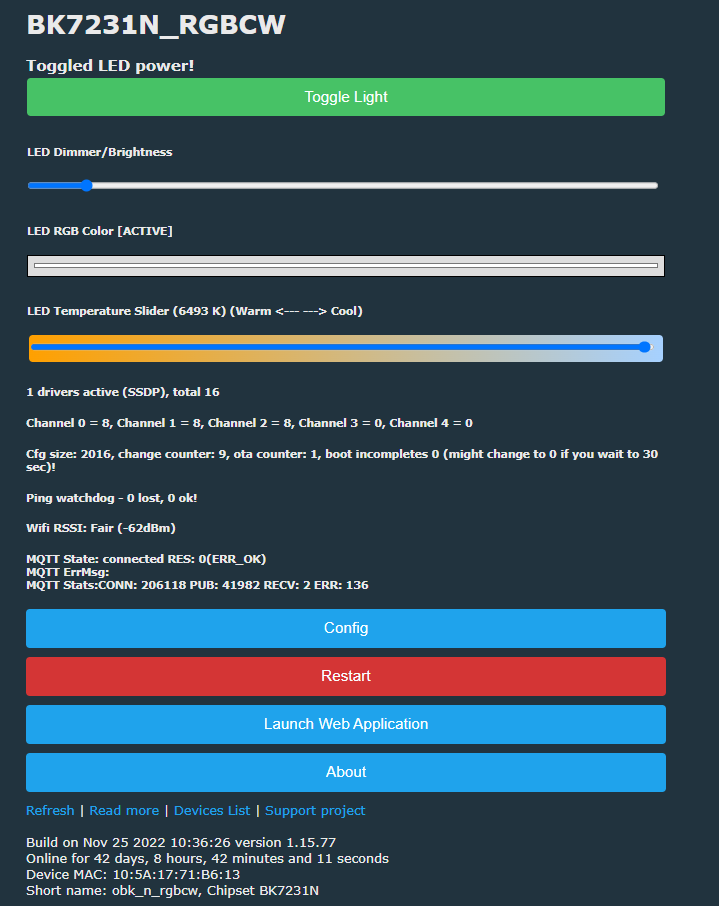

    Rate: 12814
    This might mean that we need to increase MQTT buffers for BL602 platform, but it also may mean that there is a threading issue (like the one in the past with N, but in that case, @valeklubomir and @btsimonh did GREAT WORK solving it and now BK7231 is super-stable, see picture below):
    Emphasis in case you missed:
    Build on Nov 25 2022 10:36:26 version 1.15.77
    Online for 42 days, 8 hours, 42 minutes and 28 seconds
    @p.kaczmarek2 I see so I am experiencing something different than others? I wonder why.
    Especially since this problem is repeated on 6 devices and through different firmware.

    @p.kaczmarek2 Just as an FYI.
    I noticed the HA conf on the BL602 configuration page returns an error (at least in my version of HA)
    I found the correction was just adding quotation marks to the payload values:
        payload_on: "1"
        payload_off: "0"
    45 days here but it is just a switch.
