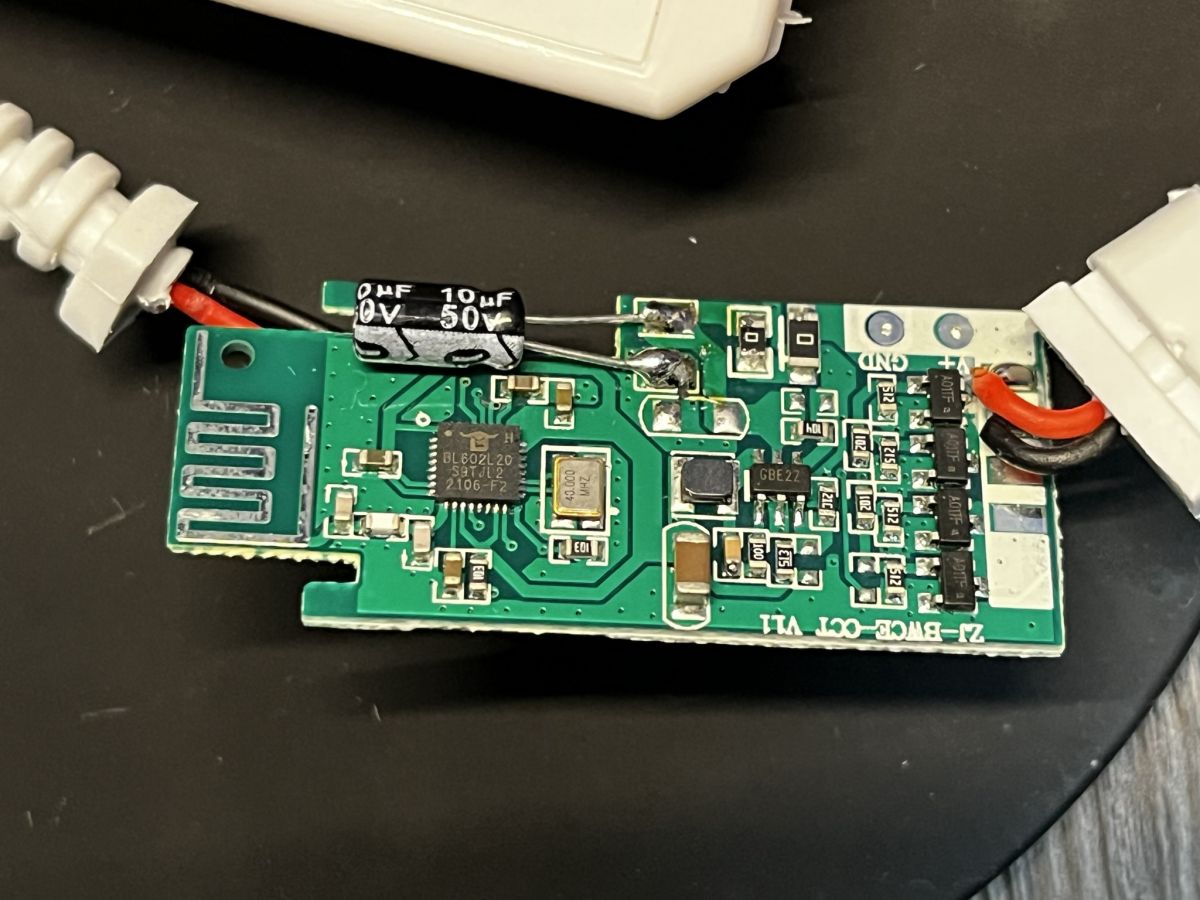

  • Since I didn't find any tutorials related to the Magic Home single-color LED controller I used this post as a starter/reference guide.
    Guide: Control MagicHome Single Color LED WiFi Controller with BL602 & HomeAssistant
    The main focus was only on controlling the LED PWM signal using HomeAssistant . As the first step, the device was disassembled, revealing the BL602 controller and the UART pins (RX, TX).
    With the wires soldered to the pin pad, an FTDI FT-232RL was used to connect the soldered pins as the diagram below (remember to setup the FTDI device or any serial converter to 3v3 voltage as the BL602 uses that voltage on its pins). The BOOT pin was connected to GND in series with a 10K resistor, enabling the bootloader flash mode.

    Then, the device needs to be powered using the 5V-24V power supply (probably the same that you will use to power your LEDs. Note the positive and negative connectors, avoiding plugging them in reverse).

    Now it is time to set up the GPIO to control the LEDs. Go to "Config" -> "Configure Module" then use the P20 as a PWM signal and save the settings
    Return to the index page/main menu and your LED device should now be working. Toggle on and off the light, adjust the brightness and test the device.
