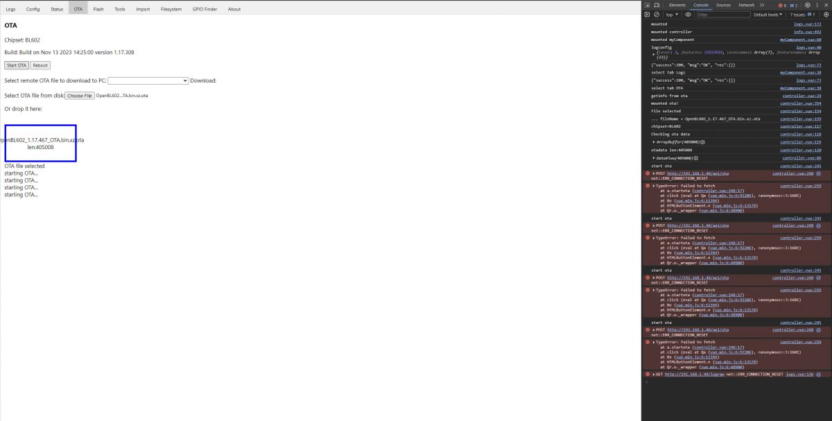

    Hello, I have several Magic Home LED controllers flashed with Open Beken. I'm trying to flash the BL602 OTA file using the web app but I get stuck with a status of "starting OTA". I've tried a couple of web browsers with no improvement. They're currently on version 1.17.308. Any help would be great. UART flashing these sounds like a pain considering how many I have around the house. Thanks!

  • Browser console still shows OTA errors
    #13 20968856
    hubiverse
    Posts: 11
    Screenshot of an OTA interface and developer console with errors. Oh! You mean the dev console for the web browser itself, sorry I thought there was a console on the web app somewhere I was missing lol. Unfortunately, it doesn't seem to have improved. I've tried several times, but I receive an error on each attempt. I'm not experiencing any freezing, though. I'll attach a screenshot of my last attempt. Maybe it'll be useful.
  • #14 20968862
    miegapele
    Posts: 173
    Help: 15
    Rate: 29
    Okay, I also did not experience that. Unfortunately cannot think of anything else to try

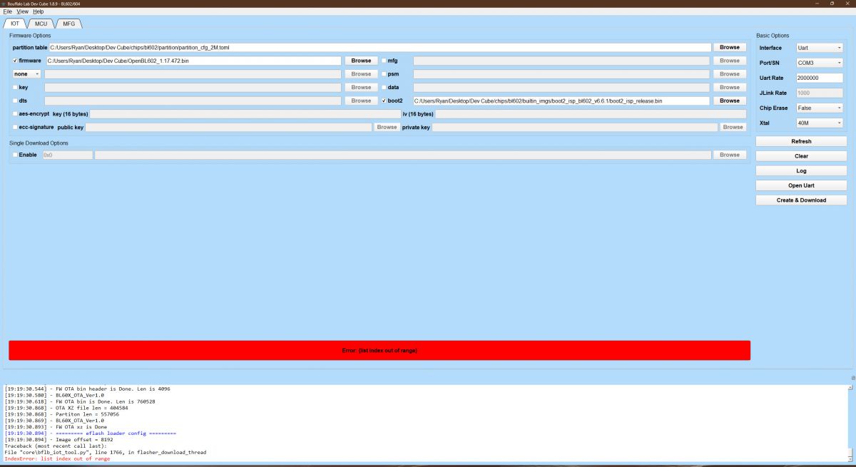

  • #15 20969616
    hubiverse
    Posts: 11
    Any ideas as to why dev cube is giving me this error?
    Screenshot of a microcontroller programming tool with an error message list index out of range.
  • #16 20969643
    miegapele
    Posts: 173
    Help: 15
    Rate: 29
    People have trouble with 1.8. try flashing with 1.4.8 it's in openbl602 SDK repo.
    Added after 1 [hours] 18 [minutes]:
    Also that log is very strange. It says something about the OTA. Did you pick correct image?.
    You also do not have dts specified in this flasher. I think that will make Mac address all zeros.

    Posts: 14756
    Rate: 12881
    What does the DTS stands for there?
  • DTS defines device config and MAC source
    #18 20969794
    miegapele
    Posts: 173
    Help: 15
    Rate: 29
    DTS is device tree source. It's coming from Linux and specifies device config. But it's also used in some microcontrollers. I see in that file various defaults, including where to get device MAC from.
    Also, if I remember correctly, partition layout is different onq1.8 so flashing with that will probably remove existing settings
    Added after 33 [minutes]:
    Some more information here: https://lupyuen.github.io/articles/flash#device-tree
  • #19 20971227
    hubiverse
    Posts: 11
    1.4.8 BL Dev Cube ended up working well for me. Thanks for your help. I'll see if OTA works again once a new version is released
