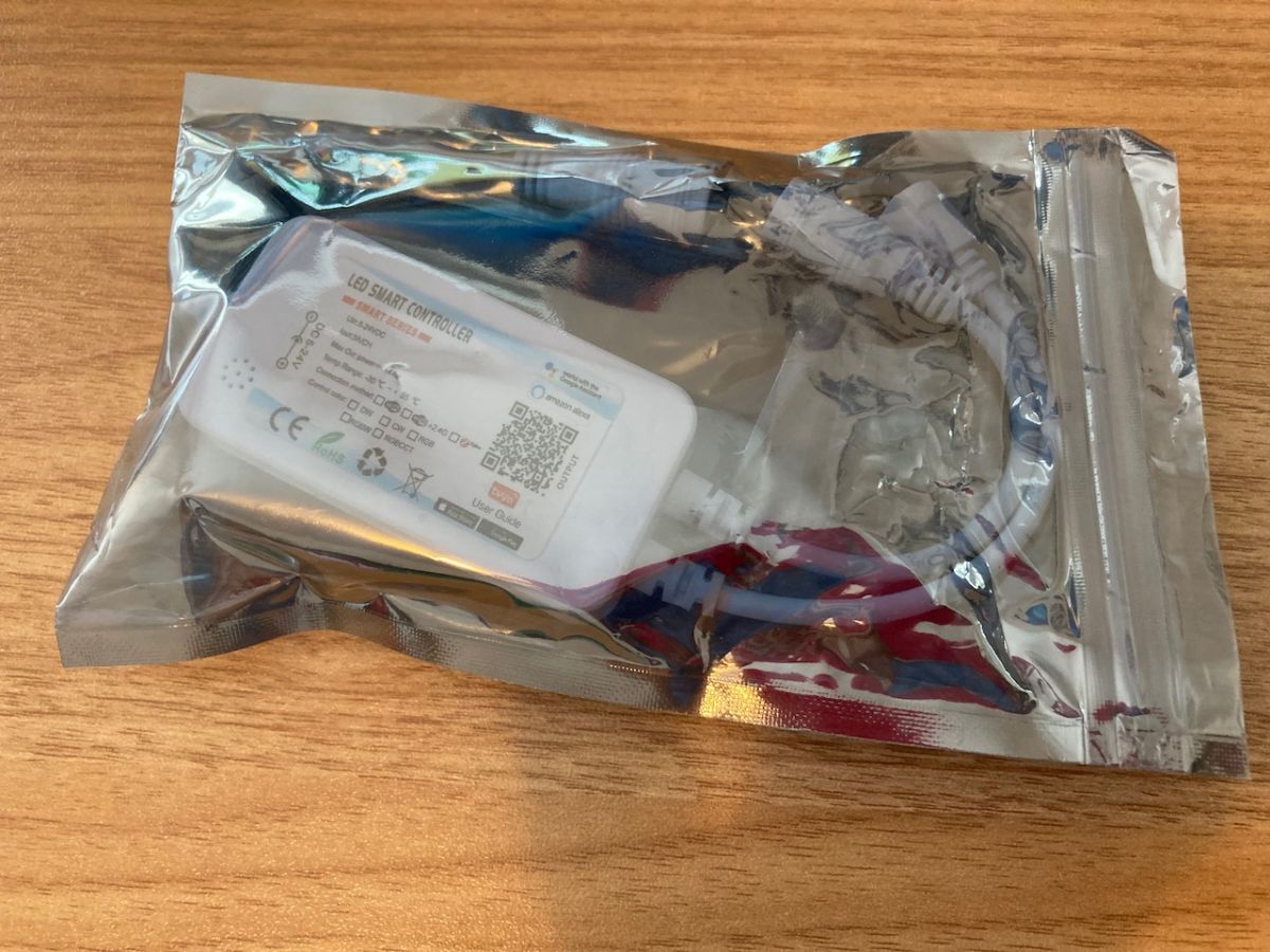

    This is a $7 LED controller that I got from aliexpress.
    Tuya WIFI LED controller set with remote control for single color LED strips, including cables, connectors, and a remote with large buttons. LED controller in a ziplock plastic bag on a wooden surface. White LED controller with two cables and technical label lying on a wooden surface.

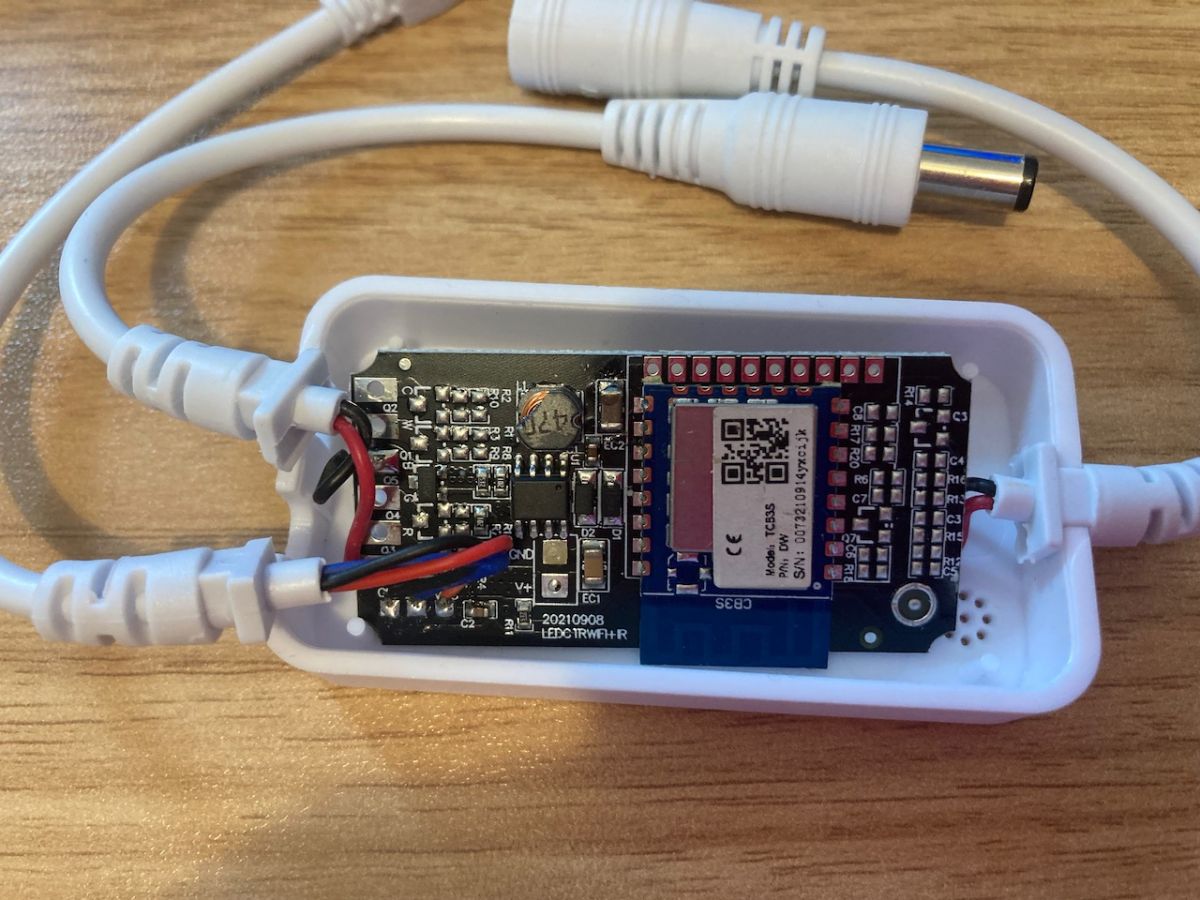

    Opening it up revealed that it uses a CB3S/BK7231N module.
    LED controller with CB3S/BK7231N module in an open plastic case, visible PCB and wires. A black LED controller circuit board with connected wires, placed on a wooden surface.

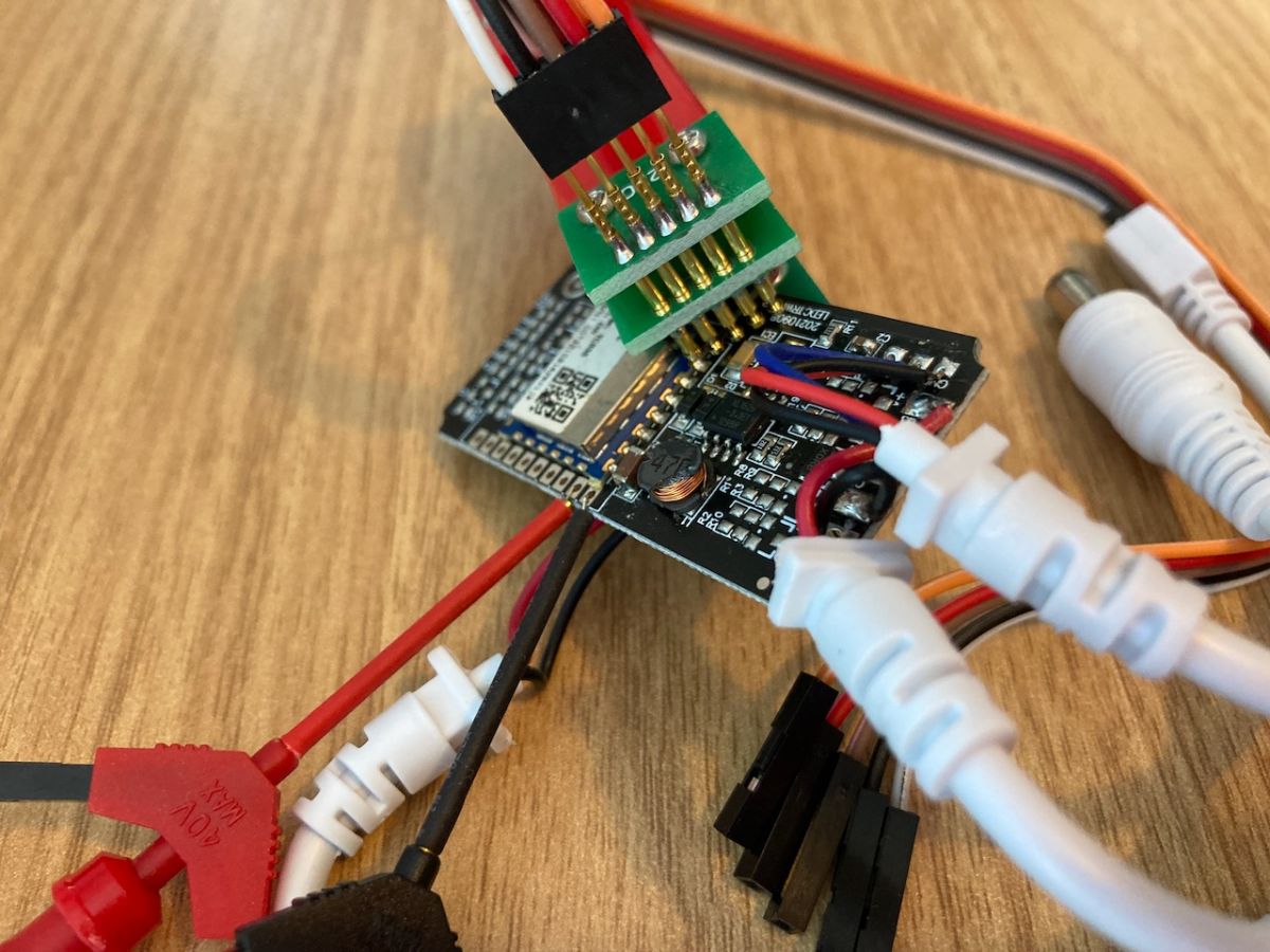

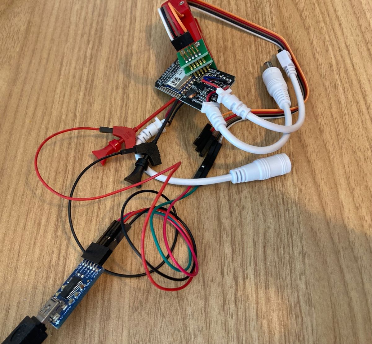

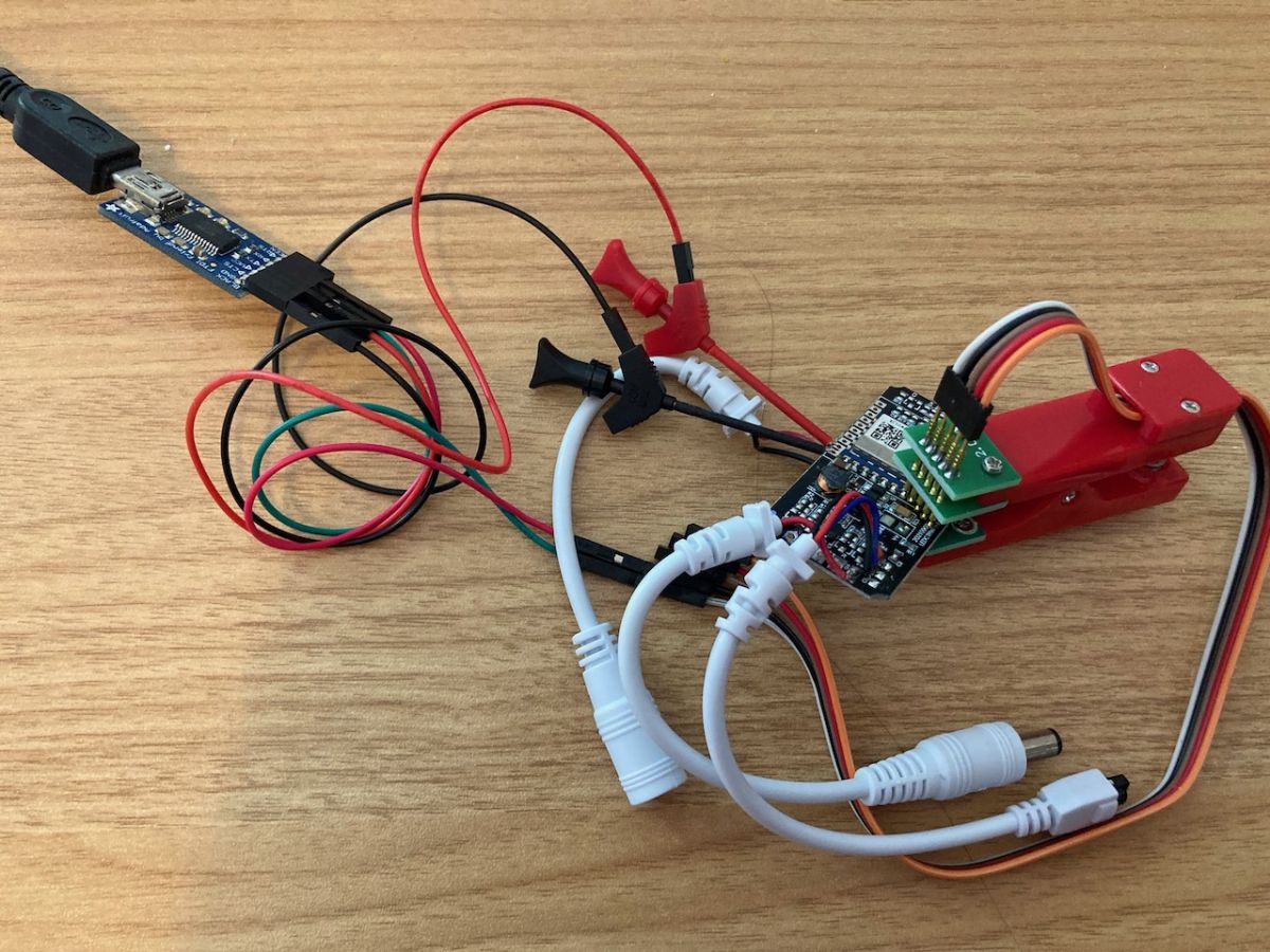

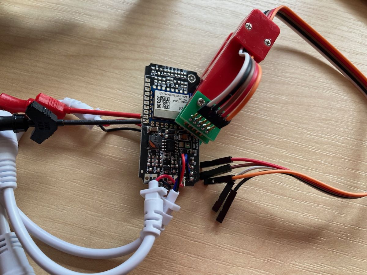

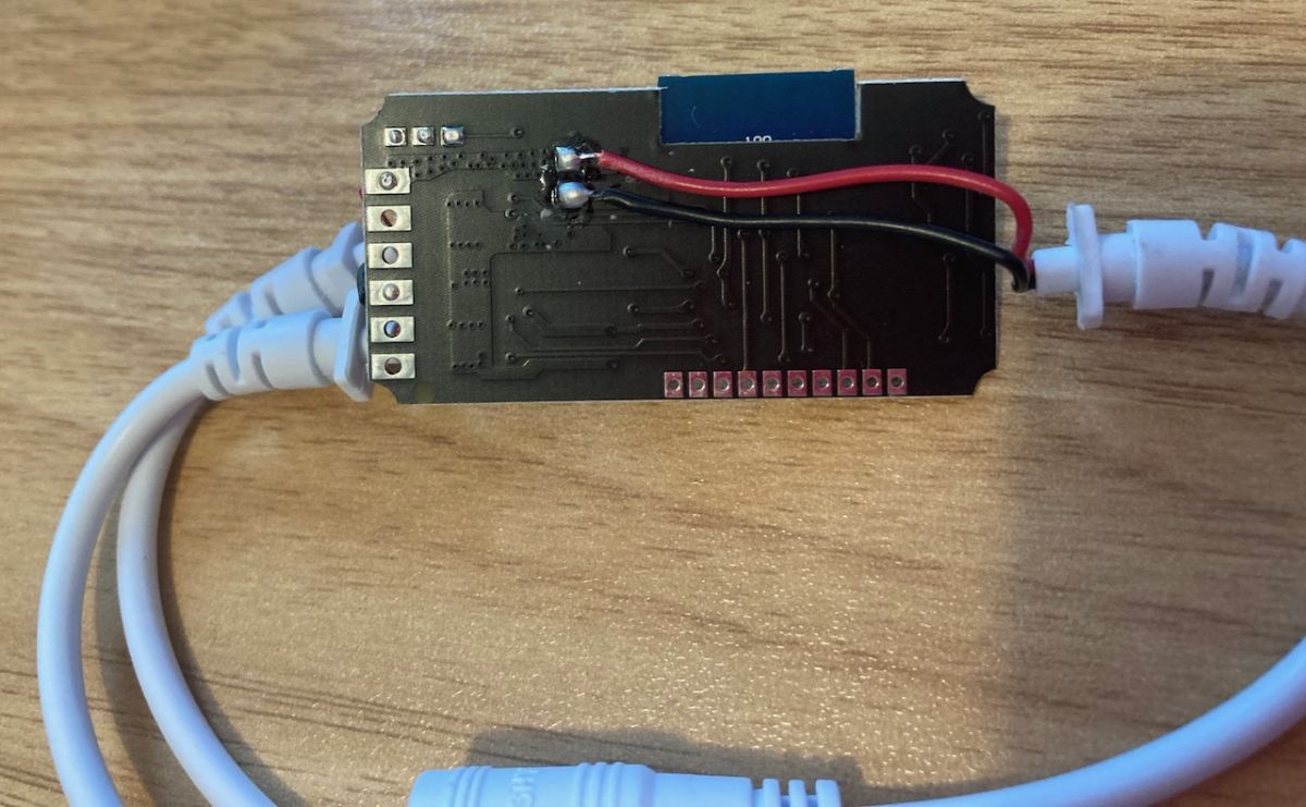

    As I was not in the mood to try desoldering the module, or to solder additional attachments to the board, I checked if the TX/RX pins are available on the debug pins to the side. This sadly was not the case - only VCC and GND were broken out there. However, it turns out that I have a pogo mini clamp laying around that kind of fit on the rx/tx pins of the CB3S - and I used some probe clips to attach to GND/VCC.
    LED controller board with connected wires, pogo pin adapter, and measurement probes attached. Programming a LED controller using probe clips and wires on a wooden surface. CB3S/BK7231N module with attached debugging wires and pogo connector, placed on a wooden surface. LED controller board with attached wires and probe clips, lying on a wooden surface.
    Even though this looks a bit adventurous - this approach worked fine, and flashing worked without any problems.
    If you want to replicate this - the black probe clip (rightmost debug connector) is GND, the red one next to it is VCC (3.3V). Only the two left probe clips are used; they attach to pin 15 (RXD) and 16 (TXD) of the CB3S; 16 is the pin closest to the antenna.
    After flashing, PIN 26 is the PWM pin for the LED strip. I did not yet try the remote (I don't really need it for my current use-case).
