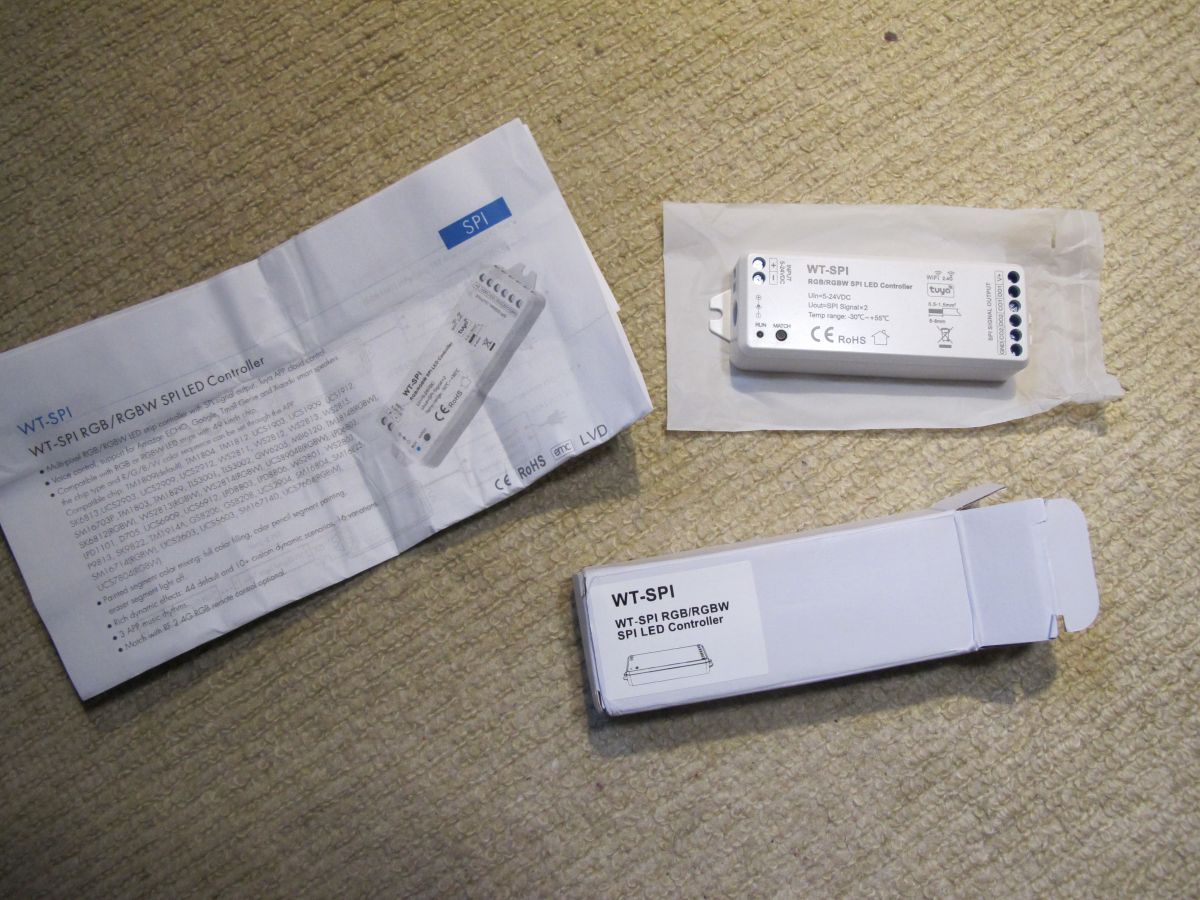

    I have another device to play with!

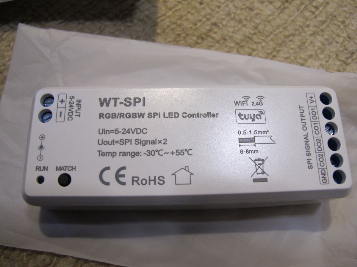

    This is Tuya SPI LED controller with up to 4 data lines (LED strip controller depending) supporting up to 1000 LEDs @ 8 amps. Its model is WT-SPI and a quick Google shows a few vendors for it.
    https://www.aliexpress.com/item/1005005335498067.html
    Tuya SPI LED controller WT-SPI with technical description and price on AliExpress.
    The product manual is quite good and is also available as a PDF, which I attach. The number of supported LED controller types seems quite extensive

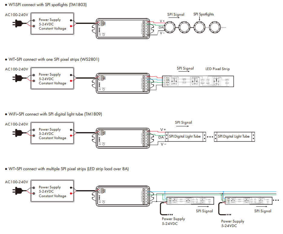

    Connection diagram of the Tuya SPI LED controller to various types of LED strips.

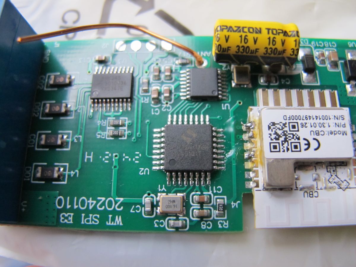

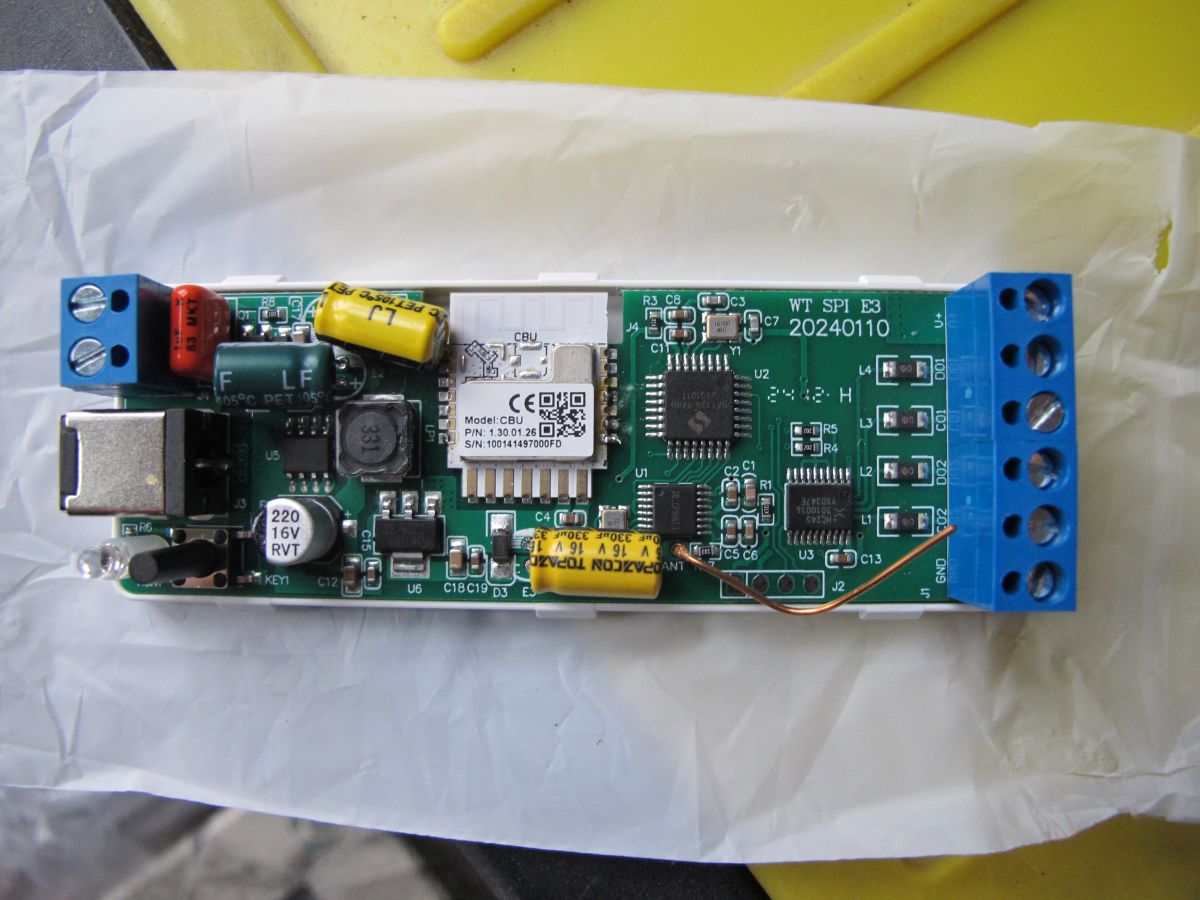

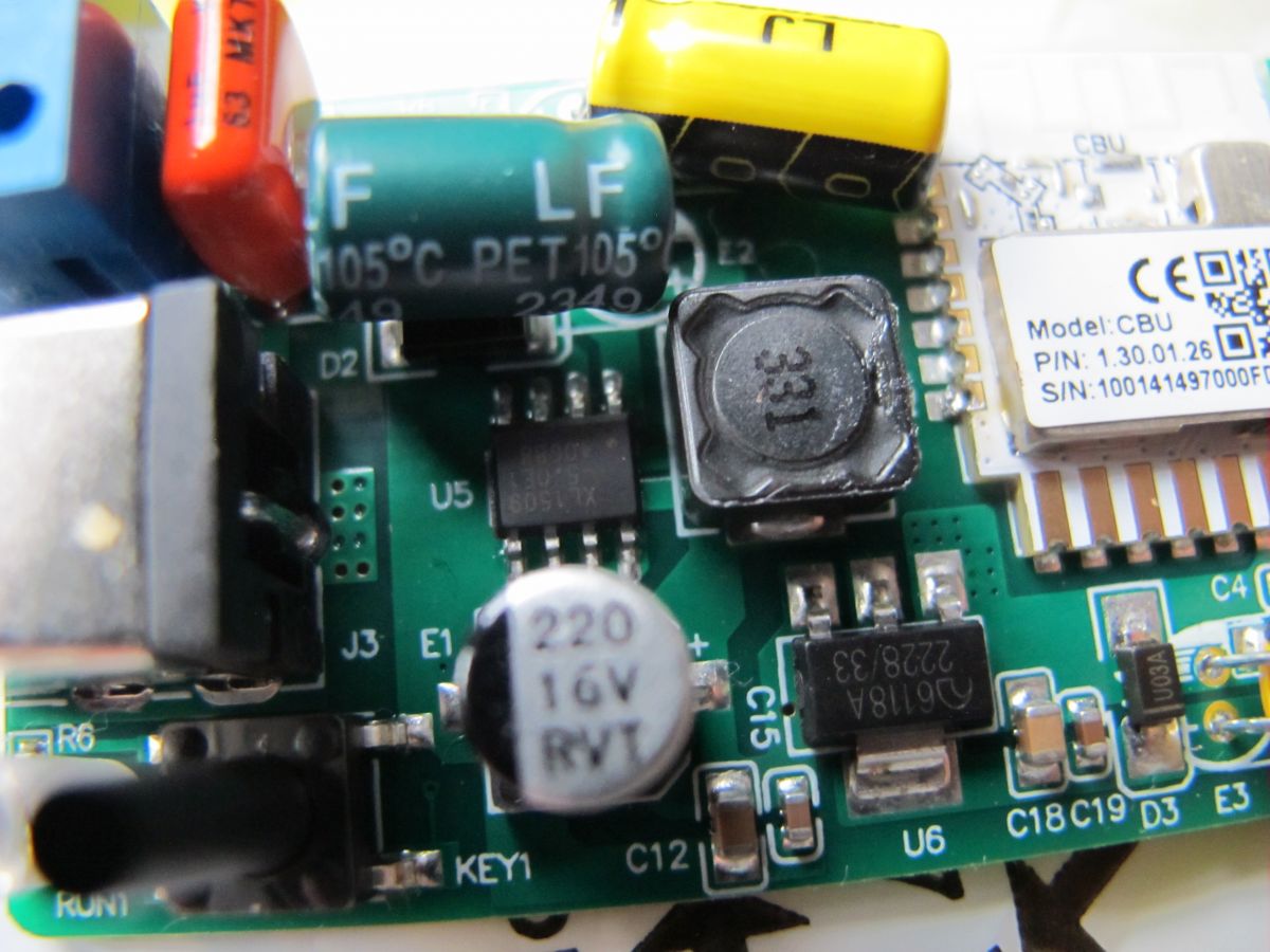

    Despite having a CBU/BK7231N module the device also comes with an MCU. The accepted input voltage is 5-24v with barrel or bare-wire connector options. With my 12V DC barrel adaptor the output is 12v, so natively good for LED strips that require 12v, like WS2811.

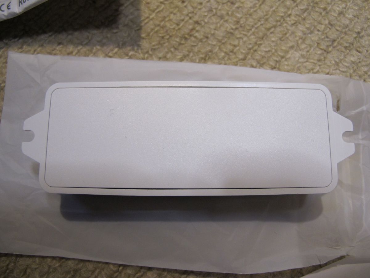

    White Tuya SPI LED controller on a light background. Tuya WT-SPI LED controller with visible ports and labels. WT-SPI RGB/RGBW controller with manual and box.
    Close-up of a circuit board with CBU module, buttons, and capacitors. Close-up of a printed circuit board with electronic components of a Tuya SPI LED controller. Close-up of a circuit board with electronic components Close-up of a printed circuit board with visible integrated circuits and wire connections. Close-up of a circuit board with integrated circuits and a Topazcon 16V capacitor. Close-up view of the underside of a circuit board with a removed copper trace. Bottom view of a green printed circuit board with solder marks. Tuya SPI LED controller WT-SPI with visible components and connectors

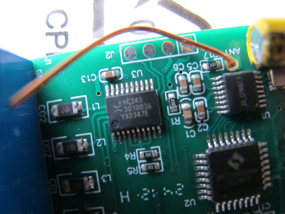

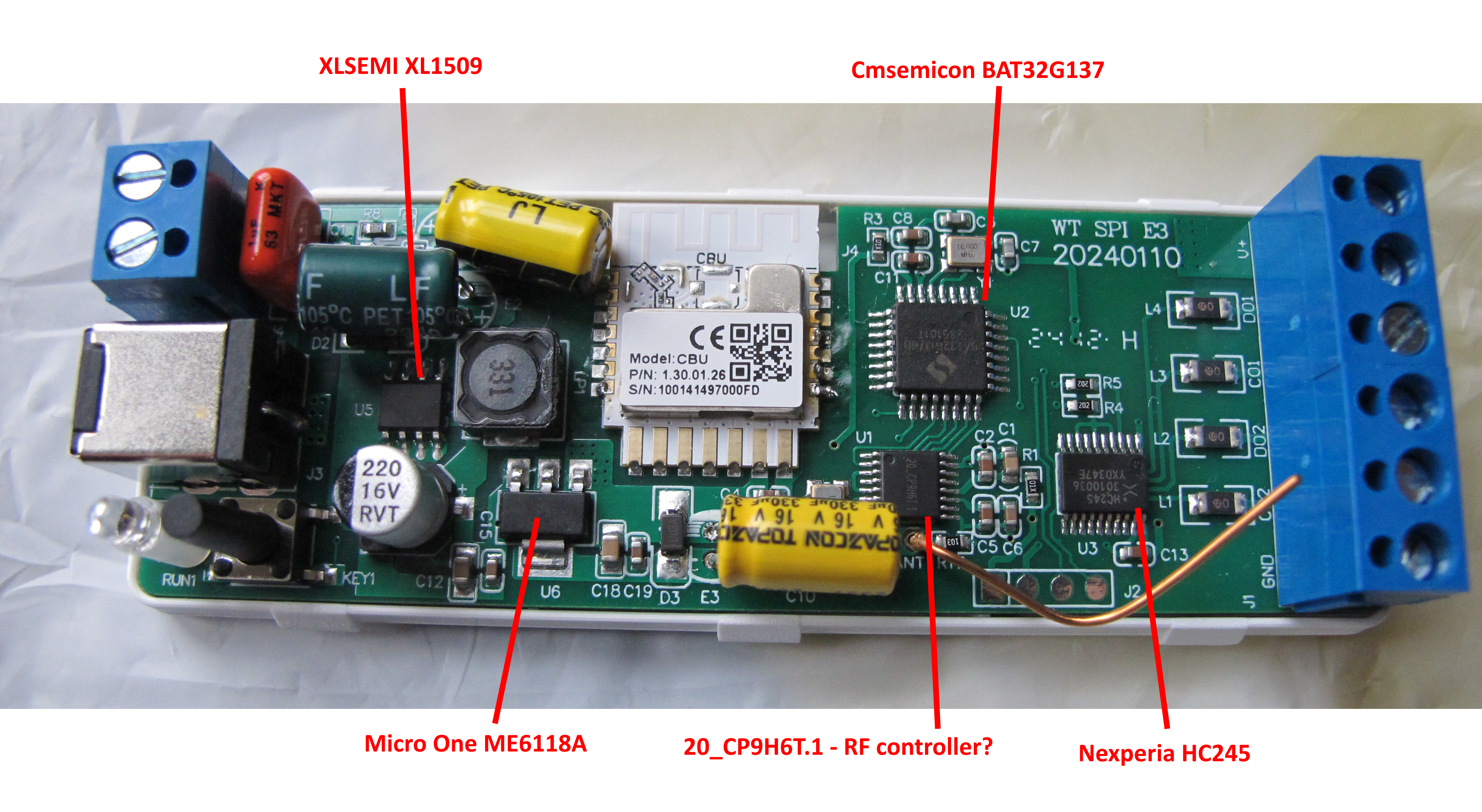

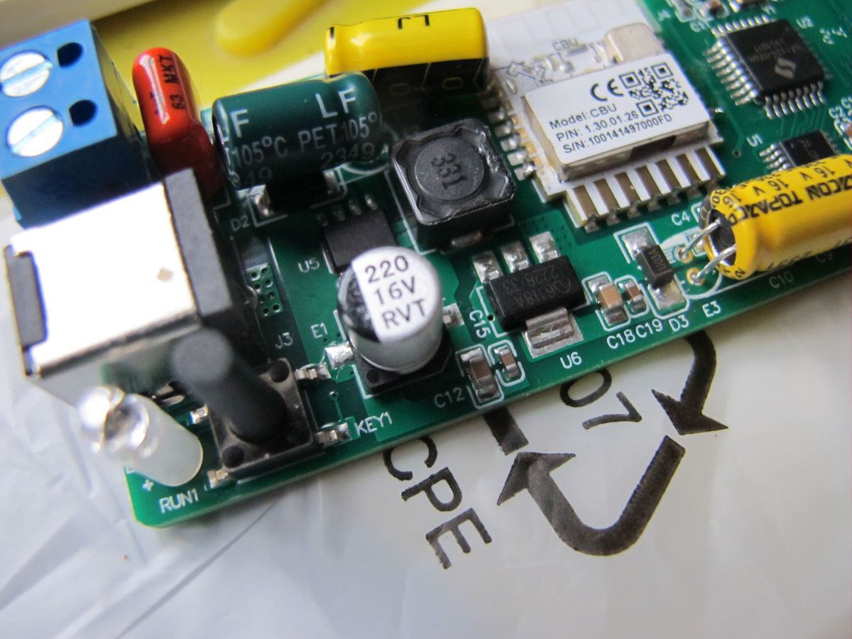

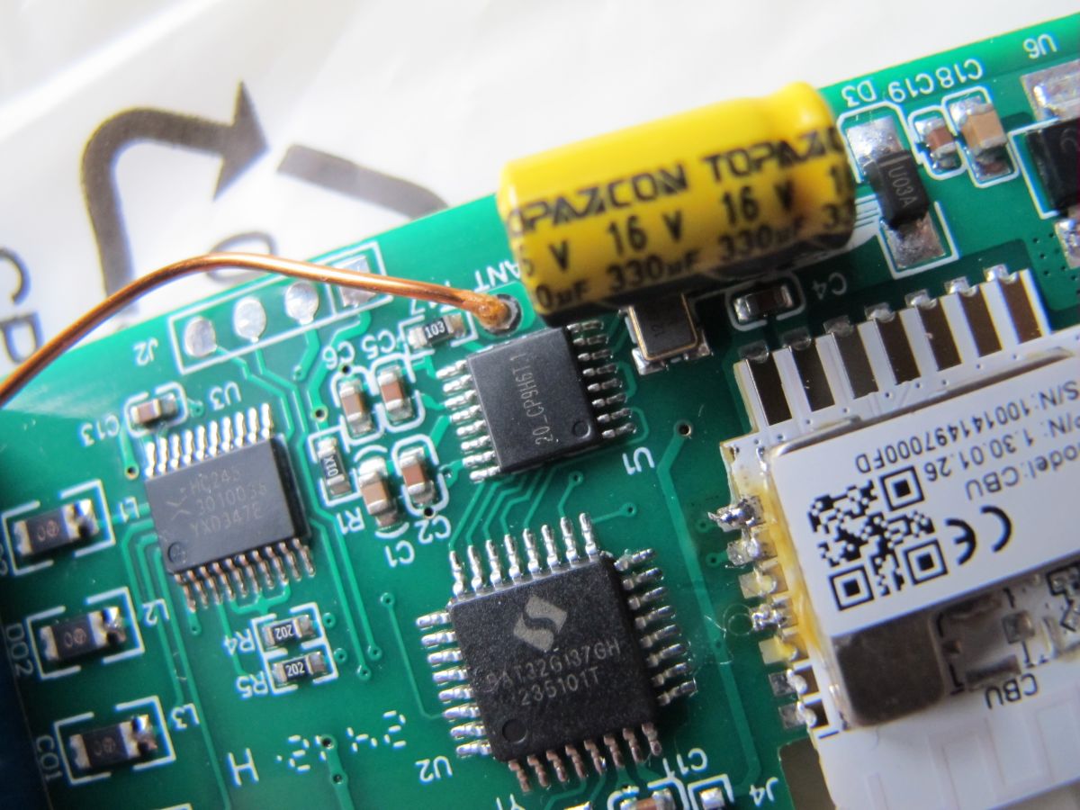

    I think I have identified these components correctly
    Image of Tuya SPI LED controller with marked components on the board.
    Along with their respective product pages:
    https://www.xlsemi.com/datasheet/XL1509-EN.pdf
    http://www.microne.com.cn/en/product/246.html
    https://www.mcu.com.cn/en/Products/112
    https://www.nexperia.com/products/analog-logi...ers/transceivers/series/74HC245-74HCT245.html

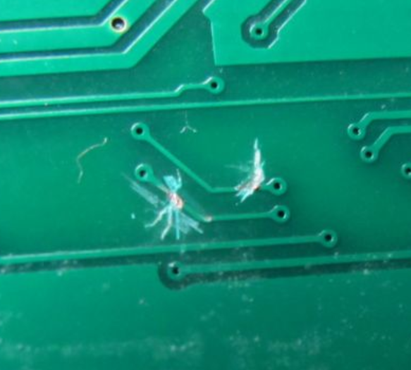

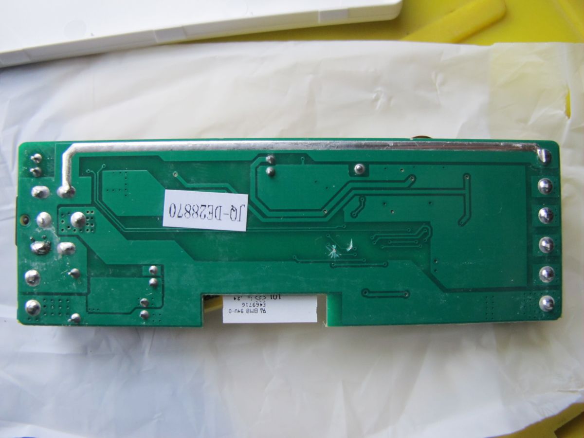

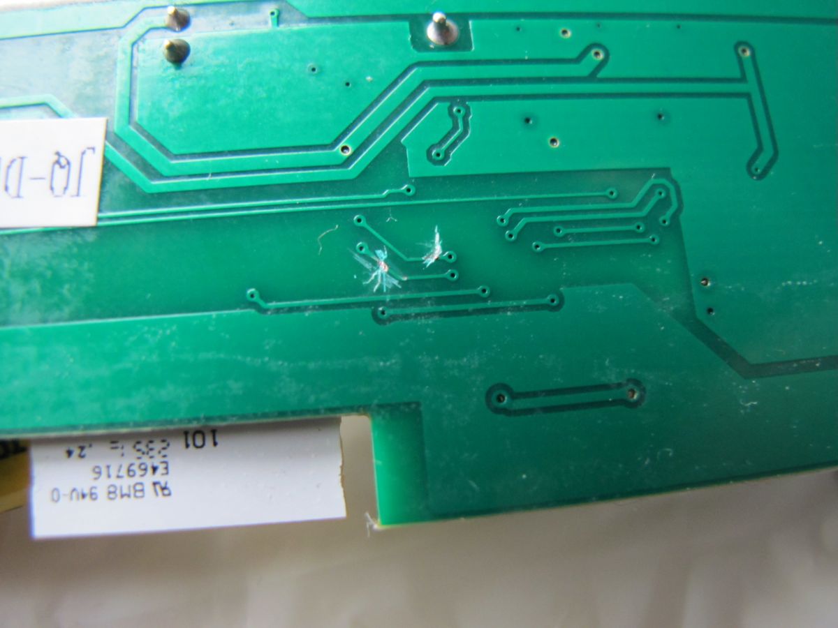

    Because the MCU is connected to the CBU using RX and TX communication at 115200 baud, I was not able to take a dump of the CBU firmware without severing the TX trace to the MCU. Unfortunately I severed the RX too, I think I've usually only needed to do one before. No matter, it can be repaired.
    Damaged traces on a printed circuit board.
    And with the MCU out of the way I can take a backup, attached. Also, boot log:

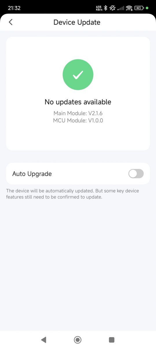

    Being v2.1.6 it is not patched and so Cloudcutter can be used to flash to Openbeken. My next steps are to repair the RX/TX and begin MCU communication capture using TuyaMCU Analyser. I have not been able to get a full API response from Tuya for this device so I'll have to use tuyaMcu_sendQueryState as explained here https://www.elektroda.com/rtvforum/topic4049908.html

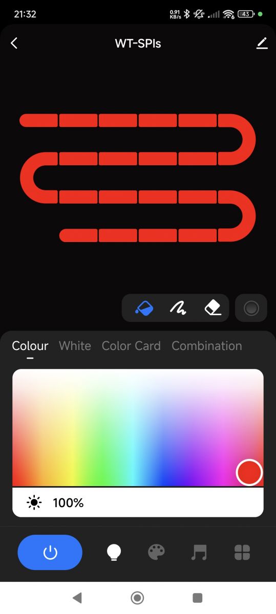

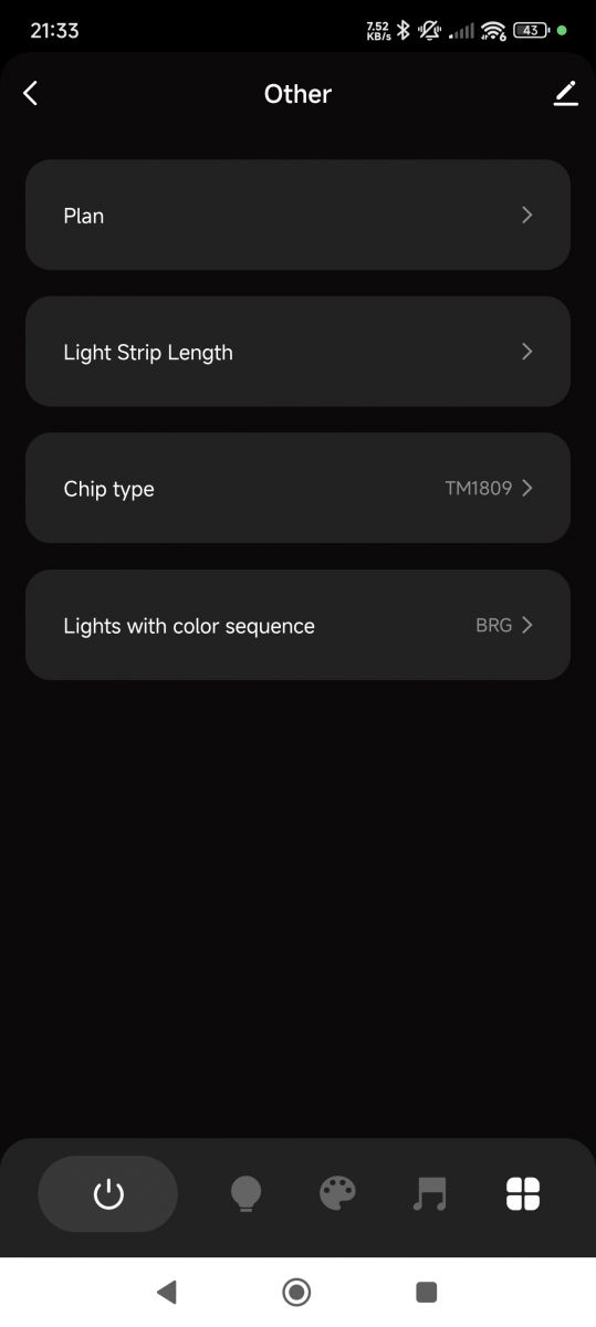

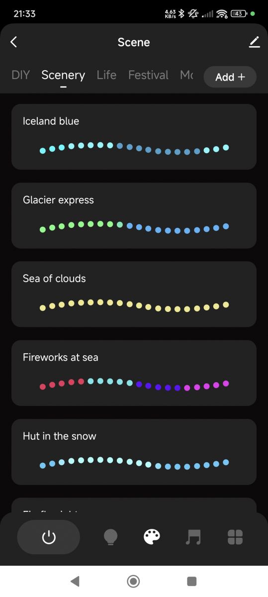

    I am curious to find out if the MOSI pin on the CBU is doing anything. Is the MCU doing everything and does it contain the full program of supported LED controller types and animation seen in the Tuya app? If so, can all these things be set by MCU command alone from within Openbeken? If so, it could mean a long autoexec and many GUI options to set in OBK. Sadly that would mean no OBK PixelAnim opportunities I fear.
    Tuya app interface for the WT-SPI LED controller with a red color setting for the LED strip. Tuya LED controller app screen displaying various light effects. LED controller settings menu in the app. Chip type selection screen in the app. Device update screen in the app showing no updates available for modules V2.1.6 and V1.0.0.

  • Chip type selection and animation mirroring concerns
    #3 21149178
    Posts: 5213
    Help: 446
    Rate: 914

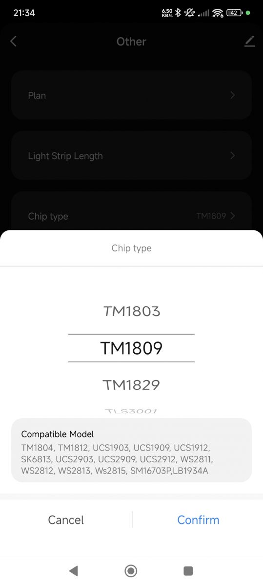

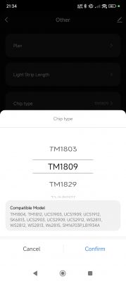

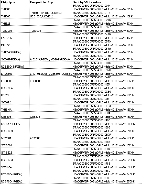

    hmm. and this is just the chip type selection
    Table showing chip types, their compatible chips, and WiFi module commands.
    Added after 10 [hours] 3 [minutes]:
    not sure I have the energy for getting every function mirrored in OBK, if that's even possible. The LED strip length calculation and free-style colour picker could be interesting to work out. :/
    half the predefined animations:
    Screenshot of a list of predefined LED animations with codes and names.

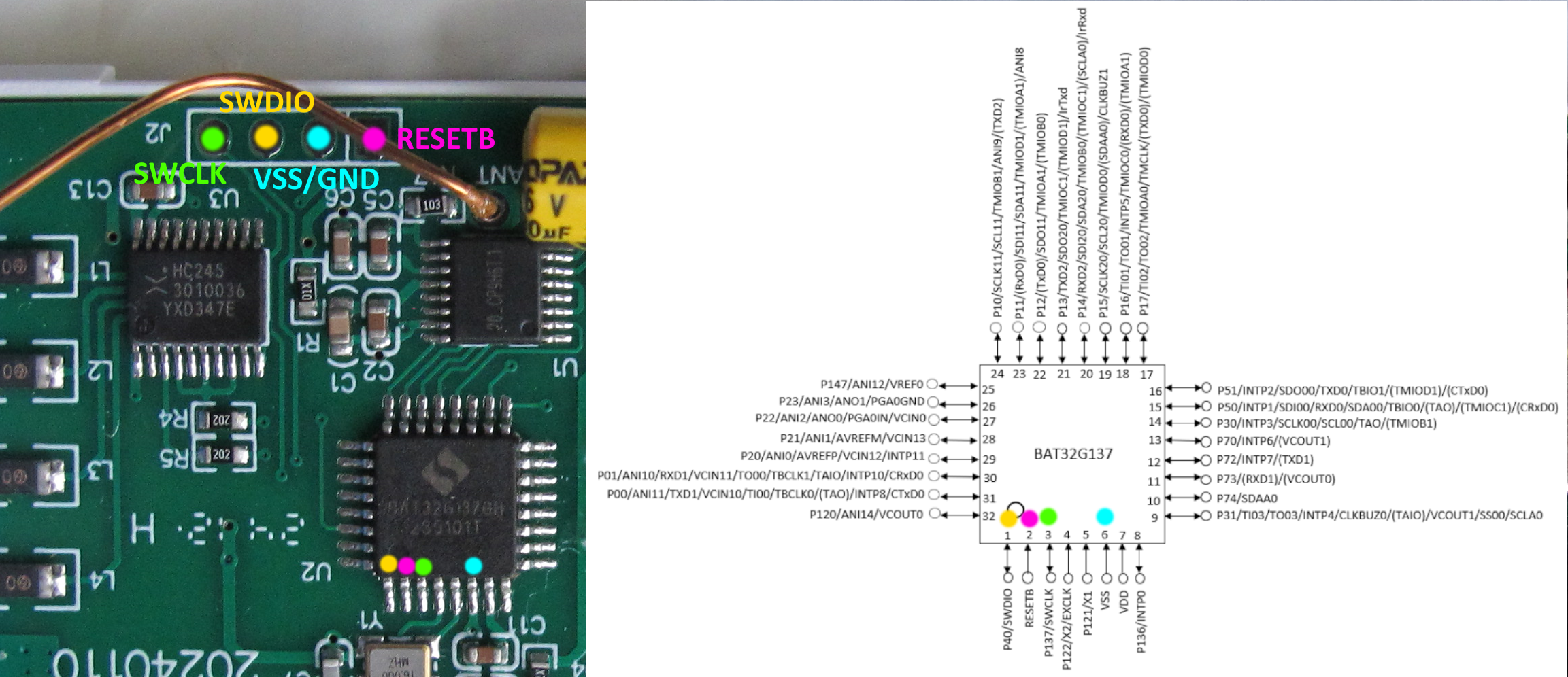

    The test pads on the PCB trace to these legs of the Cmsemicon 32-pin package BAT32G137GH32FP. I hoped they would include SWDIO and SWCLK so there's potential to dump the MCU flash using Jlink.
    Printed circuit board with labeled test points for SWDIO, SWCLK, VSS/GND, RESETB, and a pinout diagram for the 32-pin BAT32G137GH32FP package.
    and I probably didn't need to cut the RX/TX on the underside as the reset pad pulled to ground could disable the MCU, freeing access to the CBU.

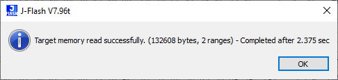

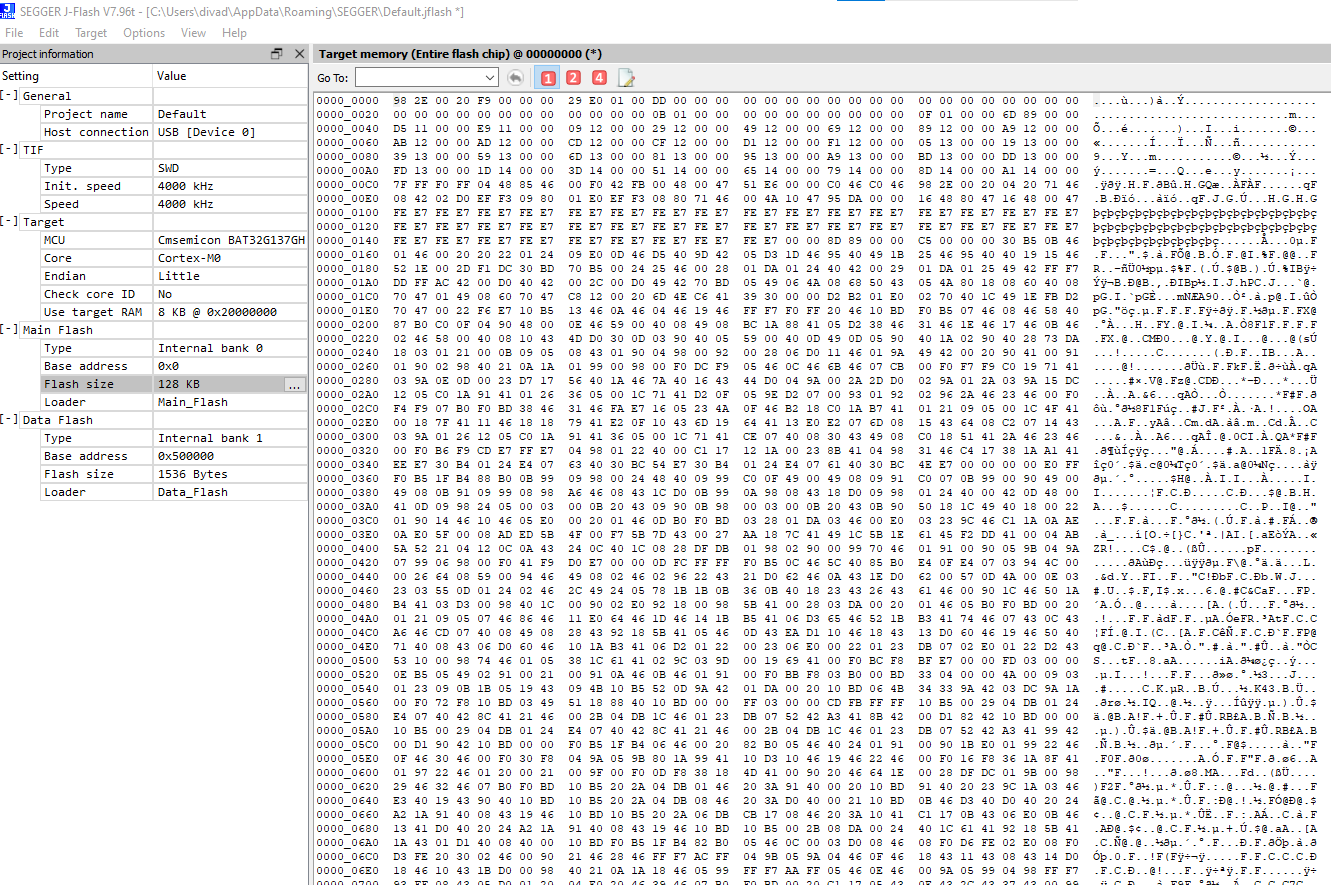

    with SWDIO and SWCLK connected to a J-Link SWD USB device and this custom device added to C:\Program Files\SEGGER\JLink_V796t\JLinkDevices.xml we can choose the correct MCU from the target device list. The FLM file for BAT32G137GH can be downloaded from https://www.mcu.com.cn/en/Products/112/pids/8
    Screenshot showing the CMS.BAT32G137.pack file, version 3.0.8, labeled as BAT32G137 Pack.
    unzipped. file placed in C:\Program Files\SEGGER\JLink_V796t\JLinkDevices\Cmsemicon\BAT32G137GH.FLM
    SEGGER J-Flash software interface with selected configuration for MCU Cmsemicon BAT32G137GH.
    connected OK and entire chip read, seemingly successfully. 0x00000000 - 0x0001FFF. Attached.
    Not sure what use this is, looks like gibberish. encrypted?
    J-Flash message indicating successful memory read.
    Screenshot of SEGGER J-Flash program with a memory view of the chip.
    • BAT32G137_mcu_fw.zip (57.83 KB) You must be logged in to download this attachment.
