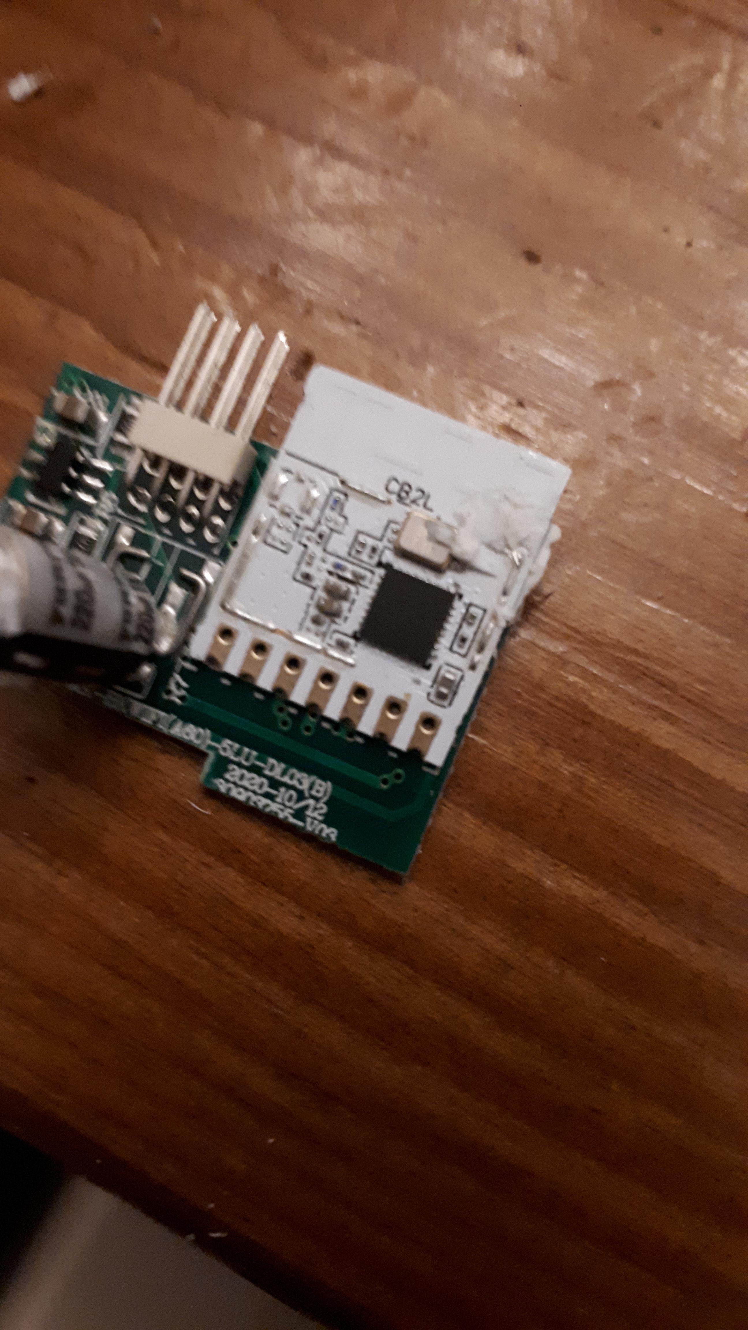

    hi,
    last week I bought 2 smart lightbulbs homeylux A60 10W 806lm RGB CTWW
    after a teardown I discovered there is no ESP module in it, but a beken CB2L BK7231N wifi bluetooth module, see picture
    CB2L homeylux E27 A60 RGBCTWW 10W 806lm OTA flashing not successful
    it works with the hoftronic app( qr code on the box of the bulb ) and the standard Tuya app on my phone.
    firmware 1.3.1 / MCU 1.3.1 is what I discovered in the Tuya app
    on the PCB where the CB2L is soldered on is a BP1633. for the BP1633 I can not find a datasheet. someone has it?
    I can place it in bluetooth pairing (fast blinking) and WIFI AP pairing mode( slow blinking
    it is vulnerable for the exploit, but I can not flash it over the air as the firmware version is not in the list of cloudcutter firmware list.
    I like to flash the CB2L module as I want it to get it off the cloud. I like to flash openbeken firmware in the bulb

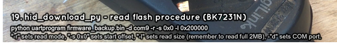

    You can do a 2MB flash dump that way:

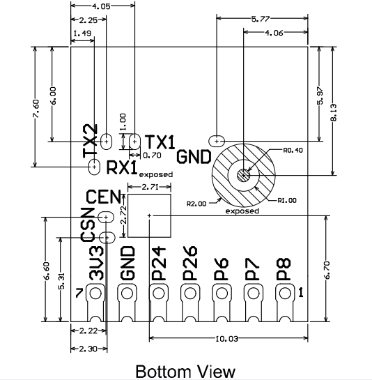

    NOTE: CB2L has UART pads on back, so you will have to desolder it::
    but our video covers it well...
    Just do a 2MB firmware read for this device and post here 2MB flash here. I will do everything else for you, I can forward the request to Cloudcutter team and get a profile for you.

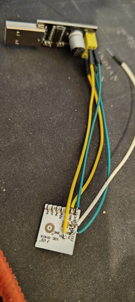

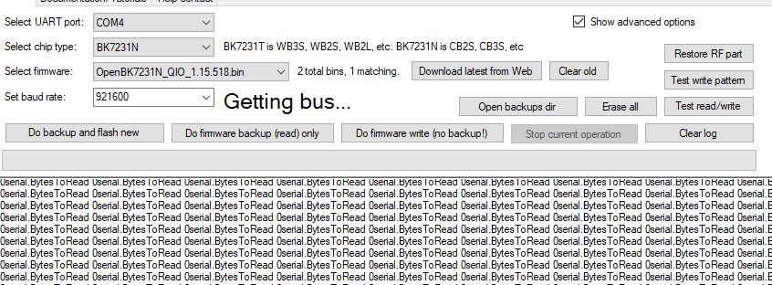

    Hi,
    I've the same smart bulb with the CB2L chip.
    I've desoldered and tried to flash but couldn't achieve it.
    I'm using the esp01 programmer: https://makeradvisor.com/esp8266-esp-01-usb-serial-programmer/
    and plugged the cables as in many tutorials:
    tx=>rx
    rx=>tx
    3v3=>3v3
    gnd=>gnd
    The problem is it's not getting bus
    Getting bus failed, will try again - 5/100!
    3v3 reboot or CEN>gnd doesn't work
    Like the link above I've soldered a button to the programmer to be able to enter the serial programming mode.
    When I hold the button, plug, release and try to "Do firmware backup (read) only" I'll only get Getting bus failed
    I've enabled logging and it's like this:
    When I don't enter the programming mode:
    Has anyone an idea why I can't flash the chip. I've already tried 3 different CB2L.
    I did also try it with different power supplies and measured 3.3v

    Hey @tufandelice , please show your setup, you can also try using Python flasher:

    Have you tried swapping TX and RX? Also let me check if you have correct pins soldered....

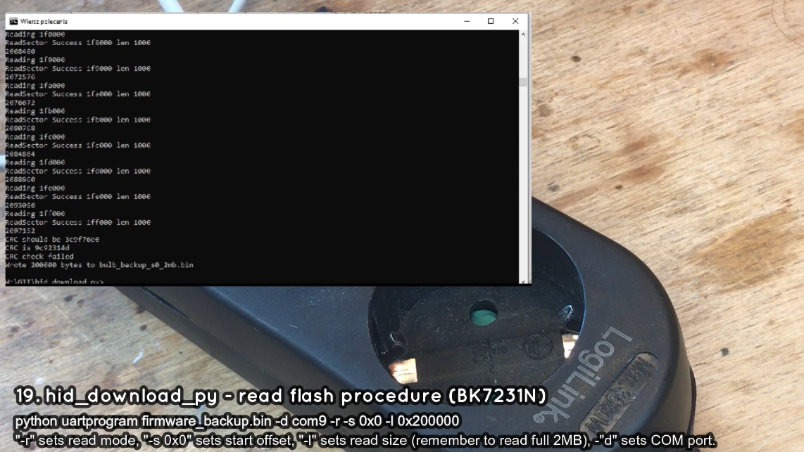

    I have programmed CB2L in this topic:
    https://www.elektroda.pl/rtvforum/topic3918447.html#20183171
    (sorry, not yet translated, but scroll to the photos)
    There was no issues at all. I have compared my pad connections with yours and yours seem okay ,however you may have TX2 shorted on second photo.
    Please check hid_download_py so we can be 100% sure if it's not somehow a flasher fault and then, if it's still not working, we will try to figure something out.
    Also try different baud rates.
    PS: hid_download_py will show checksum error, but it can be ignored

    Please try another USB to UART converter. Btw the read command for N platform should be:

    #9 20503901
    Delice
    Level 4  
    Posts: 7

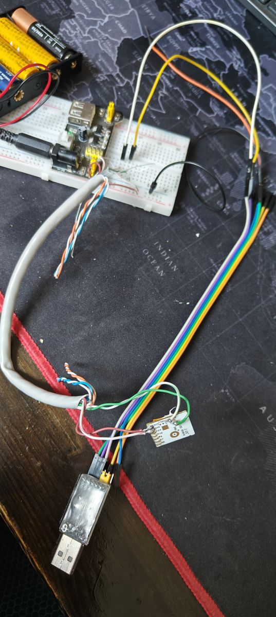

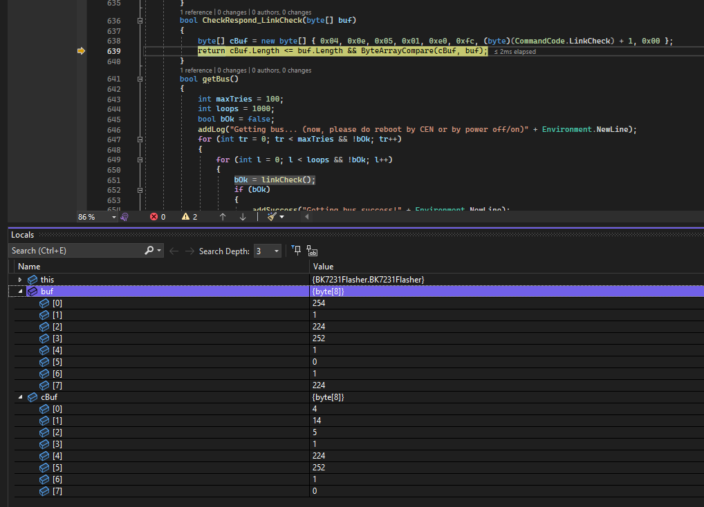

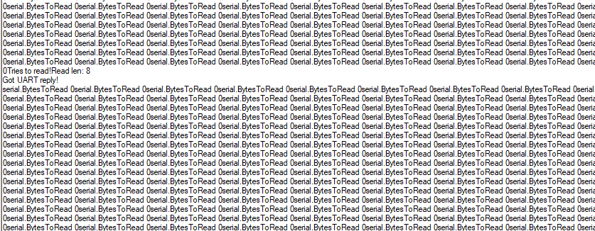

    I've bought the same kind of usb-ttl converter as in the video and tried all the options but couldn't manage to flash the chip.
    I've tried the next routes:
    -python code with ubuntu
    -windows BK writer
    -windows BK7231Flasher
    soldered all the pins again with CAT6 UTP cable(solid)
    chip measurements with volt meter:
    tx-gnd = ~3.2v
    rx-gnd = between 0.01v - 0.10v (idle)
    rx-gnd = ~ 2.3v (running BK flasher => readonly backup)
    3.3v-gnd = 3.3v
    already tried a new chip.
    I also tried to debug it, it fails with ByteArrayCompare:
  • #10 20504011

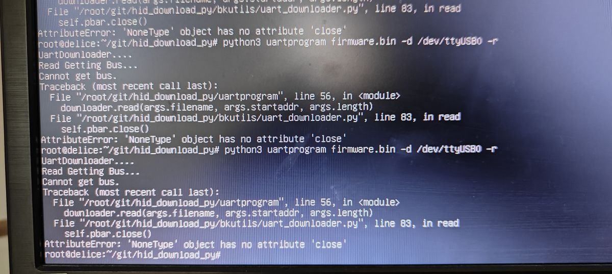

    The hid_download_py (ubuntu tool) always worked for me, at which stage does it fail for you? Does it manage to start reading anything?
    hid_download_py has a misleading "wrong checksum" warning but still saves correct flash.
  • #11 20504016
    Delice
    Level 4  
    Posts: 7
    Cannot get bus.
    Same as Windows flasher

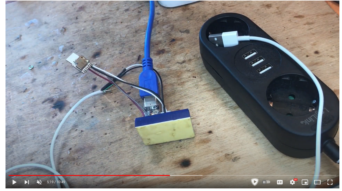

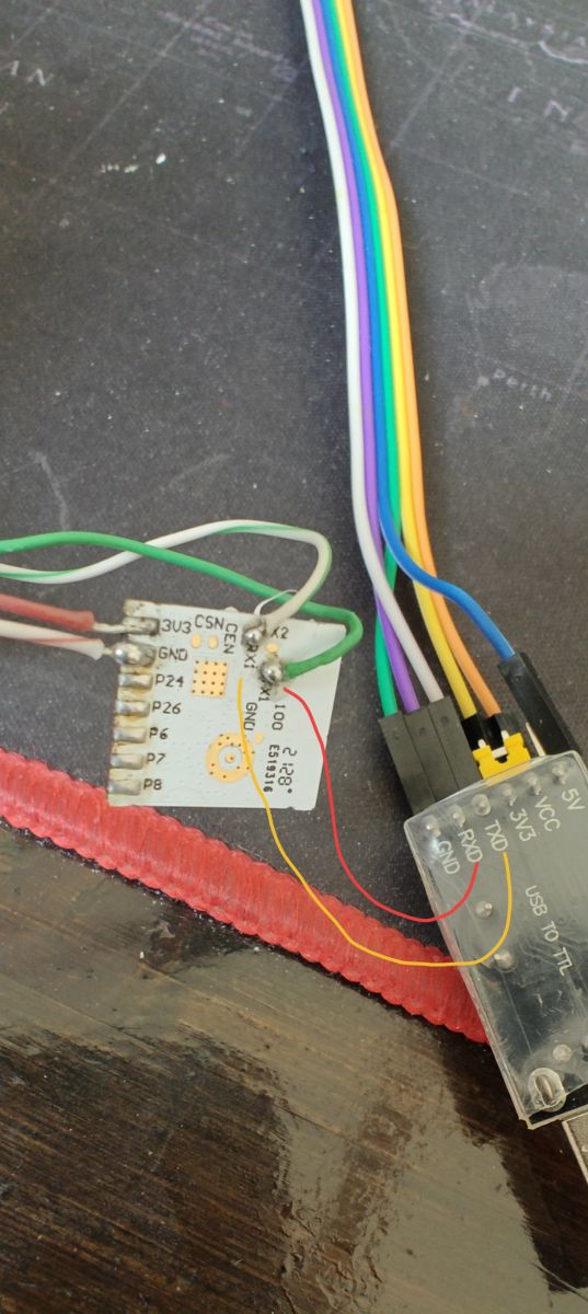

    And how do you connect the same USB to TTL converter as on the video?
  • Shorten flashing wires and use correct uartprogram command

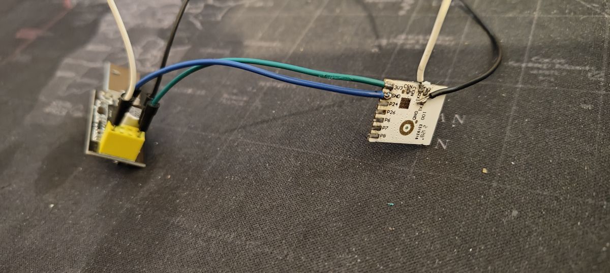

    #14 20504239
    Posts: 14797
    Rate: 12954
    And you are doing power on/off cycle by disconnecting batteries?
    Well, something must be still wrong, can you try to shorten the wires substantially?
    Keeping wires short in order to reduce stray inductances and capacitances is crucial while flashing devices. I had similar issues even with non-IoT MCUs, for example with PIC18F2550. I am not saying that's the problem, but your wires are very long, compared to the ones I am using in my flashing circuits:
    Your wires seem... about six times more long than time.
    Btw if that's CB2L, you are using incorrect command for uartprogram, use the one like on video:
    but it still should get bus. https://www.youtube.com/watch?v=2e1SUQNMrgY
  • #15 20504253
    Delice
    Level 4  
    Posts: 7
    It works!!!
    Thank you very much.
    My cables were too long.
    Total cable length now is around 14cm
