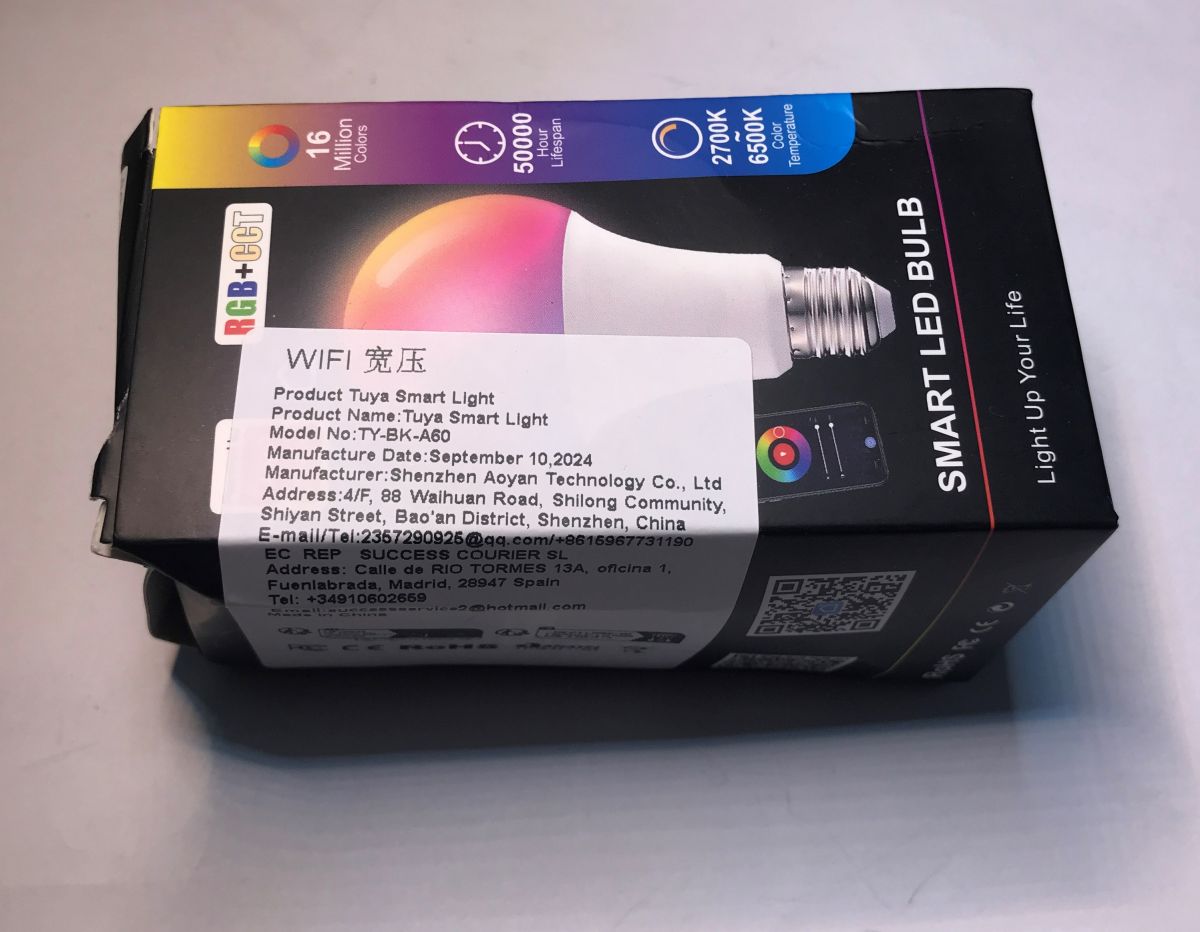

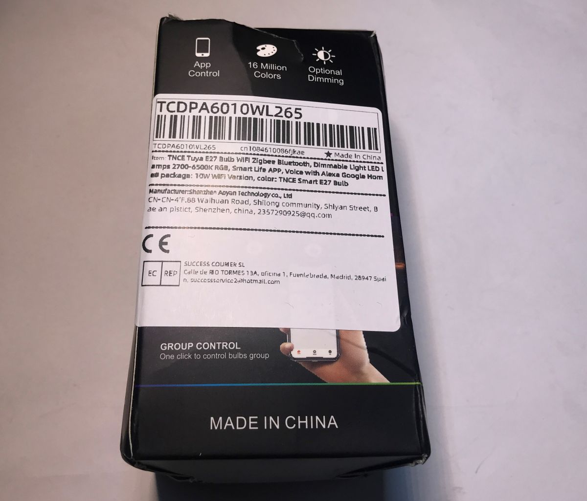

    Packaging of the TNCE Smart E27 bulb - TCDPA601WL265 with visible product labels.
    Package of TNCE Smart E27 bulb showing product parameters.
    Packaging of the Tuya Smart LED Bulb TY-BK-A60 with product information.
    Box of TNCE Smart E27 bulb with certification labels
    TNCE Smart E27 Bulb Packaging
    TNCE Smart E27 Bulb - TCDPA601WL265
    Model: TY-BK-A60
    Manufactured: September 10, 2024

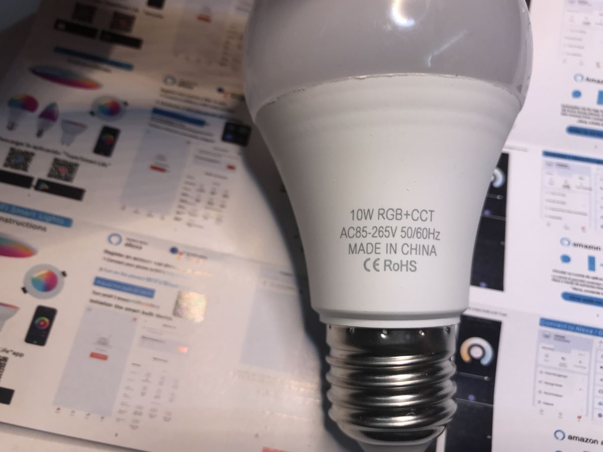

    and the bulb itself:
    TNCE Smart E27 LED bulb lying on technical documentation.

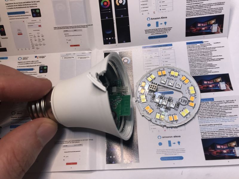

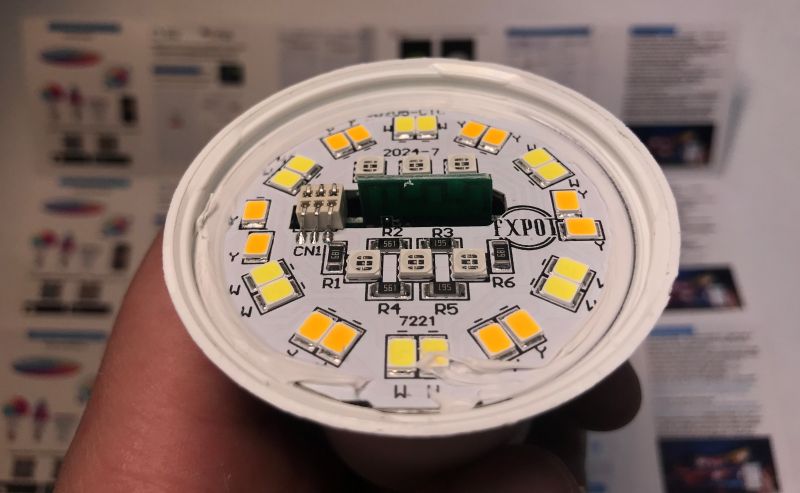

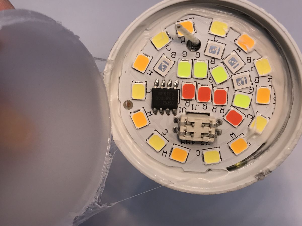

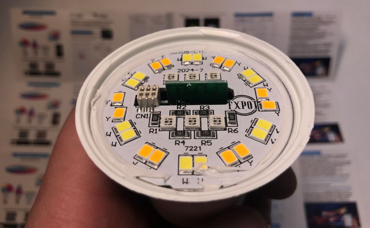

    Bulb teardown
    Top dome can be easily removed with some force. I managed to do it with my bare hands:
    Close-up of LED PCB with yellow diodes and markings.
    Then I had to remove the LED board. I had to pry it with screw driver, it was a bit problematic. I broke the part of the bulb edge:
    View of the interior of a TNCE Smart E27 LED bulb with the dome and LED board removed, against a background of the user manual.

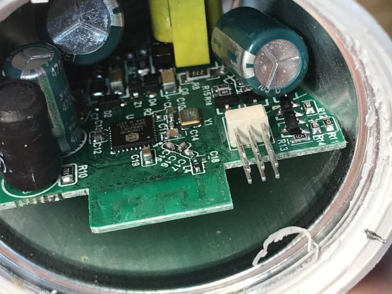

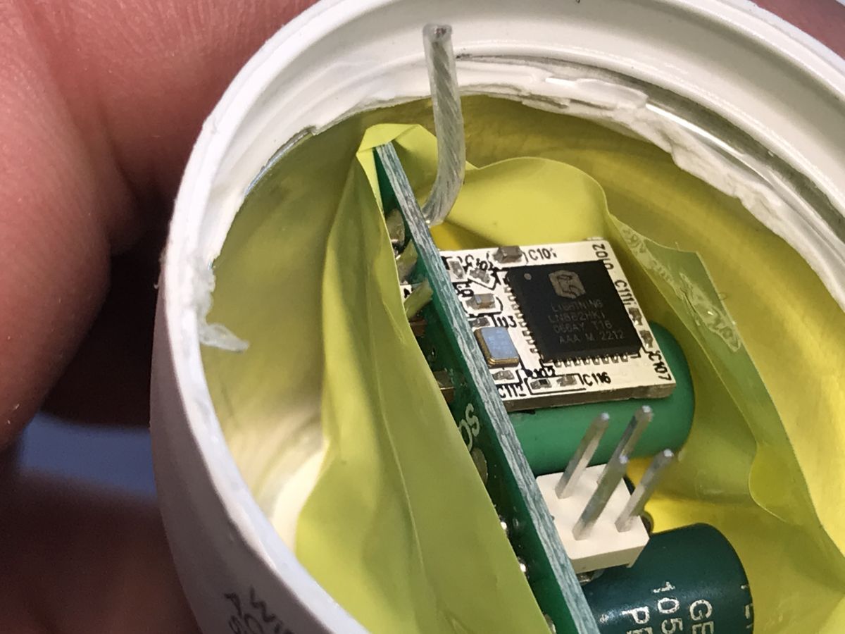

    Finally, as you can see, we're getting access to the WiFi MCU:
    Interior of an opened LED bulb showing the circuit board.

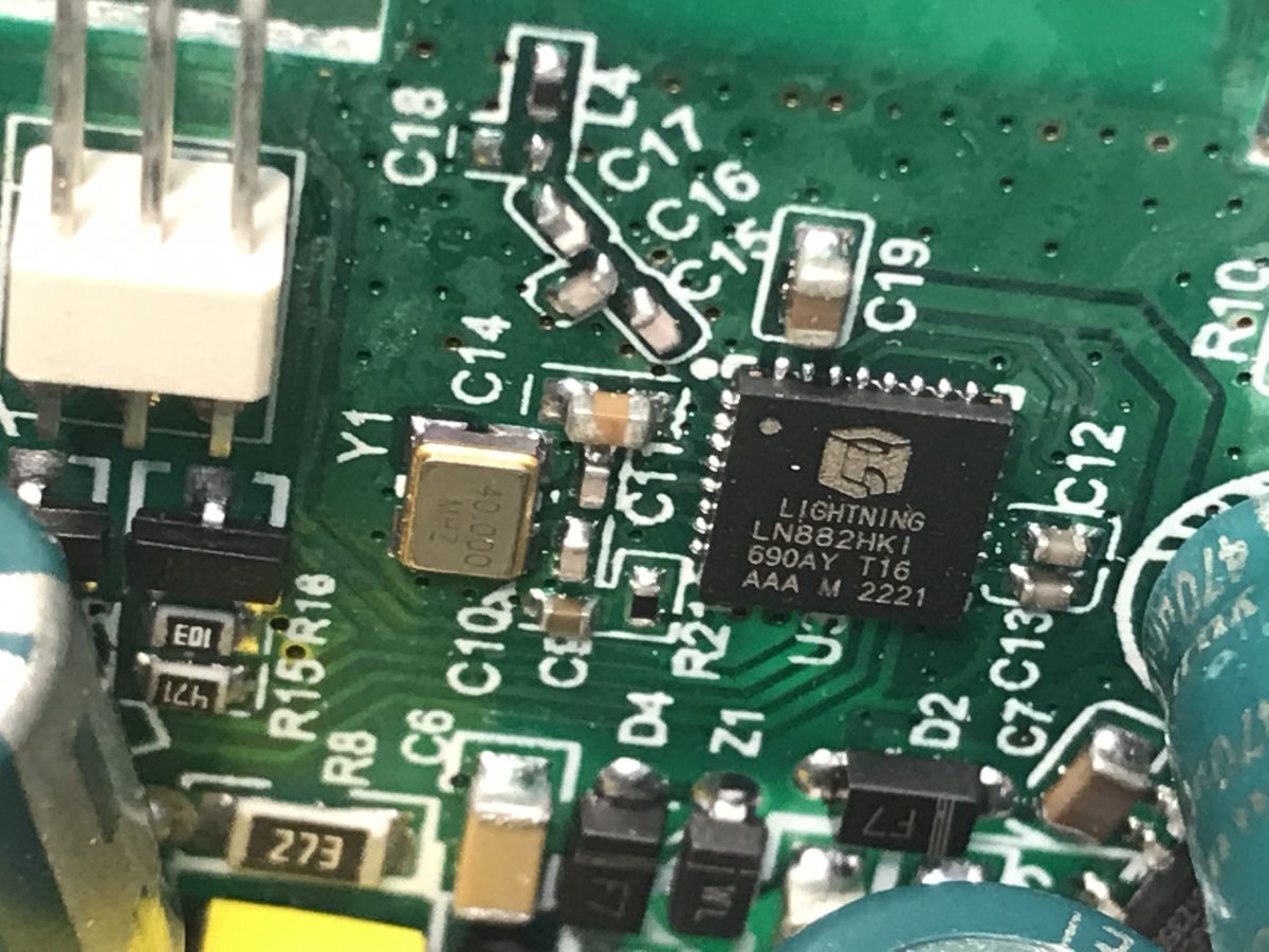

    It's not a Beken chip this time, but a LN882H:
    Close-up of Lightning LN882HKI chip on a circuit board.
    LIGHTNING LN882HKI, to be precise.
    You can also see five transistors nearby, so probably bulb uses raw PWMs. No I2C LED controller there.
    Interior view of an LED bulb with a visible PCB and electronic components.

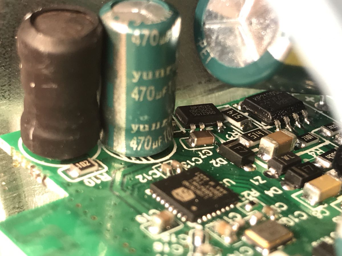

    It is also possible to glance at the power supply circuit in the back:
    Close-up of a circuit board with electronic components.
    It's a step down converter based on BP2525, just like usual. It's a very common solution in these products.
    I can also see a KP2120 (KP2120SG?) in the background, so the LED circuit might have a separate supply than a WiFi SoC.

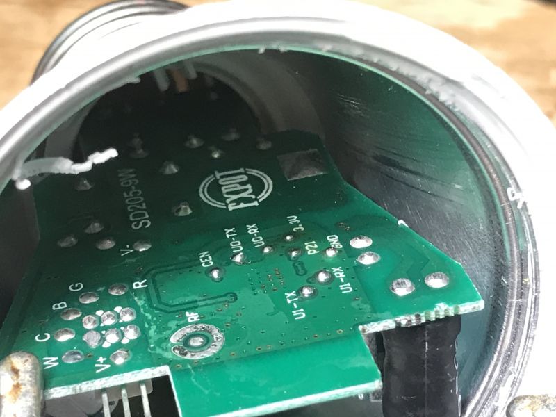

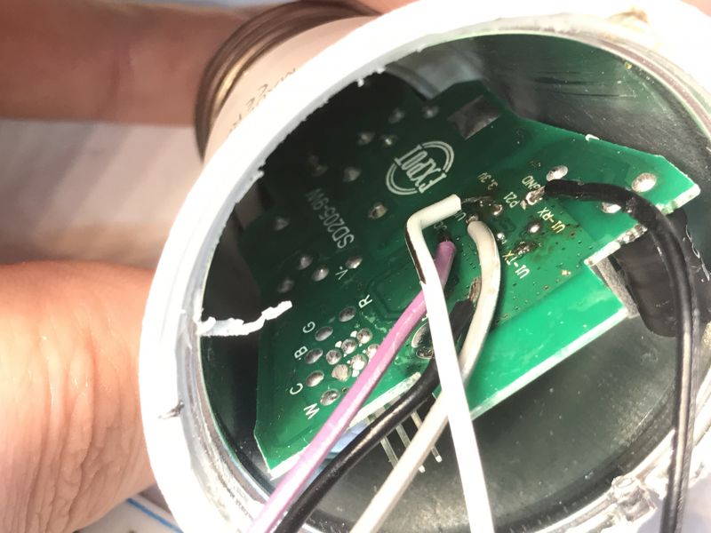

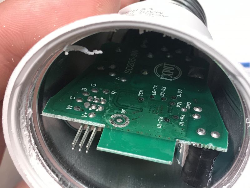

    There are also flashing pads on the bottom of the board:
    View of the interior of a LED bulb showing the PCB and solder pads.
    P21 may sounds like a Beken pin. I think it's a left over from previous device version which might have used BK7231.
    Firmware change
    P21 is actually a LN882H boot pin. The programming UART is in the background, U0-TX and U0-RX. First add some flux and Pb solder to the pads:
    View inside an LED bulb showing a circuit board and solder pad labels.
    Then solder wires:
    Inside view of a light bulb with visible circuit board and wires.
    Follow LN882H flashing tutorial:
    https://www.elektroda.com/rtvforum/topic4028087.html
    https://www.elektroda.pl/rtvforum/topic4028087.html

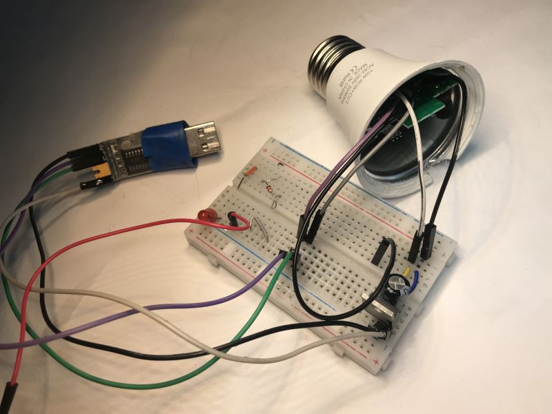

    Here's my full circuit:
    Dismantled TNCE Smart E27 LED bulb with a breadboard and USB to UART adapter.
    Of course, I've also took a backup of original firmware first. It's not full 2MB because I had to interrupt read early, but it seems that data past 1MB mark is just full of 0xFF:

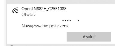

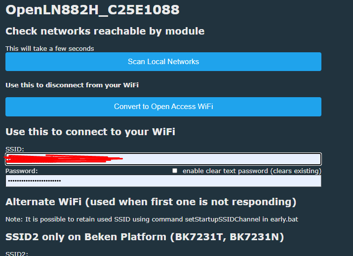

    Just like with Tasmota - disconnect boot pin, do power off/on, connect to LN822H access point:
    Notification for connecting to OpenLN882H network.
    Configure your WiFi:
    Screenshot of WiFi setup interface for OpenLN882H

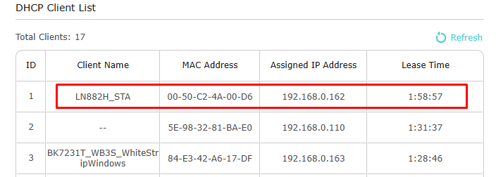

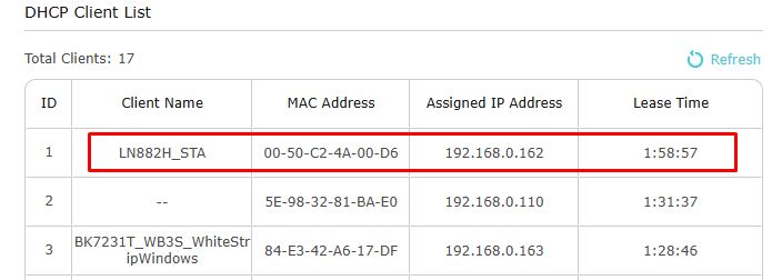

    Get new device IP from DHCP:
    DHCP client list showing LN882H_STA device with assigned IP address.

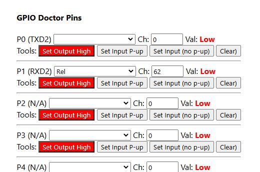

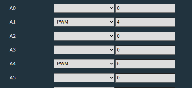

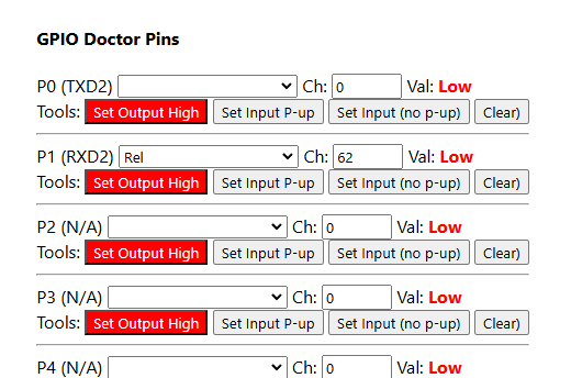

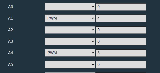

    Then you need to figure out the GPIO roles. We don't have yet GPIO extraction for this platform, so I used the GPIO Doctor tool from the Web App.
    GPIO Doctor Pins interface
    Once you guess the pins with Doctor, you can set them to PWMs in Configure Module menu:
    Screenshot of GPIO settings, showing PWM configuration for A1 and A4.

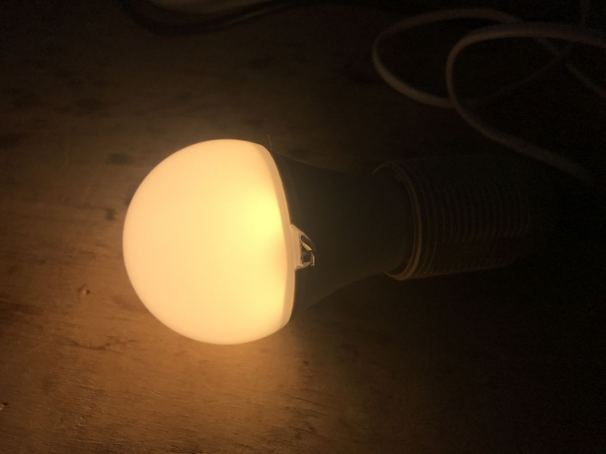

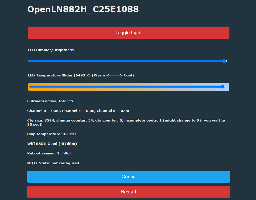

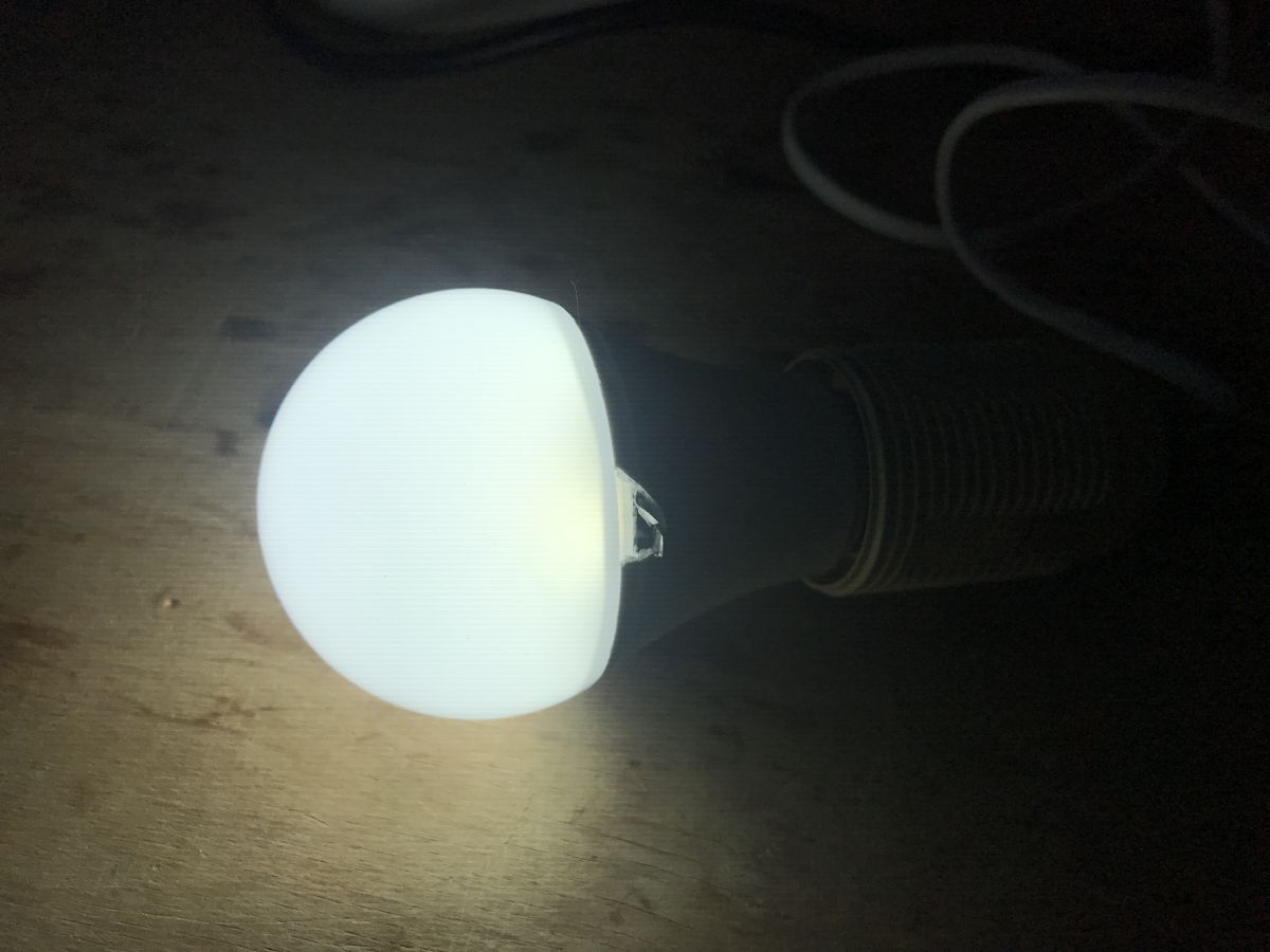

    At first I got CW working:
    This is how CW controls look like:
    Screenshot of OpenLN882H interface with LED brightness and temperature slider.
    CW seems to work good:
    Illuminated TNCE Smart E27 - TCDPA601WL265 bulb lying on a wooden surface.
    Lit LED bulb placed on a wooden surface.

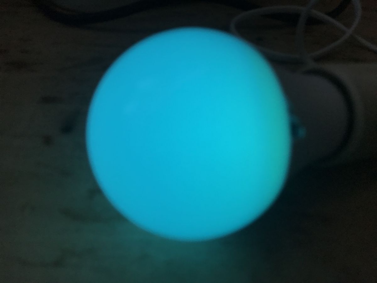

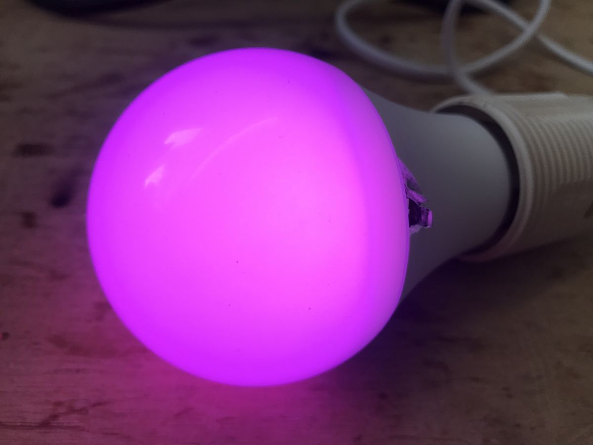

    Later I found RGB pins, so RGBCW is fully working now.
    LED bulb emitting purple light
    LED bulb glowing blue.
    RGBCW configuration:

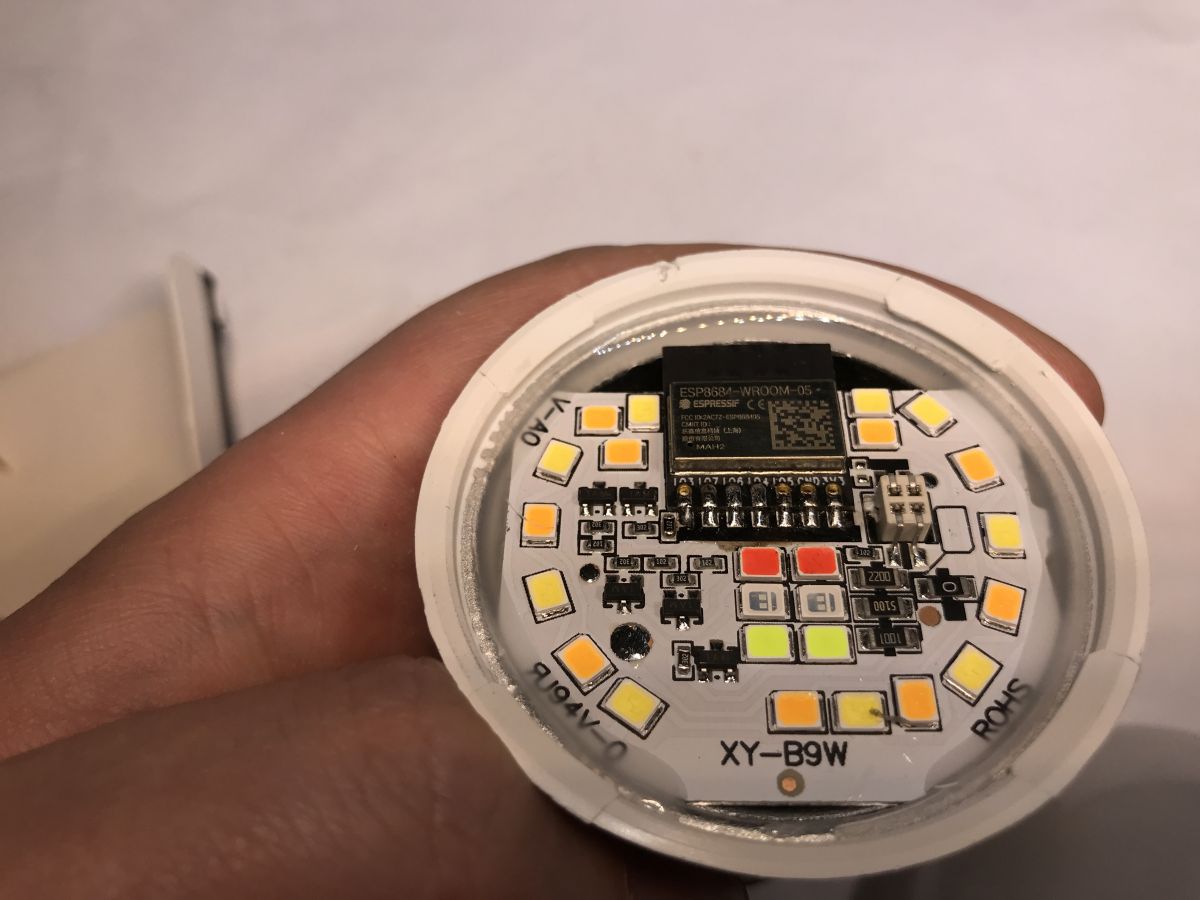

    Image of Ewelink E14 WiFi Zigbee smart LED bulb with color-changing feature. .
    It turned out to be based on the BL602 - BW2L module . I am working on it. It is possible to upload OpenBL602.

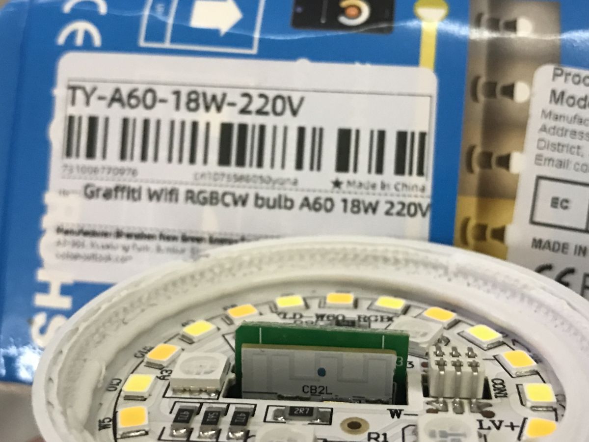

    It came with:
    ZigBee Tuya WiFi LED bulb with a smartphone app. .
    CB2L.
    Close-up of an LED bulb with an integrated circuit labeled CB2L, with a product packaging label for TY-A60-18W-220V in the background. .

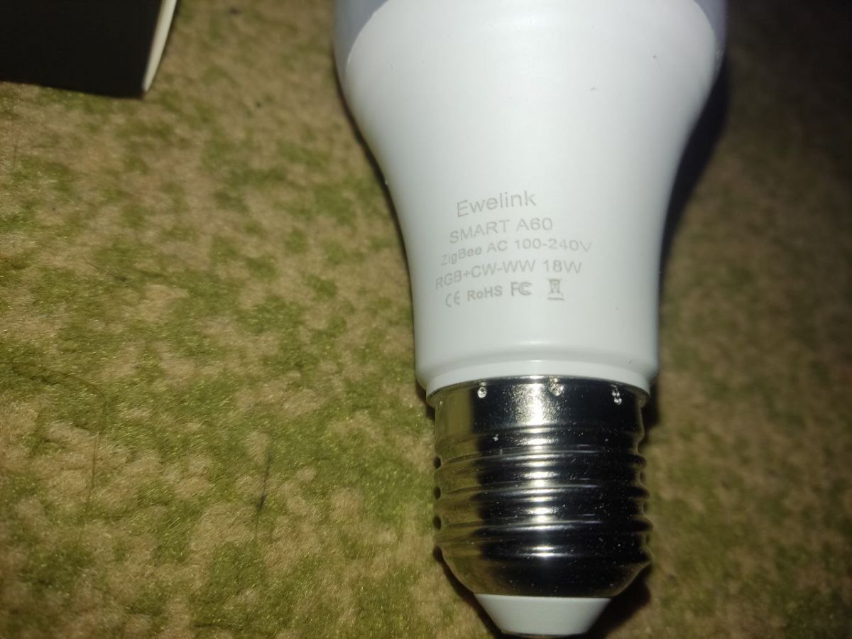

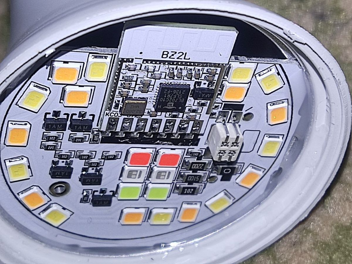

  • BZ2L module with BL702 in Ewelink A60 bulb
    #10 21459470
    bulek01
    Posts: 338
    Help: 12
    Rate: 297
    I ordered, also, a zigbee version of the bulb.
    There is a BZ2L module inside with a BL702 microcontroller.
    The bulb is an Ewelink SMART A60
    Close-up of the inside of a light bulb with a BZ2L module and BL702 microcontroller, surrounded by LED lights. .
    Ewelink SMART A60 bulb lying on a green carpet. .
    Ewelink SMART A60 bulb next to an open box on a carpet. .
    Zigbee2mqtt found it as https://www.zigbee2mqtt.io/devices/CK-BL702-AL-01.html

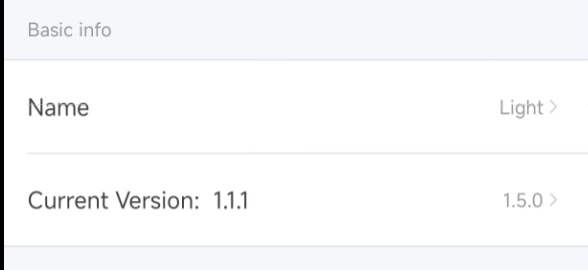

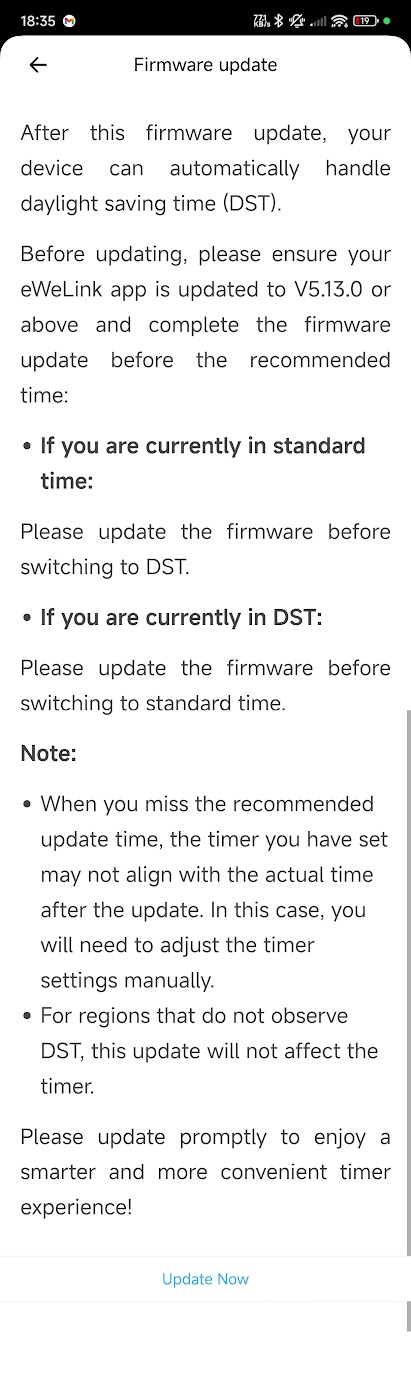

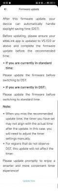

    The E14 led mentioned earlier in this topic from eWeLink turned out to use BL602
    Assuming eWeLink-C3009-EW-E14-BWL2-bulb-20250225.bin is from this bulb:
    In eWeLink app:
    FW Name: CK-BL602-5PWM-01
    Screenshot showing device information with the name Light and current firmware version 1.1.1, offering an update to 1.5.0.
    Offers update to 1.5.0
    eWeLink firmware update screen with instructions.
    which is downloaded from http://52.57.99.135:8088/ota/rom/UOqtau8qtAt8...1024.new.2.bin?deviceid=xxxxxxxxxxxxxxxxxxxxx
    (deviceID removed)
    After update the boot log is more verbose. Recently built.
    • user1.1024.new.2.bin (539.81 KB) You must be logged in to download this attachment.

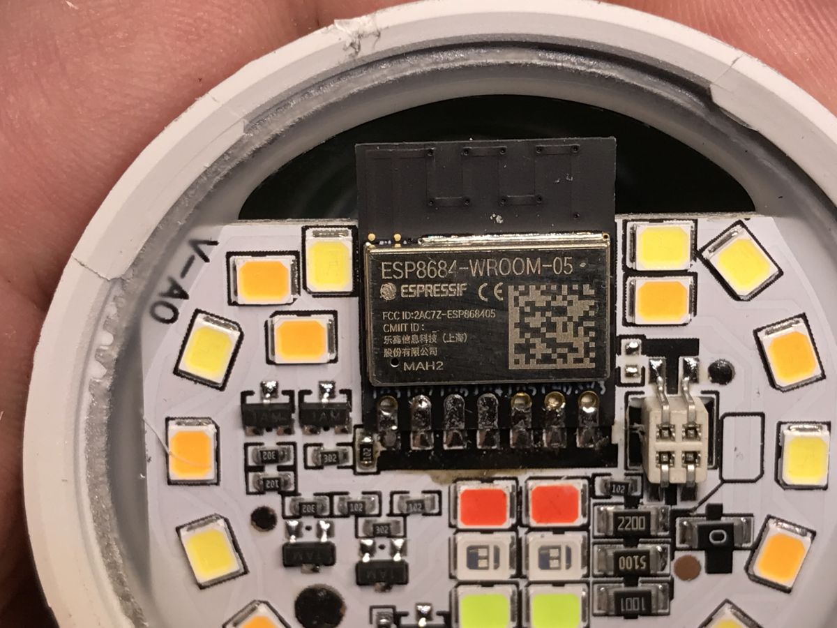

    @divadiow the Matter bulb also arrived:
    Smart LED bulb packaging with Matter technology.
    LED board with ESP8266 module.
    Close-up of an electronic board with an ESP8266-WROOM-05 module and LED lights.
    Image of an LED bulb held in hands with a QR code and serial number.
    ESP8684-WROOM-05, I didn't research it yet. I hope it's not flash-protected?
    Added after 44 [seconds]:
    Found this: ESP8684 is the new nomenclature for ESP32-C3 based modules
  • #17 21469251

  • #22 21469421
    Posts: 14755
    Rate: 12879
    Well, it seems I don't have much options. Buying a replacement module would cost too much, maybe at most I could try to botch there WB2S that I received from a reader... but it's not pin to pin compatible...

  • Two bulb models identified as LN882H and BW2L
    #26 21473843
    Posts: 14755
    Rate: 12879
    Two bulbs arrived today.
    - Smart Life/Tuya Smart TY-E14-220VB*AT 5W
    Advertisement for a smart RGB LED bulb with WiFi and Bluetooth features.
    https://pl.aliexpress.com/item/1005007654887555.html
    Box of a smart bulb model C3009.
    Open LED light showing diodes and an electronic component.
    Electronic circuit inside a device with yellow insulation.
    LN882H
    - COOLO eWeLink - EW-A60-15W
    Advertisement promoting Zigbee WiFi smart LED bulbs.
    https://www.aliexpress.com/item/1005006412570573.html
    It's BW2L as well

    edit: so I fooled around a bit with the timing of connecting sp21 to ground and got this:
    GPIOA_9 low level, will enter ATE mode!
    so the chip seems to recognize that the pin is low ... but I still cant flash or read from the device in this state ... isnt ATE mode some kind of test mode and not the desired download mode`?
  • #28 21877420
    Posts: 14755
    Rate: 12879
    I didn't pay attention to this log. Can anyone check? @divadiow ?
    I would still suggest testing different baud rates, in both our flasher and original LN882H tool. How do you connect this, did you try swapping RX and TX, how do you power the module?
  • #29 21877425
    insmod
    Posts: 1432
    Help: 168
    Rate: 455
    It shouldn't be printing anything if in boot mode.
    A9 must be low before powering it up.
    If there's no log - boot mode. To double check - open COM port in any terminal program at 115200 baud and write "version".
    It should respond with "Mar 14 2021/00:23:32"
  • #30 21877429
    Posts: 5209
    Help: 446
    Rate: 914
    power off/unplug USB port and 3.3v to device in between flash attempts. A9 grounded before powering-on

What is the P21 or SP21 pad on an LN882H bulb board, and how is it used to enter boot mode?
P21, also labeled SP21 on some boards, is the LN882H boot-selection pad tied to GPIOA_9. You use it by grounding it before power-up so the chip enters boot mode instead of normal firmware startup. Later troubleshooting confirmed that the pad continuity to GPIOA_9 was correct and that the module recognized the low state. If the pad is released, the bulb resumes normal operation and prints standard boot logs again. [#21877012]

Which UART pads should be used on the LN882H bulb for flashing, and how do U0 and U1 differ during troubleshooting?
Use U0, not U1, for flashing the LN882H bulb. The original guide identifies U0-TX and U0-RX as the programming UART, while a later user initially wired the U1 interface because it showed serial logs. That caused confusion: U1 exposed runtime output, but flashing only worked after moving the wires back to U0. This is the key troubleshooting difference: logs alone do not prove you are on the bootloader UART. [#21878105]

How can you tell from the outside whether a Matter smart bulb is more likely to use an ESP8684/ESP32-C3 module or a Beken-based module before buying?
You usually cannot tell reliably from the outside. One participant asked exactly that, and the reply was that there was no dependable labeling pattern, only weak brand-level guesses. The thread mentions some Moes devices can be ESP, and CozyLife / Aiyatto products had looked promising, but this was not presented as a rule. A Matter bulb in the same discussion arrived with ESP8684-WROOM-05, and its UART download mode was blocked, showing why external branding is a poor predictor. [#21469802]
