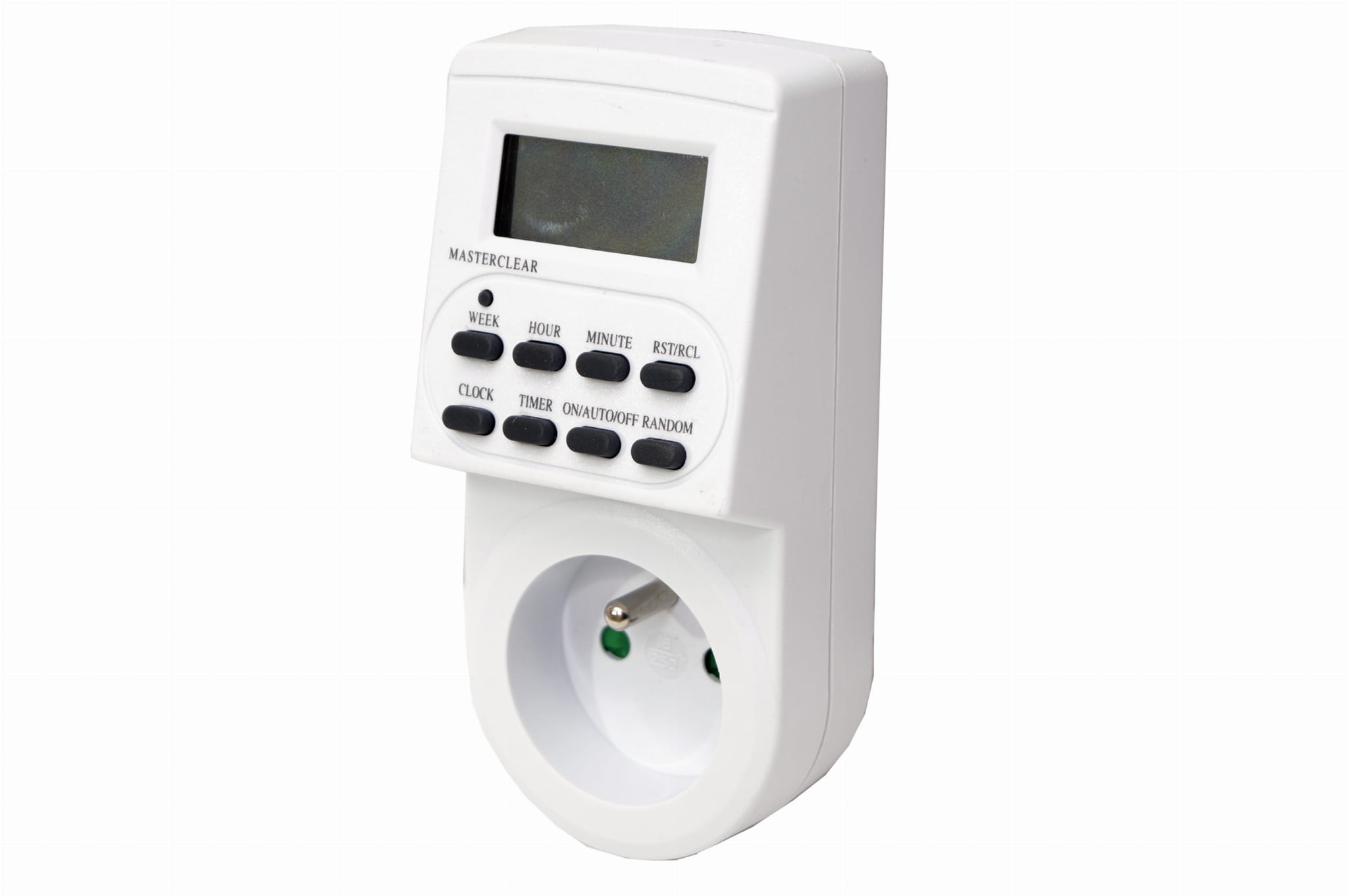

    Good afternoon.
    I am looking for a timer or a programmer, but other than the one attached, which can be bought almost everywhere.
    I want it to be possible to set the time, several times at which it would switch on, and most importantly its setting would be in seconds, i.e.
    I set at 12:35:00 it switches on and off at 12:35:05
    And such cycles during the day, for example, made 10. Is such a timer available on the market for sale?
    • Wanted timer with setting in seconds and multiple daily cycles programator-czasowy-dpm-dt03-1.jpg (56.02 KB) You must be logged in to download this attachment.

    I guess it would be cheaper and simpler to use that timer from the photo, connecting a timer in monostable mode to its output, programming the appropriate duration (in seconds) of the pulse.

    ADB-6 wrote:
    I guess it would be cheaper and simpler to use this timer from the photo, connecting a timer in monostable mode to its output, programming the appropriate duration (in seconds) of the pulse.
    You need to explain this to me more clearly because I don't know any of this

    Zamel ZCM-11 ( single channel ) or ZCM-12 (two channel ) operating in pulse mode.
