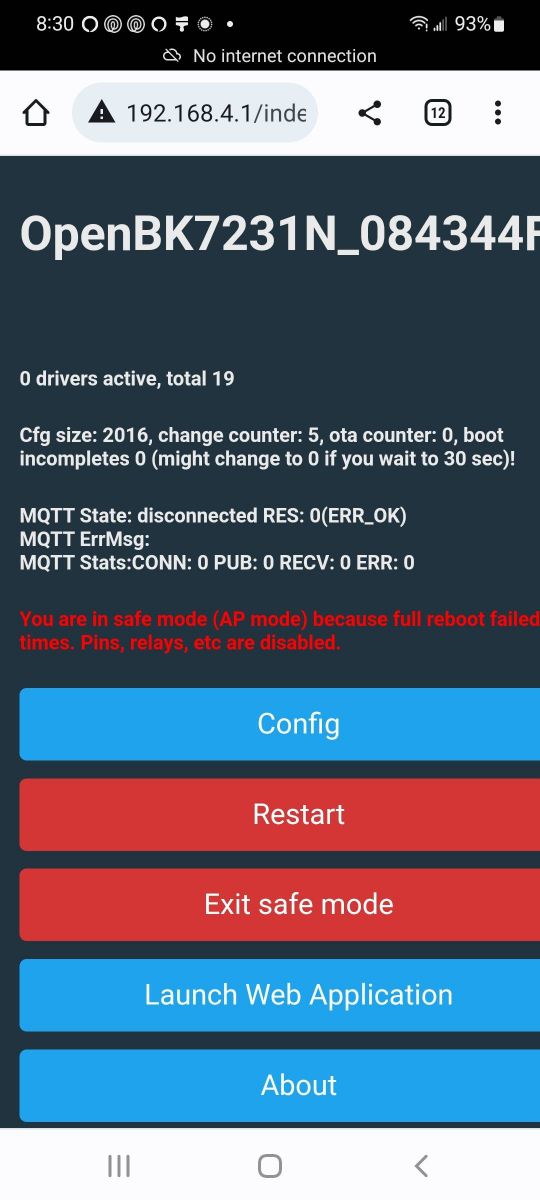

    I discovered that if I power-cycle the KS602S device 6 times, the device resets and the AP at 192.168.4.1 is back.
    In the home page, it says, in red, "You are in safe mode (AP mode) because full reboot failed 0 times".
    Am I in the right place? Where next?

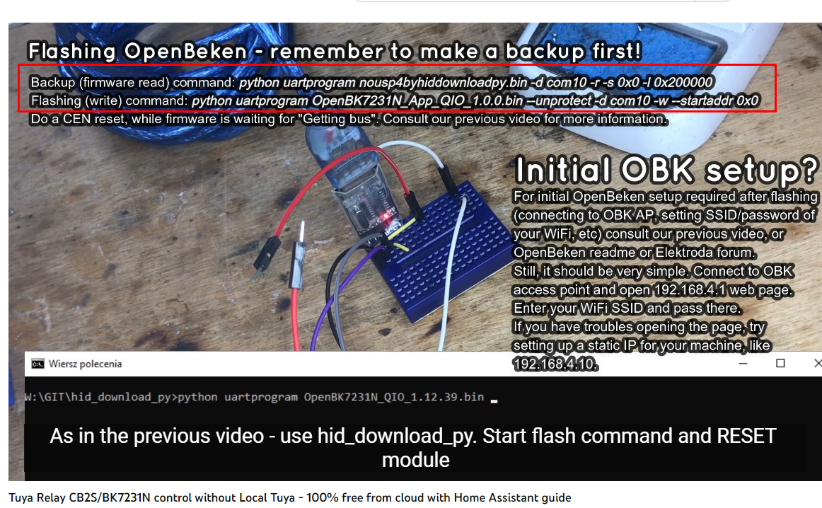

    1. connect uart to TXD2 and get uart log, but i have read your linked topic and it seems TXD2 has no easy access
    2. do a full 2MB flash dump for me (for analysis), maybe set wifi password to garbage first if you are worried about leaking it, and then flash a dump from myself and see if it behaves better.
    CB2S hid_download_py backup (firmware read 2MB) and writing firmware binary tutorial is here:

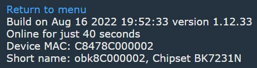

    Yes. FullFW.bin did accept my WiFi credentials and the index page is viewable on my local network:
    I flashed my switch that has a BK7231N chip on it,. Now what?
    I have NOT tried SFMax.bin, but I will if it would provide you with useful information. Otherwise, I will proceed with this binary if you don't have any issue. Now I just need to figure out the MQTT configuration for the KS602S.
    HOWEVER....

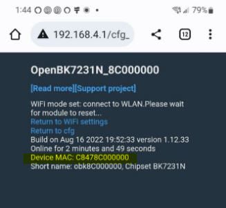

    Did the MAC address change??
    When I first started I noted the MAC address of the Belkin chip as A0:92:08:43:44:F4, and this was the MAC address I had been looking for in my IP scan. (I have over 100 devices on my network, so searching for the MAC is easiest). But after flashing FullFW.bin and entering my WiFi credentials, I noticed a new MAC address:
    This new MAC address was in my IP scan and when I opened the IP address for the device I got the configuration screen. I am now wondering if I was looking for the wrong MAC address using the latest release OpenBK7231N_QIO_1.15.391.bin ??? Should I go back and try .391.bin?
    You will need to reconfigure WiFi pass in safe mode. In order to get into safe/configuration mode, you need to do 5 quick reboots. In order to get out of safe mode, you need to wait for the device to run without resets for more than 30 seconds.

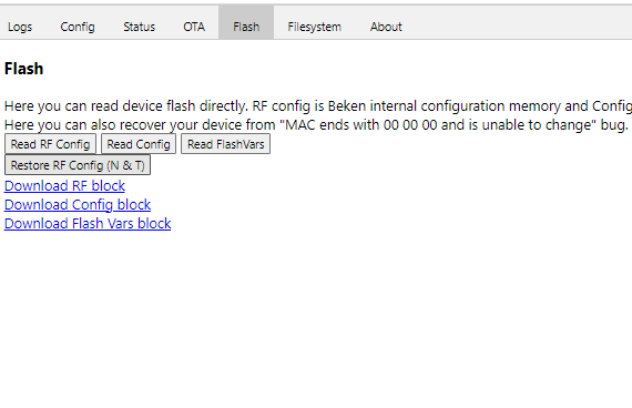

    Posts: 14797
    Rate: 12954
    CB2S is a name of WiFi module with BK7231N.
    You seem to be experiencing a rare issue where RF calibration partition (or something further in memory, after the firmware binary) is not compatible with our SDK.
    It is currently unknown why it happens exactly, do both of your switches come from the same batch?
    The FullFW has cleared RF config, that's why MAC is lost.
    To recreate MAC, go to Open Web Application, and then in Flash tab do "Restore RF config":

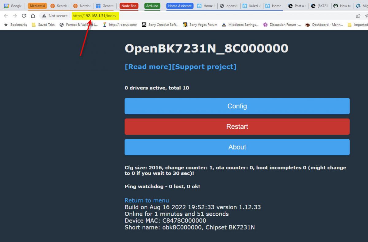

    Of the two switches, only one connects to the WiFi.
    The switch flashed with FullFW.bin seems to be working as expected. I reassembled the switch and wired it with a power cord and light load and everything, including MQTT commands are working.
    The binary is possibly an older one because it doesn't have MQTT discovery for Home Assistant. I put the Home Assistant yaml code into my mqtt.yaml file, but I am not seeing the switch in config/devices.

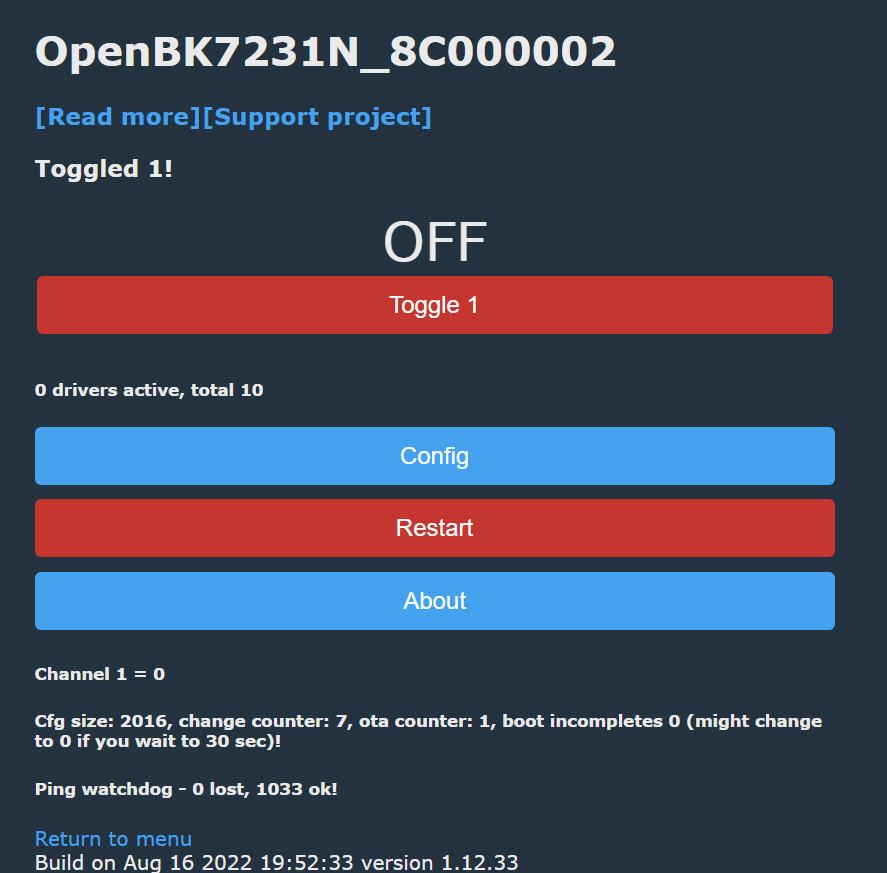

    And, a new (minor) problem has appeared that was working yesterday. When I toggle the switch from the button or from MQTT, the status on the main menu doesn't change. If I toggle from the menu page, the status tracks.
    This appeared after I changed the device name from "Utility Room Light" to "UtilityRoom-Light". I changed the name back to the original but the status still doesn't track.

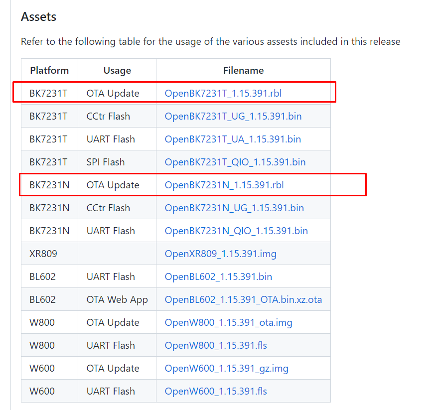

    What's an RBL file? (OpenBK7231N_QIO_1.15.391.bin ?). Is it safe to OTA this from BK7231Flasher.exe?
    It's only for UART. RBL is here:
    https://github.com/openshwprojects/OpenBK7231T_App/releases/
    for me, it autorefreshes after few second. Does the status change if you hit "Refresh"?

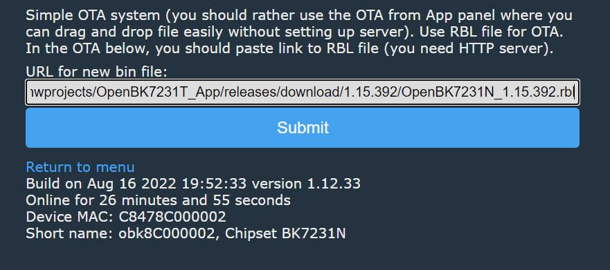

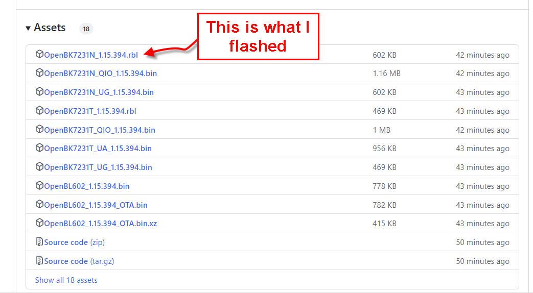

    Then I will try to upgrade using OpenBK7231N_1.15.392.rbl. From the menu? Is this correct?
    It isn't clear what "App panel" is being referred to here.
    Later...
    Well, that didn't work.
    So, how do you recommend an OTA update?

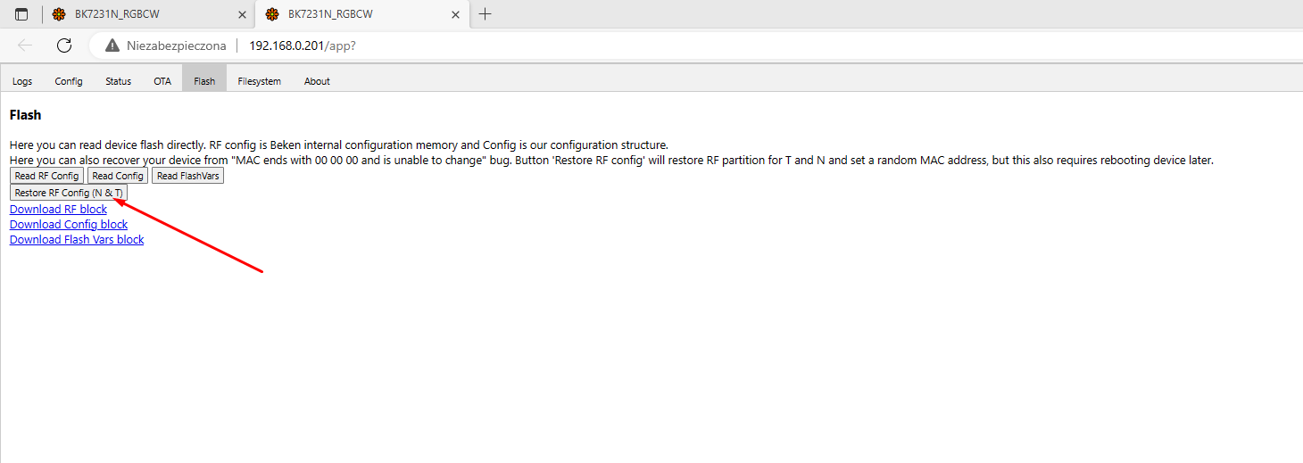

    #12 20409384
    Posts: 14797
    Rate: 12954
    Hello, this field is for HTTP OTA. It works if you have a file on HTTP (not HTTPS server). So it won't work that way.
    I will show you how to do OTA better way.
    And, btw, you still haven't changed MAC.

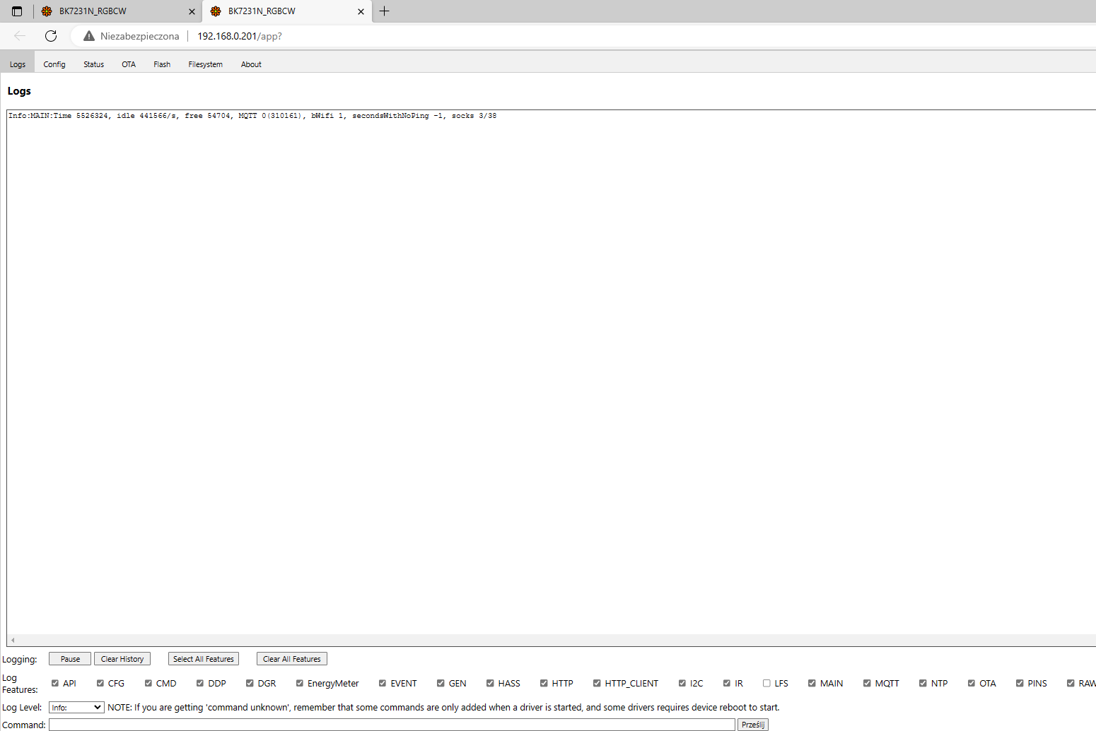

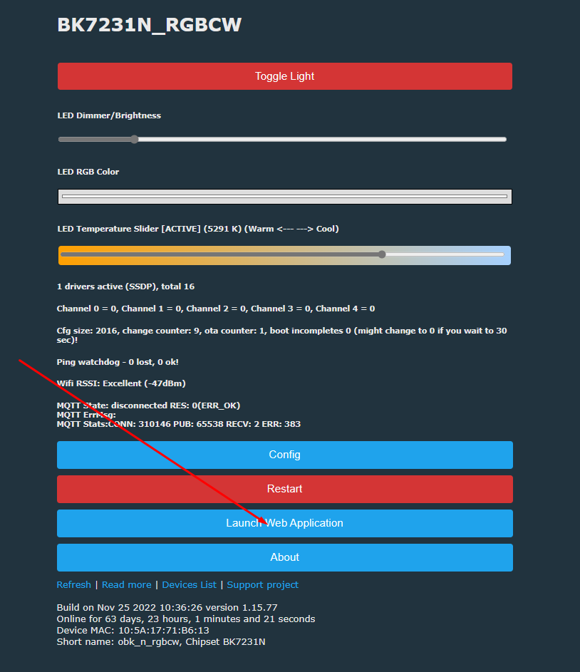

    Please go to "Open Web Application" and then, first:
    (Here is how web app looks like:

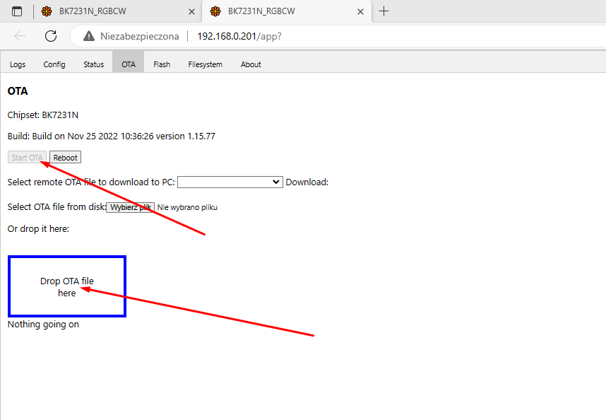

    In Flash do "restore RF config" to get valid MAC:
    Then in OTA ,drag and drop RBL file for your platform and start:
    Again, I apologize for that WiFi issues. It's rare case that affects a certain batch of N modules, it happens because Tuya RF partition seems to have changed its format and breaks OBK. That's why you had to write full 2MB flash with empty MAC (and RF data), that was to clear the bad RF data.
    If you have any more problematic devices, please do a 2MB flash read first (of broken device) and attach it here for me for analysis, if you want to help investigating it.
    EDIT:
    I just had a thought- What if I do a backup of switch number 1, disconnect it, then flash that backup to switch number 2. Would I essentially have a clone?
    2MB flash contains everything, including MAC, so writing it twice to two devices without changing MAC as I shown above will make your devices and router go crazy.

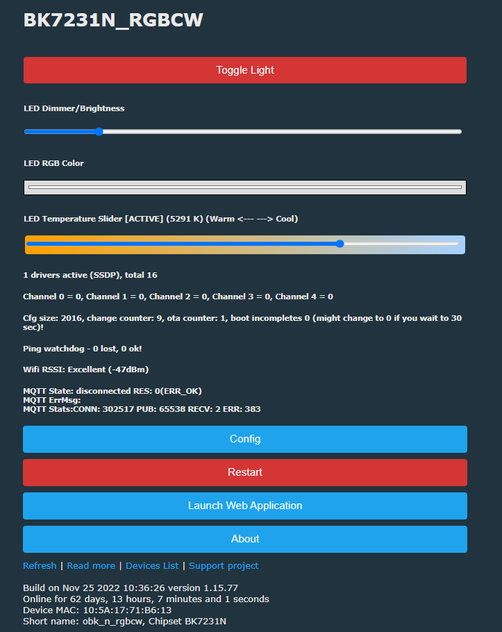

    But on the FullFW binary, there is no "Launch Web Application" button. But your sample image showed the URL so I just went to my IP /app?.
    Is this the right RBL file?

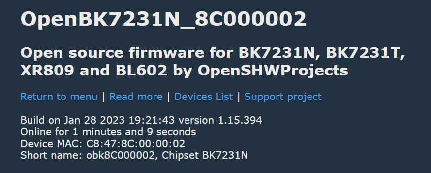

    At any rate this is from the "About" page after flashing the RBL file:
    "And, btw, you still haven't changed MAC."
    Yes, look at the last digit. One is 001 and the other is 002. They coexist nicely.
    "Again, I apologize for that WiFi issue. It's a rare case that affects a certain batch of N modules, it happens because Tuya RF partition seems to have changed its format and breaks OBK. That's why you had to write full 2MB flash with empty MAC (and RF data), that was to clear the bad RF data."
    No apology needed. At least I know what to do the next time and your assistance is greatly appreciated.

    Conclusion
    Everything appears to be working now.
    Does this mean that as far as OpenBK is concerned, my devices are now up to date and safe for future updates?

    But on the FullFW binary, there is no "Launch Web Application" button. But your sample image showed the URL so I just went to my IP +/app?.
    Sorry, but now it's not clear, did going to URL work?
    I think in older version the App link was in Config.
    I am starting to think that we need to add something like a hard reset mechanism that will automatically clear RF partition without doing "FullFW hack". Maybe 10 quick power on/off cycles should clear 100% of config and RF? But now I would worried that power outage or user playing around with light would trigger it by accident....
    It seems so, but I would make sure that whole MAC is totally random (it can be changed in options?) and also set full and short device names to something unique, like "obkNkitchenLamp", etc and NOT to obkFFAABBCC.
    Now you can pair with HA, etc:
