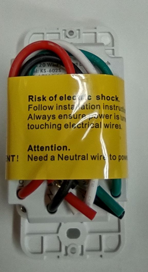

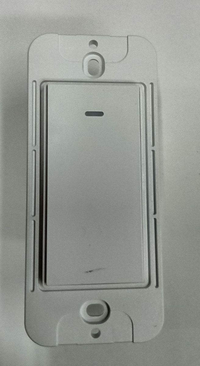

    This is the front of the switch.
    [BK7231N] KS-602S 120V Intertek Kuled K36 Switch Flashing

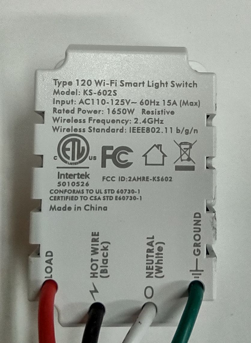

    This is the back.
    There seem to be a number of similar switches from other locations that all have the same model number - KS602-S although sometimes the switches are advertised as K36 - not sure what that's all about.

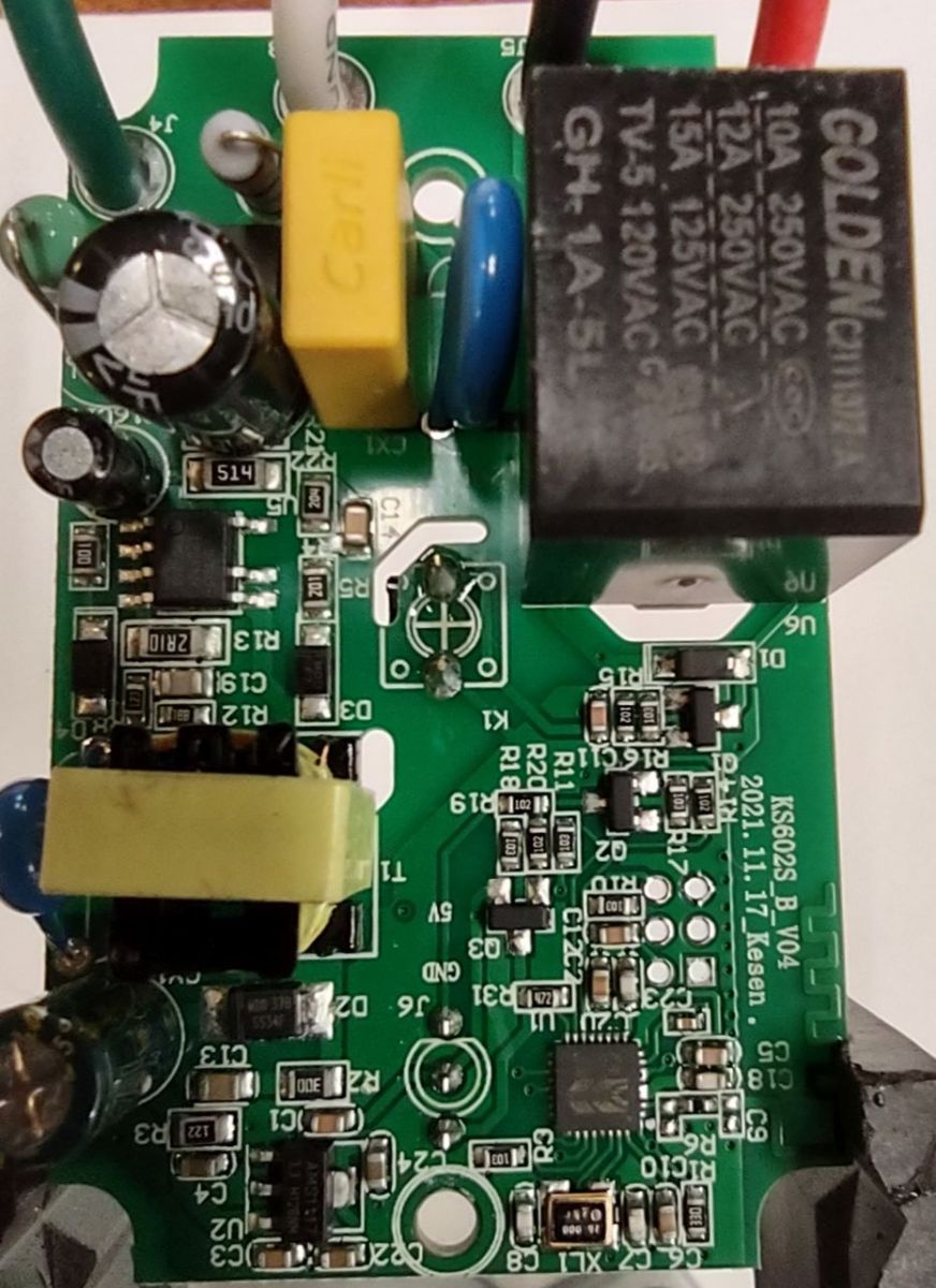

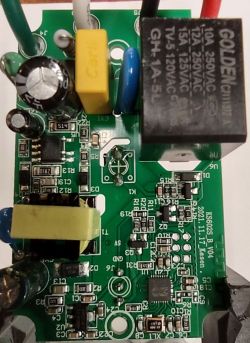

    If you remove the 4 screws you see the back of the PCB.

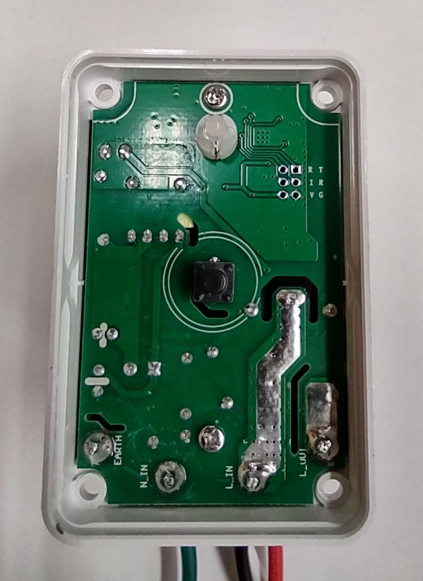

    Then if you remove 2 more screws you get to the top of the board.

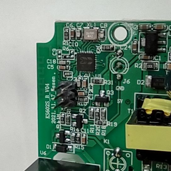

    There is a 2 X 6 X 2mm PCB hole layout that can be used for flashing. The first switch I soldered wires to the holes but for the others I actually soldered in a 2 X 6 header and left the header since there was plenty of room.
    The header labels refer to these pins on the MCU:
    T - Transmit
    R - Receive
    G - Ground
    R - CEN
    I - No Connection
    V - 3.3 volts
    As usual the Transmit goes to Receive on the USB - Serial adapter and Receive goes to Transmit on the adapter. Make sure you are using a 3.3 volt adapter and connect V and G to the appropriate connections on the USB adapter. For the R terminal I used a single wire.

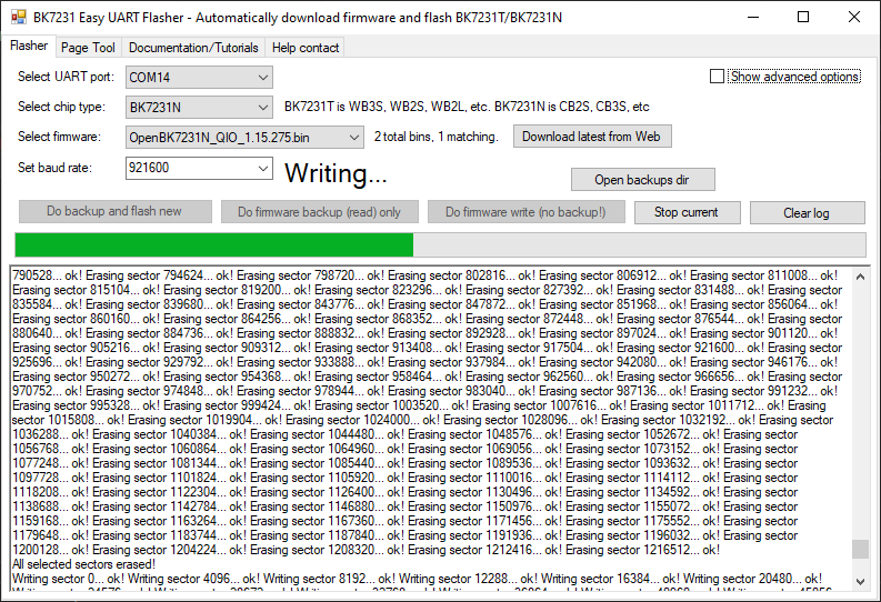

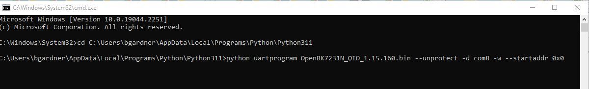

    Once you are wired up and ready to go it's time to flash. I already had Python installed on my PC so I just installed hid_download_py and then moved the bin flash into the same directory as uartprogram. Once I had all that set up I opened the command line window and changed the default directory to the uartprogram directory and entered the flash command.

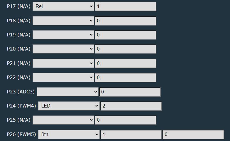

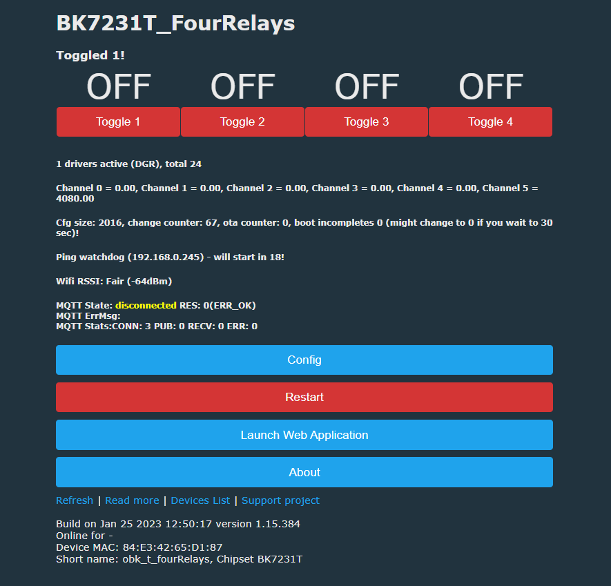

    After pressing enter, I briefly touched the CEN pin wire to ground and the flash started. Once completed, I followed the standard procedure to log into the temporary access point and configure the WiFi settings. Then I determined the IP address assigned by my router and logged into the switch. It was then a simple matter to configure the correct pins as below:

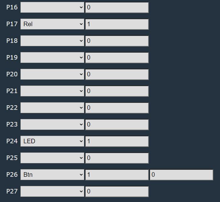

    P17 - Relay - channel 1
    P24 - LED - channel 2
    P26 - Button - channel 1

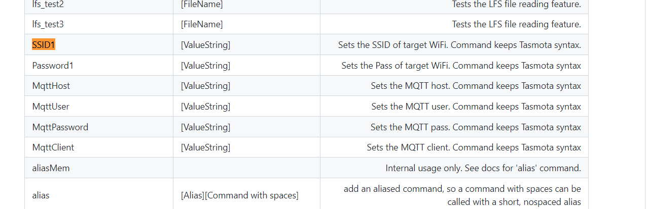

    After saving these setting, I configured the MQTT settings and I was ready to go. I was able to control the switch via MQTT through my home control system and was even able to set up device groups which greatly simplified setting up 3 way switches.

    I used the BK7231 Easy UART Flasher on my PC and successfully flashed the file: OpenBK7231N_QIO_1.15.384.bin.
    When the upload finished, I restarted the device and got the device AP. I pointed my browser to 192.168.4.1 and I entered my network credentials.
    Then, nothing. When I rebooted the device, the MAC address was not found in my IP scanner (Advanced IP Scanner).
    Thinking that I may have made an error with my network credentials, I flashed it again using "Do firmware write". Now, when I reboot the device I do not see the device AP in my phone's "Available networks".
    Any tips would be appreciated.

    @mannsteve what kind of device do you have? What is in the serial log? Use TX2 pin with 115200 baud to see what device logs.
    EDIT initial test shows that 384 works for me, no surprises here.... I will investigate more:

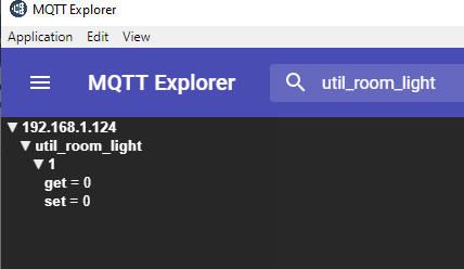

    What are the MQTT commands to turn the switch on or off?
  • #11 20407162
    bgardner46
    Posts: 26
    To turn the switch on you would use "topic/1/set 1"
    To turn the switch off you use "topic/1/set 0"
    Without the quotes and topic is whatever name you gave the switch.
    Bob
  • Relay GPIO mapping may differ from reference switch
    #12 20407262
    mannsteve
    Posts: 16
    Bob
    Thanks. That's what I thought watching the get command on MQTT explorer, but I can't control it with a publish. Is there a status command?
    I am connected to the MQTT broker or I wouldn't be able to publish the get command.
    The button on the switch, and the toggle button on the menu page just toggle the LED from green to red. The relay does nothing.
    Could the GPIO pins in my switch be different than yours?
    Any ideas would be appreciated.
    You are most likely using an older version (didn't do OTA to latest) and you didn't reboot device after changing MQTT topic?
    But.. I will just note that we also support Tasmota syntax, as said in project subtitle, so you can do:
    cmnd/obkFFBBCCAADD/POWER
    with argument
    and it should work as well.
    Or POWER2, etc,. Please try.
    both cmnd and set/get are working
  • #14 20407323
    bgardner46
    Posts: 26
    You should also set the LED to 2 instead of 1 and you get individual control of the relay and the led.
    Bob
    Many thanks. The switch is now working using MQTT commands.

What hardware does the Kuled KS-602S/K36 switch use?
It uses a BK7231N Wi-Fi MCU with 2 MB of on-chip flash memory and exposes a 2 × 6-pin 2 mm header for UART flashing [Elektroda, bgardner46, post #20355154]

Windows users can pick Easy UART Flasher v1.0.4 or bkWriter 1.60; Linux/macOS users can run hid_download_py with uartprogram.py [Elektroda, p.kaczmarek2, post #20404005]
What GPIO roles work for the KS-602S?
Set P17 → Relay (channel 1), P24 → LED_n (channel 2), P26 → Button (channel 1). Use LED role 2 to control relay and LED separately [Elektroda, bgardner46, #20355154; #20407323].

Run “Erase All”, flash firmware again, and restore the RF partition in Web-App → Flash tab; a missing RF table usually blocks Wi-Fi [Elektroda, Phrede, #20440060; p.kaczmarek2, #20440218].
