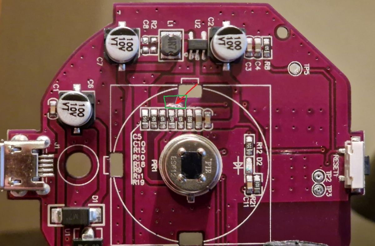

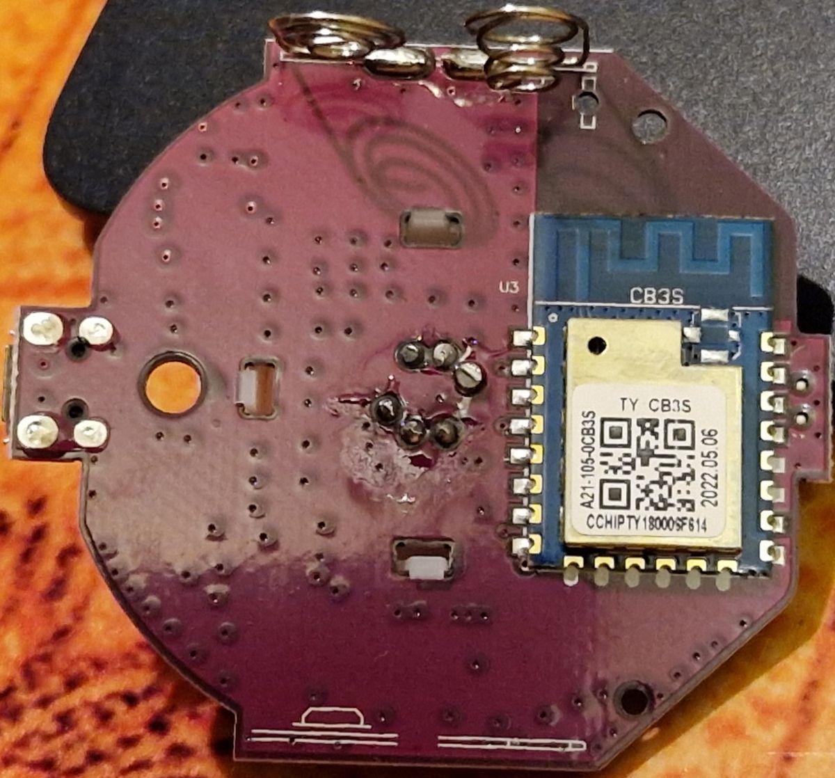

    Hello!
    Recently I started to dive into the IoT topic and at the moment I'm dealing with:
    Name: Tuya Smart WiFi Wireless Ceiling PIR Infrared Movement Motion Detector
    Model: PST-HW400B
    Tuya Smart WiFi Ceiling PIR Motion Detector PST-HW400B: Pin Configuration & Power Saving Tips
    This is how it looks inside:

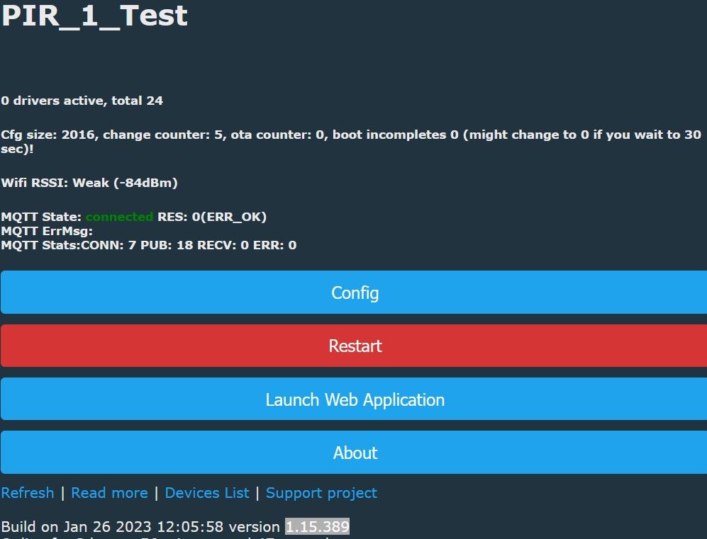

    Using "tuya-cloudcutter" I was able to install "OpenBK7231N_UG_1.15.365.bin" firmware to it by Wi-Fi without soldering and UART.
    After that I updated to version 1.15.389 through OTA using WebApplication and connected to MQTT broker. It seems that this device is without TuyaMCU.
    My question is how can I figure out what pins are used for?
    I'm going to use this device as PIR with external power supply unit. But it would be good to understand how to configure "deep power saving" and battery level on this device.

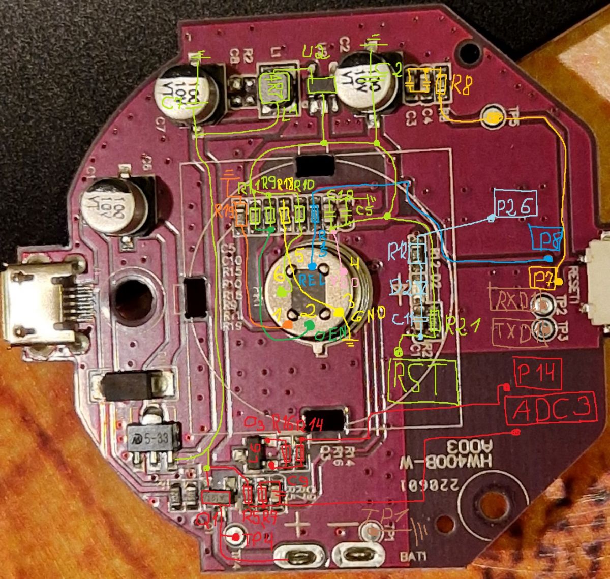

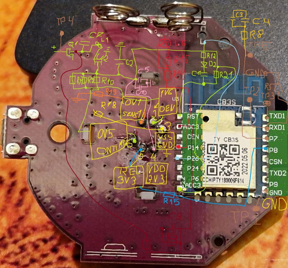

    It is not so easy a task to track the connection between pins. Some of the traces are located under elements. Okay let's moving forward step by step.
    At the moment I was able to trace some connections and made some voltage measurements. This is a draft and if something is not clear please ask the question.
    PIR BS612 module - voltage measurements - connection
    1(SENS) - 0v1
    2(OEN) - 1v6
    3(VSS) - 0 (GND)
    4(VDD) - 3v3
    5(REL) - 3v3 -> R15 -> CB3S (pin 13) P8
    6(ONTIME) - 0v5
    My electronic skills are not so good. This is what I was able to trace and show on the PCB.
    Up side
    Down side

    Very good reverse engineering. My only question would be, why do you have ADC3 twice?
    Hmm CB3S docs clearly shows which pin is which Px role.
    If you think that, for example, P26 is a input of PIR sensor, they you can try setting P26 role to "dInput" and then watch channel 0 value on Gui (it should show up), is it changing to 1 if you try to trigger sensor?

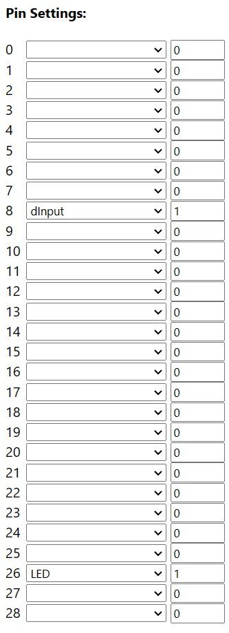

    Regarding PIR, as I understand correctly it is not so simple it is working on 3V. Please check the link.
    https://evelta.com/pyroelectric-infrared-sensor-6pin-3v/
    According to my investigations PIR pin 5(REL) connected to CB3S pin 13 (with mark P8) through resistor R15.
    I made measurements and I see 3.3v on PIR pin 5 (REL) and CB3S pin P8 constantly.
    Unfortunately I can't receive any output from the PIR. I was trying to configure "dinput", "dinput_n", "dInput_noPullUp" and "dInput_noPullUp_n" in configurator for field P8.
    I was able to light the diode assigning LED_n to P26.

    Thanks for your assistance!
    Now I know how this PIR PIN's should be configured to send information about motion detection.
    It took some time, because of PIR behavior. When PIR reacts to motion it changes signal on Channel1 from 0 to 1 and holds it for 30 seconds approximately.
    According to my understanding to make this time shorter I need to cut off resistor R10 and connect PIR PIN 6 (ONTIME) to GND. Then ONTIME should be 2 seconds. Can you comment this?

    It is enough to disconnect power from resistor R10 and now ONTIME is 2 seconds. This means that when motion is finished value for Channel1 will be set back to 0 in 2 seconds instead of 30 seconds.
