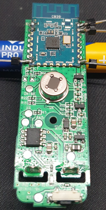

    I recently bought this motion sensor: https://aliexpress.com/item/1005007542667555.html
    I received it today, backed up its firmware and flashed OpenBeken on it which worked flawlessly. I tried to figure out pins using GPIO finder but while the PIR / LED responded to me being in its FOV / not, neither of the GPIOs had any I/O - I then manually had a look and it seems like the only connections are RX/TX to a secondary MCU (So probably TuyaMCU) AND there is a transistor on GND of the WB3S which turns it off / on (I guess this is how they achieve low idle power instead of just using deep sleep...... smh) that's also controlled by the secondary MCU
    Has somebody here dealt with a device similar to this? I have not yet bothered to hook up my logic analyzer to make sense of it.
    Electronic motion sensor with PCB and WB3S module.

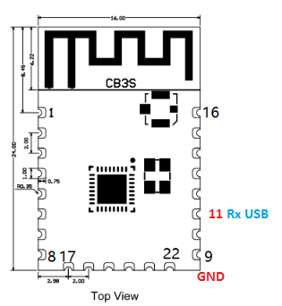

    Can you connect the USB adapter to pin 11 of CB3S? Restart the device and show the captured Log?
  • #5 21352836
    Kinsi55
    Level 4  
    Posts: 22
    I tried, unfortunately my Serial board resets whenever I power the Sensor from it and I don't have another 3.3v source handy right now - How would the information be of use seeing as I seem to have figured it out?
  • Serial log capture at 9600 or 115200 bps
    #6 21353078
    spin55
    Posts: 209
    Help: 17
    Rate: 42
    Only connect the Rx Cable from the USB Adapter to pin 11 of the CB3S and the GND cable from the Adapter to the GND of the board or (-) of the power supply. Open Realterm or equivalent program (for example Arduino serial port reader) set the transfer speed to 9600 bps. Get started and capture and publish the Arduino or Realterm Log. If no readable information appears, you may have to change the speed to 115200 bps.
    Diagram of CB3S module with pin labeling.

    Info:TuyaMCU:Received: 55 AA 00 01 00 24 7B 22 70 22 3A 22 72 6A 7A 6F 6E 39 6B 79 78 70 6F 65 6B 73 6A 33 22 2C 22 76 22 3A 22 31 2E 30 2E 30 22 7D 26
    Info:TuyaMCU:ProcessIncoming[v=0]: cmd 1 (QueryProductInformation) len 43
    Info:TuyaMCU:ParseQueryProductInformation: received {"p":"rjzon9kyxpoeksj3","v":"1.0.0"}
    Info:TuyaMCU:Received: 55 AA 00 08 00 0C 00 02 02 02 02 02 02 01 04 00 01 01 26
    Info:TuyaMCU:ProcessIncoming[v=0]: cmd 8 (QueryState) len 19
    Info:TuyaMCU:V0_ParseRealTimeWithRecordStorage: processing id 1, dataType 4-enum and 1 data bytes
    Info:TuyaMCU:V0_ParseRealTimeWithRecordStorage: byte 1
    Info:TuyaMCU:Received: 55 AA 00 05 00 05 03 04 00 01 02 13
    Info:TuyaMCU:ProcessIncoming[v=0]: cmd 5 (WiFiSelect) len 12
    Info:TuyaMCU:V0_ParseRealTimeWithRecordStorage: processing id 3, dataType 4-enum and 1 data bytes
    Info:TuyaMCU:V0_ParseRealTimeWithRecordStorage: byte 2

    Different DPs and 10-second motion reporting behavior
    #10 21767934
    wpSolution
    I have the same sensor. It took me a couple of days to figure it out. Apparently identical sensors have different DPs! This is misleading because autoexec.bat depends on it. Also confusing is the sensor's response time. To report movement, the sensor needs to send information for about 10 seconds and then go to sleep. After 30 seconds, it wakes up to check for more movement. If there is movement, it sends 0; if the movement has stopped, it sends 1. Below is my configuration and links to threads that helped me; I hope this is helpful.
    https://www.elektroda.com/rtvforum/topic4053536.html
    https://www.elektroda.com/rtvforum/topic4092861.html
