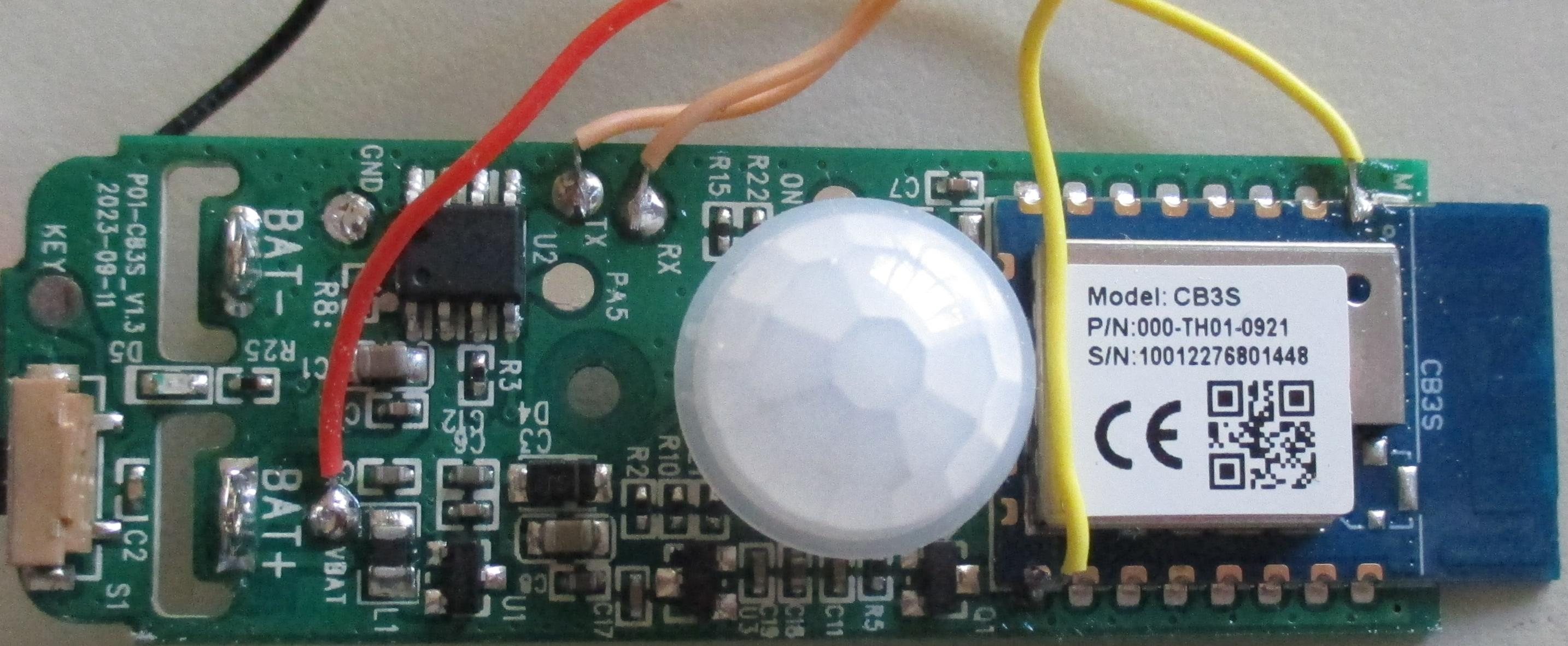

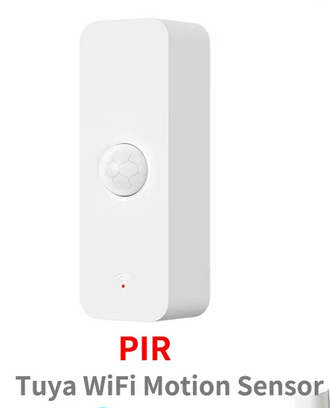

    Anyone dug into this battery-powered PIR Tuya device? The PIR output signal seems to only go into the TuyaMCU so I'm not sure how to configure it. Maybe someone has some ideas.
    Here is the picture of the device:
    White PIR motion sensor from Tuya with a visible round detection element.
    Here is the board showing the PIR, the 8-pin TuyaMCU (might be a Holtek part), and the CB3S:
    PCB with PIR sensor, TuyaMCU, and CB3S module.

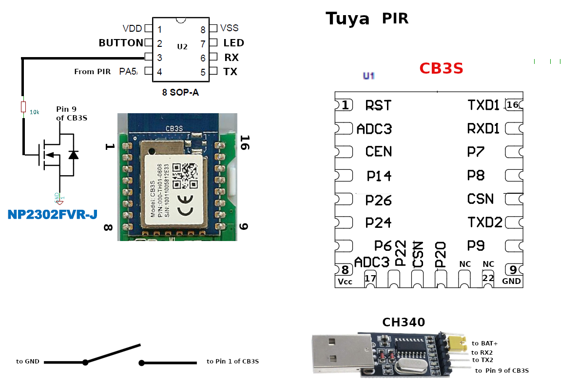

    And lastly, my guess at a rough schema of the important parts.
    Tuya PIR circuit diagram with CB3S and CH340
    Note that I was able to flash the CB3S without unsoldering anything, but I had to use the CB340 USB-Serial. I'm guessing it has a higher drive capability to overcome the TuyaMCU's TX drive. Also, during my testing, I found that it doesn't work very well outside as any tree branch waving around in the wind seems to set it off. I realize the product states that it is not waterproof and thus not to be used outside, but I thought I could put it in a box.

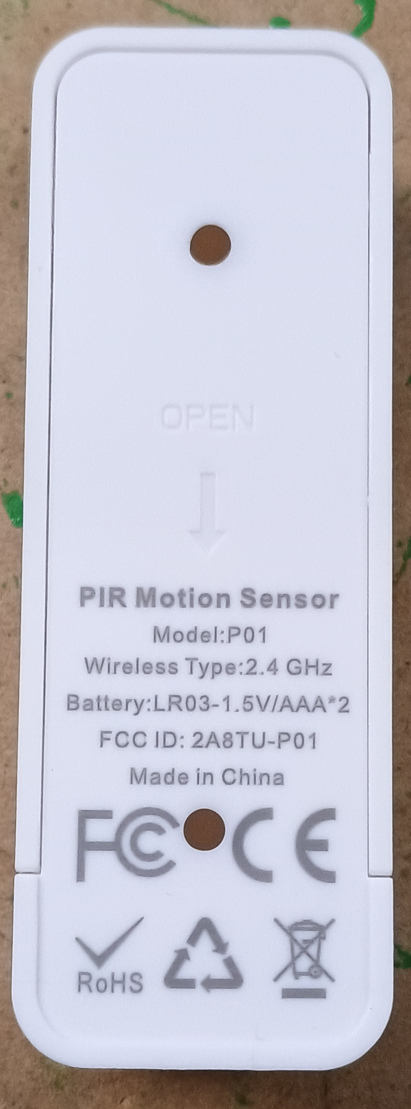

    I bought this simple motion detector.
    [BK7231N] [CB3S] P01 Tuya PIR Motion Sensor Configuration and Outdoor Use Issues[BK7231N] [CB3S] P01 Tuya PIR Motion Sensor Configuration and Outdoor Use Issues
    https://www.aliexpress.com/item/1005006246106212.html
    Is it possible that the P01 isn't in the device list yet?
    The app is Tuya.
    It is sold under the model code P01.
    At https://iot.tuya.com/, the device is displayed with this product name: 001P02CB3S
    It is based on the CB3S.
