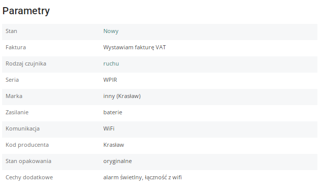

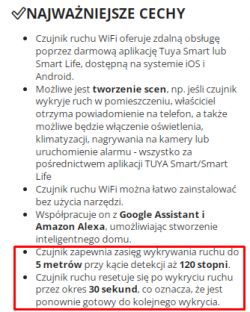

    Parameters, no specifics here:
    [CBU/BK7231N] Tuya PIR motion sensor Krasław 120°, deep sleep, battery powered
    Only in the features can we read, for example, that the sensor "holds" presence detection for 30 seconds, or at what distance it can detect:

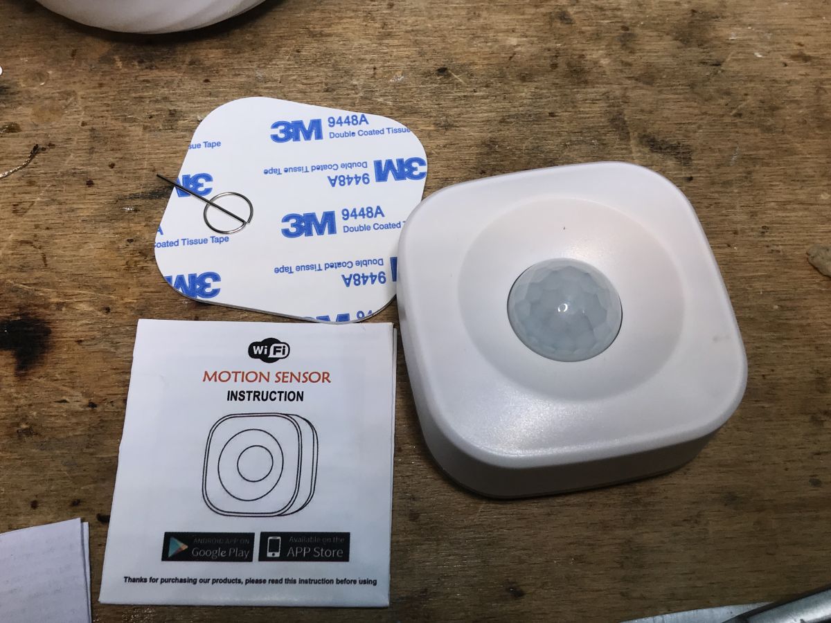

    Here's what we got in the kit:
    There is a tape and a reset key.
    The product also has a hook to stick to the wall (this is the tape), and after removing it, we have access to the battery, the ON-OFF button and the reset button (i.e. pairing):

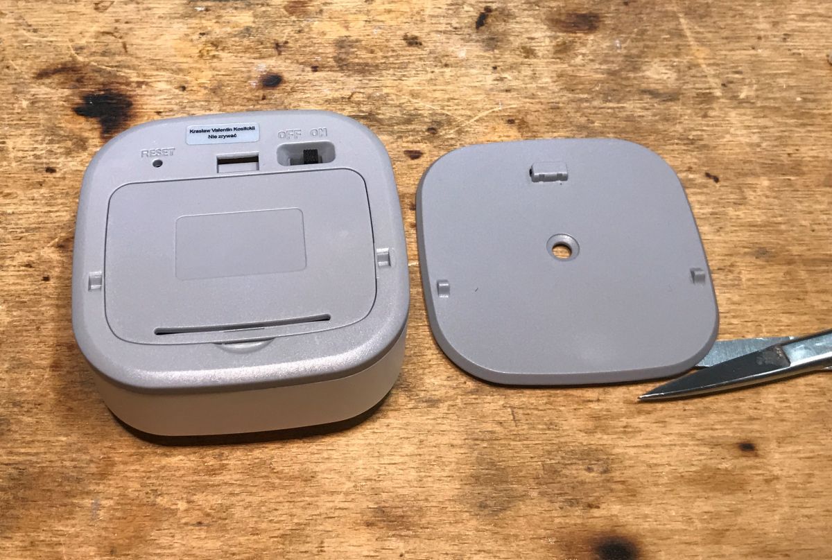

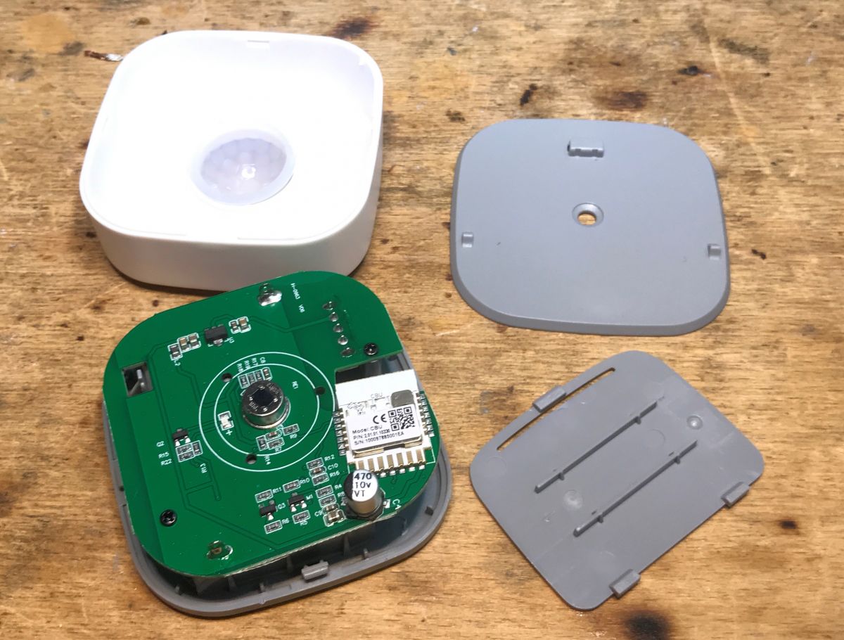

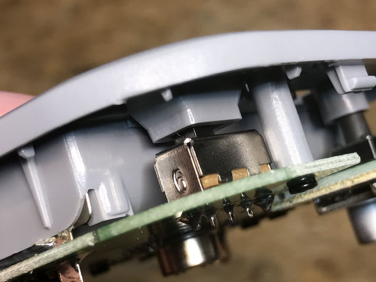

    The teardown of the sensor
    Apparently the sensor has a warranty seal from the seller, but it is glued in such a way we don't have to remove it.

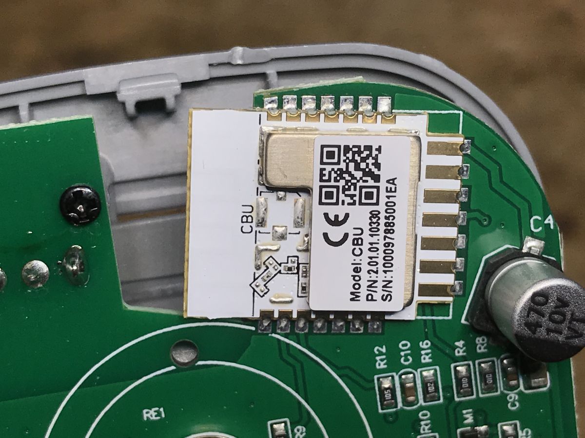

    There is a module inside CBU , its documentation is on the Tuya website, a OpenBeken supports BK7231N.

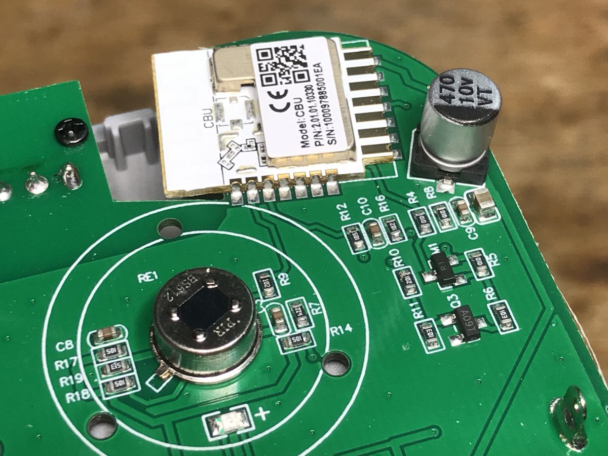

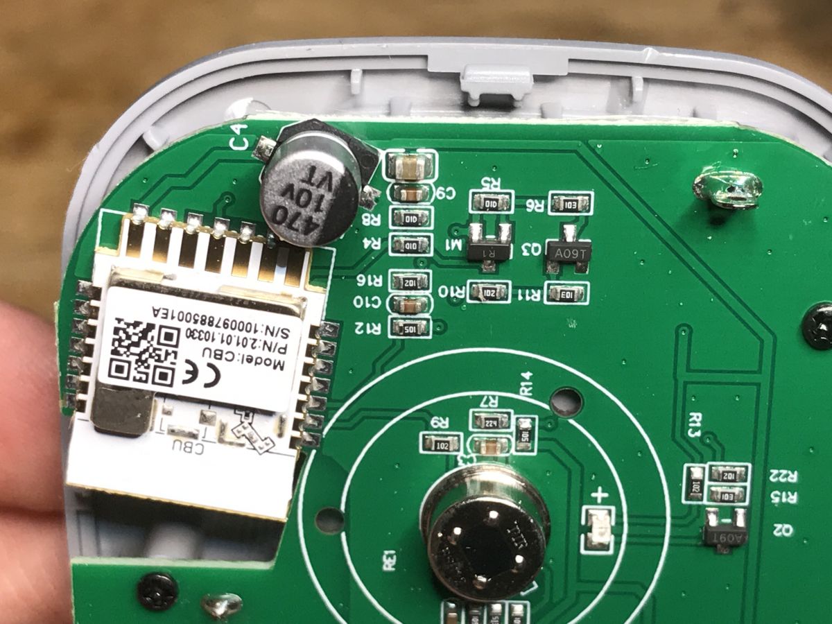

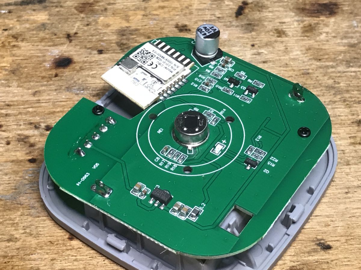

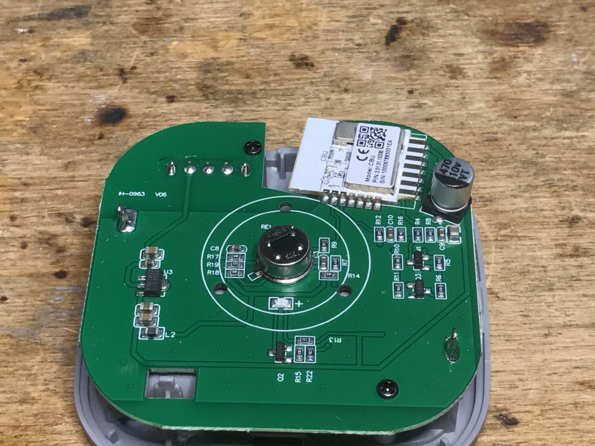

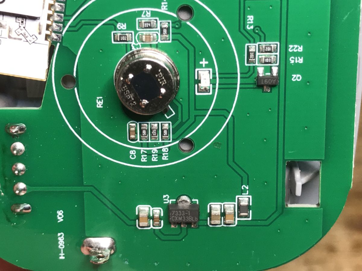

    Let's take a look at the board:
    [CBU/BK7231N] Tuya PIR motion sensor Krasław 120°, deep sleep, battery powered [CBU/BK7231N] Tuya PIR motion sensor Krasław 120°, deep sleep, battery powered [CBU/BK7231N] Tuya PIR motion sensor Krasław 120°, deep sleep, battery powered [CBU/BK7231N] Tuya PIR motion sensor Krasław 120°, deep sleep, battery powered [CBU/BK7231N] Tuya PIR motion sensor Krasław 120°, deep sleep, battery powered
    Not much happens on this board. The PIR sensor is typical, such as in popular modules for Arduino. My attention was caught by the U3 chip, i.e. 7333, 3.3V LDO regulator. I thought that there would be a slightly more efficient step down converter here, but no. All in all, it makes some sense, here there are three nominally 1.5V batteries, i.e. 4.5V in total, of course less and less with their discharge. Tuya battery powered products with converters instead of regulators are rather two batteries, then there is 3V, and the converter increases them to 3.3V.
    The on-off button allows you to turn off the sensor completely without removing the battery:
    Transistors R1 and A09T, whose roles I have not analyzed:
    CBU:
    This device does not use TuyaMCU. There is no additional microcontroller here, nothing is blocking UART1 from the CBU. The CBU controls everything by itself and falls into a deep sleep when nothing happens. This device wakes up and connects to WiFi only when a status needs to be reported.

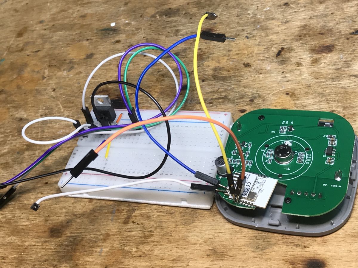

    We connect the common ground, RX and TX from the UART converter and possibly the power supply, start the flasher, and do the power cycle (off and on). Everything as described in our repo:
    The same process can be seen on our YT channel:
    Soldered wires:

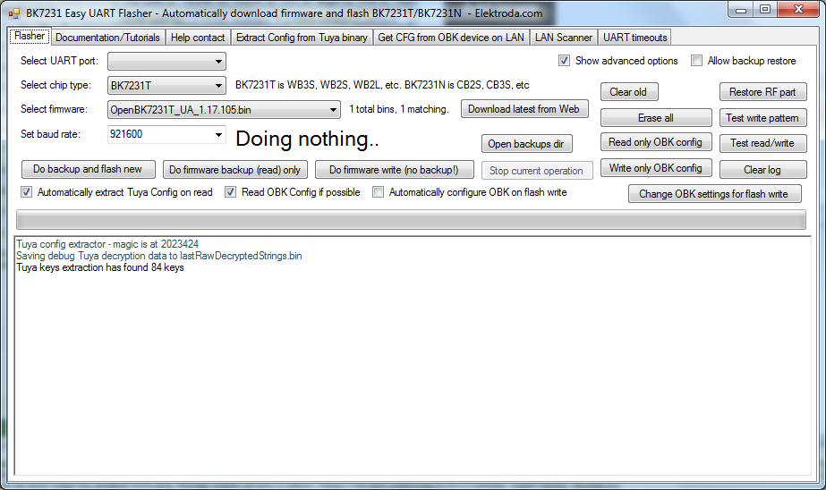

    Flasher in motion:

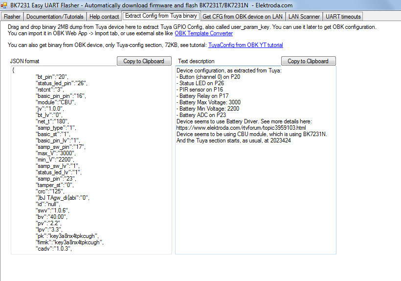

    Flasher can also read Tuya configuration:
    Here we have the JSON from Tuya, their device description format:
    Text description of the same from my flasher:
    - Button (channel 0) on P20
    - Status LED on P26
    - PIR sensor on P16
    - Battery Relay on P17
    - Battery Max Voltage: 3000
    - Battery Min Voltage: 2200
    - Battery ADC on P23
    Device seems to use Battery Driver. See more details here: https://www.elektroda.com/rtvforum/topic3959103.html
    Device seems to be using CBU module, which is using BK7231N.
    Partially finished template in our JSON format:
    Let's analyze what we've got here. First, there's the pairing button, Button, on the P20. There is a WiFi LED here on the P26. There is a PIR sensor on the P16. And we have a battery status control system, i.e. ADC + GPIO which turns on the resistor divider. These GPIOs are there to save energy and to make the resistor divider only let current when we make a measurement. Tuya also determines the maximum and minimum battery voltages, it is used for calculations.

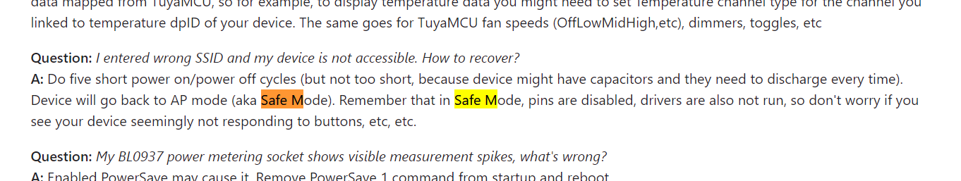

    So you already accessed OBK on the OBK config page?
    Well, then try to enter safe mode:
    Screenshot from OpenBK7231T FAQ documentation with instructions for enabling safe mode.
    https://github.com/openshwprojects/OpenBK7231T_App/blob/main/docs/faq.md
  • #11 20970513
    lambuzz
    I was able to access OBK config page.
    I did the 5 quick power on/off on both device but nothing happened. I tried multiple times
  • #12 20970622
    Posts: 14635
    Help: 655
    Rate: 12649
    Have you already entered a deep sleep command for that device? Maybe it's asleep?
  • #13 20970673
    lambuzz
    The only thing I updated once I flashed OBK is in the wifi settings. I added the SSID and password and I clicked on Submit. This made me confirmed I entered the correct information. and then it turned off and never rebooted. not even the light
  • #14 20970703

    The safe mode really should work. It's designed in such a way that even if the AP connect crashes, safe mode will still kick in.
    Anyway, can you connect USB to UART converter to get log from TX2?

    Is your device the same as the one in the first post? Maybe your device is TuyaMCU based. That could complicate things. TuyaMCU battery powered devices have MCU controlling the power of WiFi module, so the MCU can power off the WiFi module unexpectedly.
    There aren't many much more options left. Try safe mode or get USB to UART converter and check what happens on debug log output - TX2. This will tell you whether device boots and when it breaks.

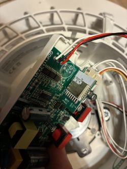

    I was able to backup and flash a tuya PIR sensor as described in this topic (see backup attached). Unfortunately I am not able to connect to the openBK wifiAP afterwards: although it appears as available I cannot connect to the AP.
    Any suggestions would be highly appreciated!

    What is the debug log output at TX2?

    gramais wrote:
    see backup attached
    Backup is from TuyaMCU device. Maybe MCU is turning it off before you can get to AP
