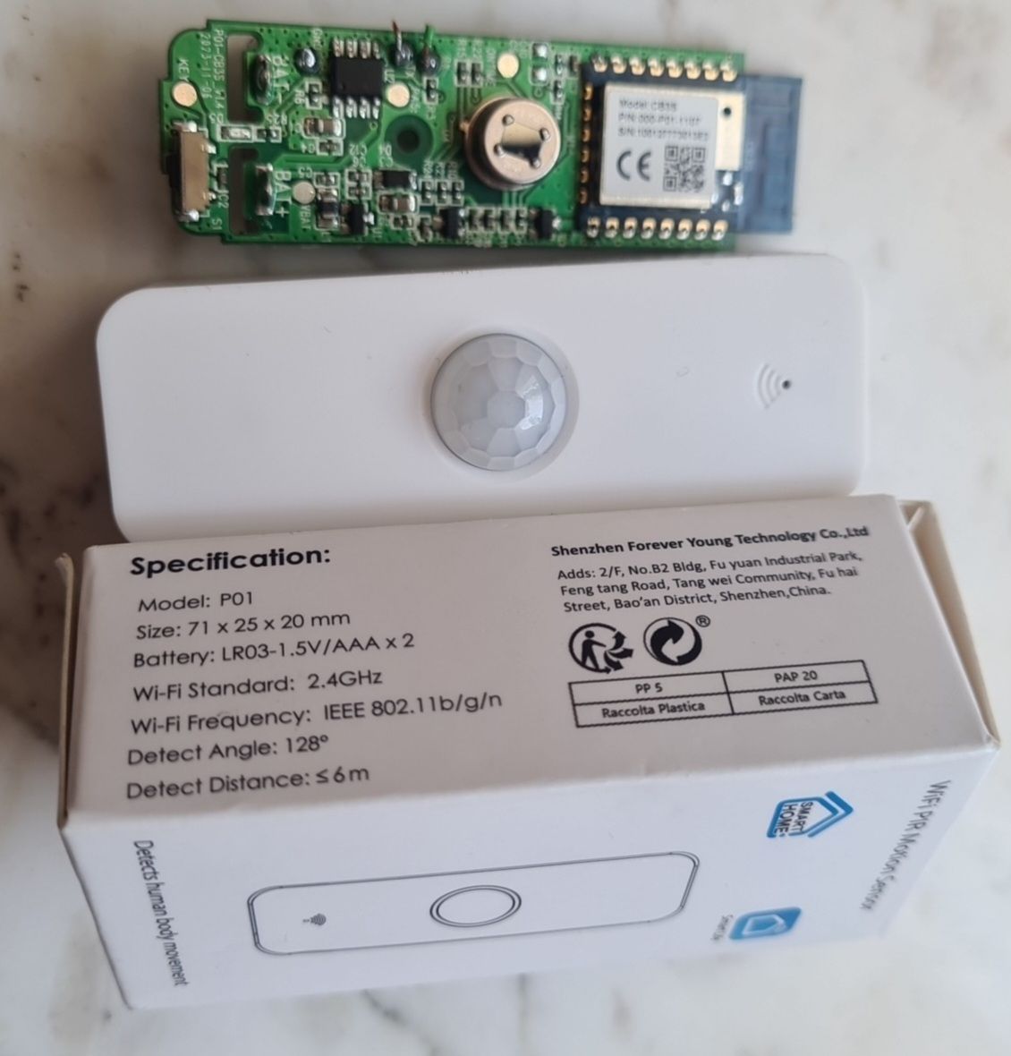

    Still a bit off the fringe of this thread: is that board from another (battery-powered) PIR sensor, whose photo I pasted earlier, surely it could be a TuyaMCU? That extra chip on the board (without any lettering) has only 8 legs. In all the threads about tuyaMCUs, however, these are quite large chips.
    Image of an electronic module with components on a circuit board, including a CB3S module. .
    But undoubtedly the device puts you to sleep somehow, because as I mentioned, even the flashing was intermittent until I plugged directly into the CB3S.
    Electronic module and packaging of a PIR sensor. .

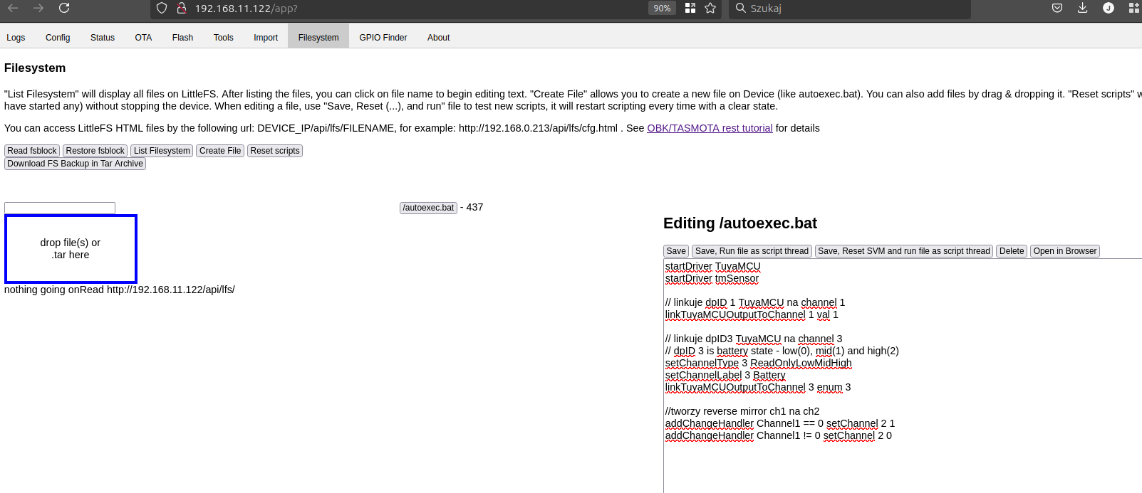

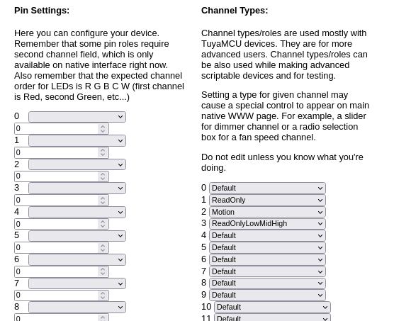

    working configuration (already after uploading OpenBeken)
    1. so that the sensor does not go to sleep every few seconds, we lock the reset button in the pressed position

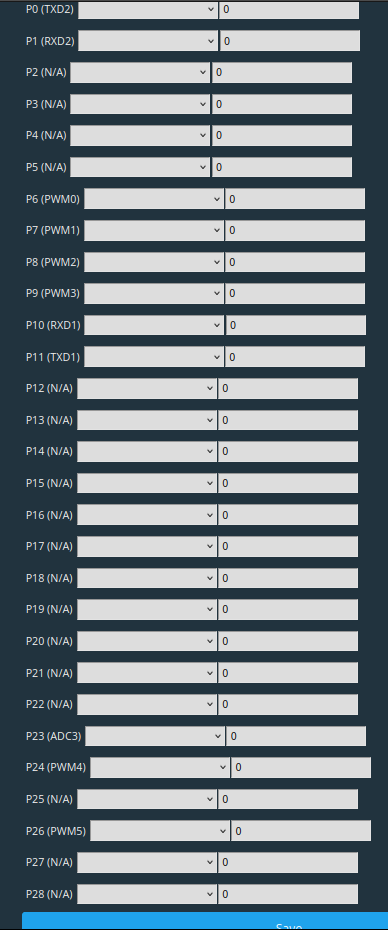

    2. we do not configure any pins directly in OpenBeken, as everything is controlled by the external TuyaMCU chip
    3. via WebApp we upload autoexec.bat
    startDriver TuyaMCU
    startDriver tmSensor
    // linkuje dpID 1 TuyaMCU na channel 1
    // linkuje dpID3 TuyaMCU na channel 3
    // dpID 3 is battery state - low(0), mid(1) and high(2)
    setChannelType 3 ReadOnlyLowMidHigh
    setChannelLabel 3 Battery
    linkTuyaMCUOutputToChannel 3 enum 3
    //tworzy reverse mirror ch1 na ch2
    addChangeHandler Channel1 == 0 setChannel 2 1
    addChangeHandler Channel1 != 0 setChannel 2 0

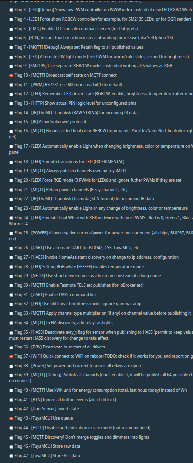

    4. set flags 10, 37, 43
    5. set all other parameters for our system: wifi, ip, mqtt, etc.
    Screenshot of initial start value settings for channels in the OpenBeken system. List of available configuration flags in OpenBeken system for TuyaMCU devices. OpenBeken web interface with autoexec.bat file editing. Screenshot of pin configuration in OpenBeken software. .

    #2 21076988
    Posts: 14753
    Rate: 12875
    It could be the TuyaMCU, but more testing would need to be done:
    - is the UART RX1 and TX1 connected to this circuit in SO8? If so, it's probably TuyaMCU
    - does this transistor Q1 switch on the power supply to the WiFi module? If so, it's probably TuyaMCU turning off the WiFi module with it
    - does the read 2MB config (or just the Tuya config partition) have a baud setting in Tuya JSON, or regular pins?
    - if you leave the device without moving it, is 3.3V is still on the VDD of the WiFi module, or does it disappear (see TuyaMCU unplugging the power supply with a transistor)
    - if you hook up a USB to UART converter, more precisely ground to ground and the RX of the converter to (at will) RX1 or TX1 of the WiFi module, are you able to receive on 9600 or 115200 any communication, packets in the UART, e.g. in Realterm?

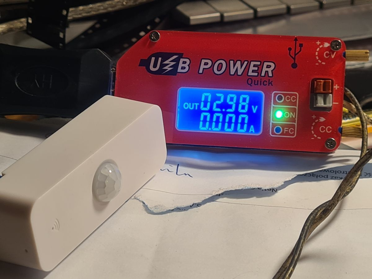

    Yes, it's TuyaMCU. It works quite nicely with such an autoexec.bat
    startDriver TuyaMCU
    setChannelType 1 Motion
    setChannelType 3 Readonly
    Interestingly, in the sleep state it doesn't draw any detectable current for my power supply. And yet it wakes up immediately when something moves. It's as if the PIR sensor is somehow internally powered - maybe a capacitor of some sort? Of course, it takes quite a while before the wifi connects and the sensor reports in MQTT - about 12s. In the excited state it takes 55-75mA.
    USB Power Quick board and PIR motion sensor on a desk.
  • #4 21077850
    Posts: 14753
    Rate: 12875
    Simply put, a small amount of current is drawn in the sleep state.

  • #5 21079983
    burba
    Posts: 44
    "linkTuyaMCUOutputToChannel" was there, it just cut it off for me when pasting. And the channel type turned out best to be "ReadOnlyLowMidHigh"
     startDriver TuyaMCU

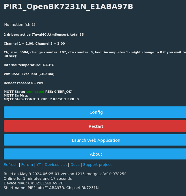

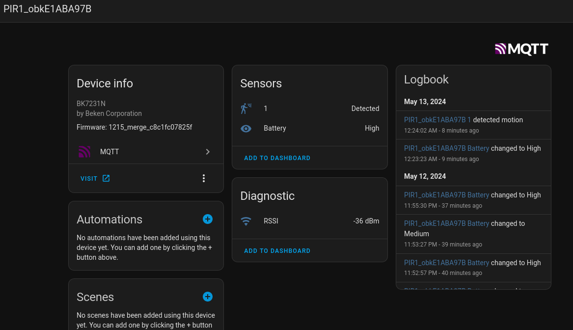

    Unfortunately, however, there is a problem with this PIR with TuyaMCU.
    I have observed that it works in the following way:
    -When motion is detected, the MCU activates the wifi module, connects to MQTT, reports sensor wake-up and goes to sleep
    After 30 seconds, it wakes up again, connects to MQTT, reports no motion
    -puts to sleep until the next motion is detected
    Theoretically.
    The problem is that for HA the sensor has a status of "detected" all the time. The sensor's OBK web page, on the other hand, correctly shows "no motion" after 30s, and remains in this status until the next motion detection.
    User interface for the PIR1_OpenBK7231N_E1ABA97B sensor showing no motion status and available configuration options. Interface screen of a PIR device with MQTT and Home Assistant issues.
    I've looked in the logs - and there's something I don't like here:
    Info:GEN:CHANNEL_Set channel 3 has changed to 2 (flags 0)
    Info:MQTT:Channel has changed! Publishing 2 to channel 3
    Info:MQTT:Publishing val 2 to obkE1ABA97B/3/get retain=0
    Info:GEN:No change in channel 1 (still set to 0) - ignoring
    Info:MQTT:Publishing val OpenBK7231N 1215_merge_c8c1fc07825f May 9 2024 06:25:07 to obkE1ABA97B/build retain=0
    Info:GEN:CHANNEL_Set channel 1 has changed to 1 (flags 0)
    Info:MQTT:Channel has changed! Publishing 1 to channel 1
    Info:MQTT:Publishing val 1 to obkE1ABA97B/1/get retain=0
    It appears to me that:
    1. the battery level (channel 3) is reported as "changed" every time. - even though it doesn't actually change (this of course doesn't interfere with anything)
    2. the PIR status (channel 1) is only actually reported to MQTT on this second connection, after 30s, after changing to the value "1", i.e. "no motion". On the other hand, when motion is detected (value "0"), the OBK ignores the change and does not send anything to MQTT, claiming that there was no change.
    3. The HA keeps the sensor status as "detected", because it treats the "1" and "0" values it gets from the OBK in reverse.

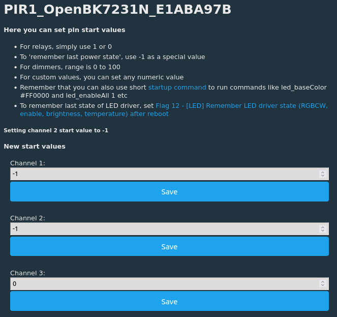

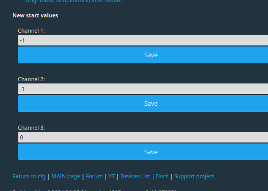

    #8 21080261
    Posts: 14753
    Rate: 12875
    The description of the problem indicates that you should set the initial channel values in Startup Config to -1, i.e. to 'remember last state'. This will ensure that the module remembers the previous state and reports changes correctly. Don't worry about the flash memory consumption, the variable writing system optimises the flash erase cycles (writes in blocks of 64 bytes and only when the page fills up it deletes it once)
    And if you don't want to do this remember, you can set the initial states e.g. to 999, then the change will also be reported.
    After all, you would be wise to put the configuration in a separate topic....
  • #9 21081259
    burba
    Posts: 44
    Very cool it works with that "-1", thanks. Entering 999 would have some advantage?
    Only still a question of reversing the action - the status on the OBK website shows motion/no motion correctly, and HA the other way around. Is it possible to do this on foot somehow? Would a new Motion_Inv channel type be needed?

    Info:MAIN:Time 10, idle 0/s, free 73080, MQTT 0(0), bWifi 0, secondsWithNoPing -1, socks 2/38
    Info:GEN:dhcp=0 ip=0.0.0.0 gate=0.0.0.0 mask=0.0.0.0 mac=b8:06:0d:2c:e5:4e
    Info:GEN:sta: 0, softap: 0, b/g/n
    Info:MAIN:Time 11, idle 87232/s, free 73552, MQTT 0(0), bWifi 1, secondsWithNoPing -1, socks 2/38
    Info:TuyaMCU:Received: 55 AA 00 02 00 00 01
    Info:TuyaMCU:ProcessIncoming[v=0]: cmd 2 (MCUconf) len 7
    Info:TuyaMCU:ProcessIncoming: TUYA_CMD_MCU_CONF, TODO!
    Info:MAIN:Time 12, idle 276680/s, free 73592, MQTT 0(0), bWifi 1, secondsWithNoPing -1, socks 2/38
    Info:MAIN:Time 13, idle 189005/s, free 73592, MQTT 0(1), bWifi 1, secondsWithNoPing -1, socks 2/38
    Info:MAIN:Time 14, idle 185902/s, free 73592, MQTT 0(1), bWifi 1, secondsWithNoPing -1, socks 2/38
    Info:TuyaMCU:Received: 55 AA 00 05 00 05 03 04 00 01 01 12
    Info:TuyaMCU:ProcessIncoming[v=0]: cmd 5 (WiFiSelect) len 12
    Info:TuyaMCU:V0_ParseRealTimeWithRecordStorage: processing id 3, dataType 4-enum and 1 data bytes
    Info:TuyaMCU:V0_ParseRealTimeWithRecordStorage: byte 1
    Info:GEN:CHANNEL_Set channel 3 has changed to 1 (flags 0)
    Info:MQTT:Channel has changed! Publishing 1 to channel 3
    Info:CFG:####### Boot Count 90 #######
    Warn:CFG:CFG_InitAndLoad: Correct config has been loaded with 3 changes count.
    Info:MAIN:Main_Init_Delay
    Info:MAIN:Using SSID [Cottage]
    Info:MAIN:Using Pass [*****]
    Info:MQTT:MQTT_RegisterCallback called for bT obk0D2CE54E/ subT obk0D2CE54E/+/set
    Info:MQTT:MQTT_RegisterCallback called for bT bekens_n/ subT bekens_n/+/set
    Info:MQTT:MQTT_RegisterCallback called for bT cmnd/obk0D2CE54E/ subT cmnd/obk0D2CE54E/+
    Info:MQTT:MQTT_RegisterCallback called for bT cmnd/bekens_n/ subT cmnd/bekens_n/+
    Info:MQTT:MQTT_RegisterCallback called for bT obk0D2CE54E/ subT obk0D2CE54E/+/get
    Info:MAIN:Started TuyaMCU.
    Info:MAIN:Started tmSensor.
    Info:GEN:Channel 3 type changed to ReadOnlyLowMidHigh
    Info:EVENT:CMD_AddChangeHandler: added Channel1 with cmd setChannel 2 1
    Info:EVENT:CMD_AddChangeHandler: added Channel1 with cmd setChannel 2 0
    Info:MAIN:Time 1, idle 271479/s, free 78608, MQTT 0(0), bWifi 0, secondsWithNoPing -1, socks 2/38
    Info:TuyaMCU:Received: 55 AA 00 01 00 24 7B 22 70 22 3A 22 72 6A 7A 6F 6E 39 6B 79 78 70 6F 65 6B 73 6A 33 22 2C 22 76 22 3A 22 31 2E 30 2E 30 22 7D 26
    Info:TuyaMCU:ProcessIncoming[v=0]: cmd 1 (QueryProductInformation) len 43
    Info:TuyaMCU:ParseQueryProductInformation: received {"p":"rjzon9kyxpoeksj3","v":"1.0.0"}
    Info:MAIN:Time 2, idle 189972/s, free 78608, MQTT 0(0), bWifi 0, secondsWithNoPing -1, socks 2/38
    Info:MAIN:Time 3, idle 190996/s, free 78608, MQTT 0(0), bWifi 0, secondsWithNoPing -1, socks 2/38
    Info:MAIN:Time 4, idle 192015/s, free 78608, MQTT 0(0), bWifi 0, secondsWithNoPing -1, socks 2/38
    Info:MAIN:Time 5, idle 191682/s, free 78608, MQTT 0(0), bWifi 0, secondsWithNoPing -1, socks 2/38
    Info:MAIN:ssid:Cottage key:ghtrhtr
    Info:MAIN:Time 6, idle 183352/s, free 73088, MQTT 0(0), bWifi 0, secondsWithNoPing -1, socks 2/38
    Info:MAIN:Time 7, idle 192621/s, free 73088, MQTT 0(0), bWifi 0, secondsWithNoPing -1, socks 2/38
    Info:MAIN:Time 8, idle 90337/s, free 73080, MQTT 0(0), bWifi 0, secondsWithNoPing -1, socks 2/38
    Info:MAIN:Time 9, idle 0/s, free 73080, MQTT 0(0), bWifi 0, secondsWithNoPing -1, socks 2/38
    Info:MAIN:Time 11, idle 85557/s, free 73552, MQTT 0(0), bWifi 1, secondsWithNoPing -1, socks 2/38
    Info:MAIN:Time 12, idle 186812/s, free 73592, MQTT 0(0), bWifi 1, secondsWithNoPing -1, socks 2/38
    Info:MAIN:Time 13, idle 188804/s, free 73592, MQTT 0(1), bWifi 1, secondsWithNoPing -1, socks 2/38
    Info:MAIN:Time 1, idle 269691/s, free 78608, MQTT 0(0), bWifi 0, secondsWithNoPing -1, socks 2/38
    Info:MAIN:Time 2, idle 190444/s, free 78608, MQTT 0(0), bWifi 0, secondsWithNoPing -1, socks 2/38
    Info:MAIN:Time 3, idle 190658/s, free 78608, MQTT 0(0), bWifi 0, secondsWithNoPing -1, socks 2/38
    Info:MAIN:Time 4, idle 192038/s, free 78608, MQTT 0(0), bWifi 0, secondsWithNoPing -1, socks 2/38
    Info:MAIN:Time 5, idle 192017/s, free 78608, MQTT 0(0), bWifi 0, secondsWithNoPing -1, socks 2/38
    Info:MAIN:ssid:Cottage key:htrht
    Info:MAIN:Time 6, idle 185572/s, free 73096, MQTT 0(0), bWifi 0, secondsWithNoPing -1, socks 2/38
    Info:MAIN:Time 7, idle 182950/s, free 73096, MQTT 0(0), bWifi 0, secondsWithNoPing -1, socks 2/38
    Info:MAIN:Time 8, idle 84808/s, free 73088, MQTT 0(0), bWifi 0, secondsWithNoPing -1, socks 2/38
    Info:MAIN:Time 9, idle 0/s, free 73088, MQTT 0(0), bWifi 0, secondsWithNoPing -1, socks 2/38
    Info:MAIN:Time 10, idle 0/s, free 73088, MQTT 0(0), bWifi 0, secondsWithNoPing -1, socks 2/38
    Info:MAIN:Time 11, idle 86932/s, free 73576, MQTT 0(0), bWifi 1, secondsWithNoPing -1, socks 2/38
    Info:MAIN:Time 12, idle 192993/s, free 73616, MQTT 0(0), bWifi 1, secondsWithNoPing -1, socks 2/38
    Info:MAIN:Time 13, idle 193061/s, free 73616, MQTT 0(1), bWifi 1, secondsWithNoPing -1, socks 2/38
    Info:MAIN:Time 14, idle 195464/s, free 73616, MQTT 0(1), bWifi 1, secondsWithNoPing -1, socks 2/38
    Info:TuyaMCU:Received: 55 AA 00 08 00 0C 00 02 02 02 02 02 02 01 04 00 01 01 26
    Info:TuyaMCU:ProcessIncoming[v=0]: cmd 8 (QueryState) len 19
    Info:TuyaMCU:V0_ParseRealTimeWithRecordStorage: processing id 1, dataType 4-enum and 1 data bytes
    Info:EVENT:EventHandlers_ProcessVariableChange_Integer: executing command setChannel 2 0
    Info:GEN:No change in channel 2 (still set to 0) - ignoring
    Info:MAIN:Time 15, idle 182761/s, free 73616, MQTT 0(1), bWifi 1, secondsWithNoPing -1, socks 2/38
    Info:MAIN:Time 16, idle 182513/s, free 73616, MQTT 0(1), bWifi 1, secondsWithNoPing -1, socks 2/38
    Info:MAIN:Time 17, idle 190322/s, free 73616, MQTT 0(1), bWifi 1, secondsWithNoPing -1, socks 2/38
    in_Init_Before_Delay
    Info:CFG:####### Boot Count 93 #######
    Info:MAIN:Using Pass [htrhtt
    Info:MAIN:Time 1, idle 269388/s, free 78608, MQTT 0(0), bWifi 0, secondsWithNoPing -1, socks 2/38
    Info:MAIN:Time 2, idle 190520/s, free 78608, MQTT 0(0), bWifi 0, secondsWithNoPing -1, socks 2/38
    Info:MAIN:Time 3, idle 190999/s, free 78608, MQTT 0(0), bWifi 0, secondsWithNoPing -1, socks 2/38
    Info:MAIN:Time 4, idle 192002/s, free 78608, MQTT 0(0), bWifi 0, secondsWithNoPing -1, socks 2/38
    Info:MAIN:Time 5, idle 191957/s, free 78608, MQTT 0(0), bWifi 0, secondsWithNoPing -1, socks 2/38
    Info:MAIN:ssid:Cottage key:htrhtrht
    Info:MAIN:Time 6, idle 183281/s, free 73088, MQTT 0(0), bWifi 0, secondsWithNoPing -1, socks 2/38
    Info:MAIN:Time 7, idle 183163/s, free 73088, MQTT 0(0), bWifi 0, secondsWithNoPing -1, socks 2/38
    Info:MAIN:Time 8, idle 85109/s, free 73080, MQTT 0(0), bWifi 0, secondsWithNoPing -1, socks 2/38
    Info:MAIN:Time 11, idle 86780/s, free 73584, MQTT 0(0), bWifi 1, secondsWithNoPing -1, socks 2/38
    Info:MAIN:Time 12, idle 193630/s, free 73624, MQTT 0(0), bWifi 1, secondsWithNoPing -1, socks 2/38
    Info:MAIN:Time 13, idle 191770/s, free 73624, MQTT 0(1), bWifi 1, secondsWithNoPing -1, socks 2/38
    Info:MAIN:Time 14, idle 194158/s, free 73624, MQTT 0(1), bWifi 1, secondsWithNoPing -1, socks 2/38
    Info:TuyaMCU:Received: 55 AA 00 05 00 05 03 04 00 01 02 13
    Info:TuyaMCU:V0_ParseRealTimeWithRecordStorage: byte 2
    Info:MAIN:Using Pass [htrhtrht]
    Info:MAIN:Time 1, idle 271441/s, free 78608, MQTT 0(0), bWifi 0, secondsWithNoPing -1, socks 2/38
    Info:MAIN:Time 2, idle 190031/s, free 78608, MQTT 0(0), bWifi 0, secondsWithNoPing -1, socks 2/38
    Info:MAIN:Time 3, idle 191049/s, free 78608, MQTT 0(0), bWifi 0, secondsWithNoPing -1, socks 2/38
    Info:MAIN:Time 4, idle 192034/s, free 78608, MQTT 0(0), bWifi 0, secondsWithNoPing -1, socks 2/38
    Info:MAIN:Time 5, idle 191691/s, free 78608, MQTT 0(0), bWifi 0, secondsWithNoPing -1, socks 2/38
    Info:MAIN:Time 6, idle 186794/s, free 73096, MQTT 0(0), bWifi 0, secondsWithNoPing -1, socks 2/38
    Info:MAIN:Time 7, idle 183389/s, free 73096, MQTT 0(0), bWifi 0, secondsWithNoPing -1, socks 2/38
    Info:MAIN:Time 8, idle 85801/s, free 73088, MQTT 0(0), bWifi 0, secondsWithNoPing -1, socks 2/38
    Info:MAIN:Time 11, idle 88485/s, free 73576, MQTT 0(0), bWifi 1, secondsWithNoPing -1, socks 2/38
    Info:MAIN:Time 12, idle 185372/s, free 70776, MQTT 0(0), bWifi 1, secondsWithNoPing -1, socks 2/38
    Info:MAIN:Time 13, idle 194738/s, free 70776, MQTT 0(1), bWifi 1, secondsWithNoPing -1, socks 2/38
    Info:MAIN:Time 14, idle 196256/s, free 73616, MQTT 0(1), bWifi 1, secondsWithNoPing -1, socks 2/38
    Info:TuyaMCU:Received: 55 AA 00 08 00 0C 00 02 02 02 02 02 02 01 04 00 01 00 25

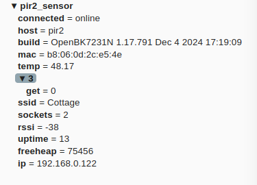

    EDIT: Found the device again using its AP, WIFI configuration was lost from some reason, so I reconfugured and thing are working fine again apart from the fact that device does turn off by itself, need to figure out how to stop it.
    Last but not least, how to use it as PIR sensor via MQTT? I use MQTT explorer to see what is send, but nothing sensible here for motion detect or is it?:
    Screenshot of MQTT Explorer interface showing details of the pir2 sensor.

How do I confirm the 8‑pin SOIC chip is a TuyaMCU?
Check if RX1/TX1 from the Wi‑Fi module go to that SOIC. See if Q1 switches 3.3 V to the Wi‑Fi module. Read Tuya JSON for a UART baud setting. Measure if 3.3 V is cut during sleep. Sniff UART at 9600 or 115200 using Realterm. [Elektroda, p.kaczmarek2, post #21076988]

Use: startDriver TuyaMCU; startDriver tmSensor; setChannelType 1 Motion; linkTuyaMCUOutputToChannel 1 val 1; setChannelType 3 ReadOnlyLowMidHigh; setChannelLabel 3 Battery; linkTuyaMCUOutputToChannel 3 enum 3. This maps dpID 1 to motion and dpID 3 to battery. [Elektroda, burba, post #21079983]
HA shows motion permanently as detected. How do I fix stuck states?
Set initial channel values in Startup Config to -1 to remember the last state across sleeps. Alternatively set 999 to force the first publish after boot. "Set the initial channel values to -1" ensures changes are reported correctly. [Elektroda, p.kaczmarek2, post #21080261]

Which MQTT topics carry motion and battery values?
OpenBeken publishes as obk//get. Motion arrives on channel 1; battery on channel 3. Example log lines: Publishing val X to obk.../1/get and obk.../3/get confirm the topic shape. [Elektroda, burba, post #21080136]
How do I keep the PIR awake for bench testing or mains power use?
Physically hold or lock the device’s button in the pressed position to stop sleep. Set fixed IP and MQTT to stabilize reconnections. Initialize mirrored channels to -1, or HA won’t update. Expect initial "detected" then "clear" in under a minute. [Elektroda, burba, post #21082341]
What current does the sensor draw and how fast does it connect?
Active current is about 55–75 mA. Wi‑Fi connects and reports to MQTT in about 12 seconds. In sleep, the supply measured no detectable draw. The PIR still wakes instantly on motion, likely due to its internal power path. [Elektroda, burba, post #21077738]
How do I link Tuya dpIDs to channels for this PIR?
Map dpID 1 to Channel 1 as Motion using linkTuyaMCUOutputToChannel 1 val 1. Map dpID 3 to Channel 3 as ReadOnlyLowMidHigh with linkTuyaMCUOutputToChannel 3 enum 3. Label Channel 3 as Battery. [Elektroda, burba, post #21079983]

HA shows motion reversed. Is there a no‑update firmware workaround?
Use change handlers to mirror and invert. Example: addChangeHandler Channel1 == 0 setChannel 2 1; addChangeHandler Channel1 != 0 setChannel 2 0. Point HA to Channel 2 for correct polarity. [Elektroda, burba, post #21076983]

Which firmware flags are commonly used on this PIR?
A working setup used flags 10, 37, and 43 alongside TuyaMCU mapping. Configure Wi‑Fi, IP, and MQTT after setting drivers. This avoids unnecessary GPIO role edits. [Elektroda, burba, post #21076983]

Do I need to set GPIO pin roles on CB3S/BK7231N for this PIR?
No. Do not configure pins. The external TuyaMCU controls the PIR and battery reporting over UART. Use drivers and linkTuyaMCUOutputToChannel instead of GPIO roles. [Elektroda, burba, post #21076983]
