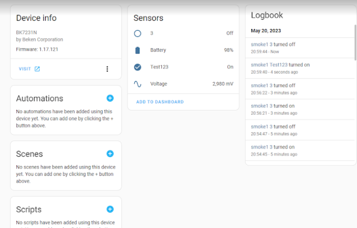

    2023-05-20 reminder
    Remember that you can set channel labels:
    setChannelLabel 1 Test123
    and they will get to HA as well:
    [Youtube] Home Assistant Discovery (automatic pairing) for BK7231 (BK7231T, BK7231N) in OpenBeken
    Please refer to the documentation for more information:
    https://github.com/openshwprojects/OpenBK7231T_App/blob/main/docs/README.md

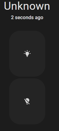

    #10 21655284
    insmod
    Posts: 1432
    Help: 168
    Rate: 455
    Online is sent on any HA boot, be it a reboot, power cycle or reboot on update (I use HA OS in VM, mosquitto as an addon in HA).
    I've got a relay, which is configured as light (flag 34). If i reboot HA instance, this light entity is shown as "unknown"
    Spoiler:
    Light state unknown, two bulb icons on dark background
    With this update, it will update it's state to what it really is after about 10-15 seconds.
