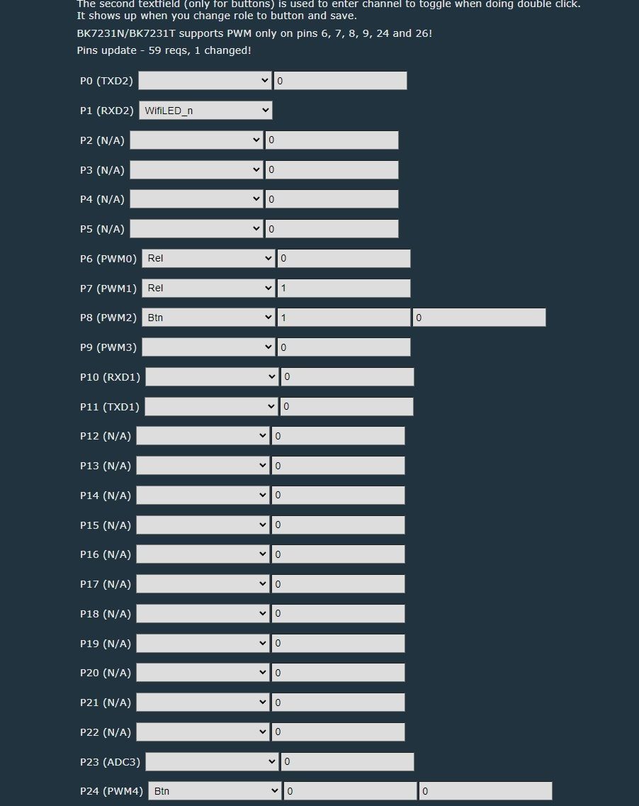

    I just flashed my tuya shutter switch with openbk7231t and everything is working correctly. but how can I prevent activating both relays at the same time? I need something like the shutter mode in tasmota. or is my only option to replace the WB3S chip with ESP and flash tasmota on it?
  • Use Rel and Rel_n for mutually exclusive relays
    #2 20413848
    Posts: 14771
    Rate: 12914
    Well, I can write any driver for you if you want, but it should be also possible to both configure or script OBK to suit your needs.
    You could, for example, set one relay Rel and second to Rel_n, and set them both to single channel, then they would work in mutually exclusive way.
    You could also use some scripting - for example, make a change handler and do something there:
    addChangeHandler Channel0 == 1 YourCommandHere
    addChangeHandler Channel0 == 0 YourCommandHere
    You can use any command in event handler, or even start a script.
    You can also use repeating event with counter set to 1 to do something after a delay.
    addRepeatingEvent 2 1 setChannel 0 0
    but again, if you have a specific use case in mind, I can write a dedicated driver for you, as long as you can explain how is it supposed to work. Show your device configuration, etc.

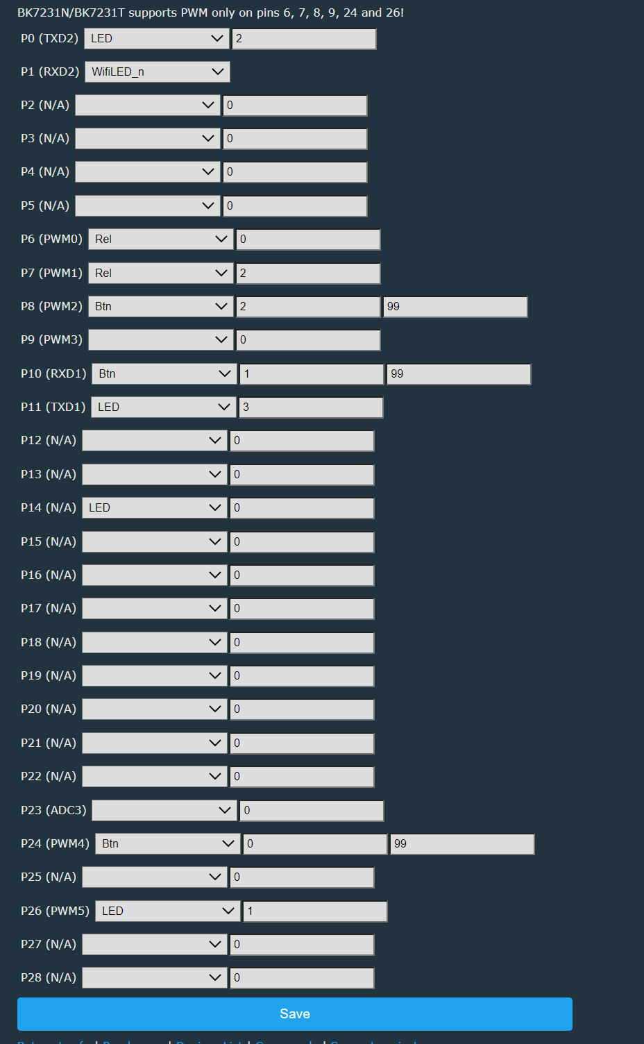

    hoezyhoest
    i tried setting them both to single channel but it still keeps one of them constantly on.
    i tried the scripting part but that is a bit complicated for me :P (i do know how to run them)
    i'm using a switch like this and i need something like the InterLock setting in tasmota so that none can accidentally fire two relays on the physical touch buttons
    https://templates.blakadder.com/WF-CS01_EU.html
    these are my settings:
    Preventing Simultaneous Activation of Both Relays in OpenBK7231T-Tuya Shutter Switch
  • #4 20414125
    Posts: 14771
    Rate: 12914
    I am not sure yet, but just maybe, this autoexec.bat (in Web Application ->LittleFS tab) can help?
    // when channel 0 becomes 1, turn off channel 1
    addChangeHandler Channel0 == 1 SetChannel 1 0
    // when channel 1 becomes 1, turn off channel 0
    addChangeHandler Channel1 == 1 SetChannel 0 0
    I haven't done shutters yet. Futhermore, do they require turning off both relays after a given time?
  • #5 20414151
    hoezyhoest
    thnx alot! this is the same as the interlock from tasmota and works like a charm :)
    i'm using home assistant to time the relays so that's not a problem. this was only for protection so i won't blow up the motors by accident.
    cheers!
