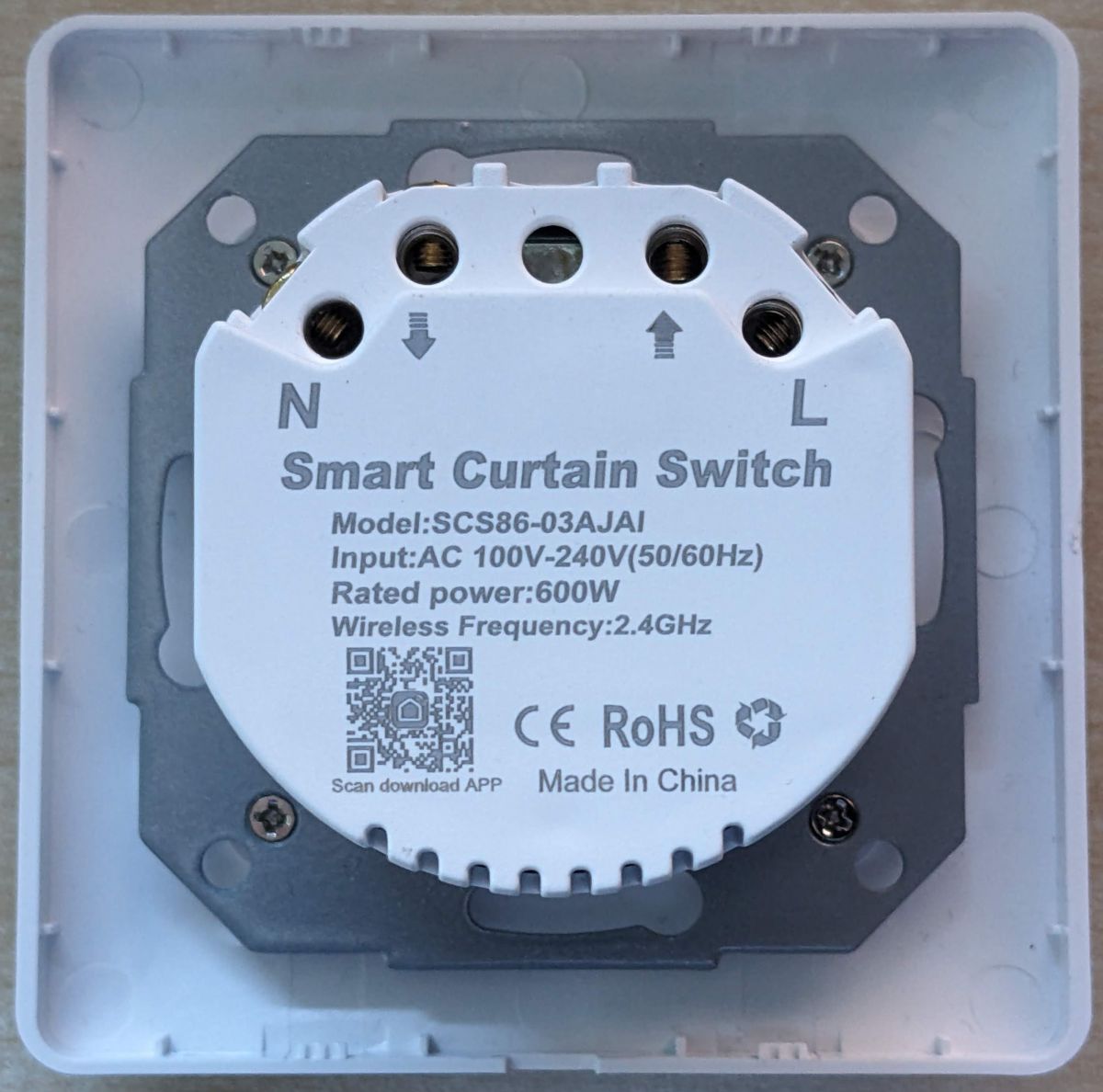

    The controller is a NoName SCS86-03AJAI Smart Curtain Switch (as labelled on the back) and fits into a standard single wall box.
    Three white mechanical buttons of the NoName SCS86-03AJAI curtain controller on a square frame. NoName SCS86-03AJAI curtain controller in a standard wall box.
    It is one of the few curtain/shade controllers with mechanical keys. It's rather cheap while mechanical build looks quite okay with reasonable electrical separation and proper capacitors. However, the original Tuya firmware has a severe flaw, causing this device to crash at random intervals between a few hours and multiple weeks. It then disconnects from the network; the green WLAN LED is lit permanently, and it can only be restored by a full power cycle. So, flashing it with a proper firmware is mandatory.

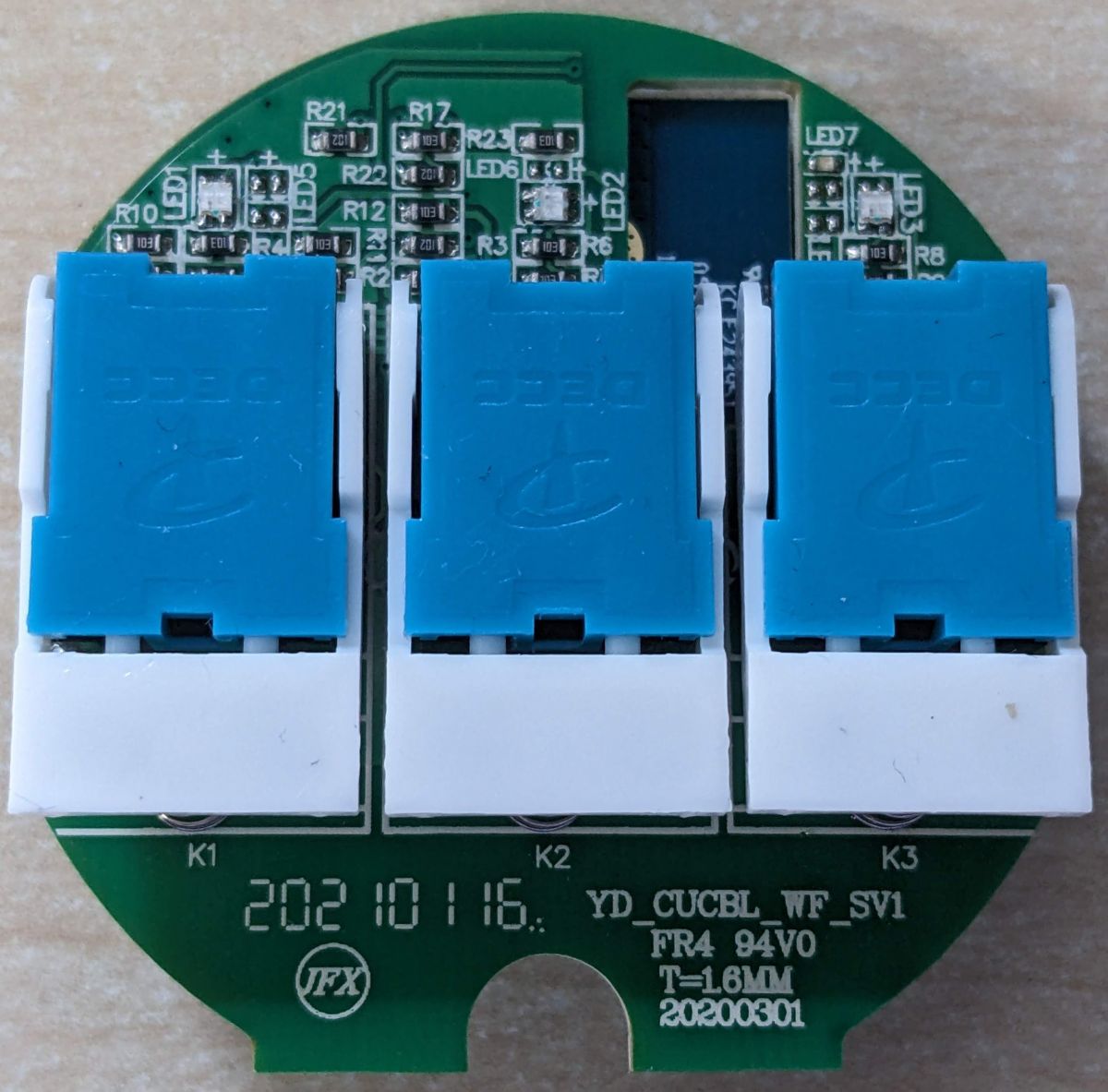

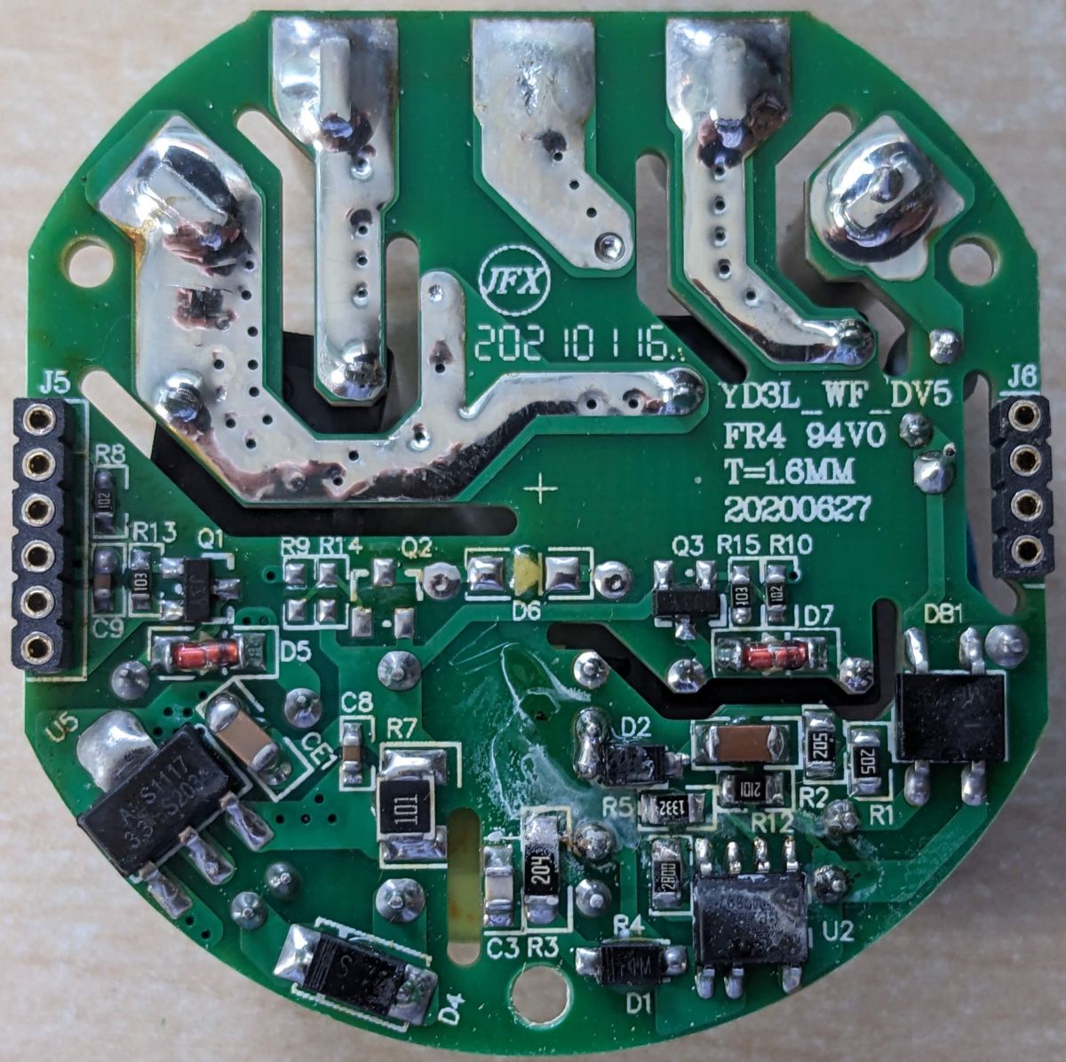

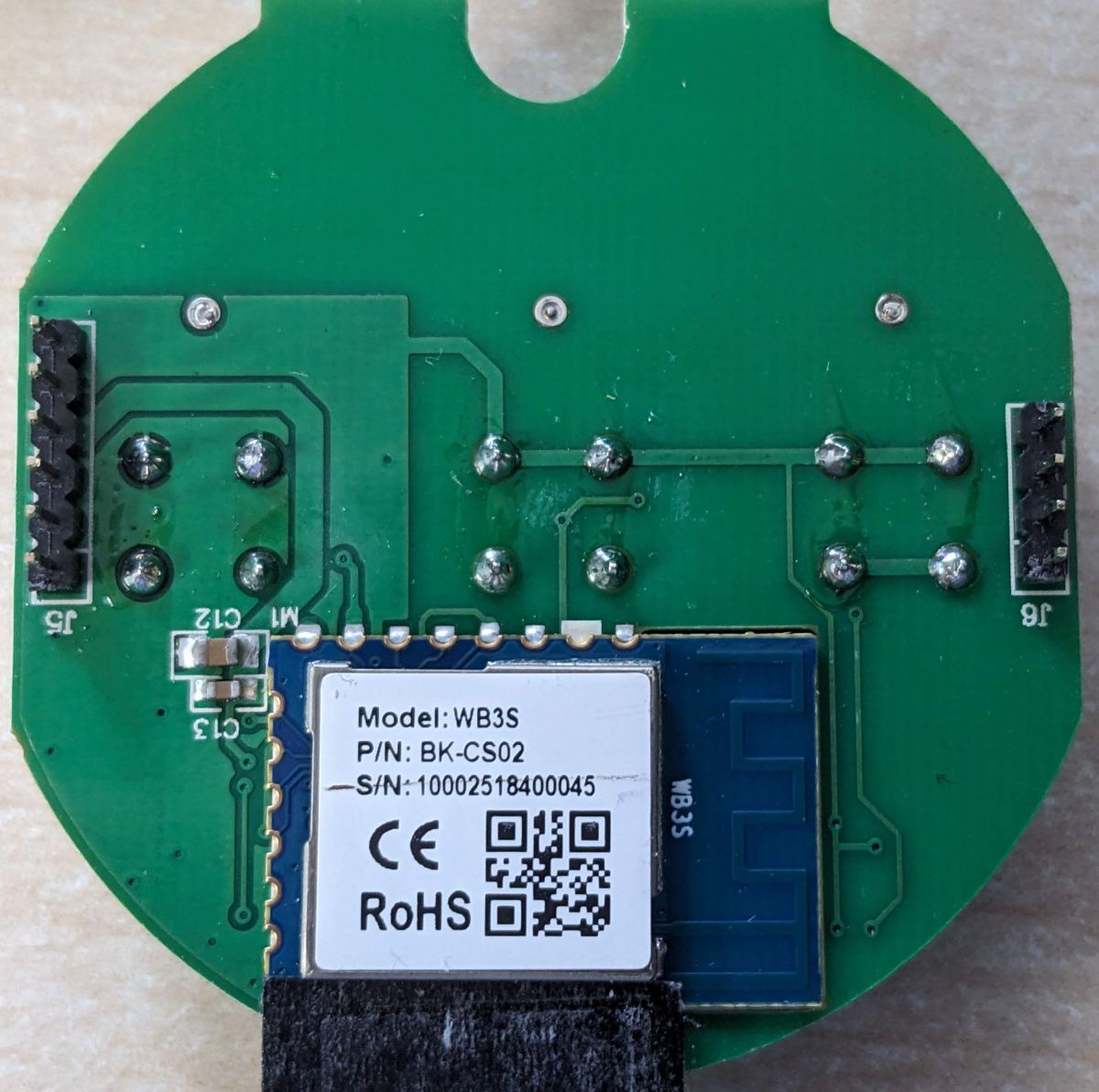

    Teardown

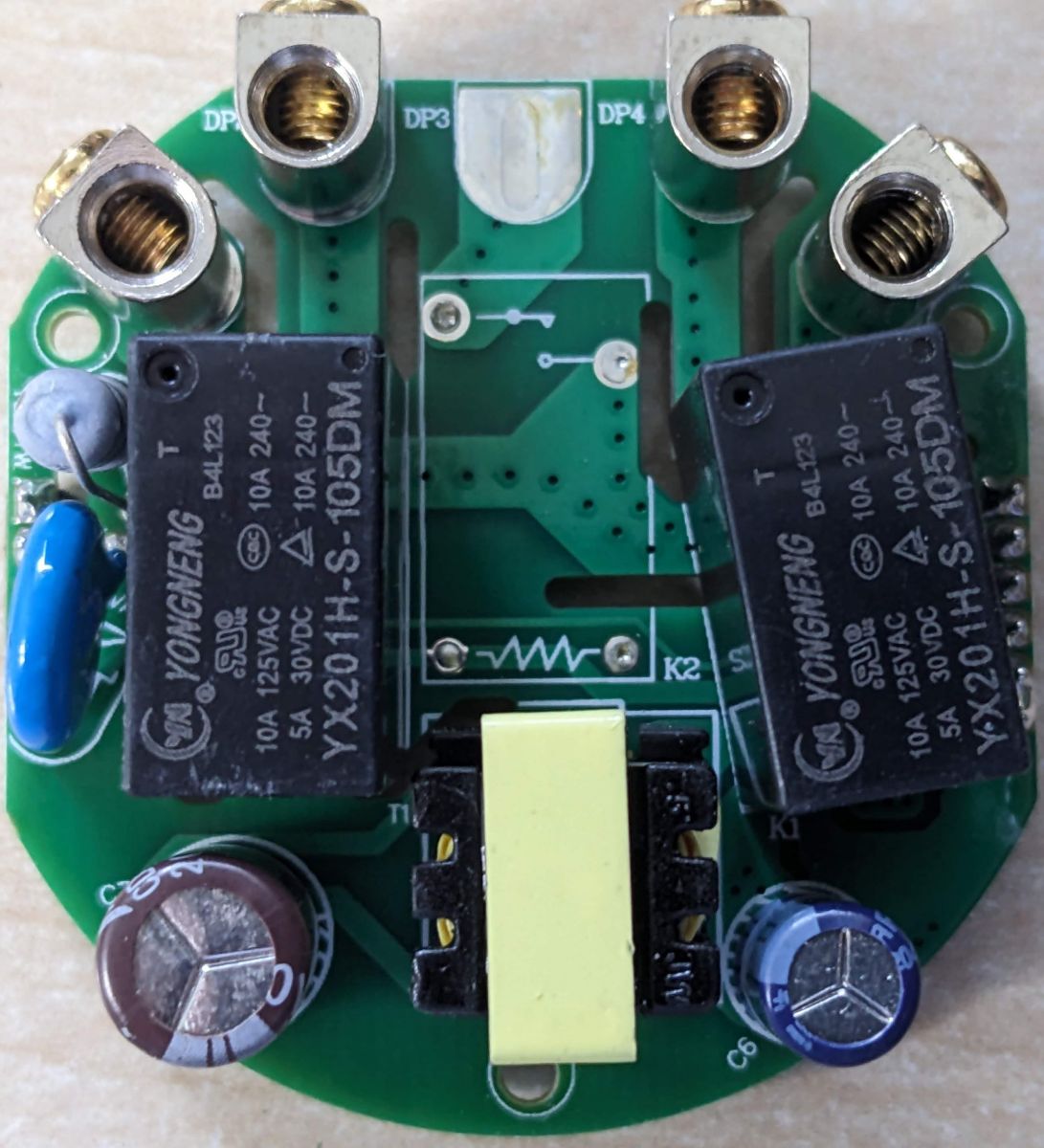

    Opening the case is straightforward: Just carefully pry the 4 clips holding the back cover to the metal frame and detach it with the boards from the front plate. A single Philips screw then needs to be removed from the power board through an opening in the processor board. Make sure the screws on the terminals are either removed or fully screwed in so the boards can be removed from the cover. Here's a view of both sides of the two boards:
    WB3S module on a green PCB with model and serial number labels. PCB with three blue switches Close-up view of the circuit board of the NoName SCS86-03AJAI controller with component labels. Close-up of a circuit board with Yongcheng relays and electronic components.
    As can be seen, the power board offers space for a third relay and terminal, so there might be a version around that operates as a simple 3-gang power switch, but I haven't come across such a variant anywhere.

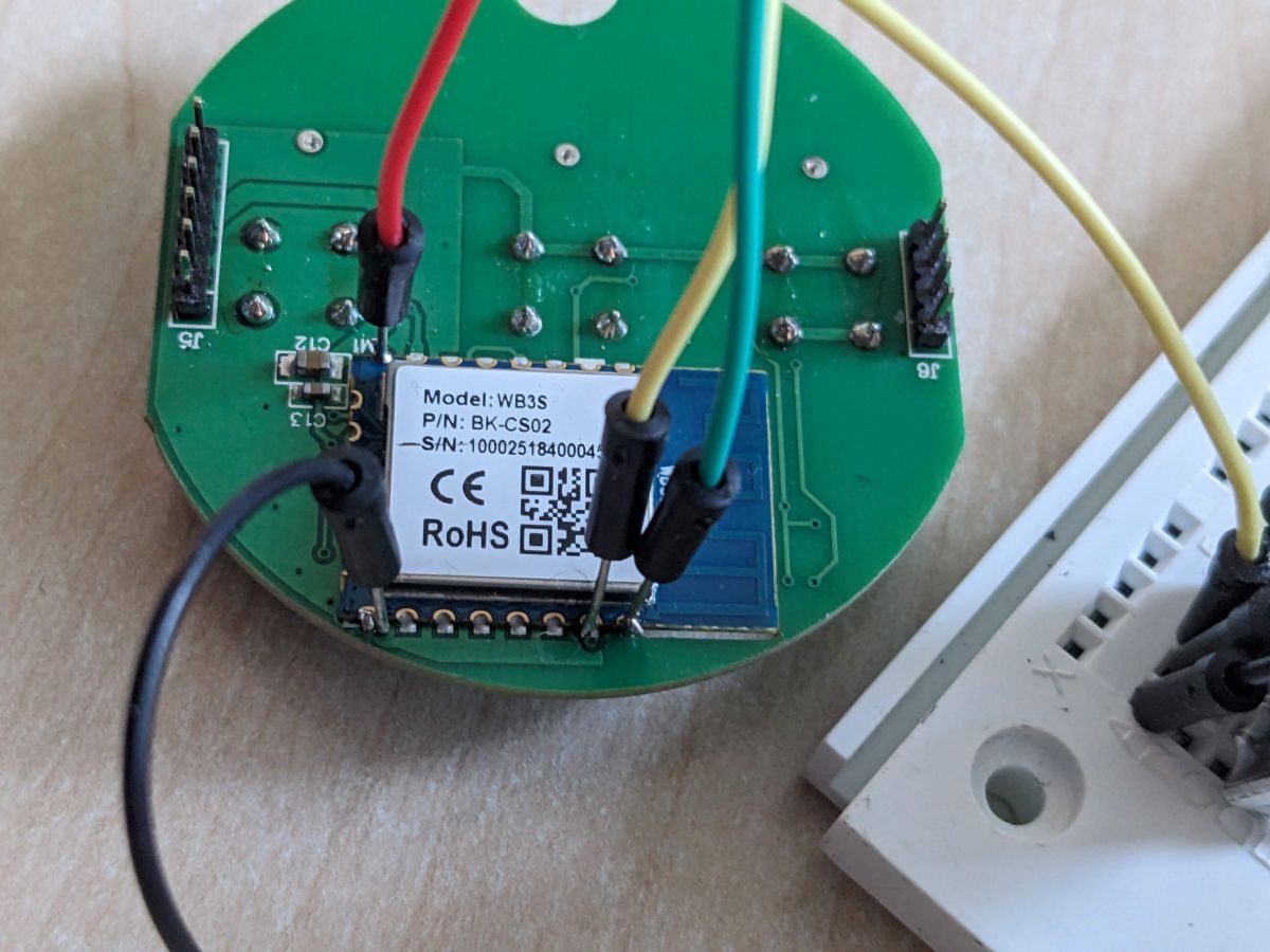

    Flashing

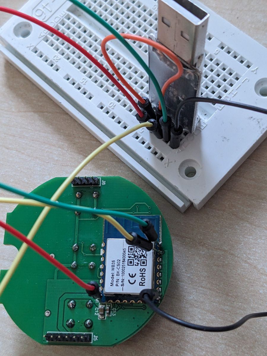

    I soldered wires onto the TXD1, RXD1, GND and VCC pads of the WB3S and connected it up my USB/UART converter set to 3V3, downloaded BK7231Flasher.exe and got the appropriate file to flash it with by this method (OpenBK7231T_UA_1.17.243.bin). The TXD/RXD pins do not interfere with the circuitry, but the trick was to put the device into flash mode: Powering it down did not work as the module draws too much power from the USB converter during powerup, causing an USB disconnect. Momentarily connecting the reset pin to ground however worked fine. Depending on your USB to serial converter, you might have to use a separate 3.3V power source for the WB3S module. Here's my flashing set-up:
    Electronic circuit board with connected wires to the WB3S module.
    Board with WB3S module connected to a breadboard and USB/UART converter.
    Instead of soldering power to the WB3S module, pin 4 (VCC) and pin 6 (GND) on J5 could have been used as well.

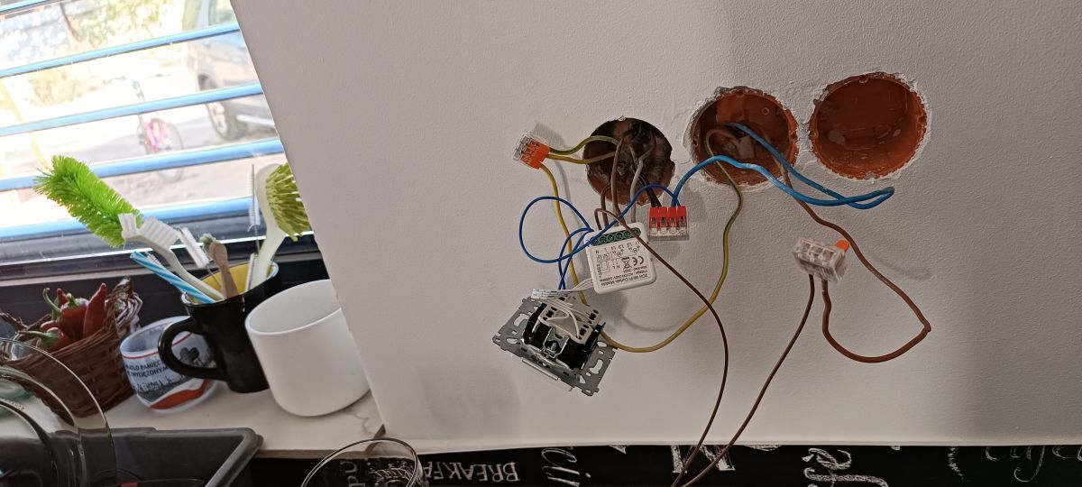

    Hi Guys.
    Big thanks for your effort into OpenBK project - Love it!
    Think I may help.
    Got facade shutters (supporting angle),
    cheap 2ch curtain switch tuya alike (similar to this),
    flashed version OpenBK7231N 1.17.231,
    configured buttons and relays,
    all tested and looking good.
    Close-up of electrical installation of a wall switch with exposed wires.
    My 2ch wall mounted curtain switch has 3 (up, off, down) and holds states, once pressed it mechanically stays pressed. OpenBK buttons doesn't work like that (or I'm using wrong driver for them atm). Shutter motor itself has (adjustable) max top/bottom limit switches, so once curtain switch pressed in desired direction you can leave it pressed, limit switch will turn the motor off once activated.
    Two white electrical switches mounted on a wall with visible wires at the back.
    - There no such thing like position feedback from Shutter or its motor, so most likely we'll have to rely on time.
    - When they travel down they do that always in fully blinded state (lamells are closed).
    - When they travel up they do that always in fully open state (lamells are open).
    - In order to adjust their angle a short impulse in reverse direction of travel is required.
    Eg. If you cycle them from very top to bottom they will be fully closed, then if you want to adjust the angle of lamells a short impulse in direction of opening will do the trick. Angle can be adjusted at any height of the shutter. I can do a video to make this process slightly more organoleptic.
    LMK what I can do in order to help with driver development.
    Got some programming skills and tools.
  • Proposes an OpenBeken shutter driver with calibration options
