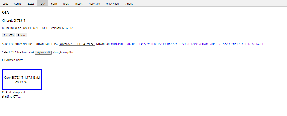

    после обновления OpenBK7231N_1.17.148.rbl, мои розетки перестали работать.!!!
    after updating OpenBK7231N_1.17.148.rbl, my sockets stopped working.!!!
  • #32 20625830
    Posts: 14728
    Rate: 12814

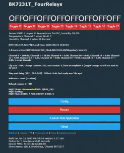

    Hello, can you provide more information, which sockets, which platform?

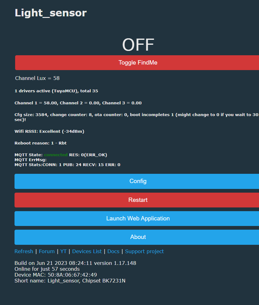

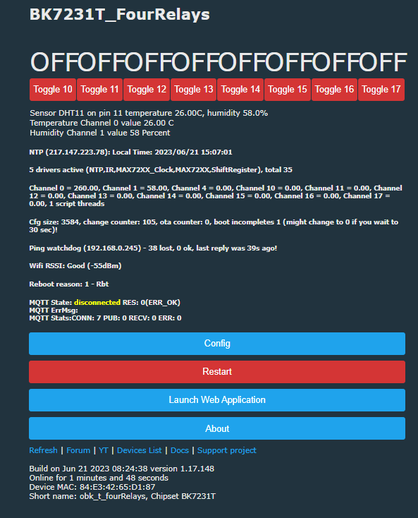

    I today updated first to 1.17.137:
    Home Assistant Not Detecting OpenBeken Device: Manual Setup & Pin Configuration Guide
    and then to 1.17.148:
    and it works for me. Do you have problems on a single socket or on many ones?

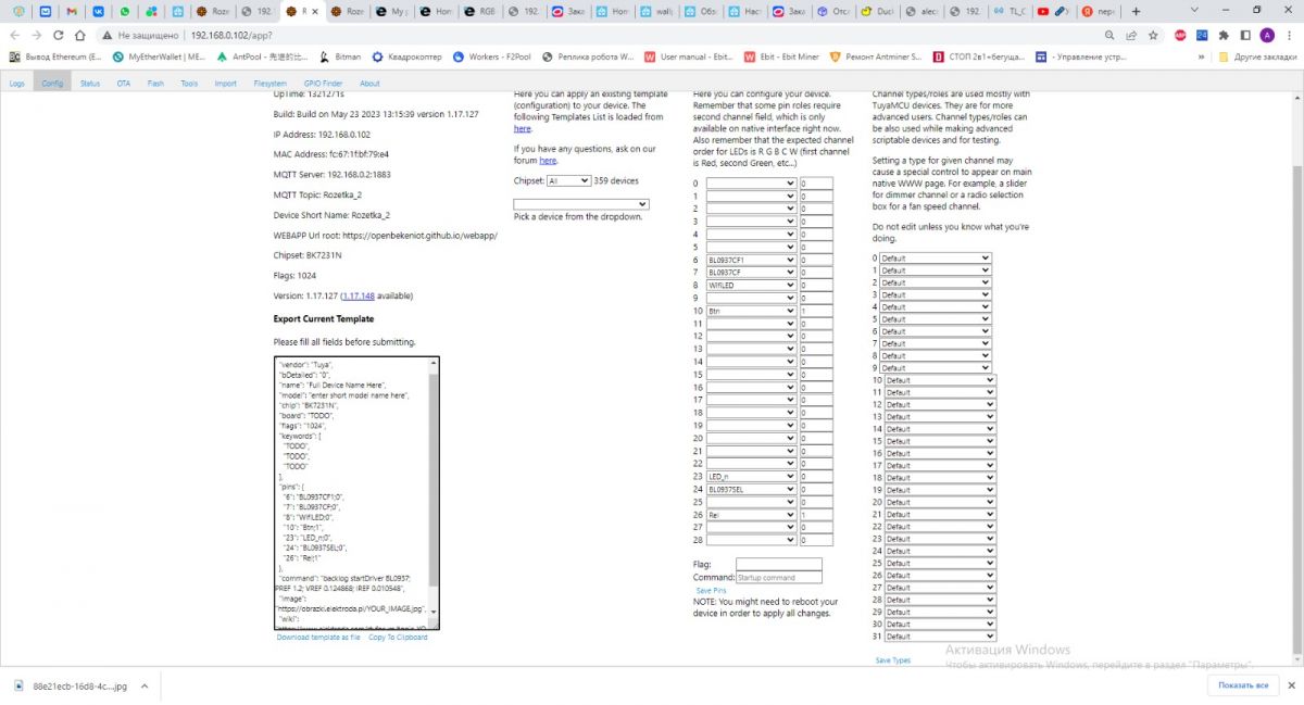

    I had three sockets, I updated two, they stopped working, I did not update the third, I did not update. What information do you need to give?
    Added after 1 [hours] 12 [minutes]:
    I figured it out, the Wi-Fi settings flew off, the devices switched to the access point mode
  • #34 20625967
    Posts: 14728
    Rate: 12814
    Why did the WiFi settings get reset? Do you mean it booted in Safe Mode (so the settings are retained, it just booted into safe mode), or do you mean that the config is really clear? Only WiFi config or full config?
  • #35 20625969
    pogadaevalecsey
    Posts: 32
    full seting bad

    Latest 148 build tested on N module - confirmed working.
    No changes to setup or functionality of the device.

    So it looks like after OTA update from 127 to 148 you lost your complete configuration, is that correct??
  • #39 20626086
    pogadaevalecsey
    Posts: 32
    да именно так
    yes

    Seems to work for me, at least while updating 1.17.108 to 1.17.148:

    pogadaevalecsey wrote:
    full setting bad
    You are right. There was a small bug that caused settings to clear by OTA updates between certain builds. It's fixed now. Please choose the latest build when updating. Thank you for reporting.
