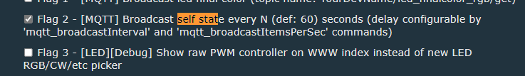

    I am fresh on this topic, I am looking and I can not find (probably I am looking poorly)
    I have a BK7231(CB2S) with openBk and in no way I can make openbk send entities Signal and RSSI, in tasmot I have enabled these entities k is ok, but through the broker mqqt dl openbk they do not exist.
    In openbk I enabled tele Tasot and broadcasting the status every 60s.
    What else should I do ?
  • #2 20598450
    Posts: 14622
    Help: 655
    Rate: 12638

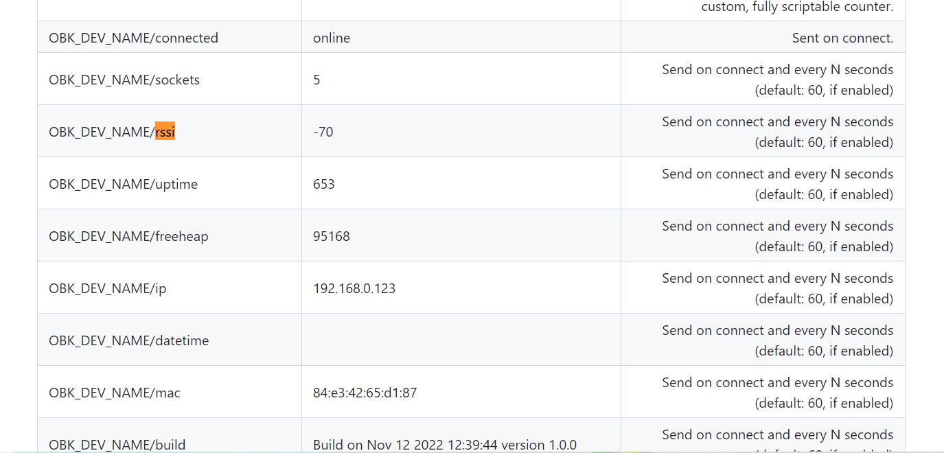

    Hello, by "openbk sent" do you mean the execution by OpenBK publish via MQTT of these entities?
    BK7231(CB2S) with openBk: How to receive Signal and RSSI entities via MQTT in Home Assistant?
    If so, you would just include this flag:
    Then you can change the reporting period of your own state via a command (see command list https://github.com/openshwprojects/OpenBK7231T_App/blob/main/docs/commands.md )
    Unless there is something else behind your question - e.g. a situation where RSSI is published but you don't have it in HASS Discovery? As far as I know, we are yet to add it to Discovery.
    If you are referring to another RSSI field, please be more specific

    Yes, that's what this is about, I can see that I missed some letters earlier.
    I wanted HA to add the entities that openBK publishes when connecting the device for the first time.
    I initially suggested a manual entry in configure.yaml and there I added the entities for openBK. HA added the on/off switch entities, but the rest of the others that openBK publishes, no longer.
    I removed the entities that I entered in configure.yaml, reviewed again all the options that should be included in openBK and after a reboot HA added all the entities nicely.
    Thanks for the help.
