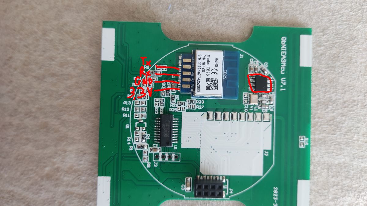

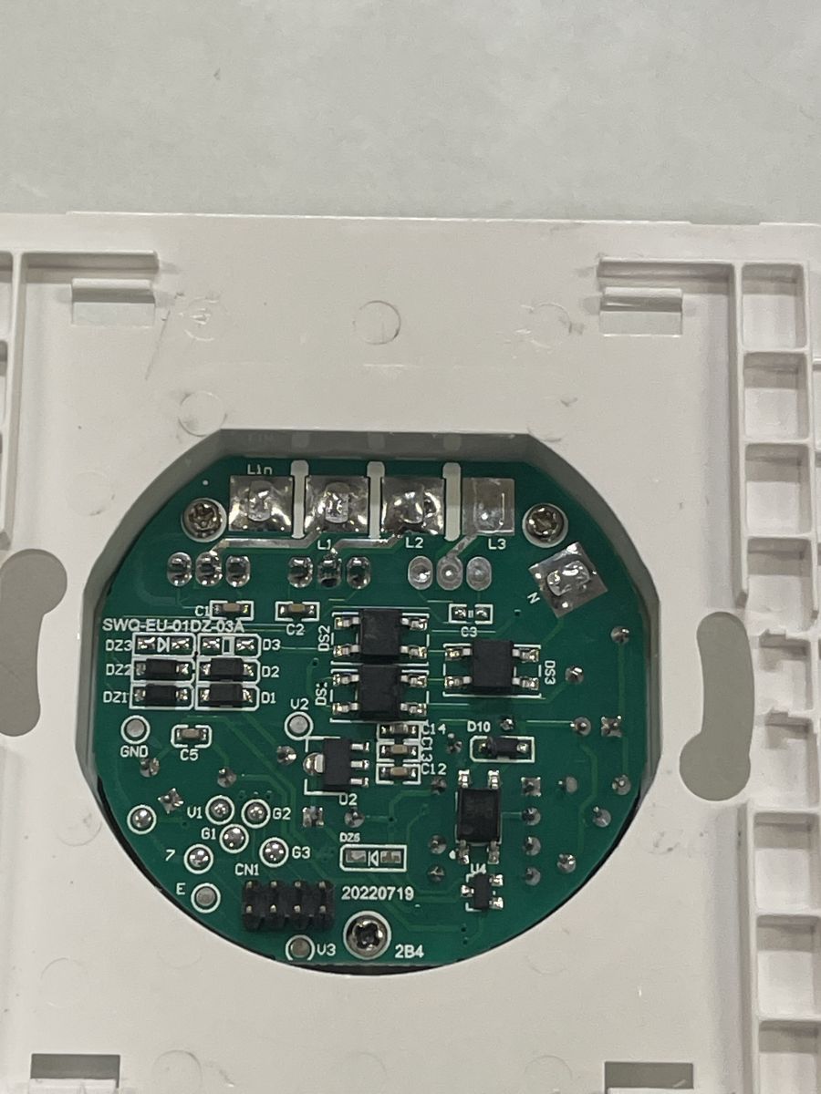

    I have bought some Moes 2 gang wall switch(WIFI+RF433) to flash with open beaken but there is a problem. It uses another MCU (66F31965) for all application control and uses WB2S (bk7231T) just to deal with Tuya via RX1 and TX1 of the module. - First of all I could not flash WB2S by bk_writer1.60.exe by any way which I tried. When I connect CEN to GND, it continues counting from zero to 15 seconds and then shows failed. If I disconnect the CEN from the GND, immediately it stops and shows failed. - Assume that I could flash it, how could I program it to deal with MCU(66F3165) to read the input switches and control the output relays and backlight LEDs? Any one can help? Problem to flash and work with Moes 2 gang wall switch(WIFI+RF433) Problem to flash and work with Moes 2 gang wall switch(WIFI+RF433) Problem to flash and work with Moes 2 gang wall switch(WIFI+RF433) Problem to flash and work with Moes 2 gang wall switch(WIFI+RF433)

    This is a TuyaMCU device.
    WiFi module is controling the MCU via UART, via TuyaMCU protocol.
    You must cut RX/TX traces between WiFI module and TuyaMCU to flash, because the UART port for flashing is used for TuyaMCU as well.
    We have a good TuyaMCU support in OpenBeken. It should be easy to run.

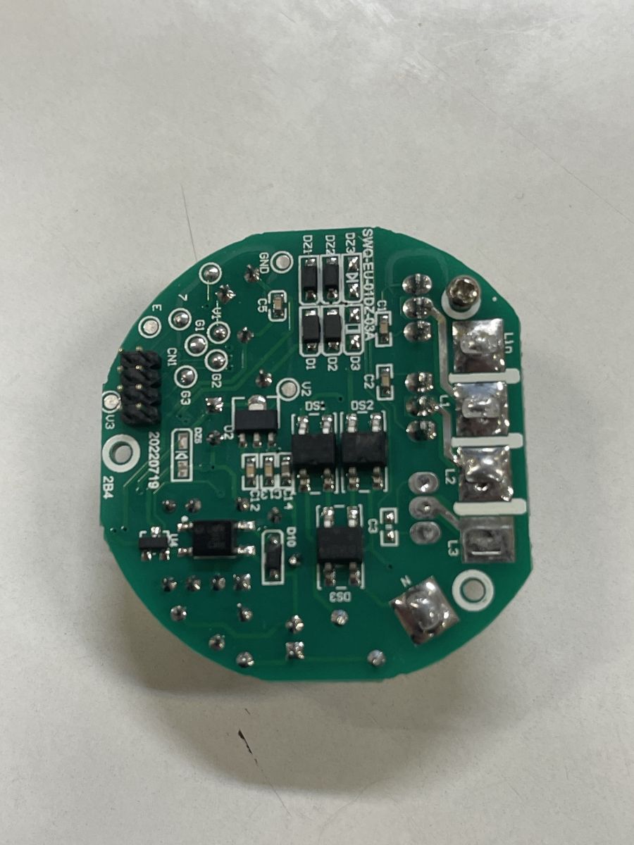

    I bought 4 of this switch. I de-soldered one of WB2S modules and it can not be flashed by any way. I am not sure whether it's burnt or OK.
    If it has been burnt, can I replace it with 8266? because I think WB2S can not be bought separately in our region.
    As I saw in the videos, flashing WB2S is very hard and not as easy as WB3S which I flashed before on another device.
    I have to connect the CEN to GND in less than a second or reconnect the power before 15 seconds? right?

    Flashing WB2S is very easy. Only RX, TX, GND and 3.3V are required. Start flashing, disconnect power, reconnect it, and it will flash.
    Do a 2MB backup first.
    You can use bkWriter 1.60 or my tool:
    I flashed tens of WB2S that way. How your setup looks like?

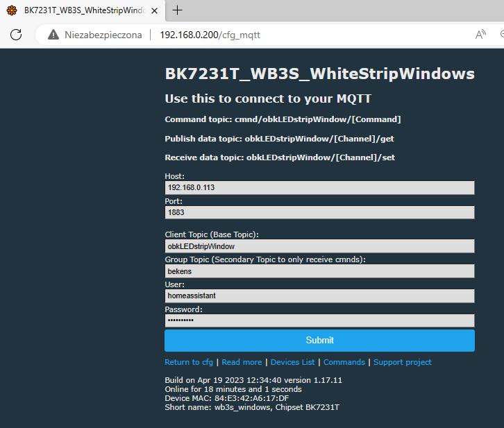

    Hello, your device topic can be found, for example, on MQTT page:
    See?
    Command topic: cmnd/obkLEDstripWindow/[Command]
    Publish data topic: obkLEDstripWindow/[Channel]/get
    Receive data topic: obkLEDstripWindow/[Channel]/set
    Them, to get your second channel, you can do something like that:

    andryvan
    Posts: 8
    Hi all! I don't know what to do anymore. Maybe someone will advise something.
    I flashed the switch, made autoexec.bat, one switch works fine. And the second, exactly the same, only turns on via WiFi, but does not want to turn off. And the LED blinks all the time, although the first one does not blink. But the button on the switch itself turns on and off.
    I suspect that Tuya's MCU has crashed. What else can be done? Share your experience.
  • #23 20632144
    Posts: 14724
    Rate: 12807
    Try powering it on and off.
    Try adding the following line to the bottom of autoexec.bat:
    tuyaMcu_defWiFiState 4
    This will force "paired and connected to cloud" WiFi state spoofing for TuyaMCU and it may stop LED blinking/other issues.
  • #24 20632404
    andryvan
    Posts: 8
    Thanks for the advice. I read about it on this forum and did so right away. But it doesn't help. One switch works and the other doesn't work.
  • #25 20632489
    Posts: 14724
    Rate: 12807
    Did you save and restart that configuration?
    What does the Web App Log say?
    Paste here a larger portion of log, include the log showing what happens when you switch via WiFi and via physical touch button

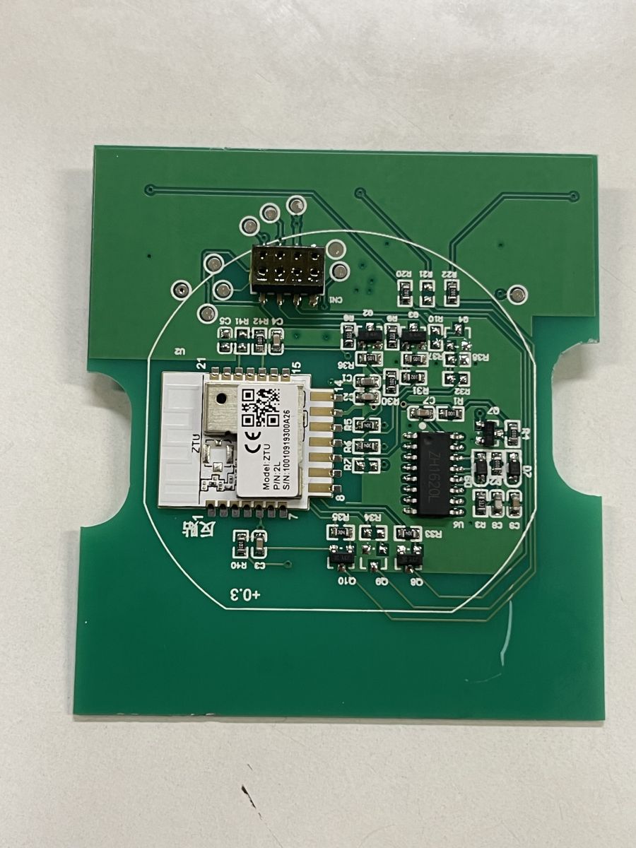

    #27 21038970
    omidjozani
    Posts: 15
    Hi
    Newly I bought one more of that switch, but inside is totally different.
    I bought this Moess switch from Amazon.
    They changed wifi module with ZTE model. And they omitted Tuya MCU, can I flash the same openbeken firmware on this new wifi module?
    If yes what about the flash procedure?
    ZTE chip on a circuit board. Green printed circuit board with several buttons and traces. Close-up of the interior of an electrical switch with various components, including a ZTE module. Top view of a Moes switch circuit board with visible components. Close-up of a circuit board inside a Moes switch with electronic components.

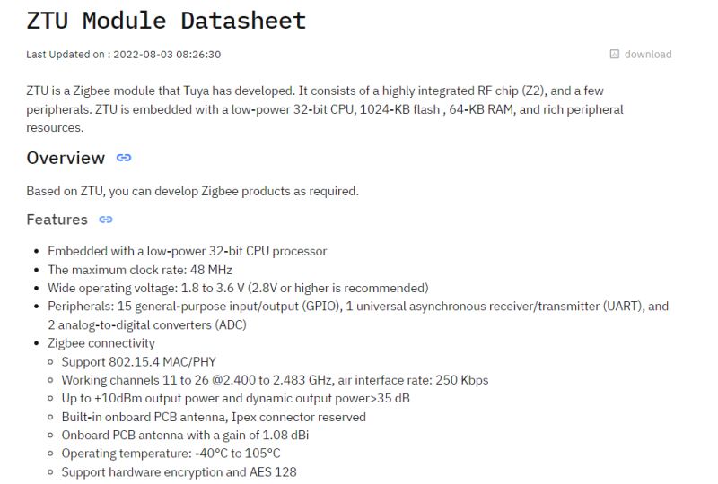

  • #28 21039004
    Posts: 14724
    Rate: 12807
    Hello! The "Z" marking indicates it's a Zigbee device. ZTE is a Zigbee equivalent of WB2S/CB2S/TYWE2S. This is not a WiFi device.
    ZTU module datasheet using Zigbee.

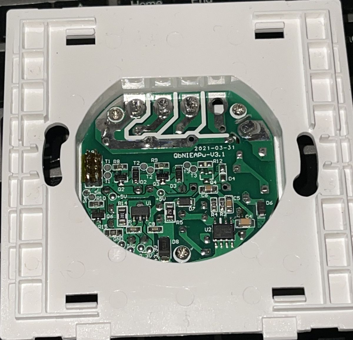

  • #29 21081997
    jaro.44
    Posts: 38

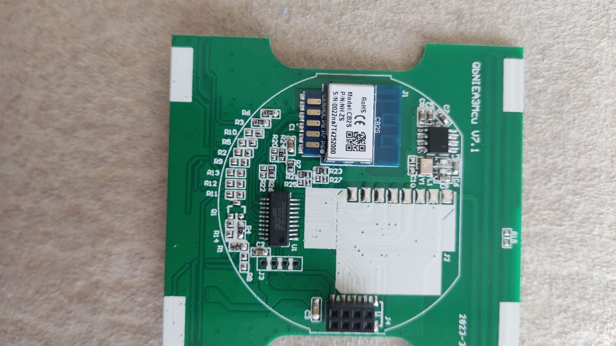

    Hi I bought a MOES triple switch and would like to hook it up to HA:
    Close-up of MOES circuit board with CB2S component.
    How is the easiest and best way without soldering the module to change the firmware to "friendly" for HA?

    I purchased some Moes WIFI+ RF433 switches:
    3-Gang (WB2S - BK7231T) and 2-Gang (CB2S - BK7231N).
    Unloading and configuring OpenBK went without any problems, pairing with HA via MQTT also.
    My question is about the RF433 support, because I am thinking about buying Vice switches for them (wall panel with RF433 transmitter).
    Added after 19 [minutes]:
    jaro.44 wrote:
    How is the easiest and best way without soldering the module to change the firmware to HA "friendly"?
    Hey,
    I programmed without desoldering the module, but I had to desolder the chip highlighted in the picture, because I could not connect BK7231 GUI Flash Tool to the module.
    Circuit board with CB2S module and annotations.

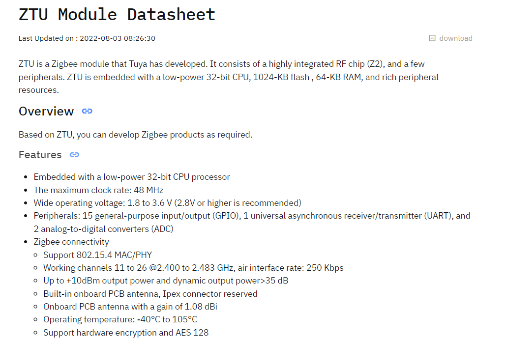

What is the ZTE module in a newer Moes switch, and how is it different from WB2S or CB2S WiFi modules?
The ZTE module is a Zigbee module, not a WiFi WB2S or CB2S replacement. The thread identifies the Z marking as Zigbee and describes ZTE as a Zigbee equivalent of WB2S, CB2S and TYWE2S form factors. Therefore, the same OpenBeken WiFi flashing process for BK7231T or BK7231N does not apply to that newer Moes switch. [#21039004]
