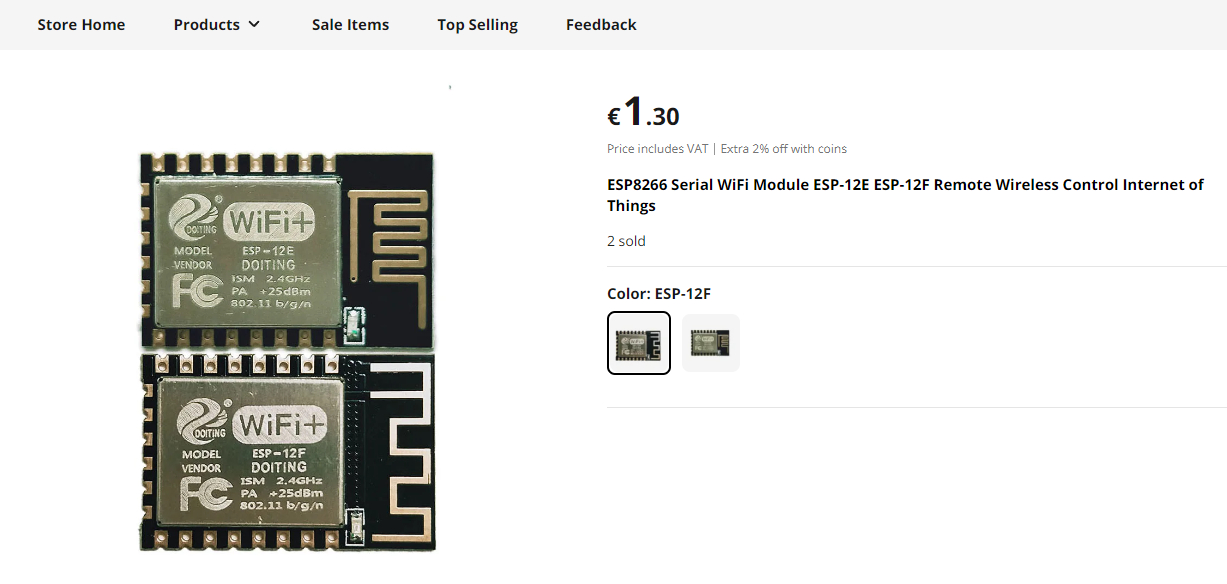

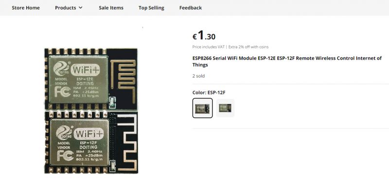

    This chip is currently not supported, sorry. Please stay tuned and watch for news here on Elektroda, I hope to get that one running with OBK soon as well, but currently, you just need to swap it for ESP12/TYWE3S:
    View of ESP8266 WiFi modules ESP-12E and ESP-12F shown on a webpage with a price of 1.30 euros.
