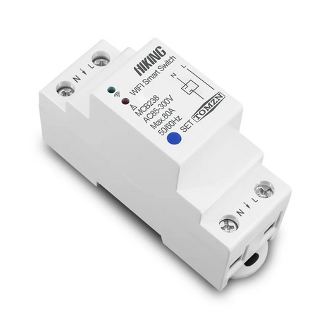

    Tomzn/Hiking MCB238 80A 2P Din Rail wifi MCB
    [BK7231T] Tomzn/Hiking MCB238 80A 2P Din Rail WiFi MCB: Where to Buy, Chip Details & Pinout
    Where to Buy (aliexpress)
    Chip: WB3S (BK7231T)
    Flash method: Solder to UART pads. Used BK7231Flasher v 1.0.5. Original Firmware attached.
    How to access PCB: Undo two Phillips head screws under the case then pull apart the bottom and top halves. You may need to cut a QC sticker on the side. Pull slowly on the PCB, only friction fit into the case.
    Pinout
    P6LED 0
    P8BridgeREV 0
    P9 BridgeFWD 0
    P24 WifiLED
    P26 Btn 0
