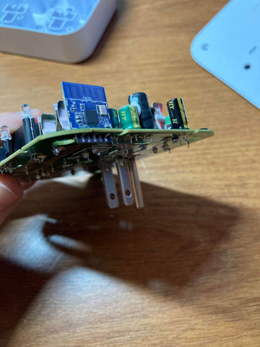

  • Remove 4 rear screws, pry off the friction-fit plate, take out 2 board screws, then desolder the CB2S chip for serial access.
  • The chip connects with 3.3 GND TX and RX, and the pin map lists P6 (PWM0) for Rel 5, P24 (PWM4) for Rel 0, and P26 (PWM5) for Rel 2.
  • The onboard circuit interferes with chip flashing, and careless removal can damage the pads; a capacitor or other part might also need removal.

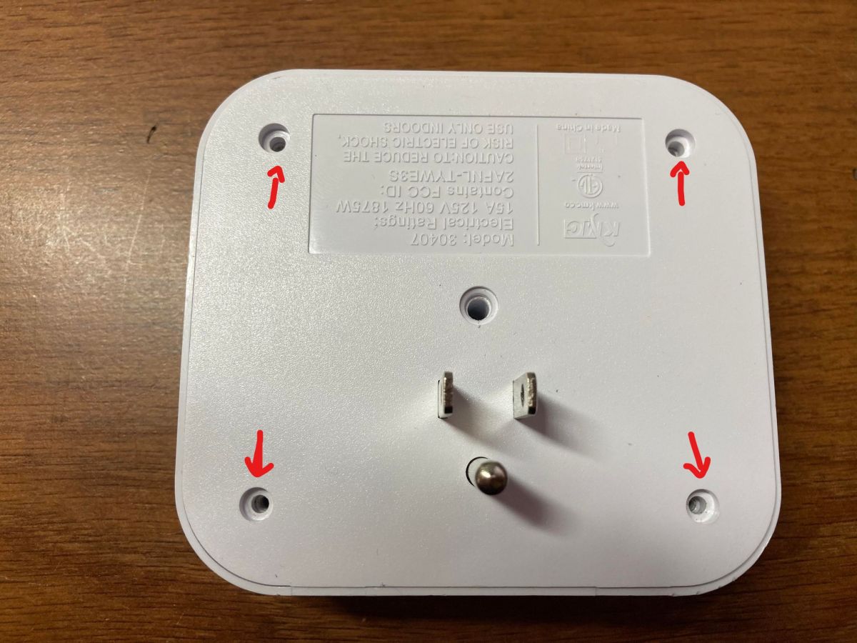

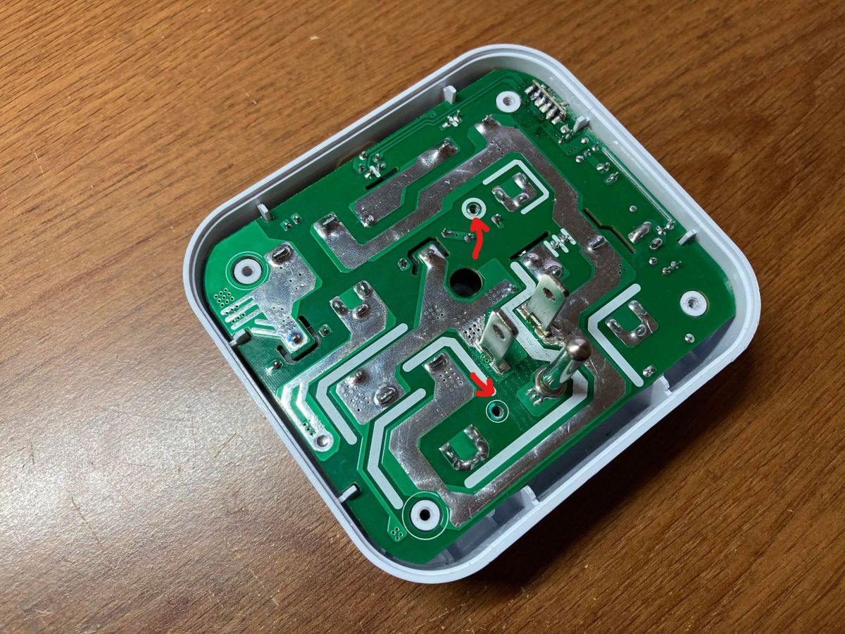

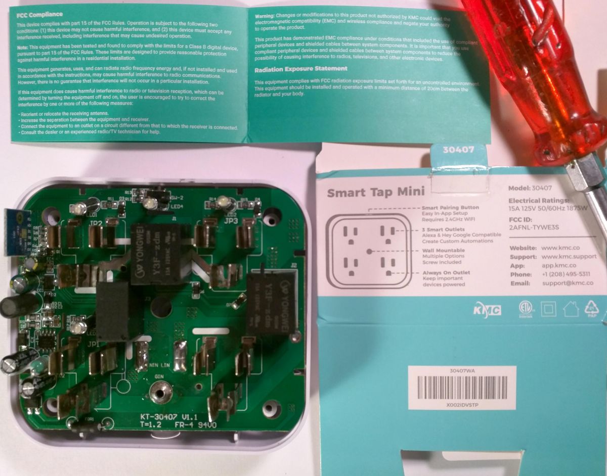

  • Remove 4 screws from back.

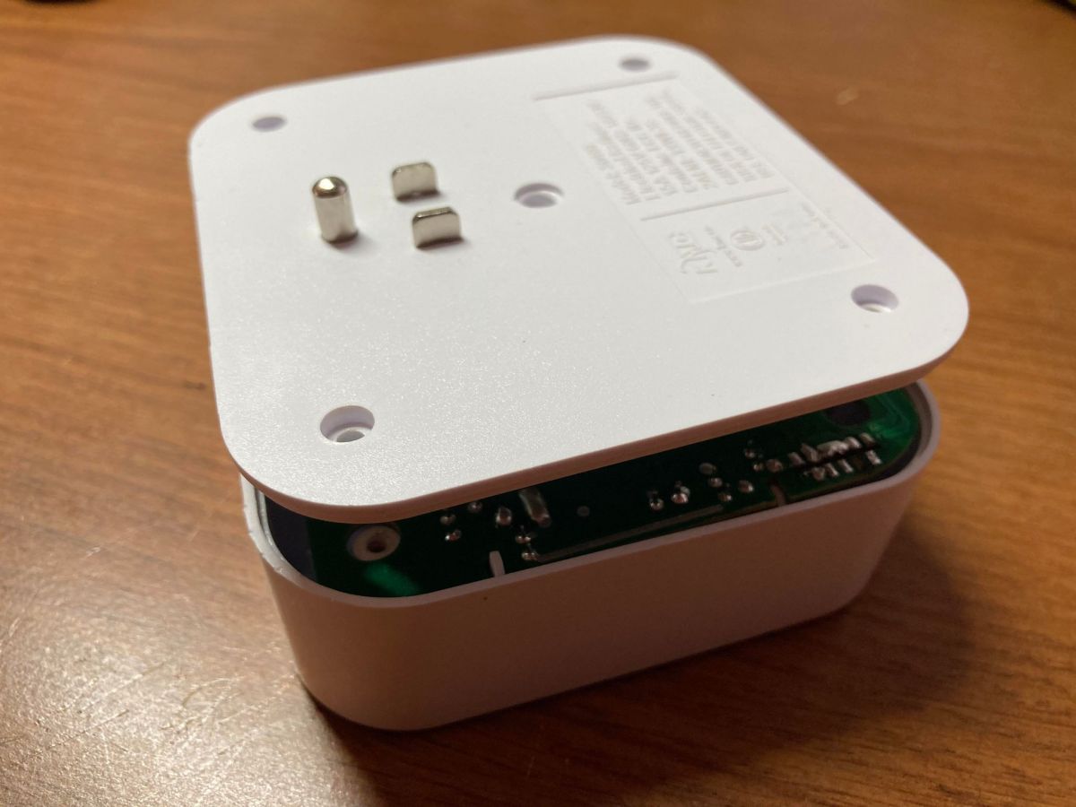

    plate appears to be clipped in place but its not. only friction holds it on.
    use something to gently pry along the edge and lift over the plug.

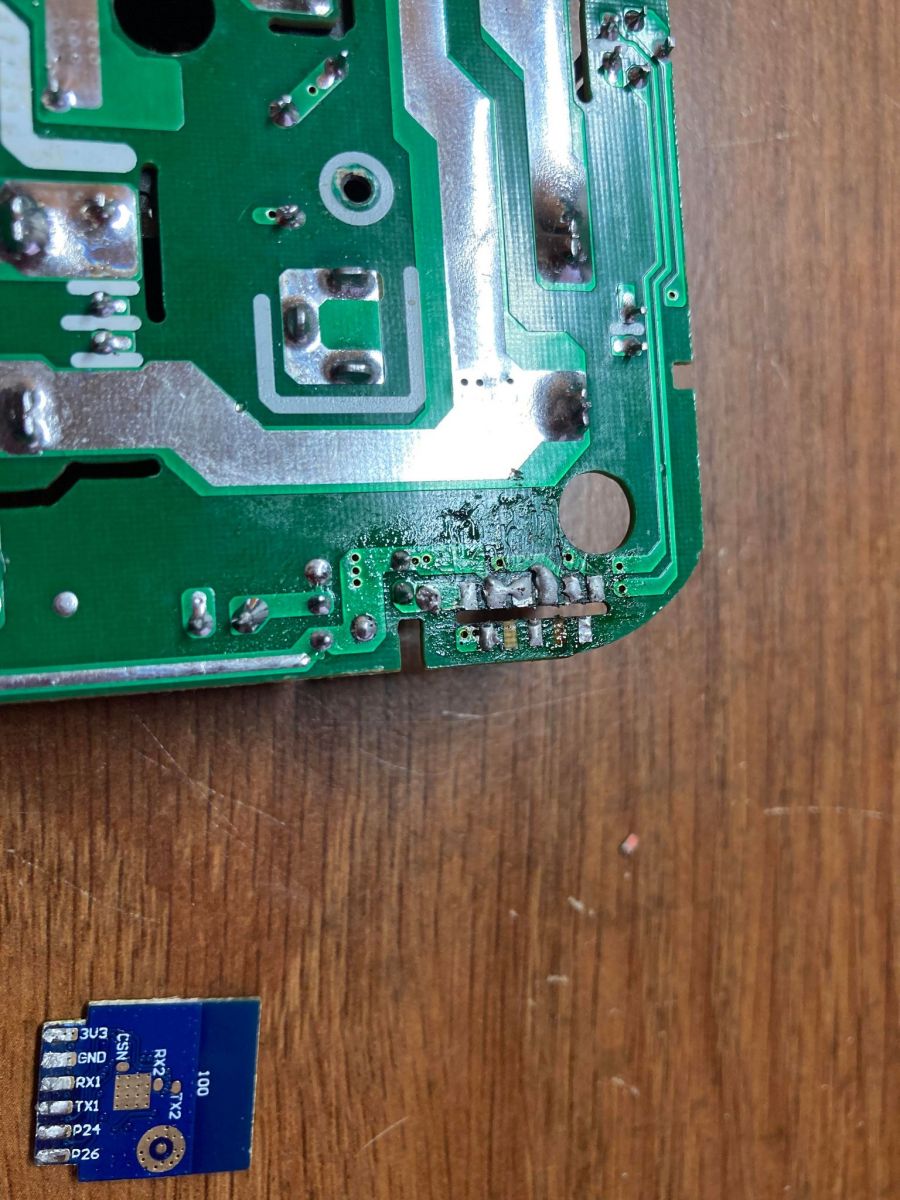

    remove the 2 screws from the circuit board and take it out of the case.

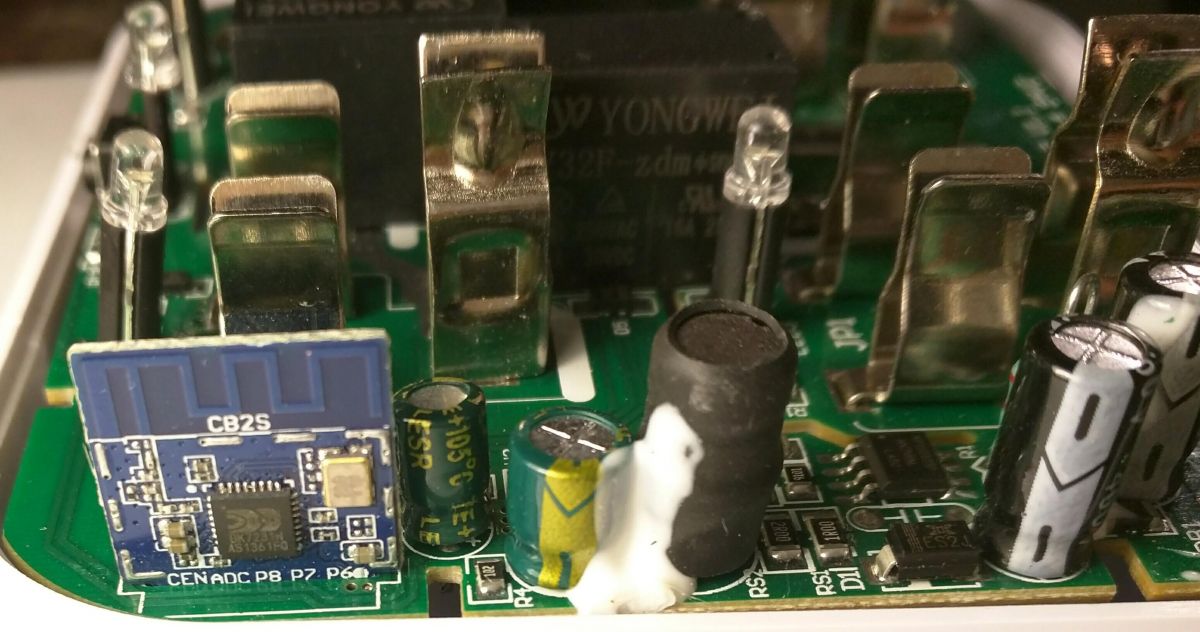

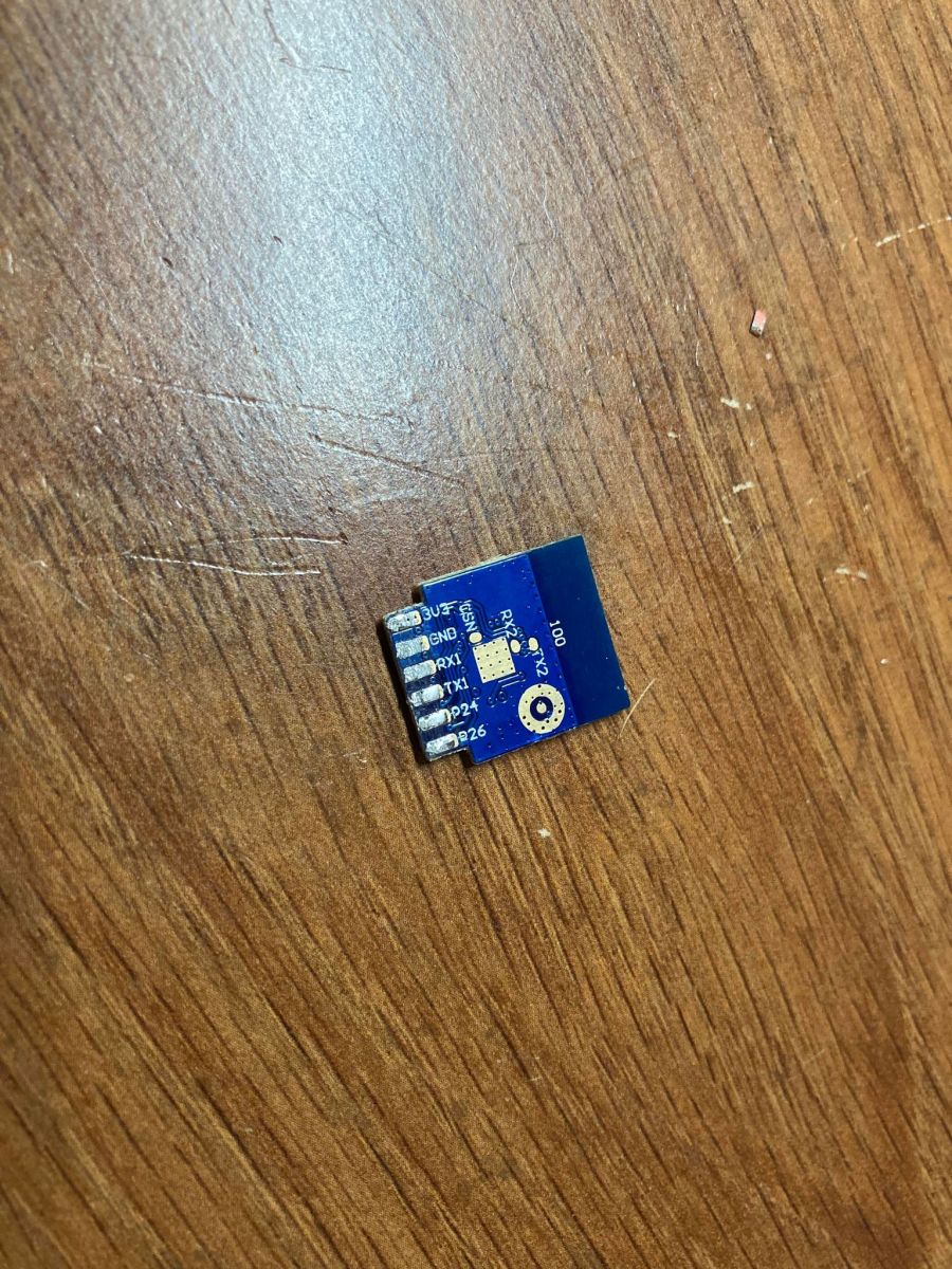

    remove the CB2S chip from the board with a soldering iron, and solder wick or a heat gun.
    careful not to damage the pads as shown in the photo
    circuit interferes with chip flashing.
    it might be possible to remove a capacitor or other component for same affect
    Pins on CB2S chip are clearly labeled.
    attach serial programmer to 3.3 GND TX and RX as usual.
    Flash chip and reassemble.

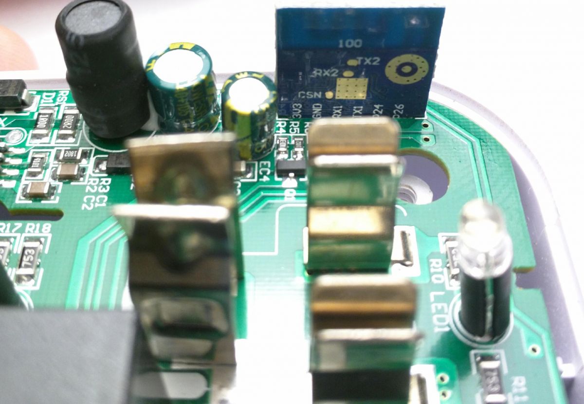

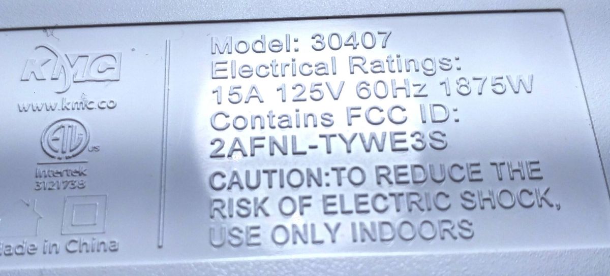

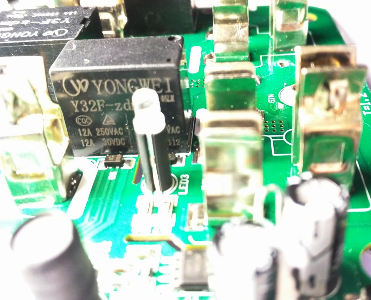

    Hello, your configuration specifies 3 relays and WiFi led, but the device seem to have 4 relays. Is your configuration complete?
    It is also worth to note the device marking:
    - Model 30407
    - FCC ID 2AFNL-TYWE3S
    It's interesting that FCC ID indicates wrong WiFi module.

    it says on the case
    FCC ID 2AFNL-TYWE3S
    but it has a CB2S with the stupid BK7231N chip!
    So these are *NOT* approved by the FCC!
    All of the approved units were using TYWE3S units as documented and pictured on FCC
    Tuya claims that the CB2S is FCC approved, but they cannot just slap their stupid Tuya chips on those units and keep FCC compliance.
    I am sooo dissapointed, this is the third newly bought unit which was changed to BK7231.
    Shame on you Tuya!

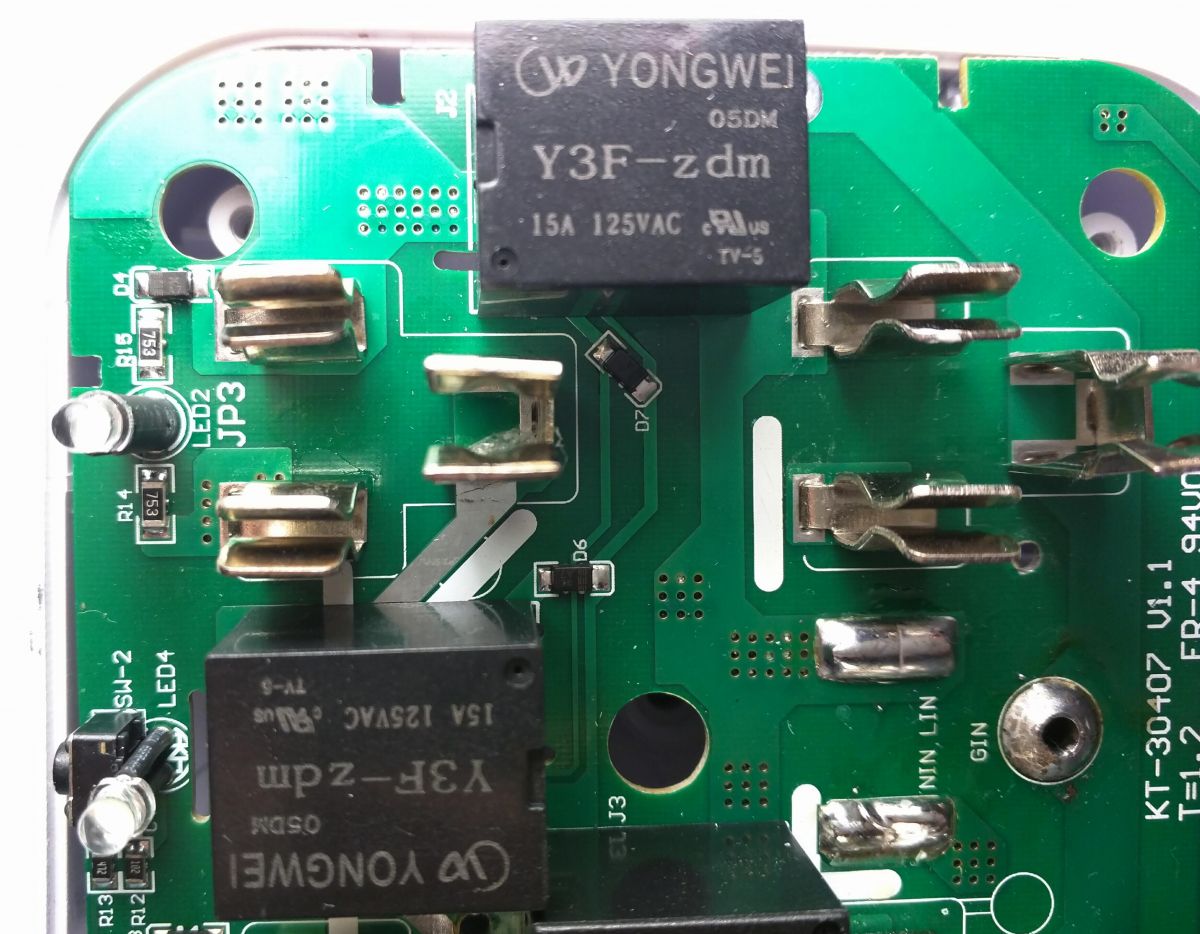

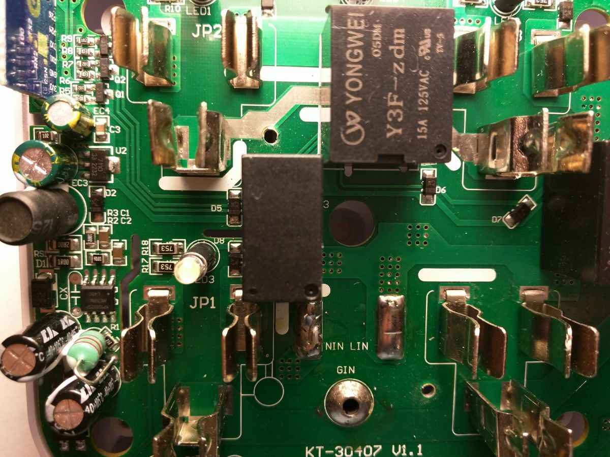

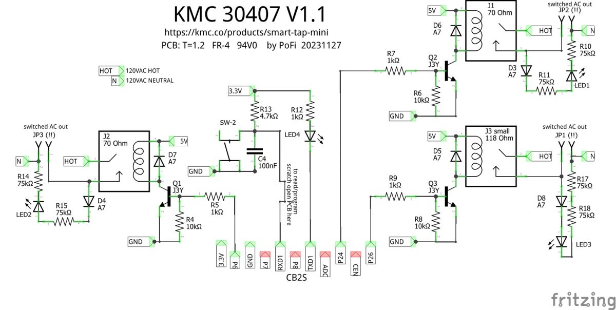

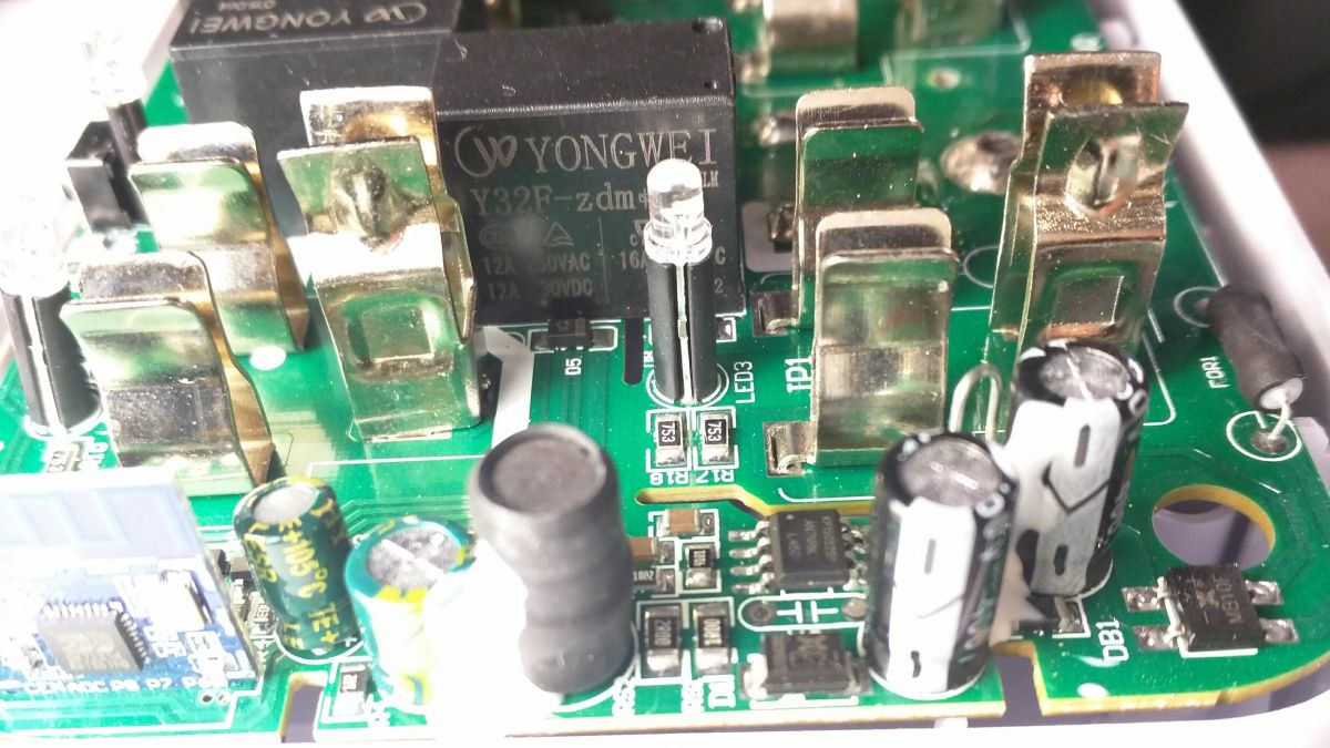

    Photo of the interior of the KMC-30407 electrical circuit with visible components. Circuit board with electronic components, including capacitors and an RF module. Close-up of an internal part of an electronic device with a visible CB2S chip. Smart plug PCB with YONGWEI relays. Close-up of a circuit board with YONGWEI Y32F relays. Close-up of internal circuitry on a PCB with electronic components. Open casing of KMC Smart Tap Mini showing internal components with a leaflet beside it. Label on KMC device model 30407 with electrical information and warning. [/img]
    Hinzugefügt nach 41 [Sekunden]:
    https://github.com/tuya-cloudcutter/tuya-clou...s/kmc-30407-smart-tap-mini-4-outlet-plug.json
    CB2S RF chip BK7231N
    Pin configuration
    P6 Rel2
    P24 Rel1
    P26 Rel 3
    RX1 button
    TX1 LED
    Notes:

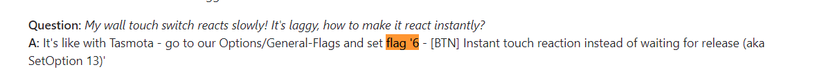

    ALL 3 relays turn on and off at the same time!
    The relays cannot be controlled indiviually.
    They switch on/off when the button is RELEASED (not pressed).
    Two of the realys are rated for 15A, the other 12A.
    Maybe a better software than the existing stupid Tuya can control the relays individually?
    The circuit supports three individual controls.
    RX1 has an RC to GND.
    Definitions:
    VCC 3.3V of KP15052 DC/DC converter, KP1505X_REV1.04_EN.pdf
    GND minus of MB10F
    J1 15A Relais, switches plug 2
    J2 12A Relais, switches plug 3
    J3 15A Relais, switches plug 1
    SM2 mini button
    R5,7,9,12 1K
    R4,6,8 10K
    R13 4K7
    Q1-3 J3Y Transistor
    C4 small ceramic capacitor
    Partial Circuit:
    P6--R9-bQ1c-J2
    GND-R8-bQ1e-GND
    P24-R7-bQ2c-J1
    GND-R6-bQ2e-GND
    P26-R5-bQ3c-J3
    GND-R4-bQ3e-GND
    RX1-R13-aSM2a-C4-GND
    SM2b-VCC
    TX1-cLED
    RX1-R12-aLED

    Everything in OBK is fully scriptable, you can easily support that device and script it for each relay to work with single click, double click, or triple click. We already have examples for that in our docs.

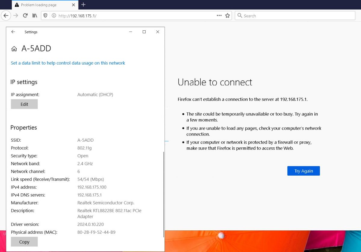

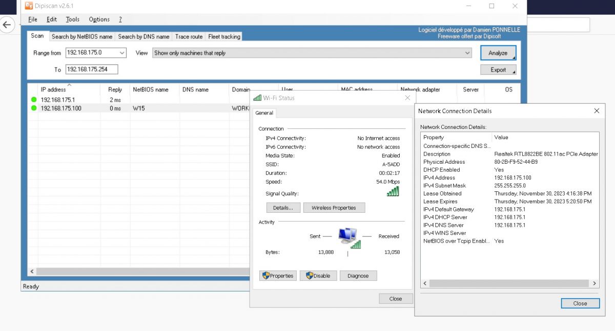

  • Cloudcutter OTA flashing issue on BK7231 devices
    #5 20804642
    omniron
    Posts: 114
    Wow that's impressive, didn't know that, thanks!
    My problem is that I cannot remove the small boards and must flash OTA.
    I was able to flash all ESP devices with Tasmota OTA, no problem.
    But most of the new bought devices are now with BK7231 and I cannot flash them anymore!
    The Schuko SWP86 (now BK7231)
    Xenon SM-PW801-U2 (new design, now BK7231)
    and even the
    KMC 30407 profile: https://github.com/tuya-cloudcutter/tuya-clou...s/kmc-30407-smart-tap-mini-4-outlet-plug.json
    fail.
    What am I doing wrong, especially since the KMC 30407 actually has a profile here?
    Can you please help me to get these going OTA?

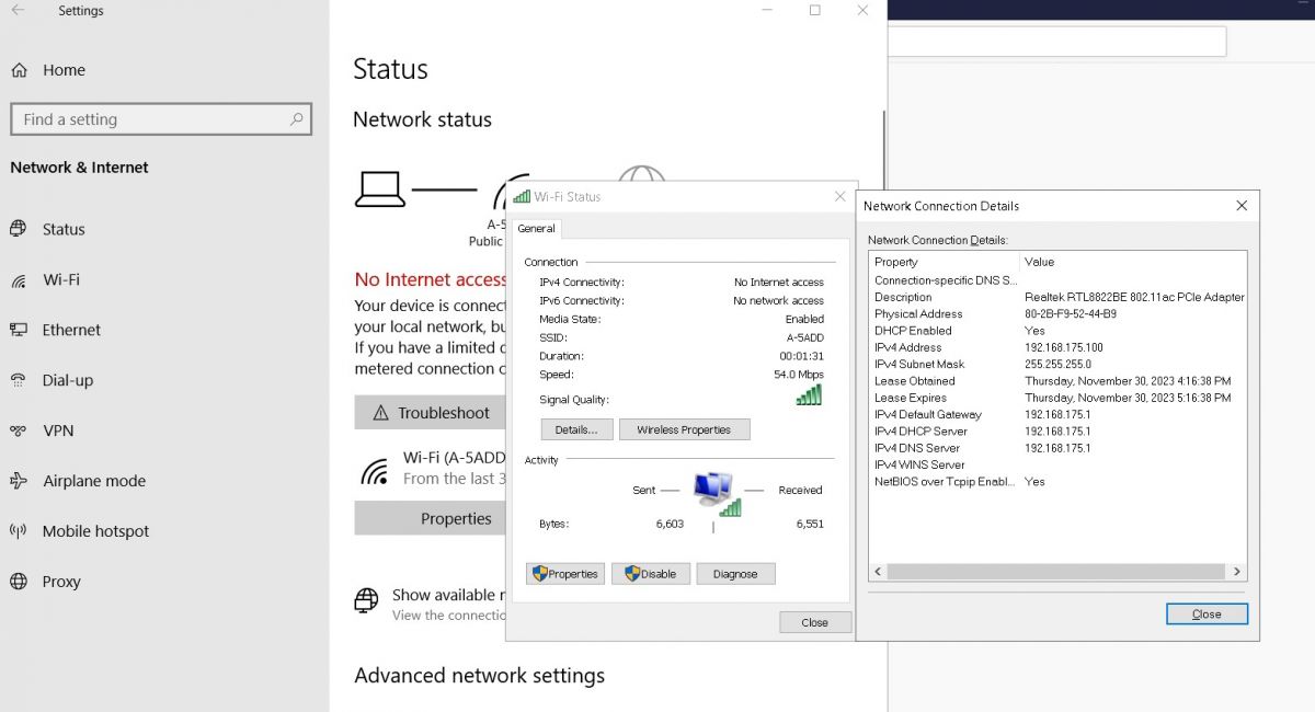

    Place your device in AP (slow blink) mode.  This can usually be accomplished by either:
    Power cycling off/on - 3 times and wait for the device to fast-blink, then repeat 3 more times.  Some devices need 4 or 5 times on each side of the pause
    Long press the power/reset button on the device until it starts fast-blinking, then releasing, and then holding the power/reset button again until the device starts slow-blinking.
    See https://support.tuya.com/en/help/_detail/K9hut3w10nby8 for more information.
    Scanning for open Tuya SmartLife AP
    Found access point name: "SmartLife-4CA3", trying to connect...
    Device 'wlan0' successfully activated with '9ea4e1c7-1a1d-4d26-a15f-d49fc6eac10c'.
    Connected to access point.
    Waiting 1 sec to allow device to set itself up...
    Running initial exploit toolchain...
    Exploit run, saved device config too!
    output=/work/configured-devices/Cdh3UcKVKTtE.deviceconfig
    Saved device config in /work/configured-devices/Cdh3UcKVKTtE.deviceconfig
    Power cycle and place your device in AP (slow blink) mode again.  This can usually be accomplished by either:
    (process:2703): GLib-GIO-WARNING **: 16:14:15.149: ../../../gio/gdbusobjectmanagerclient.c:1589: Processing InterfaceRemoved signal for path /org/freedesktop/NetworkManager/AccessPoint/193 but no object proxy exists
    (process:2703): GLib-GIO-WARNING **: 16:14:15.153: ../../../gio/gdbusobjectmanagerclient.c:1589: Processing InterfaceRemoved signal for path /org/freedesktop/NetworkManager/AccessPoint/194 but no object proxy exists
    Device 'wlan0' successfully activated with '016f0fae-cf0c-45bb-bc3e-a168c54a77e7'.

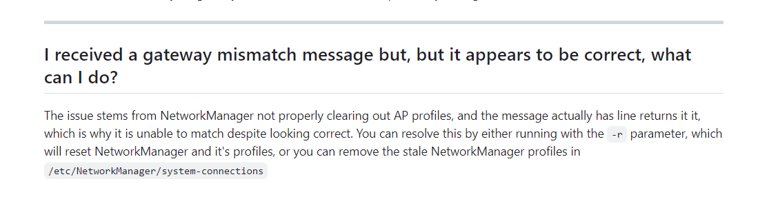

    Expected AP gateway = 192.168.175.1 or 192.168.176.1 but got
    192.168.175.1
    (process:2917): GLib-GIO-WARNING **: 16:14:50.171: ../../../gio/gdbusobjectmanagerclient.c:1589: Processing InterfaceRemoved signal for path /org/freedesktop/NetworkManager/AccessPoint/231 but no object proxy exists
    (process:2917): GLib-GIO-WARNING **: 16:14:50.172: ../../../gio/gdbusobjectmanagerclient.c:1589: Processing InterfaceRemoved signal for path /org/freedesktop/NetworkManager/AccessPoint/232 but no object proxy exists
    (process:2917): GLib-GIO-WARNING **: 16:14:50.172: ../../../gio/gdbusobjectmanagerclient.c:1589: Processing InterfaceRemoved signal for path /org/freedesktop/NetworkManager/AccessPoint/233 but no object proxy exists
    Device 'wlan0' successfully activated with '7c96d8ff-de93-4143-8ed9-99ed7ff2f5e5'.
    192.168.175.1
    (process:3128): GLib-GIO-WARNING **: 16:15:03.230: ../../../gio/gdbusobjectmanagerclient.c:1589: Processing InterfaceRemoved signal for path /org/freedesktop/NetworkManager/AccessPoint/257 but no object proxy exists

  • 2 MB flash dump and logic schematic shared
    #13 20836512
    omniron
    Posts: 114
    I was unable to flash OTA!
    Tried all options.
    So I opened the unit and was finally able to get the flash.
    Attached is the 2MB flash.
    I made a schematic of the logic part, to see if the stupid CB2S needs to be removed like OP did.
    I could access it by scratching open a trace.
    Circuit diagram of the KMC 30407 V1.1 device with components like diodes, resistors, and transistors.
    Hope you can now help me flash the other units via OTA.
    Thanks!

    Thank you, this schematic is very informative.
    I'll see what I can do about OTA for that device and reply here again. If I don't reply, please remind me.

    Didn't know these came with WB2S. OP and me have the CB2S.
    Originally these came with ESP TYWE3S, as noted on their FCC ID, pictured above.

    I've had to consult about that problem, but now I know that you need to run it with the -r flag, you have NetworkConnection profiles that are not getting properly removed.
    Excerpt from an article explaining the issue with incorrect network profiles in NetworkManager.

    I searched myself and could not find anything, bravo!!
    So I removed many many files from system-connections.
    But then somehow Docker wasn't working, hat to resinstall, and now it WORKED!!

    Does the problem happen on only one device? So IP 192.168.4.1 is not reachable?
    Can you try to connect to AP with other device?
  • AP mode gives 192.168.4.100 then 192.168.175.100
    #19 20840967
    omniron
    Posts: 114
    I opened another of these, but added the AP info
    sudo ./tuya-cloudcutter.sh -r -s tasmot 12345678
    It didn't connect to tasmot, but at least this unit does react to the switch.
    All realys turn still on at the same time.
    Since switch was working I could get into AP mode.
    I got 192.168.4.100, but 192.168.4.1 did not respond
    Then AP timed out and after that I got
    192.168.175.100 (!), and again, 192.168.175.1 did not react.
    Screenshot showing Windows network status with no internet connection.
    Screenshot of Dipiscan program with network connection information.
    Did I do something wrong?
    • 30407 Smart Tap Mini 4 Outlet Plug BK7231N.175.7z (2.45 KB) You must be logged in to download this attachment.

    Posts: 114
    it says
    wlan0: Could not connect to kernel driver
    Added after 7 [minutes]:
    The 30407 actually got an IP from tasmot!
    I can ping it, it's very slow, ~40-60ms, but it reacts.
    However if I go to it's IP (http and https) it times out
    Added after 5 [minutes]:
    in my (DHCP) router the 30407's name is wlan0 !!!???
  • #21 20841176
    Posts: 14791
    Rate: 12937
    Sorry, can you provide more information on what's wrong?

    After you magically found that the NetworkConnection profiles are not getting properly removed, I removed them manually.

    I tried portscanner etc but it would not respond and constantly time out.
    Then I checked and saw to my suprise that this second 30407 requested and received an IP from my home router.
    So the "-s tasmot 12345678" seemed to have worked (but no response).
    I also noticed the the name under which it requested from the home "tasmot" SSID was:
    wlan0
    So I guess that something went wrong with wlan0?

    As you wished, today I set my Laptop to a fixed IP in the 30407's AP mode subnet range of 192.168.175.xx (not 192.168.4.xx)
    Tried to get via webbrowser to 192.168.175.1 but it times out.
    Ping to 192.168.175.1 is successful, with ping times of just 2ms (was much higher in the beginnig).
    As can be seen, the AP mode hotspot name is
    A-5ADD
    and not cloudcutterflash.
    Screenshot of network settings and a connection error message.
    Thanks!
    A-5ADD
    Thanks!
    This means that you didn't flash OBK. This means your device is still on Tuya firmware. OBK will never create access point like:
    A-5ADD
    OBK will also never listen for connections on that IP:
    On BK7231 platform, OBK waits for connections on 192.168.4.1 and not on any other IP.
    So, to sum up, I would say that the device you are trying to configure didn't flash OBK correctly and it's still on Tuya firmware.

    Just the fact that something changed with the 30407 (tuya device) shows that there is some flashing happening?
    After flashing, the AP mode of the 30407 does transmit with SSID "A-5ADD" .
    The 30407's own IP is then 192.168.175.1
    My my laptop is getting 192.168.175.100 from 30407' AP mode
    So some flashing/initializing did work via cloutcutter here, don't you think?
    Then there is the Raspberry Pi AP (SSID tasmot), it is always on and expects the 30407 to connect to after flashing.
    The second 30407 (30407B) I flashed (where I could restart tuya's AP mode) does connect to the Raspberry Pi as "wlan0".
    The same "wlan0" which was listed as an error.
    But I cannot talk to the 30407be it via my laptop or PC (with a different WiFi radio).
    Both computers get IP's from the Raspberry Pi also, but I cannot get into the 30407B, be it via 30407B's own AP, or via Raspberry Pi's AP (static or DHCP).
    Could it be that the "wlan0" error causes a one way communication?

    omniron wrote:
    AND, the switches flip AFTER button release, which is really weird.
    It's a known problem, you can make button react faster but it will break click and double click events.
    Screenshot of a document excerpt with a question and answer about speeding up wall switch response.
    Source: https://github.com/openshwprojects/OpenBK7231T_App/blob/main/docs/faq.md

How do I stop OTA failing at the ‘wlan0: Could not connect to kernel driver’ error?
Delete old connection files in /etc/NetworkManager/system-connections/ or run cloudcutter with -r so it cleans them automatically. This fixes the repeated SSID miss and gateway mismatch [Elektroda, omniron, post #20839694]
