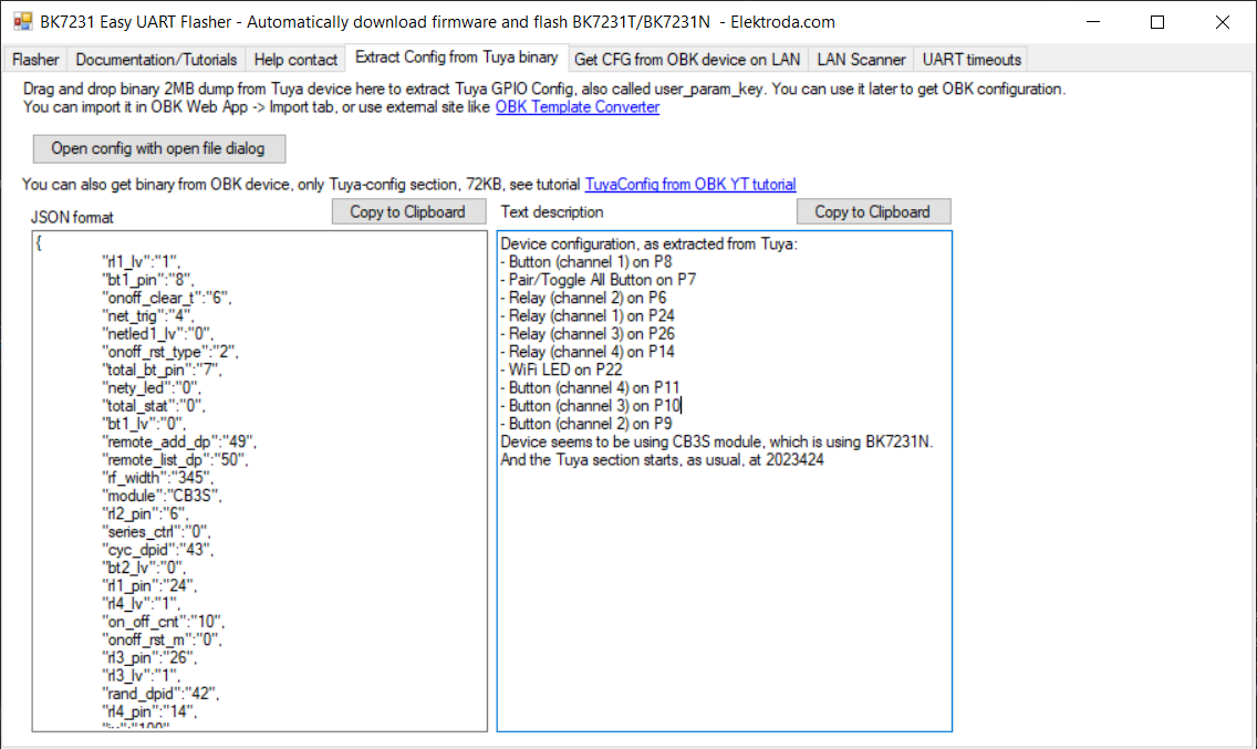

    Here is Tuya JSON config for this device:
    As exported by https://github.com/openshwprojects/BK7231GUIFlashTool :
    User interface of a device configuration tool showing Tuya JSON code.
    Text description:
    - Button (channel 1) on P8
    - Pair/Toggle All Button on P7
    - Relay (channel 2) on P6
    - Relay (channel 1) on P24
    - Relay (channel 3) on P26
    - Relay (channel 4) on P14
    - WiFi LED on P22
    - Button (channel 4) on P11
    - Button (channel 3) on P10
    - Button (channel 2) on P9
    Device seems to be using CB3S module, which is using BK7231N.

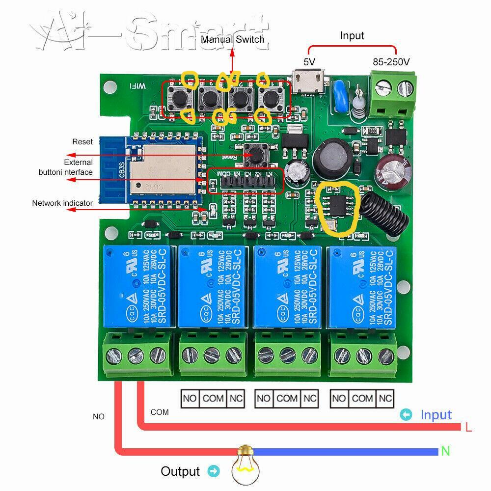

    Can you check which GPIO is connected to RF receiver? How does the board looks like from the close up?
  • #5 20903224
    lionboy
    Posts: 69

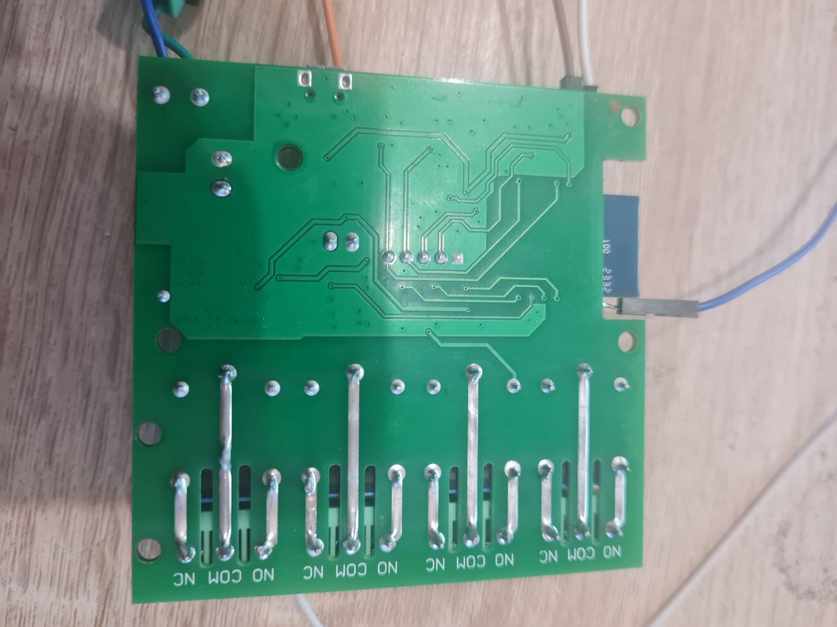

    I need to take from my gate again and make some pictures but I have another one with Zigbee. Do you think I can figure it out from that or do I need this with CB3S? They are the same, only one is with Zigbee and another with CB3S.
    Added after 4 [minutes]:
    Electronic module with labeled components and indicators.
    I found these pictures on the net. I don't know if they are okay.
  • #6 20903254
    Posts: 14580
    Help: 654
    Rate: 12604

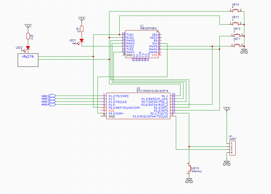

    But is RF receiver connected to CB3S via single pin, or is it integrated into buttons driver?
    RF receiver integrated into buttons controller (another SOIC chip) does not require any drivers on OBK side, it should work out of the box

    Added after 1 [hours] 49 [minutes]:
    On the chip near antena is this write: 590R 2326 i don't know what is this and didn't find on google something related to this
    Schematic image of an electronic board with labeled components such as buttons, network indicator, and antenna.
    Pin with ywllow i saw have a beep with Antenna

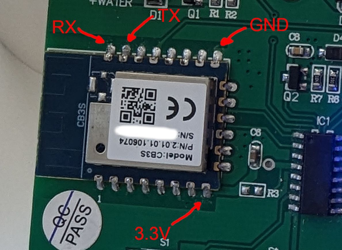

    Hi
    I can't get a connection to the device
    Which flashers did it do it with?
    Which pins did you use?
    I still have to add something extra
    I have it like this in this picture
    Electronic module on a board with labeled RX, TX, GND, and 3.3V pins
    greet
    Martin

    CB3S can be easily flashed with:
    But you need to be able to do a power cycle.
    See tutorials: https://www.youtube.com/playlist?list=PLzbXEc2ebpH0CZDbczAXT94BuSGrd_GoM

    so I must
    GND -> GND
    3V -> ADC3
    RX -> TX
    TX -> RX
    CEN -> GND kurz
    additionally
    AMS1117
    left GND -> GND(1)
    right 5V -> IN(3)
    Do I have to do the cutting, if so where?

    I would do:
    - RX to TX
    - TX to RX
    - GND to GND
    - connect 5V from USB to board USB port
    Then:
    1. start flash read
    2. disconnect 5V and reconnect it to reset/get bus
    3.flashing should start

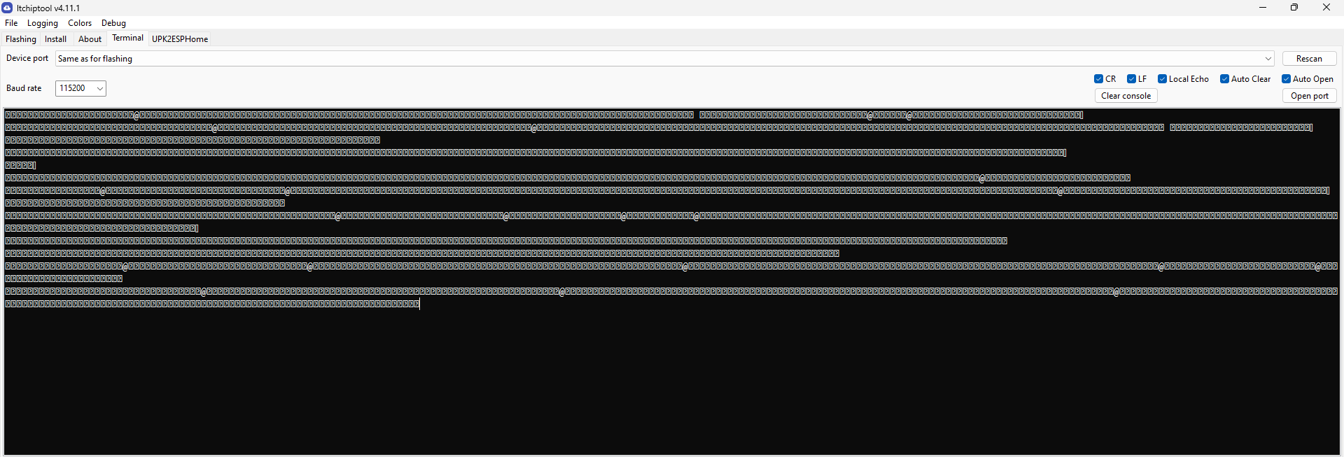

    With the program ltchiptool-v4.11.1 I get such an output at different baud rates
    Screenshot of ltchiptool v4.11.1 with unintelligible console output.
    Not a clear one like with the automatic feeder

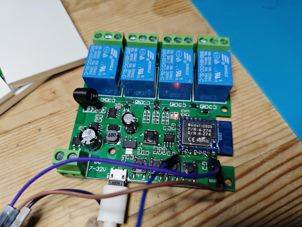

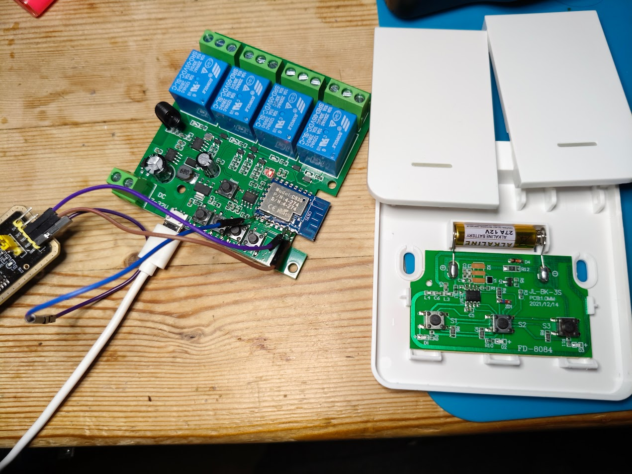

    if there was still any doubt, I have the 7-32V/5V USB version of the naked board of this and the RF operates independently. Mine is now running OBK and it still pairs with this 3-button RF switch I got with a different device.
    Printed circuit board with electronic components and power supply on a wooden surface.
    PCB with four blue relays and a CB3S Wi-Fi module.
    bootlog and dump from mine

    Krazilek
    I have the same board with WB3S.
    The RF keychain is recorded, but the relay is not triggered.
    I can't figure out how to reset it or make it work.
    [BK7231N / CB3S] Tuya Smart Life Garage Door Motor Receiver 4CH Switch Controller WiFi Switch
    AlCube-ISP Check MCU log:
    Checking target MCU ... MCU type: STC15W204SCurrent
    H/W Option: . Current system clock source is internal IRC oscillator . Current frequency: 11.069MHz . Wakeup Timer frequency: 35.975KHz .
    Do not detect the level of P3.2 and P3.3 next download .
    Power-on reset, use the extra power-on delay . RESET pin behaves as IO pin . Reset while detect a Low-Voltage .
    Thresh voltage level of the built-in LVD : 2.69 V . Inhibit EEPROM operation under Low-Voltage . CPU-Core supply level : 2.74 V .
    Hardware do not enable Watch-Dog-Timer . Watch-Dog-Timer pre-scalar : 256 . Watch-Dog-Timer stop count in idle mode . Program can modify the Watch-Dog-Timer scalar . Do not erase user EEPROM area at next download . Do not control 485 at next download . Do not check user password next download .
    TXD is independent IO . TXD pin as quasi-bidirectional mode after reset .
    P1.0 output HIGH level after reset . Reference voltage: 1254 mV (Range: 1150~1320mV)
    MCU type: STC15W204S Complete !
    Silence in the terminal

  • The exported Tuya config maps 4 relays, 4 channel buttons, 1 toggle-all button, and 1 Wi-Fi LED: relay pins P24, P6, P26, P14; button pins P8-P11; toggle-all on P7; Wi-Fi LED on P22. [#20860235]
  • The original dump shows rf_width set to 345, remote_io to 20, and remote_select reported as 1 in one config, while another device dump later showed remote_select as 0. [#21125280]

Which pins should be connected to an FTDI adapter when flashing this BK7231N CB3S garage door board, and how should the power-cycle reset be done?
Connect FTDI RX to board TX, FTDI TX to board RX, and GND to GND. Then power the board separately through its USB port with 5 V, start the flash read, and briefly disconnect and reconnect that 5 V power. The same contributor explicitly said CEN was not needed in his preferred method. [#21120964]
Why does BK7231GUIFlashTool or ltchiptool fail to connect to a CB3S board even when RX, TX, and GND seem to be wired correctly?
Connection often fails because the board never enters the right boot state or because RX/TX are loaded by other circuitry. The thread narrowed the main question to whether the serial lines were connected anywhere else on the PCB. When the normal 3.3 V reset method fails, the suggested fallback was a short CEN-to-GND pulse of about 0.25 s. [#21122594]
How can I check with a multimeter whether the RX and TX lines on this Tuya CB3S board are connected to anything else that could block flashing?
Use continuity mode with all power removed. 1. Unplug the FTDI and all board power. 2. Set the meter to continuity mode and confirm it beeps when probes touch. 3. Put one probe on RX, then probe nearby pads, vias, and traces for a beep; repeat for TX. A beep means that line reaches another point that could interfere with flashing. [#21121370]

What is the SYN590R RF receiver chip, and how is it used in TYWB-4CH-RF or TYWD-4CH-RF relay controllers?
“SYN590R” is a 433 MHz RF receiver IC that accepts remote-control signals and passes decoded events into the relay controller path, often as a separate hardware block. In this thread family, a contributor identified TYWB-4CH-RF and TYWD-4CH-RF as sharing the same Beken CB3S, the same RF SYN590, and the same relay and button GPIO layout. [#21448020]

When RF still works after installing OpenBeken, how can I tell whether the RF receiver is handled independently by another chip instead of by the CB3S firmware?
If RF still pairs and triggers after OpenBeken replaces the original firmware, the RF path is likely independent. One contributor reported exactly that on the 7-32 V or 5 V USB version: OpenBeken was running, yet a 3-button RF switch still paired and worked. Another contributor had already explained that an RF receiver integrated into another SOIC controller would need no OBK-side driver. [#21144422]
