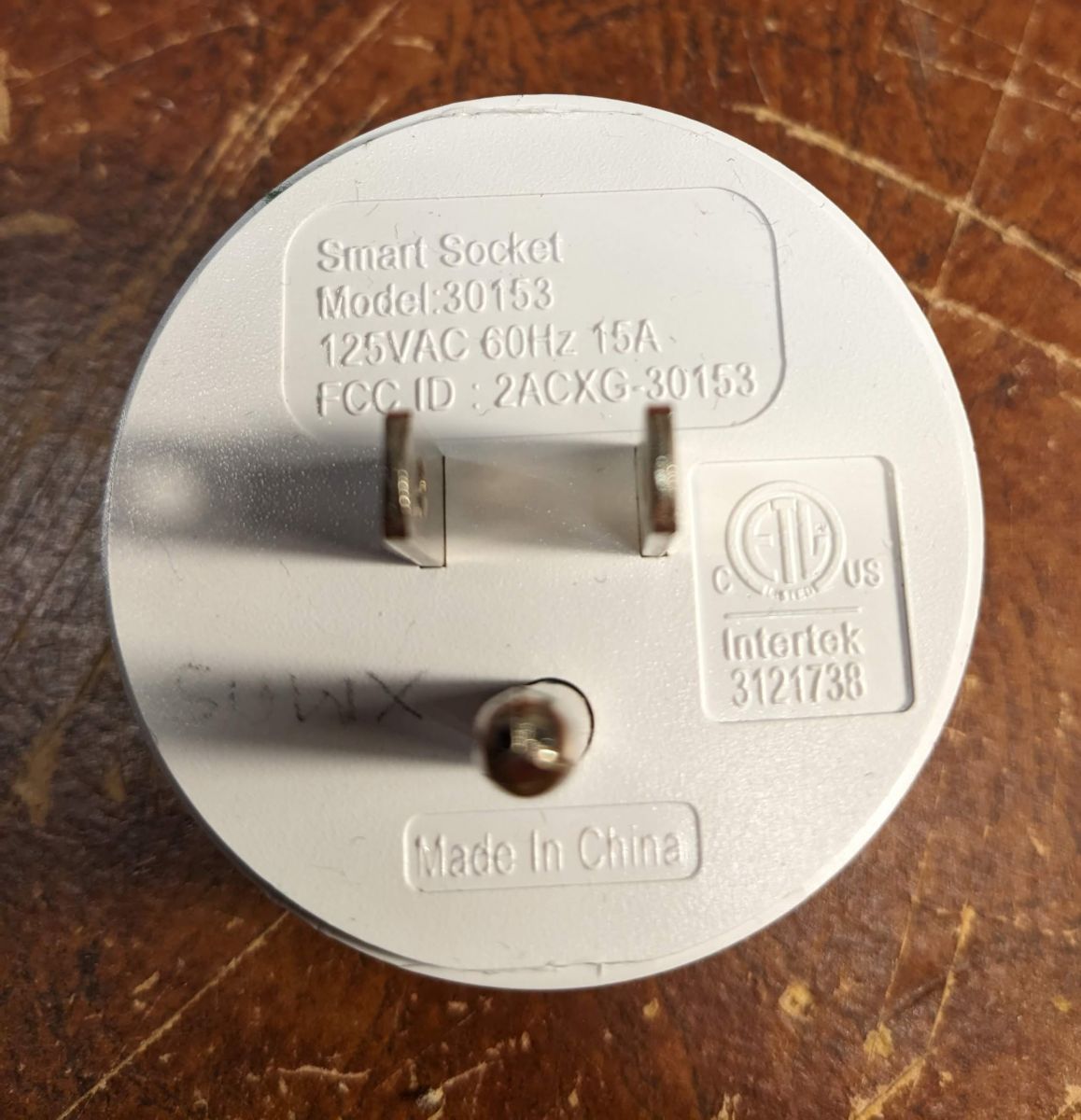

    The Device
    KMC 30153. A "smart mini plug" rated for 15A 125VAC 60Hz. Not so mini however. Plugged into a standard US double socket outlet, would not allow using the other socket with a three prong (grounded) plug. A two prong one would fit.
    Purchased from Amazon.
    Product page: https://kmc.co/products/smart-plug-mini.

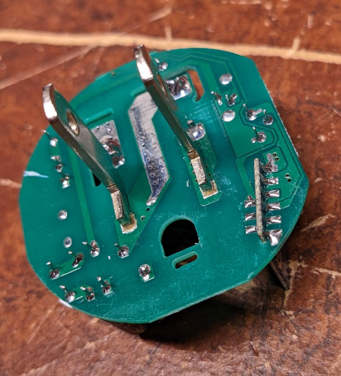

    Teardown

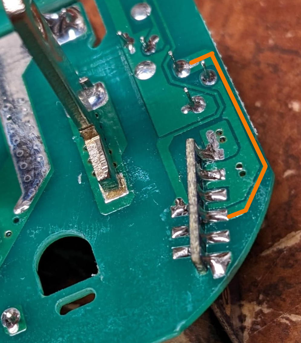

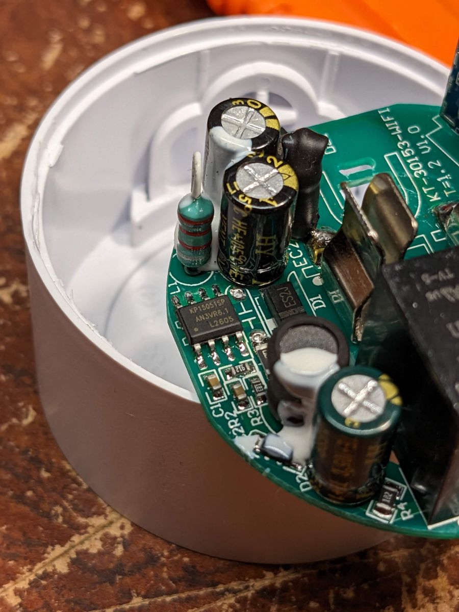

    Fairly easy to do. There are two straight line segments on the perimeter of the back cap. I used a utility knife into those to pry the back cap a bit. Then a sharp small flat screwdriver popped the cap without much resistance. The cap is held with glue. The internals slide out effortlessly. The ground pin is just a pass through. Does not connect to the board.
    !!! Caution !!!
    The cap must be glued back. Otherwise pulling the plug from the wall socket leaves you with the empty shell in hand and exposed hot guts on the socket. Dangerous.
    A very good reason to prefer the wireless tuya-cloudcutter flashing (if/until available) over disassembly for wired flashing.
    I glued the cap back with "Loctite Super Glue Ultra Gel Minis." Left it 24 hours to cure. Tested the plug on a few sockets, and it held together. For now.

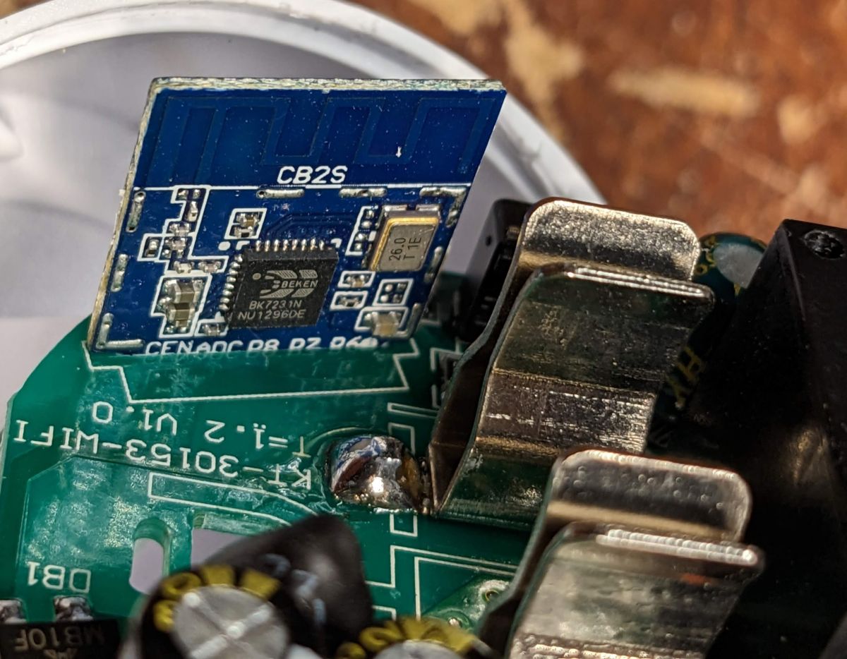

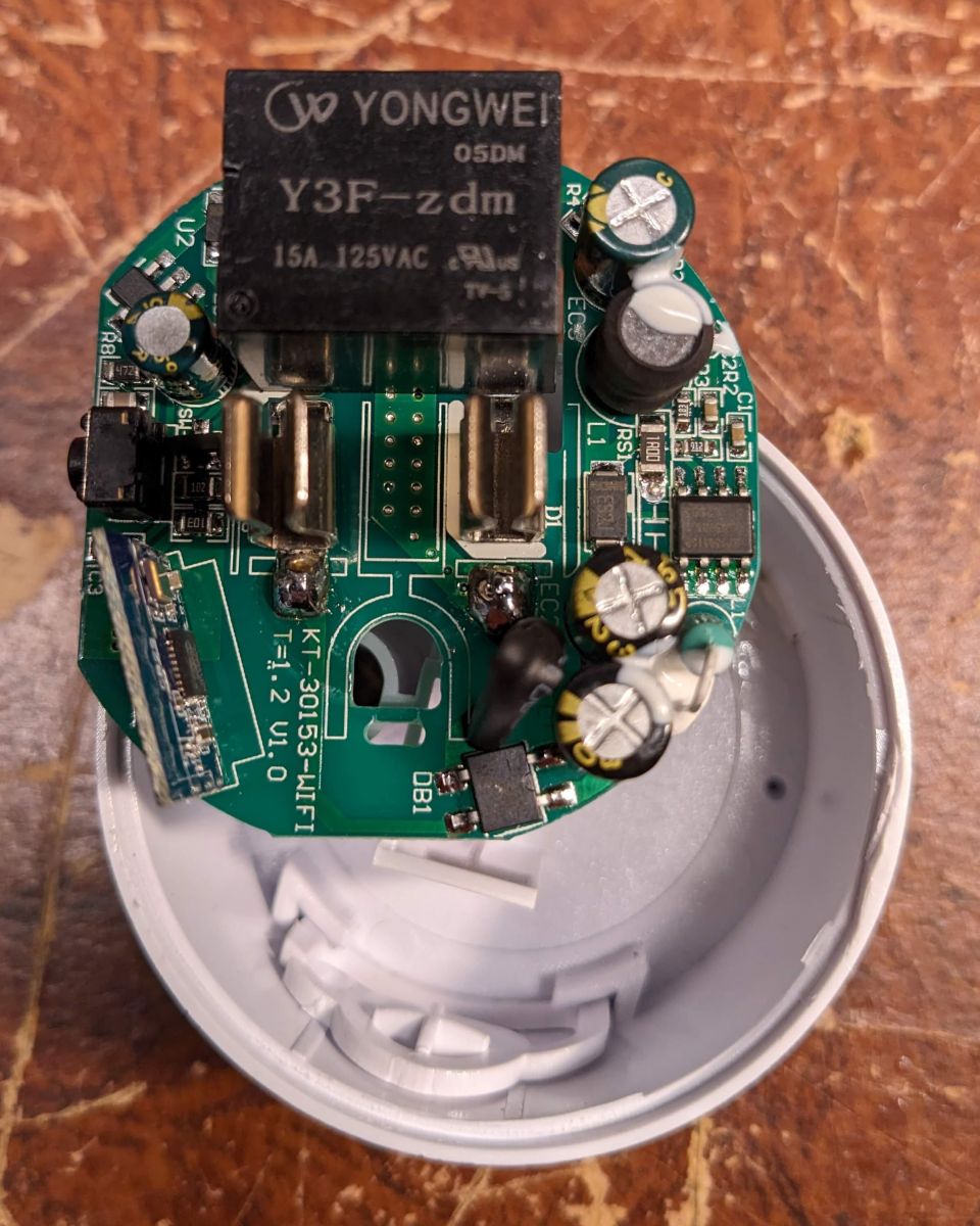

    Hardware Found
    Chip: Beken BK7231N
    Board: CB2S
    Firmware: 1.1.8, as reported by the Smart Life app.

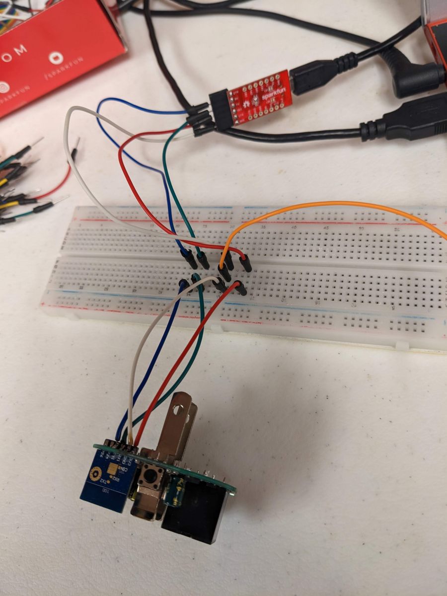

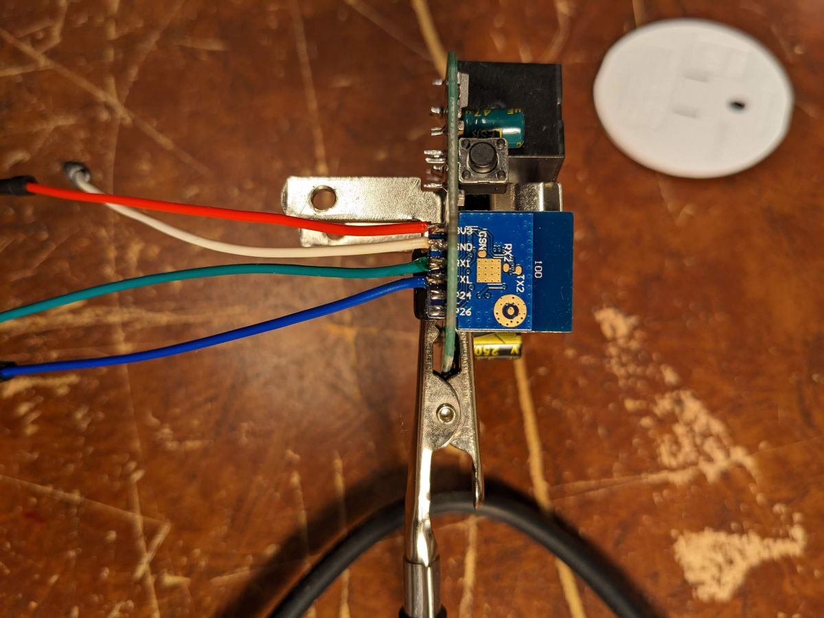

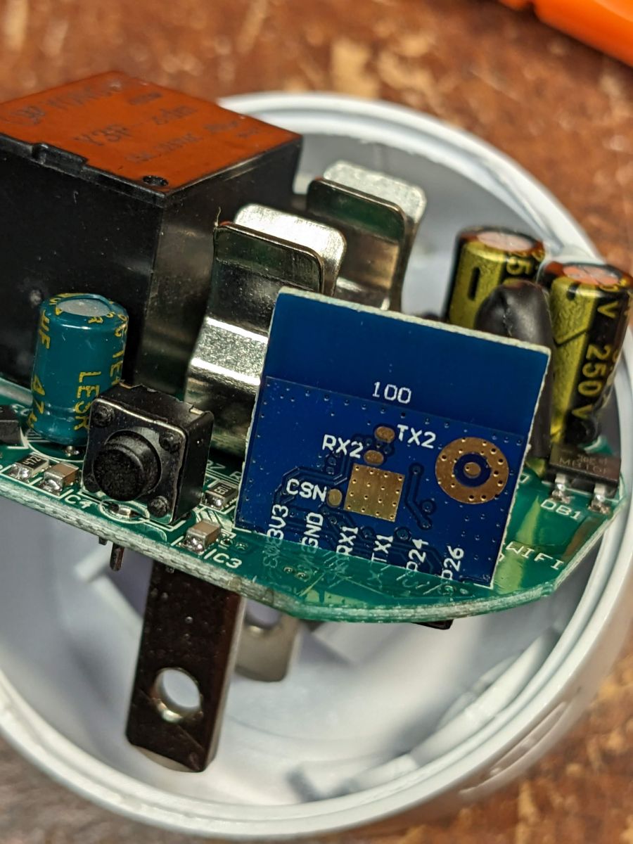

    Soldered breadboard wires to the CB2S module. On the photo:
    * Red - 3V3
    * White - GND
    * Green - RX1
    * Blue - TX1
    I had an orange grounded wire which I used to reset the chip for programming.
    I am using SparkFun FT231X, which I've used before with ESP chips. The board provides 3.3V power.

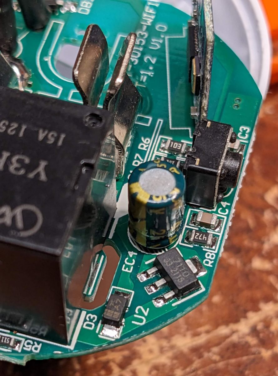

    2. Unsuccessful flashing attempts.
    I was using the uartprogram tool. For the first 20 attempts I figured my reset timing was off. After I did some 40 more attempts, I decided to investigate.
    The issue is that the lonely button on the device is wired to the TX1 pin on the CB2S. In this way:
    [BK7231N/CB2S] KMC 30153 smart mini plug, detailed flashing guide [BK7231N/CB2S] KMC 30153 smart mini plug, detailed flashing guide
    Effectively the TX1 is being pulled up, and this would prevent any proper serial communication. The fix would be to disconnect the TX1 pin from the switch. My plan was to cut the trace marked in orange in the photo below, which corresponds to the orange connection in the circuit diagram above. After flashing I would've reconnected the two points with a piece of wire to restore the button functionality.

    Very nice and detailed guide. I will say few words about your findings.
    You are correct. We had similar issue on CB2S relay:
    The resistor there is indeed a pull up, to, let's say, enforce "default state" as high, and the capacitor is a form of debouncing.
    But the thing is, in OpenBeken, we just enable internal pull ups for buttons and debouncing is done in software.
    So, just a thing to remember in future - that capacitor and resistor can be easily removed permanently and the button will still work in OpenBeken.

Why did UART flashing fail on some units?
The button pulls TX1 high through an RC network, blocking serial traffic. You must cut or desolder the trace/resistor to isolate TX1, then restore it after flashing [Elektroda, tjkolev, 20456956].
