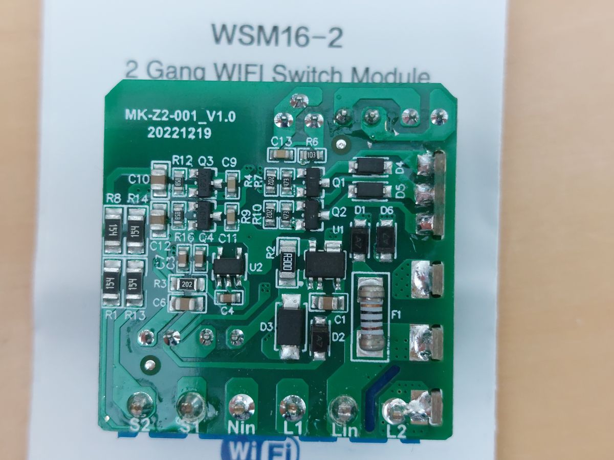

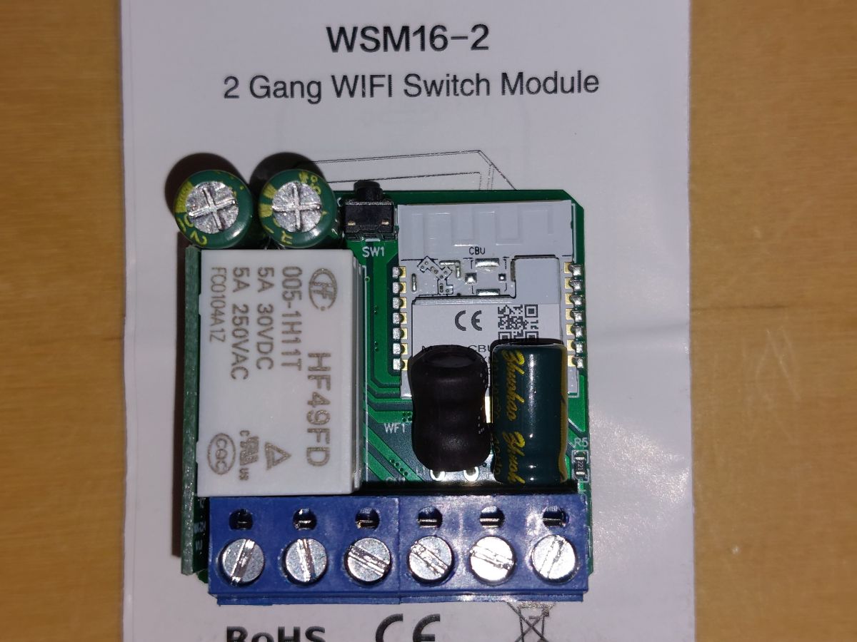

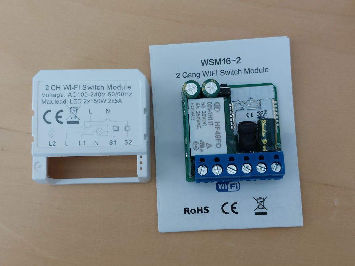

  • Hi there,
    I present you teardown and profile for this switch module
    [BK7231N - CBU] Avatto - 2 Gang Wi-Fi Switch Module
    Brand: Avatto
    Name: 2 Gang Wi-Fi Switch module
    Model: WSM16-2
    Chip: BK7231N
    Board: CBU
    This is the listing where I bought it:
    AliExpress - AVATTO Online Store
    AliExpress - AVATTO Official Store
    Yes, I bought 2 devices, but then I have burned one of them by accident, however, the internals are identical.
    Teardown photos:
    [BK7231N - CBU] Avatto - 2 Gang Wi-Fi Switch Module [BK7231N - CBU] Avatto - 2 Gang Wi-Fi Switch Module
    [BK7231N - CBU] Avatto - 2 Gang Wi-Fi Switch Module [BK7231N - CBU] Avatto - 2 Gang Wi-Fi Switch Module [BK7231N - CBU] Avatto - 2 Gang Wi-Fi Switch Module
    Flashing successful using BK7231GUIFlashTool and pin out diagrams from this thread.
