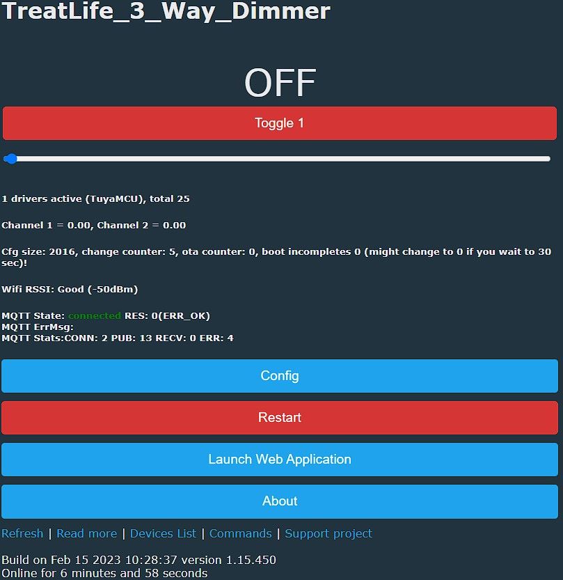

    jakkumn
    Posts: 6
    I spoke too soon, the button on the physical device was working as expected but I am not getting any sort of control from the web interface toggle. The state is not updating nor does the dimmer appear to be doing anything.

    Go to the Web App, enable all logs (debug ones also), do you get TuyaMCU packets?
    Try rebooting device, or totally powering it off for few seconds and again turn on.
    Do you get any kind of TyuaMCU communication working?

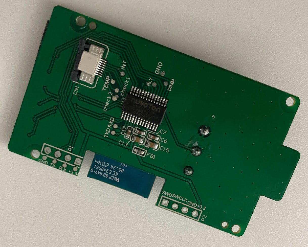

    Hey there!
    Sharing a photo of the latest (to my knowledge) board with the WB3S chip. Board is labelled v2.1, with a revision date of 2020/06/23.
    Not sure if I am missing something, but I can't seem to pull a bus connection. Were you connecting to the RX/TX on the chip itself, or going through the board pins? Do you have an updated diagram which you used with the Beken-chip version?
    Flashing OpenBeken on BK7231T TreatLife 3 Way Smart Dimmer Switch (DS02S): A Guide
    Thanks!

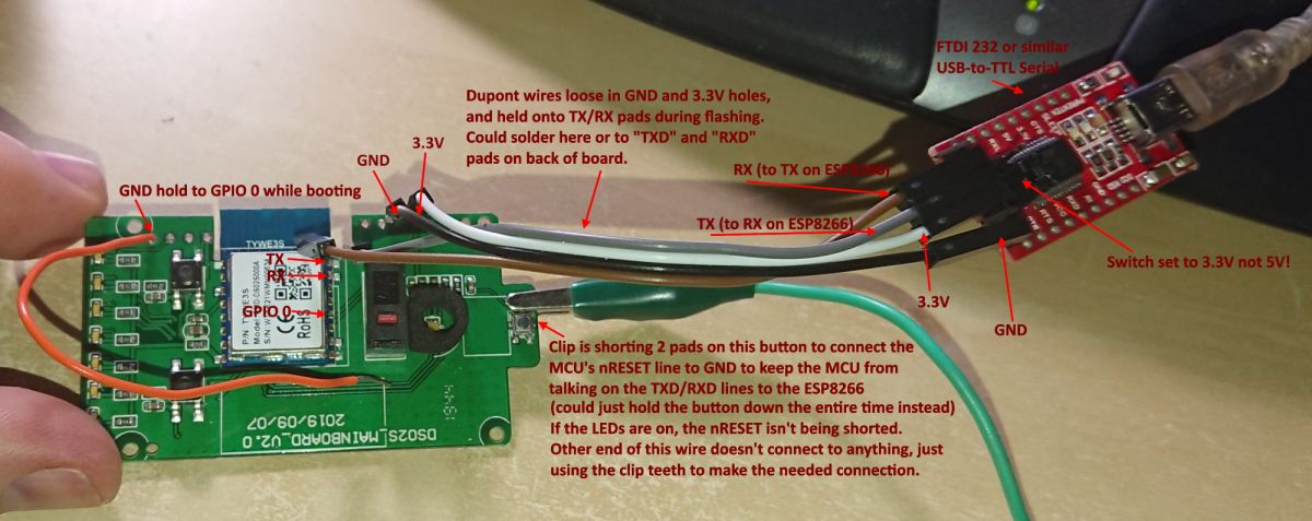

  • #8 20453552
    Posts: 14763
    Rate: 12896

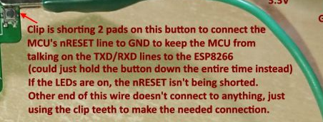

    Solution is in the first post. It's a TuyaMCU device, you have to reset the MCU or cut traces to avoid interference.
    Solution:

  • #10 20453747
    Posts: 14763
    Rate: 12896
    Is your MCU in TSSOP 28-Pin case? Check the linked datasheet where the nRESET pin exactly is.
    I don't think that GPIO0 means anything for Beken, it's not needed
    Remember to do a firmware read and backup first.

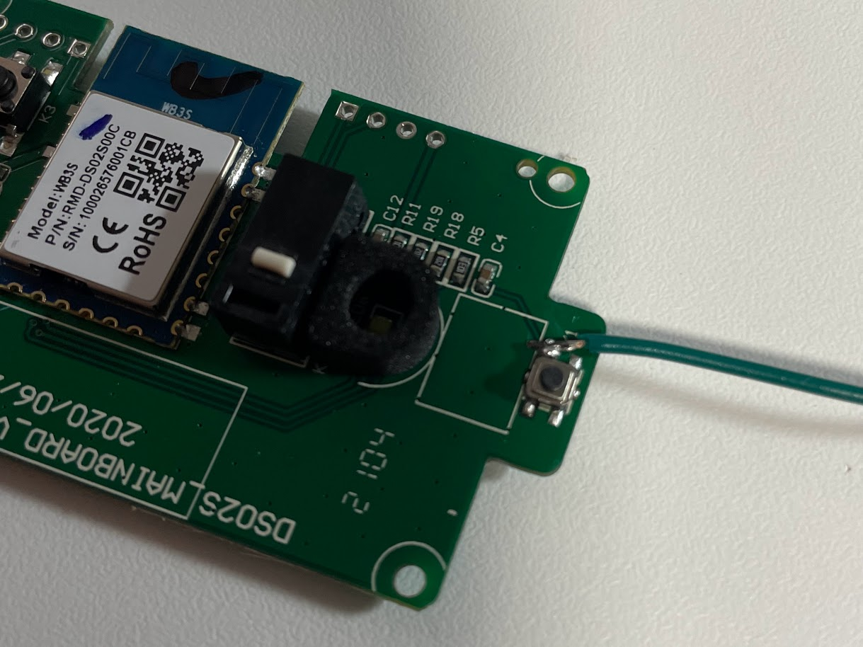

    #11 20457132
    mattj
    Posts: 42
    Rate: 16
    Thanks! I think it was my attempt at grounding NRST - I went ahead and just soldered to the pad near the bottom of the board (with the button) after tracing it from the MCU. Flashed a handful of different BK chips now, slowly getting the hang of branching out to new devices - most just didn't have a Tuya MCU, so it was a bit more straightforward.
    Appreciate all the work here, this OpenBeken project is coming along pretty awesome!

    I toggled the state on via the web interface, went to inspect and didn't see any change. I physically pushed the on button of the switch, saw the lights come on, and then turned it back off. This may be the output found in the log, otherwise it is just the repeated heart beat as seen above.
    ExtraDebug:TuyaMCU:TuyaMCU heartbeat_valid = 0, product_information_valid=0, self_processing_mode = 1, wifi_state_valid = 0, wifi_state_timer=0
    Info:TuyaMCU:Consumed 8 unwanted non-header byte in Tuya MCU buffer
    Info:TuyaMCU:Skipped data (part) F0 F0 F0 F0 F0 0A 02 F8

    That would appear to be it! It is now working as expected. I can now control it from the web UI. Thank you so much for your help! I am going to edit the first post with these notes so that way anyone else that needs it has the information available.
    Next up is doing the home assistant mqtt side of things. I will edit the first post for that when I get to it as well.

How do I flash OpenBeken onto a TreatLife DS02S without opening the housing?
  1. Use tuya-cloudcutter to back-up and push the OpenBeken binary over the air [Elektroda, 20670407].
  2. If OTA fails, open the switch, connect 3.3 V, GND, RX, TX, and pull the MCU nRESET pad low, then run BK7231GUIFlashTool [Elektroda, 20441205].
  3. Power-cycle before first boot. Total hands-on time ≈10 minutes.
Which autoexec.bat script works for the DS02S dimmer?
startDriver TuyaMCU tuyaMcu_setBaudRate 115200 setChannelType 1 toggle setChannelType 2 dimmer tuyaMcu_setDimmerRange 10 1000 linkTuyaMCUOutputToChannel 1 1 1 linkTuyaMCUOutputToChannel 2 2 2 tuyaMcu_defWiFiState 4 [Elektroda, 20463344].
My web UI shows no state changes; what’s wrong?
The TuyaMCU heartbeat is missing because the baud is still 9 600 bps. Add tuyaMcu_setBaudRate 115200 or uncomment the line, then reboot. Users report immediate recovery of heartbeats and control [Elektroda, 20463310; 20463344].
What does tuyaMcu_defWiFiState 4 fix?
Many TuyaMCU boards turn the relay off when they think the cloud is lost. Setting Wi-Fi state to 0x04 keeps the MCU in "connected" mode, preventing random shut-offs when MQTT is unavailable [Elektroda, 20512044].
How can I stop the light from turning off when MQTT drops?
Add tuyaMcu_defWiFiState 4 after the driver start. This holds the MCU in cloud-connected state and eliminated spontaneous OFF events in user testing [Elektroda, 20566728].
Why does brightness below 10 % do nothing?
The MCU’s factory minimum is 10 (1 %). Set tuyaMcu_setDimmerRange 10 1000 or send dpId 3 value 10 to redefine the floor. Values under the floor are ignored [Elektroda, 20566728].
Web toggle reverts after a few seconds on the bench—edge case?
Yes. Without a load the DS02S reverts its reported state to OFF because it senses zero current flow. Install the switch on a real load to get accurate ON/OFF feedback [Elektroda, 20823865].

Is GPIO0 needed for flashing the BK7231T?
No. Grounding GPIO0 is required on ESP8256, but the Beken BK7231T ignores it. Only nRESET must be pulled low during flash [Elektroda, 20453747].
