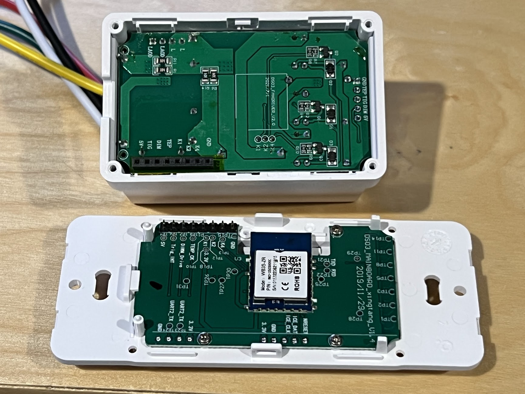

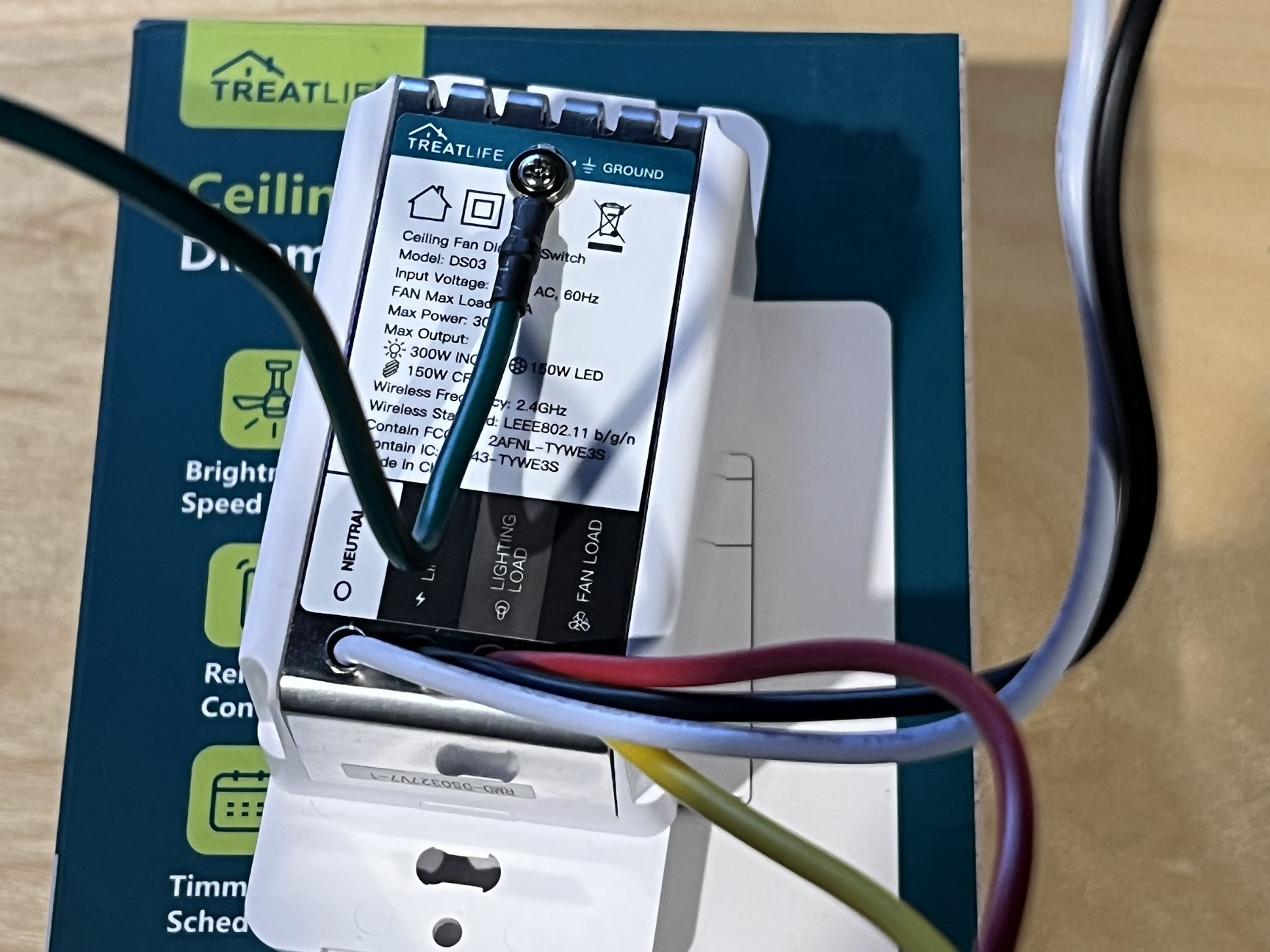

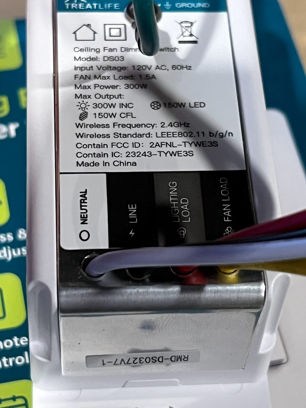

    I picked this up on Amazon for a decent price. Was able to flash OTA with Tuya Cloud Cutter, but there are pads to flash it the standard way. Below are some pictures and the AutoExec.bat commands. Everything appears to work great.
    FCC ID - 2AFNL-TYWE3S - This doesn't appear to be the actual device's FCCID. BK7231T Treatlife DS03 Fan/Light Dimmer Switch: OTA Flash & Setup Guide (TuyaMCU dpIDs) BK7231T Treatlife DS03 Fan/Light Dimmer Switch: OTA Flash & Setup Guide (TuyaMCU dpIDs) BK7231T Treatlife DS03 Fan/Light Dimmer Switch: OTA Flash & Setup Guide (TuyaMCU dpIDs) BK7231T Treatlife DS03 Fan/Light Dimmer Switch: OTA Flash & Setup Guide (TuyaMCU dpIDs) BK7231T Treatlife DS03 Fan/Light Dimmer Switch: OTA Flash & Setup Guide (TuyaMCU dpIDs) BK7231T Treatlife DS03 Fan/Light Dimmer Switch: OTA Flash & Setup Guide (TuyaMCU dpIDs)
     startDriver TuyaMCU tuyaMcu_setBaudRate 115200 setChannelType 1 toggle setChannelType 2 toggle setChannelType 4 dimmer setChannelType 3 OffLowMidHigh tuyaMcu_setDimmerRange 100 1000 linkTuyaMCUOutputToChannel 1 1 1 linkTuyaMCUOutputToChannel 9 1 2 linkTuyaMCUOutputToChannel 3 4 3 linkTuyaMCUOutputToChannel 10 2 4

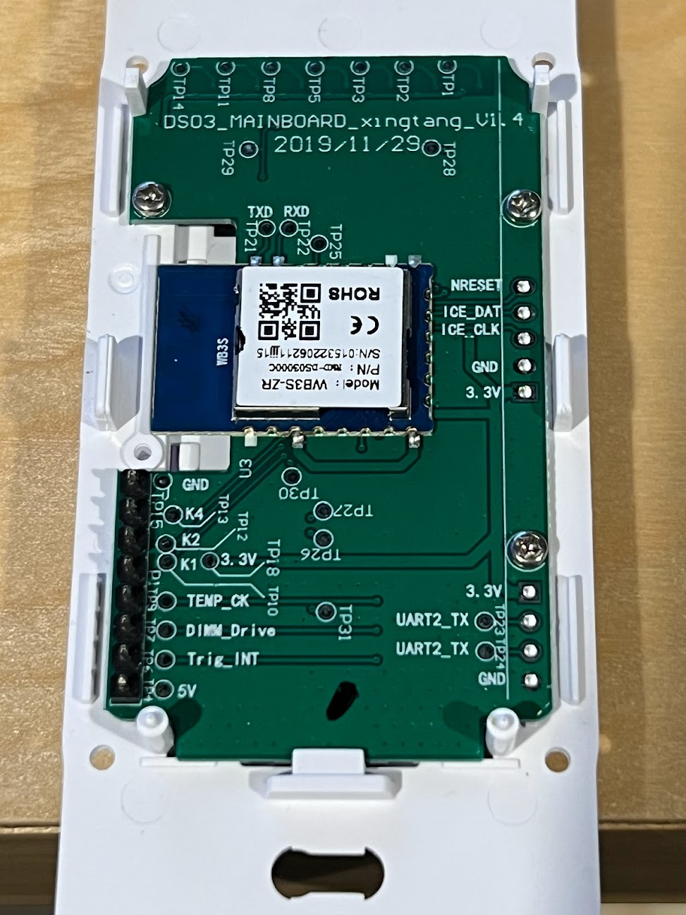

    WB3S-ZR? That's interesting. On which board is the MCU? On the same as WiFi module or on another one?
    That FCC ID seems interesting. Hmm. TYWE3S is an ESP module. So they changed module inside but left FCC ID the same?

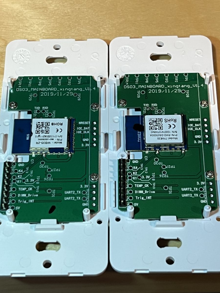

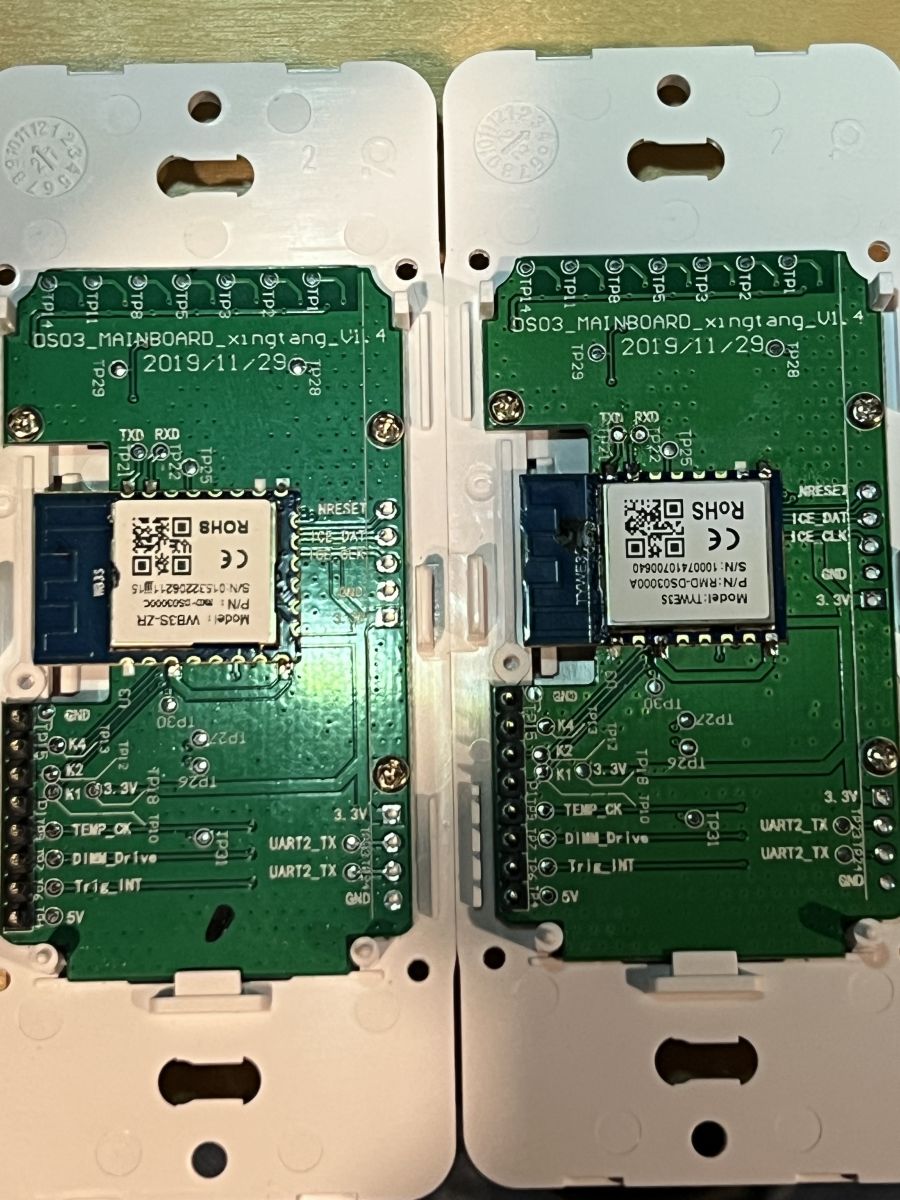

    Thanks for that updated and much nicer looking autoexe. I also wanted to note that I just purchased another DS03 and it came with an ESP chip. Guessing it's old stock, but wanted to throw that out there to double check what chip you have in your device. I was trying to flash for the updated method and then realized that chip was an ESP.

    What was the date/code on the PCB or/and on the packaging? Was there a Bluetooth logo on the package?

    The box, the shell, and the PCB date code are exactly the same.

    They are the same indeed! Very interesting. By the way, the device is not submitted to our online database:

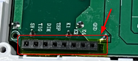

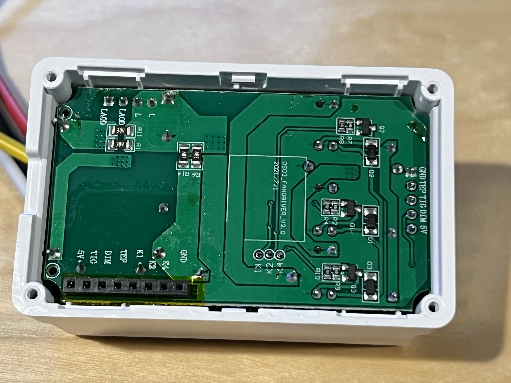

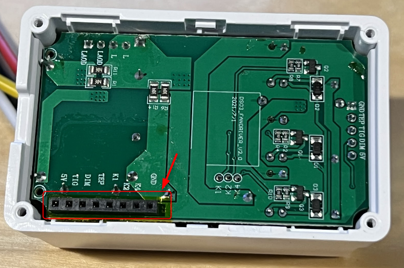

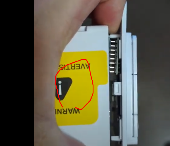

    Hi bleeblak8, quick question, did you have any difficulty pulling the DS03 apart? For some reason I can't seem to pull it apart without the fear of snapping the board, as the boards seem to be attached at the spot I've circled. I'm hoping you have some advice, or maybe they're being made a little differently now and are more difficult to pull apart.
    Context: I can pull it apart just enough to see the model is CB3S so I'm trying to planning on replacing it with a ESP-12 per the following instructions so I can install Tasmota
    https://blakadder.com/replace-tuya-esp12/

    I think it should be possible to flash the BK7231N CB3S wirelessly for this device and run it with OBK, that would save you some risk and money that would otherwise go for ESP module.

  • Clarifying PCB stack and disassembly method
    #19 20652533
    Posts: 14782
    Rate: 12920
    I am sorry to hear that the Cloudcutter has failed with your device. I don't know much about wireless flashing, as I have never used it, I always flash by wires.
    So maybe let's try to take out the PCB and solder the wires. What is exactly the problem here? Maybe we just need to experiment with one of your devices and see how to safely disassemble it.
    Can you tell me, was there a daughter board on top of that connector?
    or are you saying there is another board under it? If there is another board under it, it should be possible to pull that first board out.
    Maybe use two flat screwdrivers as levers, from two opposite sides, and gently pull it up...
    Or do you think it's soldered?
  • Pins appear to be holding the boards together
    #20 20653603
    IsThisRight
    It's kind of hard to explain, so here's a video showing what I mean. As you can see in the video, while trying to separate it, the boards are being pulled and stretched and are bending because they're stuck together somehow. As far as I can tell, the points of restriction are those pins that I focus the video on.
    https://photos.app.goo.gl/rGF1WwqJ5o1oyziE8
    Notes
    - The image I posted (that you're referring to) where I circled that area in red was just taken from @bleeblak8's original post in this thread just as a reference to the area where I believe is restricting me from pulling it apart to get access to the boards.
    - I was able to pull it apart just enough to peek inside to see that the model is CB3S

• Radio modules seen: BK7231T, BK7231N (CB3S), ESP8266 (TYWE3S) [Elektroda, bleeblak8, post #20478754] • On-board MCU: Nuvoton M031LC2AE, 48 MHz Cortex-M0+ [Elektroda, bleeblak8, post #20418692] • Default Tuya-MCU baud rate: 115 200 bps [Elektroda, azsoccerpop, post #20476782] • Light dimmer range: 100–1000 (10–100 %) [Elektroda, azsoccerpop, post #20476782] • Fan speed enum: 0 = Off, 1 Low, 2 Medium, 3 High [Elektroda, azsoccerpop, post #20476782]
1. Which wireless modules ship in the Treatlife DS03?
Units manufactured in 2022–2023 have appeared with BK7231T (WB3S-ZR), BK7231N (CB3S) and older ESP8266-based TYWE3S boards [Elektroda, bleeblak8, #20478754; p.kaczmarek2, #20417990].

11. Does the printed FCC ID match the installed radio?
No. Packaging lists FCC ID 2AFNL-TYWE3S (ESP8266), yet many units ship with BK7231 modules. Treat the ID as legacy labeling [Elektroda, p.kaczmarek2, post #20417990]
