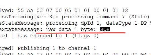

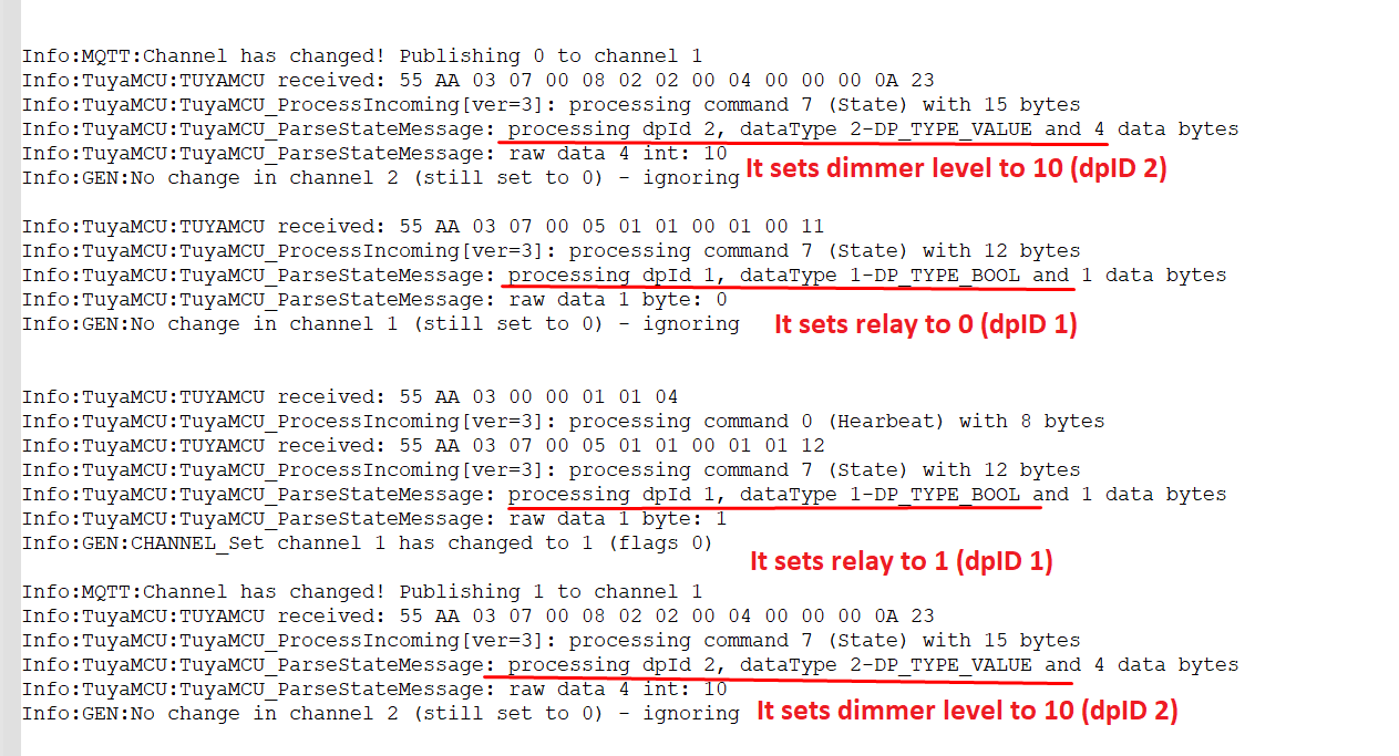

    #35 20817254
    slaroy
    Level 4  
    Posts: 8
    OK, for some reason, after a hard reboot, the config didn't stick. I have it working now.
    Three software web GUI button pushes, state toggle as described. Notice there are 6 MQTT transitions of the format Info:MQTT:Channel has changed! Publishing X to channel 1:

    Info:MQTT:Channel has changed! Publishing 0 to channel 1
    Info:TuyaMCU:TUYAMCU received: 55 AA 03 07 00 08 02 02 00 04 00 00 00 94 AD
    Info:TuyaMCU:TuyaMCU_ProcessIncoming[ver=3]: processing command 7 (State) with 15 bytes
    Info:TuyaMCU:TuyaMCU_ParseStateMessage: processing dpId 2, dataType 2-DP_TYPE_VALUE and 4 data bytes
    Info:TuyaMCU:TuyaMCU_ParseStateMessage: raw data 4 int: 148
    Debug:TuyaMCU:TuyaMCU_ApplyMapping: mapped value 148 (TuyaMCU range) to 13 (OpenBK7321T_App range)
    Info:GEN:No change in channel 2 (still set to 13) - ignoring
    Info:TuyaMCU:TUYAMCU received: 55 AA 03 07 00 05 01 01 00 01 00 11
    Info:TuyaMCU:TuyaMCU_ProcessIncoming[ver=3]: processing command 7 (State) with 12 bytes
    Info:TuyaMCU:TuyaMCU_ParseStateMessage: processing dpId 1, dataType 1-DP_TYPE_BOOL and 1 data bytes
    Info:TuyaMCU:TuyaMCU_ParseStateMessage: raw data 1 byte:
    Info:GEN:No change in channel 1 (still set to 0) - ignoring

    Info:TuyaMCU:TUYAMCU received: 55 AA 03 07 00 05 01 01 00 01 01 12
    Info:GEN:CHANNEL_Set channel 1 has changed to 1 (flags 0)
    Info:MQTT:Channel has changed! Publishing 1 to channel 1
    ExtraDebug:TuyaMCU:TuyaMCU heartbeat_valid = 1, product_information_valid=1, self_processing_mode = 1, wifi_state_valid = 1,

    I will start by saying that this:
    Screenshot showing a communication log entry with the annotation raw data 1 byte: SOH.
    indicates that you have older OBK version, can you check? I fixed the way bools are displayed already.

    Are you really sure that's what happens? Please see my comments on image:
    Screenshot showing TuyaMCU communication logs with visible commands and dpID values.
    It would be way easier if I had a remote access to that device but I still would need to be able to tell the state of the relay... hmmm, can you try to enable the "TuyaMCU queue" in flags?
