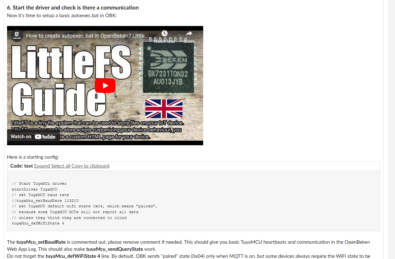

    The following may indicate that your device is TuyaMCU. No problem, TuyaMCU devices are supported, but they need a bit more of configuration.
    Would you be able to give some photos from inside your device so we can determine whether it's really a TuyaMCU?
    TuyaMCU guide is here:
    TuyaMCU flashing, setup and configuration guide - configure dpIDs for Home Assistant
    Can you familiarize yourself with it a bit?
    I would especially focus on paragraph 6:
    Screenshot showing a section of a webpage guide for configuring TuyaMCU. A code configuration card and a YouTube video are visible.
    PS: Still, we are not yet sure that your device is TuyaMCU. You may also have a simple UART-based dimmer, and that could complicate things a bit. They require some more research. However, I have already reverse engineered one: WXDM2 dual dimmer - reverse engineering - strange UART protocol
    PS2: Do you maybe have a 2MB flash backup, just in case, so in worst case, I could try flashing it onto my WB3S and capturing UART data (if that's not the TuyaMCU, but simple UART dimmer like WXDM2)?

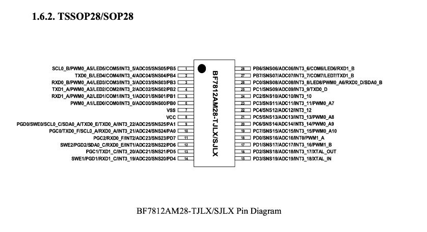

    The MCU is a BYD BF7812AM28-TJLX-P1Q6, I found the datasheet here: Link.
    Pin diagram of BF7812AM28-TJLX-P1Q6 chip.

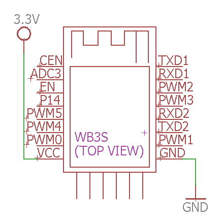

    Then I looked at the pinout of the WB3S:
    Pinout diagram of the WB3S module with pin labels and connections.
    What I found with my multimeter is:
    TXD1 from WB3S is connected to pin 14 from MCU
    RXD1 from WB3S is connected to pin 13 from MCU
    CEN from WB3S is connected to pin 8 from MCU
    EN from WBS3S is also (??) connected to pin 8 from MCU

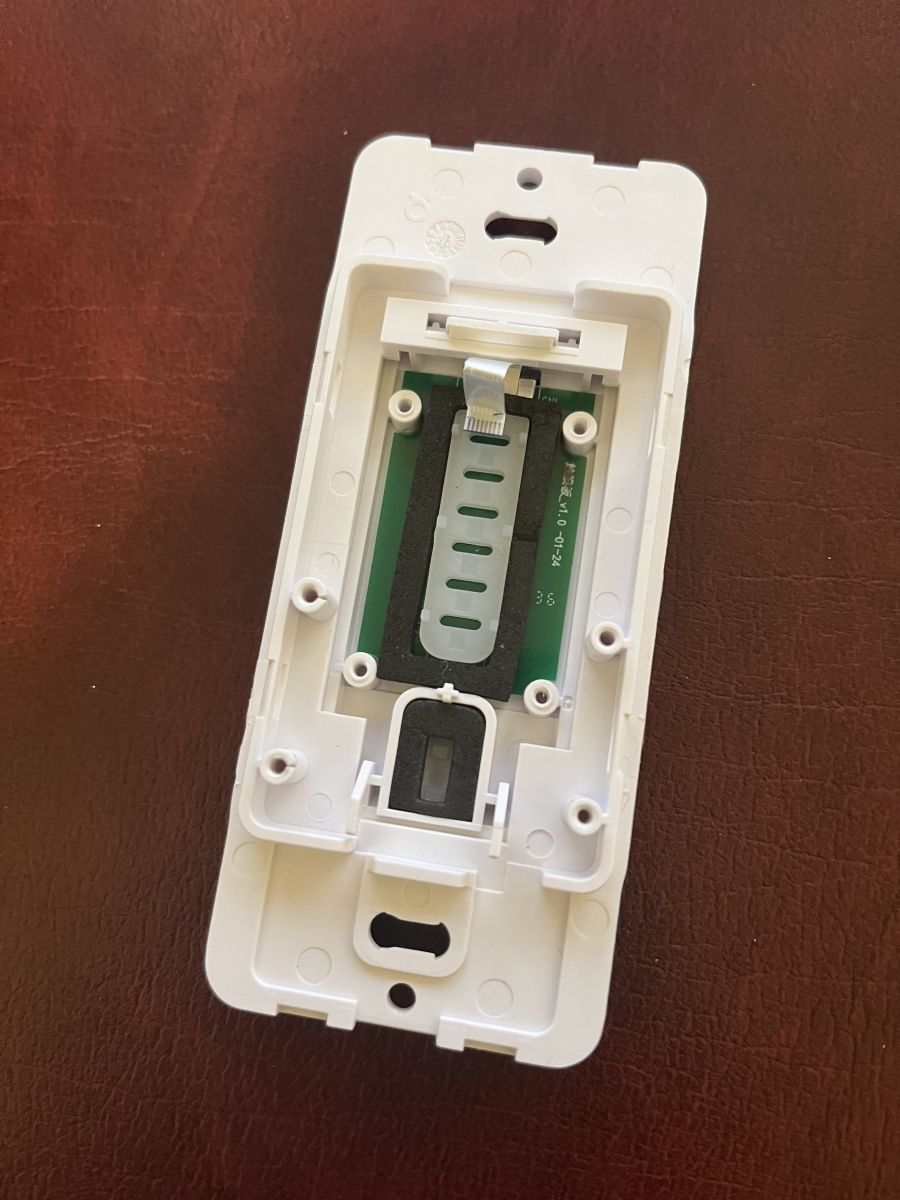

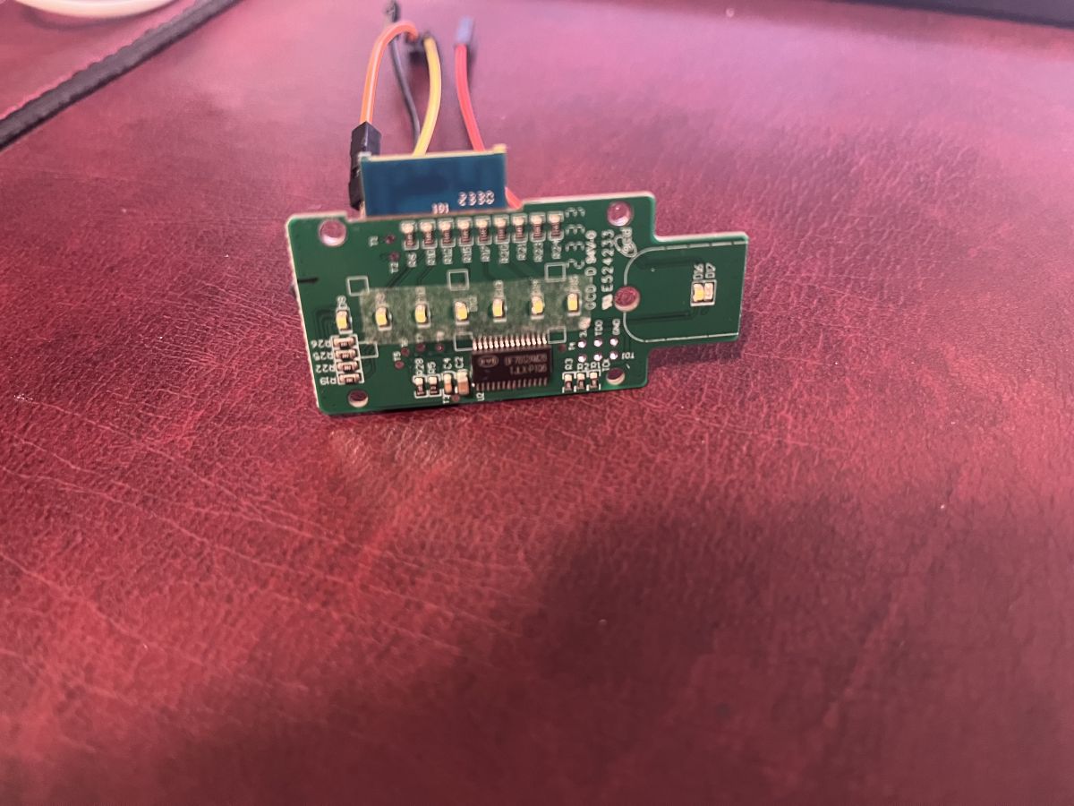

    Also attached the photos from the device.

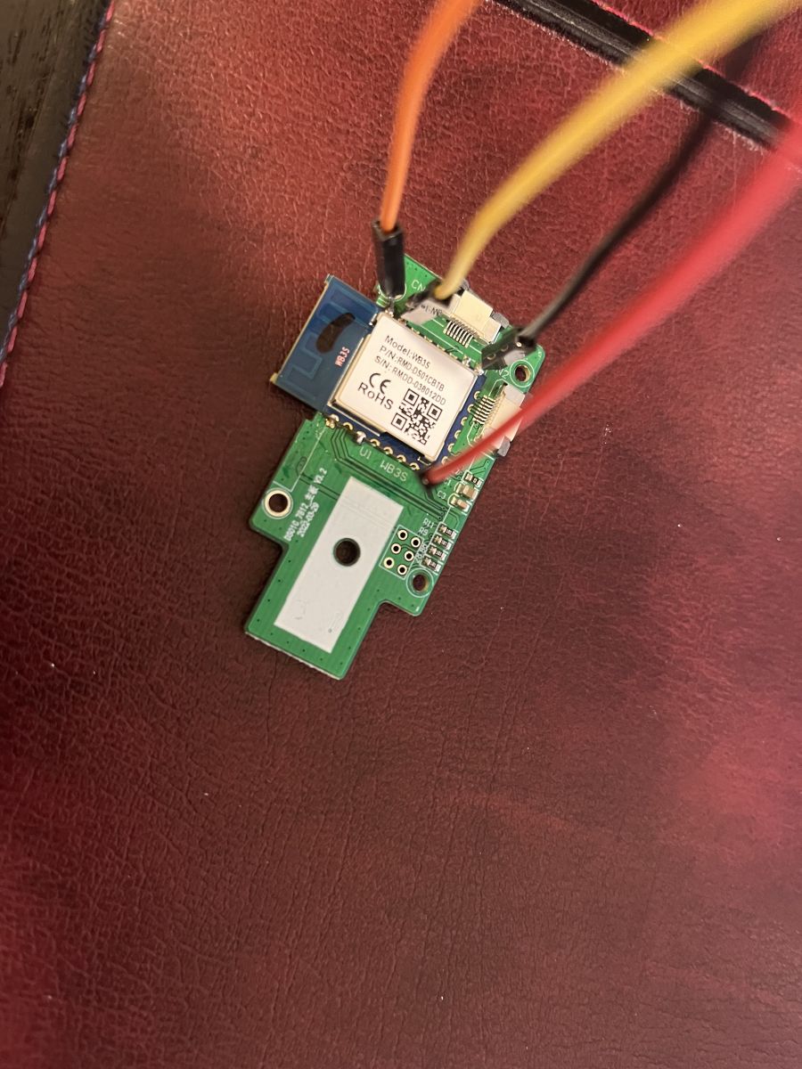

    This is the board with the WB3S
    WB3S module connected with wires to a green PCB.
    Other side
    Close-up of a WB3S circuit board with visible electronic components and connected wires.

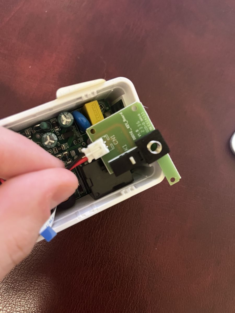

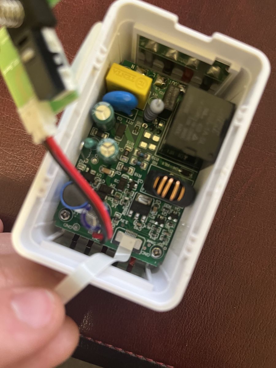

    Inside of the actual switch (relay), connected with ribbon cable to control board with WB3S
    View of the interior of a casing with electronics, including a main board with electronic components and connected cables.
    Detail of the microswitch for the rocker
    Image of the interior of an electronic device with a visible circuit board and a connected cable.
    And the inside of the rocker itself (I did not take this little board out, but it is connected via ribbon cable to WB3S board).
    Device panel with internal circuit board.

    Yes, this is TuyaMCU dimmer. I have a script for such a device here:
    https://www.elektroda.com/rtvforum/topic3898502.html
    The script from topic above should work.
    Please flash OBK and try.
