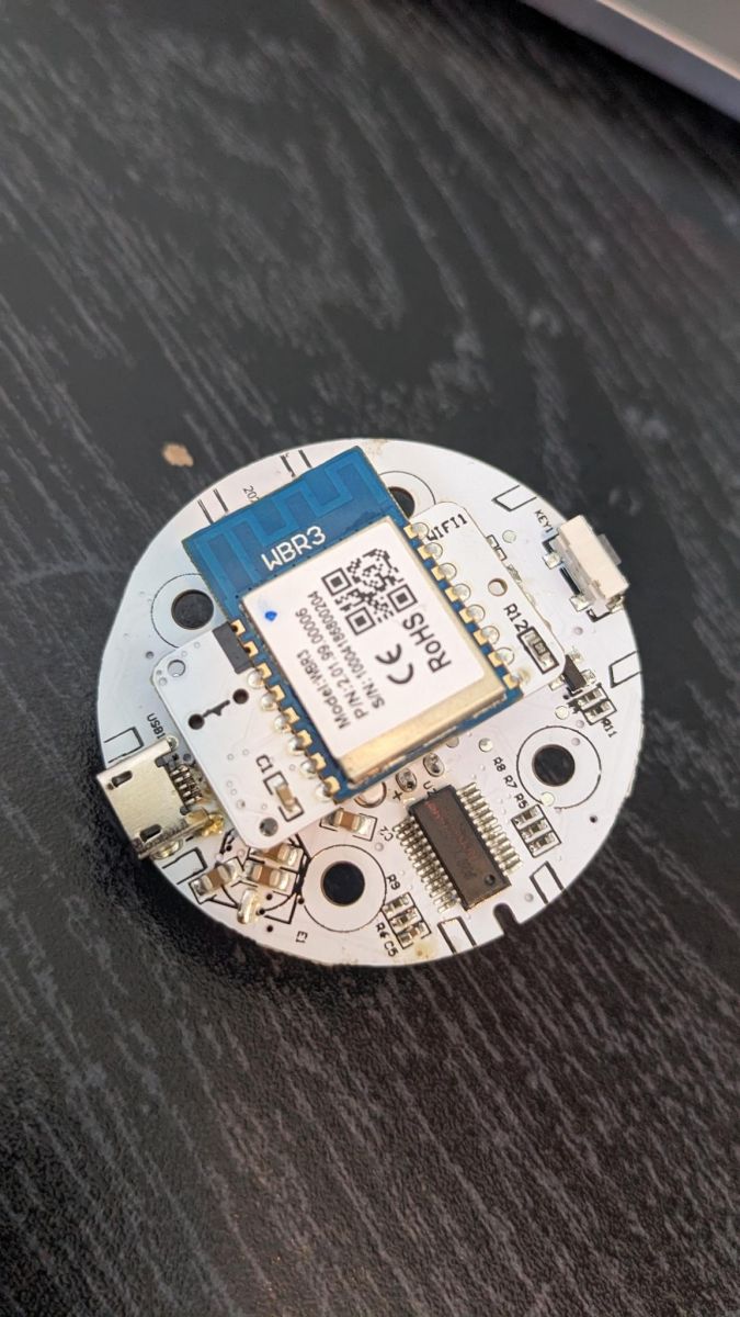

    My apologies in advance if this has been covered before.
    I have a Treatlife DS01-Dimmer wall outlet with a WB3S controller I would like to free from Tuya and use with HA directly over MQTT.
    I have been unable to locate anything here, or generally, that states whether or not I can use OpenBeken with it.
    I have the switch torn down at the moment and have been able to locate all the proper pins / etc.
    It appears this device used to use a Tuya ESP module and was swapped out for the WB3S at some point as Tasmota has a template for it with an ESP8266.
    It has visual similarities with the DS02/DS03 referenced in the Beken device database but is basically a binary on/off and tactile slider type dimmer.
    Any pointers would be greatly appreciated!

    Hello, I think it should work, it will be most likely a TuyaMCU device like many others that we have already supported. We can give it a try. Flash a single piece for a start.
    Please provide more information if you can and we'll try to setup it together.

    I made a ton of progress on this tonight. OpenBeken is flashed. I couldn't get the Windows Flasher to work but a 3rd party python one worked just fine. This could be for a number of reasons (Windows arm VM on a MacBook, flakey uart drivers, etc).
    I found a template for it as well in the cloudcutter repo, applied it, created an autoexec.bat, and just finished putting it all back together.
    It's getting late here so I'll pick back up in the morning by reconnecting it to my mains power and see how things go.
    This is awesome. I had originally thought it was an esp chip and was all prepped to flash tasmota but once I got a good look at the board, I had to quickly scramble -- and found OpenBeken!
    Will report back here if I find myself needing help. I've got one more of these I need to flash and a binary (non-dimmer) version to do as well.
    I'll be sure to follow the guidelines for publishing a legitimate template for them assuming everything works out

    I'm pretty sure I'm going to have to configure the pin roles. While the template I used created two channels, all ports are undefined in GPIO Doctor.
    Looking at the board pwm0, and pwm3 are soldered.

    Wait, the Tuya device can be either TuyaMCU or GPIO-based. I haven't seen any device requiring both TuyaMCU driver and GPIO configuration.
    You can check if your device is TuyaMCU very easily. Just do the GPIO extraction:
    https://www.youtube.com/watch?v=WunlqIMAdgw&ab_channel=Elektrodacom

    Here's what i got back:
    Sorry, no meaningful pins data found. This device may be TuyaMCU or a custom one with no Tuya config data.
    No module information found.
    And the Tuya section starts at UNCOMMON POSITION 0
    I also noticed the following in the log when using the DS02S autoexec.bat
    Info:TuyaMCU:Consumed 255 unwanted non-header byte in Tuya MCU buffer
    Info:TuyaMCU:Skipped data (part) 00 FE 00 FE 00 FE 00 FE 00 FE 00 00 F0 00 FE 00 FE 00 FE 00 FE 00 00 00 00 00 00 00 F0 00 FE 00 00 00 00 00 00 FE 00 00 00 00 00 00 00 00 00 00 00 FE 00 00 00 00 00 00 00 00 00 00 00 00 F0 00 00 00 00 00 00 00 F0 00 00 F0 00 00 00 00 00 00 00 F0 00 00 00
    And my autoexec:

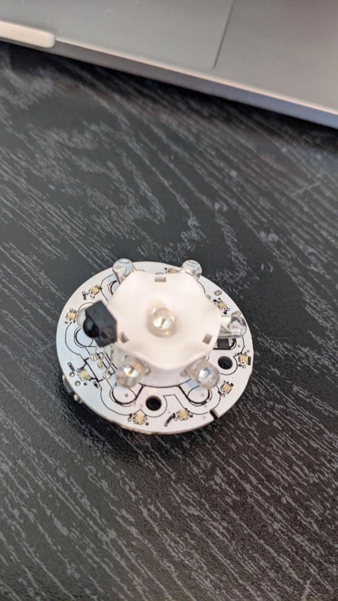

    Moving on to converting other devices of mine, I have come across an IR Blaster with a Realtek WBR3 board in it. I saw reference to OBK being updated to include support for these controllers and would like to know if it is worth giving it a shot.
    IR Blaster circuit with LEDs and Realtek WBR3 component on a dark background. IR Blaster with Realtek WBR3 card on a round circuit board.
