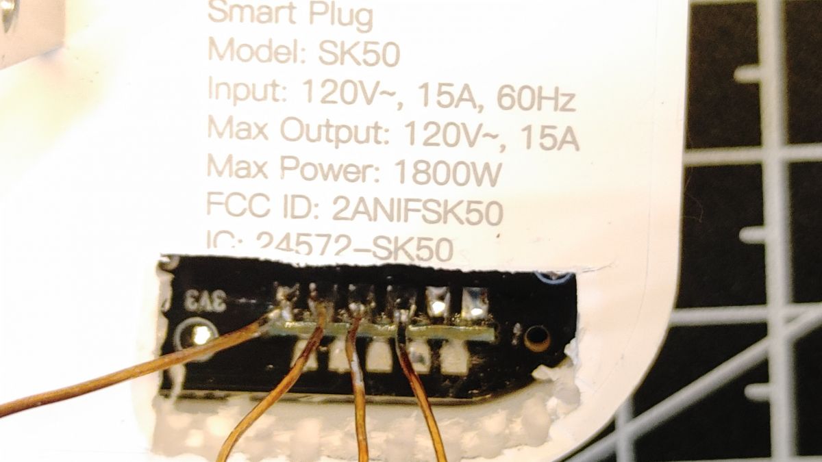

    I'm trying to flash openbeken to multiple TreatLife Smart Plugs (US variant). A lot more detail about this device can be found on the FCC Listing, specifically the internal photos.
    I've flashed twelve already, but the old ones have WB3S modules in them, and these new ones have WB2S.
    TreatLife smart plug module with soldered wires.

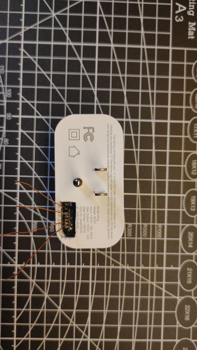

    I've soldered connections directly to the 3V, GND, TX, and RX on the WB2S module and am using a DSD TECH SH-U09C2 to connect between my laptop (Windows 11) and the module. I was always able to flash them with UART using the command:
    python uartprogram C:\Users\UserName\Downloads\Tech\IoT\OpenBeken\OpenBK7231T_QIO_1.17.308.bin --unprotect -d com3 -w --startaddr 0x0
    Nameplate and wire connections inside a smart plug.
    Because the WB3S and WB2S are very similar I tried flashing them the same way, however it would fail with an error stating "Unprotect Failed." I removed the "--unprotect" command. This would successfully flash, however the openbeken WiFi AP never became available, and when reconnecting the serial adapter, the RXD LED would flash rapidly without stopping. I could reflash again by shorting GND to CEN again to gain bus, but always ending in the same result.
    I then tried flashing again using the following command:
     c:\Windows\System32>python uartprogram C:\Users\TheBo\Downloads\Tech\IoT\OpenBeken\OpenBK7231T_QIO_1.17.308.bin -d com3 -w --startaddr 0x0
    This would flash, but return "Read CRC Failed." The openbeken AP was again not available, however on attempting to reflash, shorting GND to CEN does not work to get bus. I came across a thread here that said to leave off the "--startaddr 0x0" command for BK7321T modules, maybe that's my problem? Thus far, nothing has worked on any device flashed with that last command.
    Have I bricked the WB2S modules that I've tried to flash? Are there any recovery options? I've been scouring this forum and the internet for a while, but I'm at a loss.

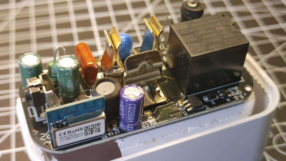

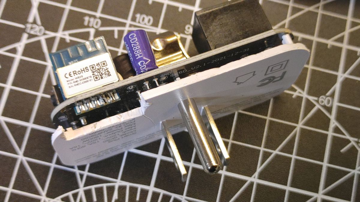

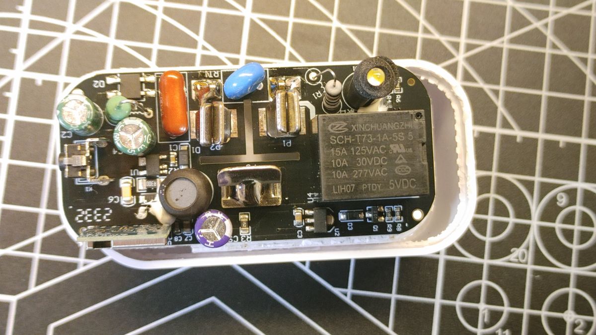

    Image of the WB2S module in a smart plug with visible electronic components.
    Close-up of an open smart plug casing with visible electronic components.
    Circuit board of a smart plug with visible electronic components and a relay.

    It looks like you're flashing incorrectly. BK7231T does not allow flashing at address 0x0. You are trying to flash it as BK7231N. You are risking corruption of your device.
    Unprotecting is for N only.
    Futhermore, the QIO binary is the binary with the bootloader. You should never use it for T platform (unless you are using our flasher, which handles it internally). The legacy way of flashing T platform is to flash UA binary, just after the bootloader.
    Please either use our new flasher that fixes this issue internally:
    Or use bkWriter 1.60 to flash the UA binary after the bootloader.
    You can check our channel for WB3S/WB2S flashing tutorials:
    Old flashing method for T:
    New flashing method for T:

    Bottom line: I bricked these devices by trying to flash the wrong firmware. While they are likely repairable using the recovery SPI mode, it requires disassembling the plastic body of the plug which is plastic welded together, and I do not have the tools at home to restore that. Permanently making the plug body unusable to repair the module would defeat the purpose of attempting any repair as the process would permanently render the device useless.
    I'm probably going to dispose of these, which really is sad because I like the challenge of repairing the unrepairable, and this is a lot of money going to waste. I may break them apart, remove the WB2S to repair and install in future devices. Expensive lesson, but I did learn my lesson.

    If they have WB2S inside then indeed recovery via SPI may be hard. Not all of the required GPIOs are exposed on this chip. I've done only WB3S recovery so far.
    You can still replace WB2S with a matching ESP module.
