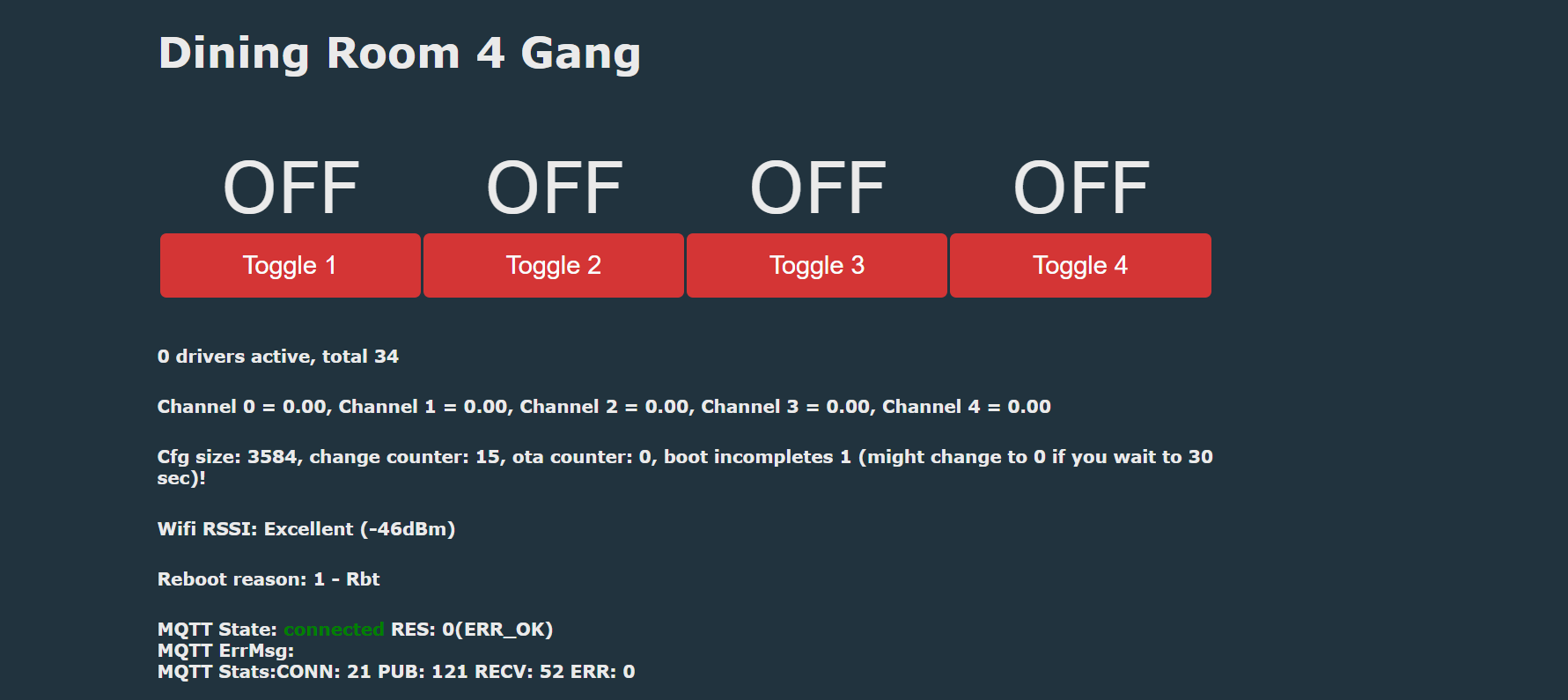

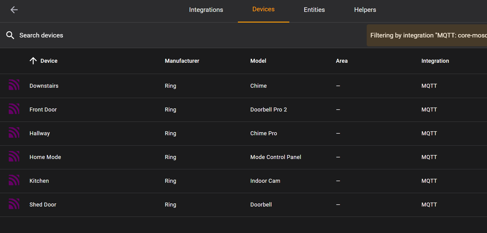

    HI All,
    ruining openbeken firmware on my 4 gang switch
    my home assistant mmqt broker is showing the device
    OpenBeken Firmware 4 Gang Switch: Home Assistant MQTT Broker Device Discovery Issue
    tho the device is not being created
    anyone have any idea how to get the switch showing up in HA.

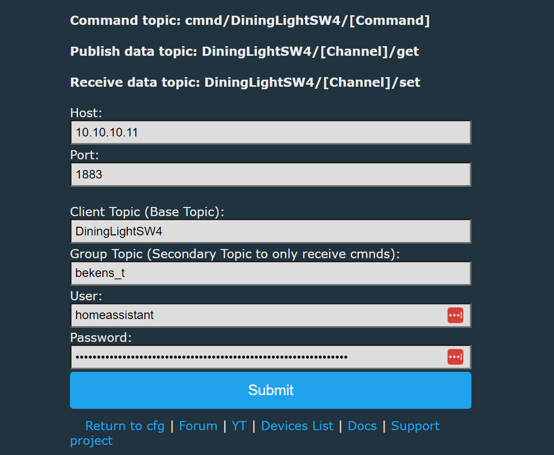

    Oh here are my setting in openbekan, i did the homeassitant discovery
    OpenBeken Firmware 4 Gang Switch: Home Assistant MQTT Broker Device Discovery Issue 1687612116.png]OpenBeken Firmware 4 Gang Switch: Home Assistant MQTT Broker Device Discovery Issue[/url]

    Hello, what is the configuration of your device? What is the GPIO config? The template?
  • Deta Grid 6904HA template for BK7231T WB3S
    #3 20630039
    sebowers
    Hi Team, the device is a
    Deta Grid Connect Smart Quad Gang Touch Light Switch - 6904HA
    using the supplied template

    And it does not show in HA when you do:
    https://www.youtube.com/watch?v=pkcspey25V4
    Which HA version?
  • #5 20630451
    sebowers
    Hi Team,
    Thanks for the reply.
    I fixed the issue by changing the shortname and MQTT names to lowercase. Maybe it's just my installation of HA.
