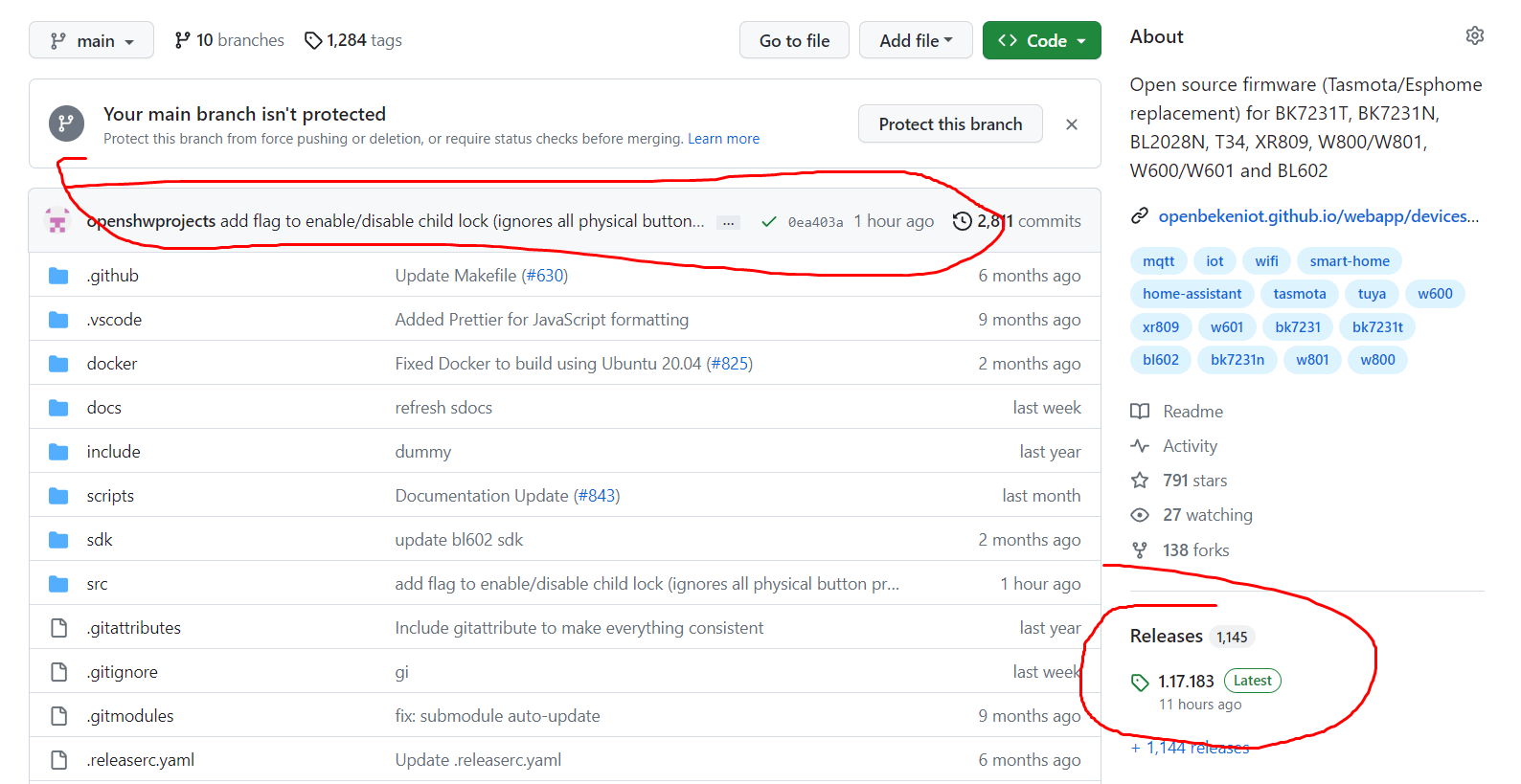

    That's a great idea! I've added a flag for that, it's called "child lock" and it makes device ignore all physical button and toggle presses:
    https://github.com/openshwprojects/OpenBK7231...mmit/0ea403a17f11e40ad5b02dc1522a5025d03a1a0e

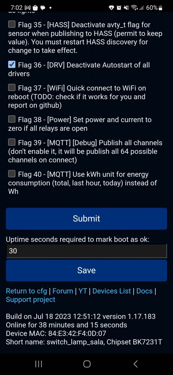

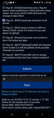

    I'm on the latest firmware but no flag 41
    OpenBeken - deactivating Physical Switch Button from Home Assistant: Ignoring Accidental Light On
  • #6 20659430
    Posts: 14770
    Rate: 12913
    Sorry, it seems that the automatic build was not triggered this time! Let me try again, the new version should build automatically:
