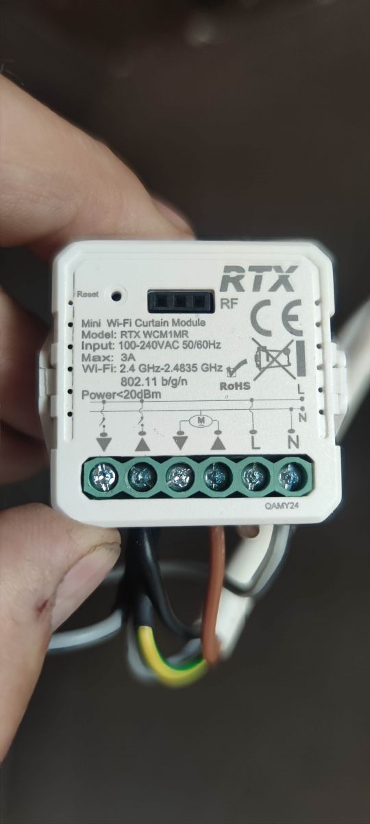

    I want to connect a tuya rtx roller shutter controller to the roller shutters where the starcus er controller is. There are 5 wires coming out of the motor brown, blue, white, black, and of course yellow green. How do I connect this so that I have control in the tuya application. Connection of rtx tuya controller to starcus er system roller shutters Connection of rtx tuya controller to starcus er system roller shutters .

    Blue - neutral
    Brown - phase
    Green-yellow - PE
    White and black - up/down
    `` (white and black under M terminals) .

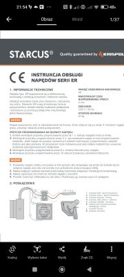

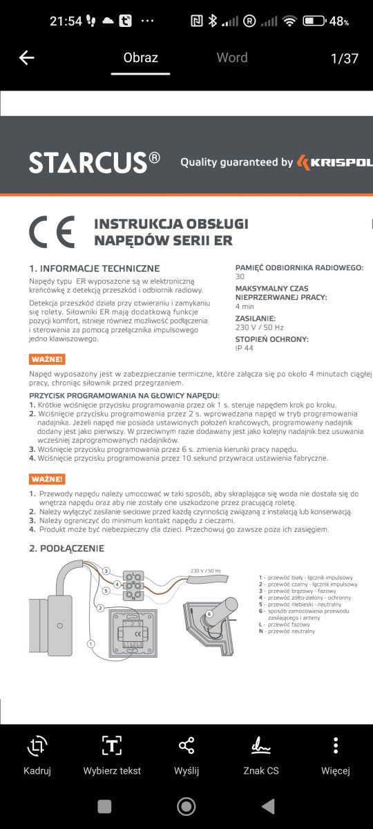

    Thanks mate but I connect black and white as top down and unfortunately it doesn't work. The roller shutters have a radio module in them but I wanted to connect them to a separate system just in place of the switch. Using white and black. The tuya controller gets a signal to open or close however the roller shutter motor does not respond.
    Added after 16 [minutes]:
    Maybe the problem is that in the instructions black and white are described as a pulse switch. That is why the roller shutter motor does not respond to a continuous signal?
    Added after 5 [hours] 13 [minutes]:
    I know a little more
    The control is done by a pulse relay. The two wires black white are used for this. So how do I still wire this to what I want to do????
