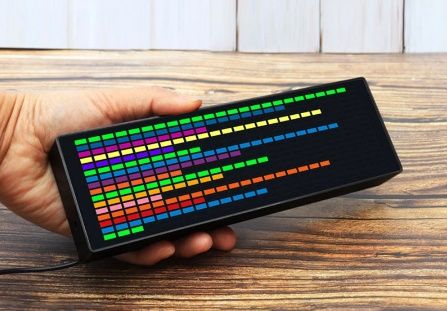

Audio spectrum display (ESP32, WS2812B)
efi222 19056 63
  • A 20-bar, 16-point audio spectrum display uses an ESP32 and a 640-LED WS2812B strip for a larger, classic-style illuminated panel.
  • The display runs FFT code from ESP32_FFT_VU, with ADC sampling moved to a timer interrupt and automatic level control added for varying music levels.
  • An IR remote with an Atmega8/Atmega88 receiver handles power, brightness, effects, and peak toggling, while standby keeps only the receiver active.
  • The build uses 320 light points from two LEDs per pixel and measures 710 x 256 x 28 mm, or 710 x 280 mm with the base.
  • It reaches about 20 FPS on a 16x40 LED matrix and 29 FPS on an 8x8 matrix, but the code needs ESP32 Arduino 1.0.4.

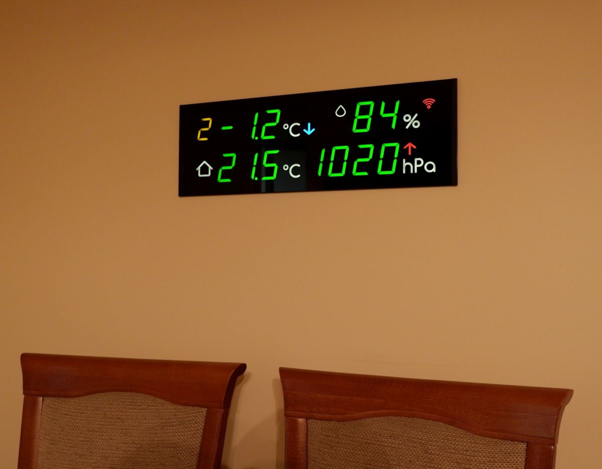

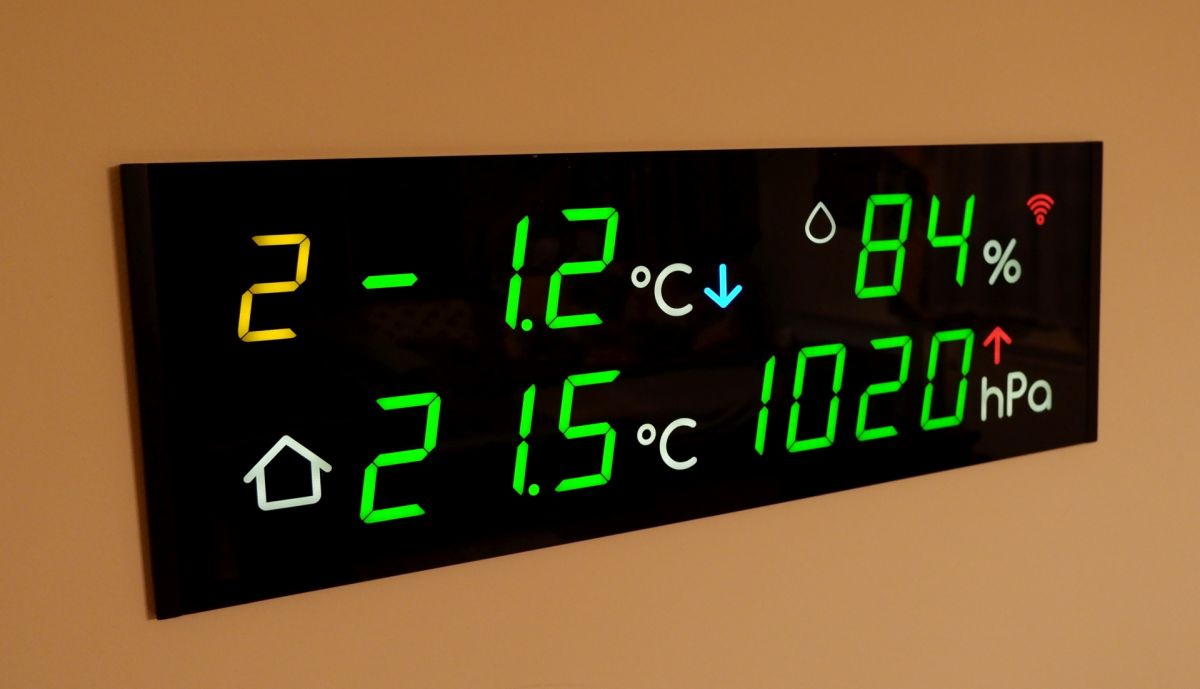

    As for me, the image from a cheap LCD at dusk is simply poor. We all know the disadvantages of such displays.
    But it all depends on the preferences of the recipient. One does not fit, the other is enough. I don't even want to think about an OLED display in this size (price). I have "loved" LEDs since the dawn of my history :)
    Besides, with LED constructions, whether they are segment displays, or like this device, you can actually freely compose the proportions of the entire display. And so it is here too. With LCD screens, we are limited by their factory sizes and proportions.
    Here's another example. I have a weather station built of LED displays (dimensions 56 x 19 cm) hanging on my wall. Everyone, everyone who sees it for the first time admires it and asks where I bought it and how much I gave for it. There's something about these LEDs :) And I think it's worth doing uncommon and somewhat unique things.
    Chair backs for proportions
    Etching machine controller.
    I may have written this before. I am glad that I have lived to such a time that I can build such constructions without looking at rationality. Because where rationality begins, DIY ends ... (of course there are some limits).
    Well, I can't imagine this spectrum on a small TV... But that's my personal preference :)

  • Incorrect GitHub repo and partial LED response
    #39 20466055
    noel200
    Posts: 1892
    Help: 36
    Rate: 815
    I recently saw something like this on the net and bought myself a roll of ws2812b, esp32 devkit v1 and a microphone for max4466. A few days ago I found half an hour to connect it and try to fire it, but it doesn't work unfortunately. The belt is functional, esp probably too. The LED flashes and the program is uploaded. The microphone also, the output is a sine wave consistent with the frequency from the generator.
    I used the program you provided at the beginning.
    By the way, you gave the wrong address there. The correct one is: https://github.com/s-marley/ESP32_FFT_VU
    A few LEDs at the beginning of the strip are turned on and later sometimes a few more are turned on somewhere further. What can I check? In the program at the beginning I changed only the number of bands and LEDs in the bars.
    I would try to upload your program, but I wanted to apply the stripes vertically, not horizontally. Combine them more classically.

    BVBek wrote:
    >>20461107
    Is the mask really necessary? Assuming that the walls adhere to the fast and the diffuser will probably stick to the fast itself anyway?
    I'm sure you did the tests "without the mask" and how did it look like?
    If I was looking for such a diffuser, let's say 1 meter square, where would you recommend me to look?
    The grille is 0.4mm thick and fulfills two tasks. The pixel is clearer. It also has slightly rounded corners. The walls are black which improves the pixel contrast. Then look at my scribbles #22. It is bent around towards the walls. The baffles and the focusing screen do not move sideways, because this fold holds everything together. The partitions are printed with two posts and it is 10 sets. I did not glue them together, because I expected a weak pressure of such a large grid. Each grille with two posts is pressed individually.
    As for the screen, I have not found anything larger than A4. I bought a white binder with a rigid binding as a test and it fit perfectly. It diffused nicely and did not suppress the light too much. That's why the screen is in parts. I can send you a piece and you can follow the trail of Polish stationery stores in search of something similar :)
    I don't have a picture of my spectrum without the mask, but it looks something like this:
    https://www.youtube.com/watch?v=Mgh2WblO5_c
    noel200 wrote:
    A few LEDs at the beginning of the strip turn on and then sometimes a few more turn on somewhere further ...

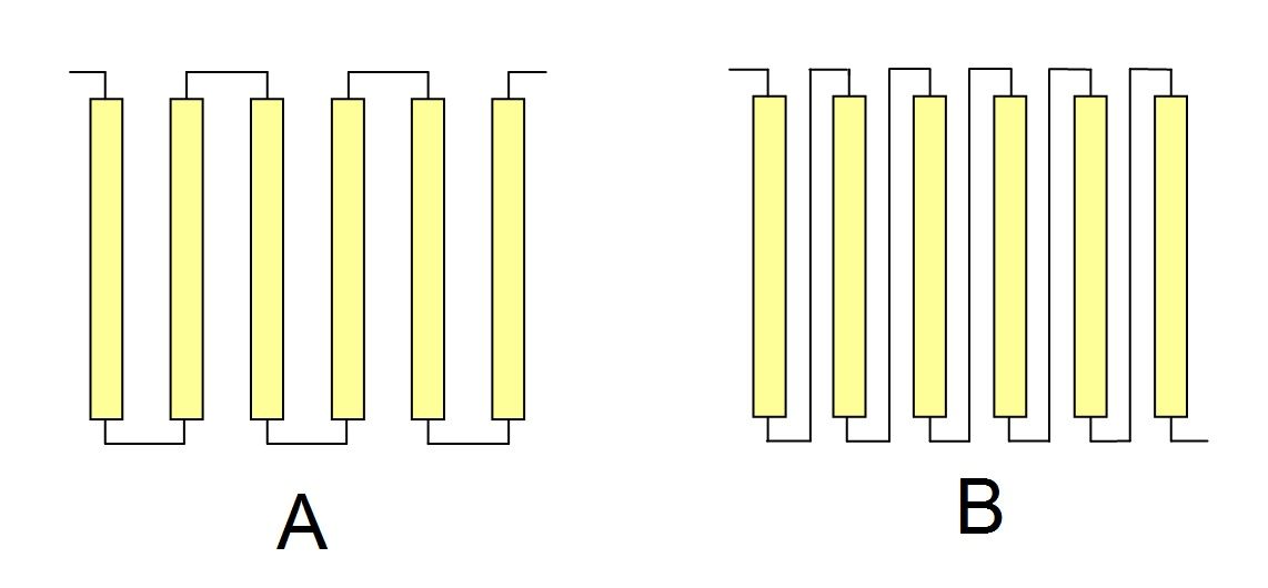

    I'm assuming you didn't make a matrix out of these strips, you're just looking at a loosely unwound strip. Then it looks like this. Make a matrix out of these strips, connect as in the diagram and everything will be ok.
    Besides, it is not enough to change the height and width parameters of the matrix in the config. You need to reassign the range of FFT fringes to each bar even further in the code. On the author's website (thanks for correcting the address) there is an xml file for calculating these values logarithmically for a different number of bars and audio band.
    This is the part of the code: the code for 20 bars.
     if (i  2   && i  3   && i  5   && i  8   && i  10  && i  12  && i  16  && i  20  && i  25  && i  30  && i  36  && i  45  && i  55  && i  66  && i  82  && i  106 && i  137 && i  176 && i  227) bandValues[19]  += (int)vReal[i];
    Classic, or how? Say how you want to connect these bars, from which diodes the next bar should start and end.
    I don't know how it is supposed to look like for you, but I warn you that with such a connection (vertical bar). the minimum pixel height is 16mm (with a strip of 300 LEDs/5m).

  • Vertical strip layout needs FFT remapping
    #41 20466497
    noel200
    Posts: 1892
    Help: 36
    Rate: 815
    Correct. I just plugged it in to see if it would work. Of course, it doesn't look like a display, but the LEDs in the episodes should be blinking, and there was no reaction.
    And I haven't read that. Today I changed back to 16 bars and there is already a response to the sound, so you are probably right.
    I wanted to cut the 5m tape into 20 equal sections of 15 LEDs and set the strips vertically. One whole bar is responsible for one frequency. The higher the intensity at this frequency, the more LEDs on the strip light up. Because you probably have stripes horizontally and each stripe contributes to each stripe? Yes, the distance between the LEDs on the strip is over 16 mm, and I wanted to place the strips every few dozen mm from each other.

  • Vertical WS2812B strips require code changes

    You can set these strips vertically, only if you want to control them from one port, then you have to decide on the following connections:
    AND Whether b ?
    Generally, it doesn't matter how the stripes are arranged. Vertically or horizontally. Each LED can be individually addressed. And it doesn't matter where she is on the bar. It is the program that decides from which LEDs to create a bar in the case of a spectrum. You can even slant ...
    The horizontal arrangement of the stripes "zig_zag" is quite often used in factory LED matrices with the WS2812 driver, hence probably many encoders write for this control system.
    Added after 2 [hours] 3 [minutes]:
    If you still insist on vertical stripes, this requires a code change.
  • ESP32 can drive WS2812B without ATmega8 or CD4050
    #44 20467111
    noel200
    Posts: 1892
    Help: 36
    Rate: 815
    Yes, I know that you can only have limited time to modify the program. But from what you write, it seems that the horizontal arrangement is more popular.
    And the connection A or B itself can be changed in the program under the SERPENTINE variable if I understand correctly.
    I'm looking at your schematic now. Will uploaded to esp32 work without this part with atmega8? You don't need to connect anything to EN, I will give audio from the MAX4466 microphone board to input 36, the output to WS2812b works without CD4050. I will connect the button, but RX and TX? There must be info there for the analyzer to start?

    Atmega is not required for this to work. Everything should work without it.
    SERPENTINE is not used anywhere in the code.
    Yesterday I did a test on a small 8x8 matrix. Just swap x and y patterns. Fuction (matrix->drawPixel(x, y, .....)
    Then the bars are along the bar. Connection A

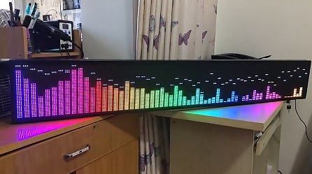

    efi222
    Level 22  
    Posts: 779
    Help: 12
    Rate: 1219
    He, He, Nooo... They're fast :D
    This is the pocket version..
    But they are also more extensive. It's just that those "bare" LEDs again...
