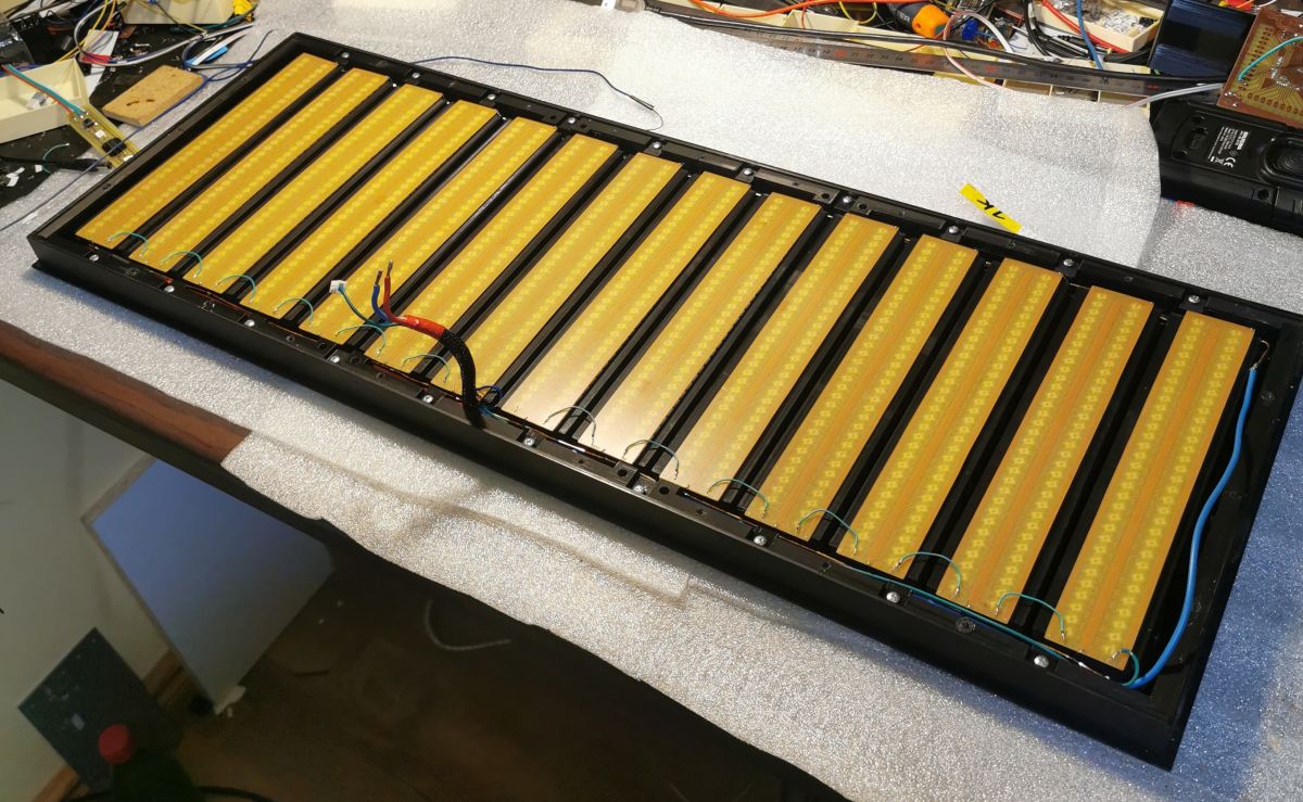

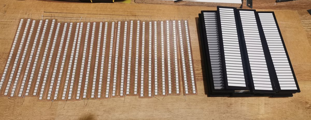

    At the beginning of the article @KJ mentioned that there is a lack of fluidity in the movement of the posts. Rightly so, by the way. I took the plunge and decided to rework the whole unit.
    First of all, I doubled the vertical resolution of the bar from 16 to 32 LEDs in two columns, which increased the number from 32 to 64 LEDs per bar. As a result, the total number of LEDs has increased from 640 to 896 (40%). The typical LED strips were no longer suitable. I had to make a PCB for the LEDs. And, of course, new fenders and hoods.
    Comparison of new and old versions of LED panels with PCB. .
    Upgraded LED panel with 64 LEDs per bar, showing 14 bars in two columns.
    The original version only pulled 20 FPS. After adding the LED, it was already a disaster and not FPS.
    We had to get on with writing new software for the ESP32.
    The result was an acceleration to 37 FPS. Practically the frames were limited by the amount of WS2812B. For such a quantity, faster is not possible.
    FPS = 1000/quantity_WS * 0.03.
    For 896 LEDs, FPS = 37.
    It could stay, because the smoothness has improved considerably. But.... I decided to go further :D .
    The final panel is controlled from two ESP32s. ( At the cost of the whole panel, 12PLN makes no difference). Each operates half of the panel. Both cores and a timer are harnessed in each.
    The number of frames now is 72. I have also introduced audio sample averaging and a small delay in the descent of the bars. Scaling, as suggested by commenters, is now logarithmic.
