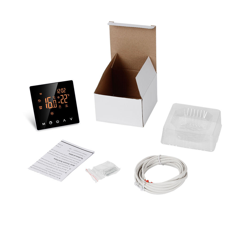

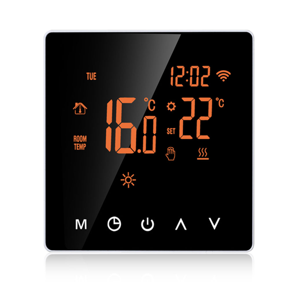

    Hello, I have a problem with smart wifi thermostats Model: ME81H, 16A. I have installed 8 of these thermostats a year and a half ago, everything worked until now without any problems, until suddenly they started to fail one by one, they get power but apart from displaying the lower signs for the settings, nothing else lights up. I have a question; does anyone have such thermostats and a similar problem and what could be the reason and how can it be corrected.
    I enclose photos of the thermostats,
