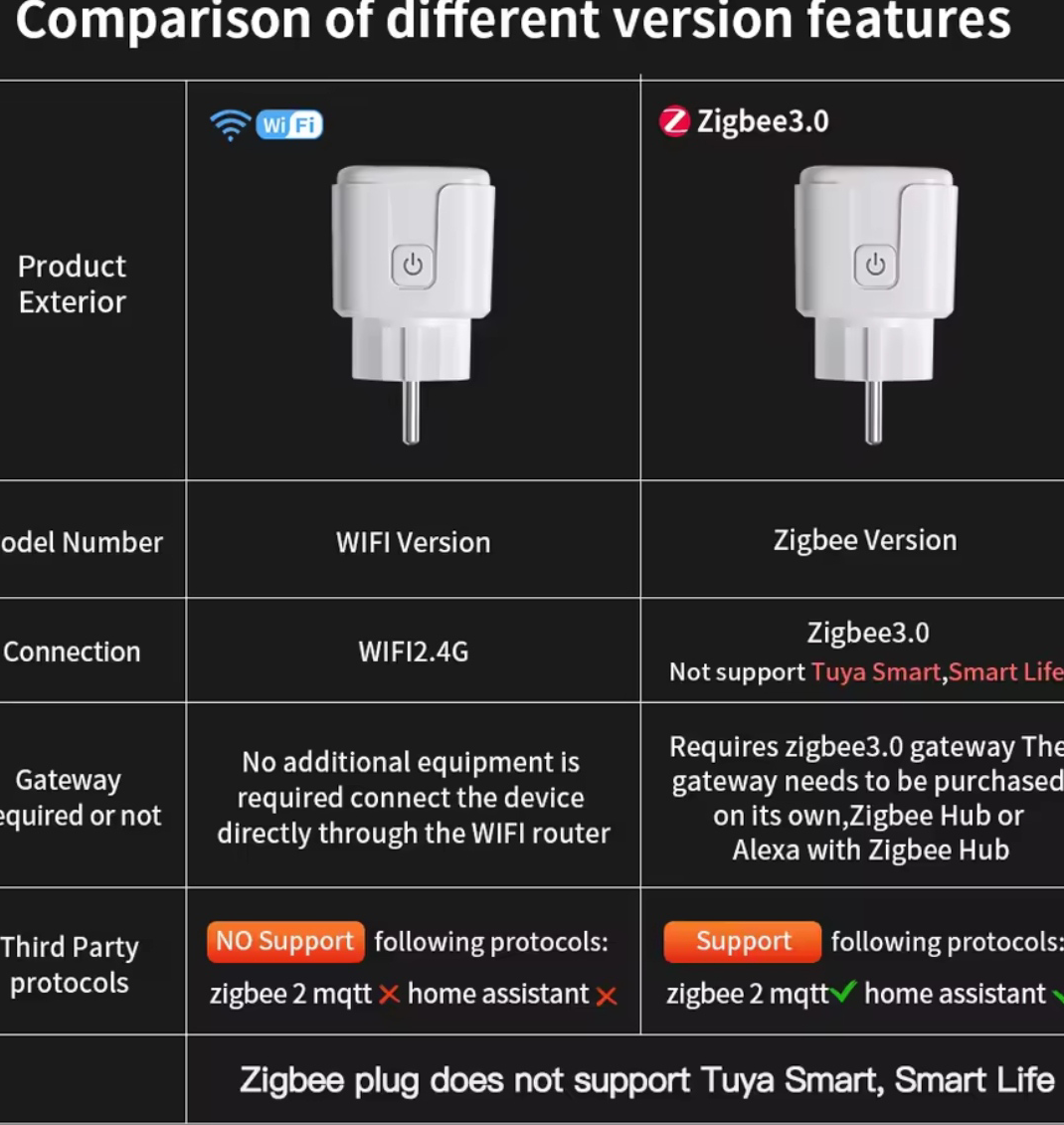

  • #9 21643825
    krzysgda25TU
    I think they have stopped supporting it. Today I found this info on AliExpress
    Comparison table showing WiFi and Zigbee plug versions with protocol support info
    Added after 1 [minute]:
    gruniu wrote:
    I have this problem, but with ZigBee.
    Interestingly, the gas sensor, I added without any problem.
    It's identical to me - with the thermometer it works, the plugs no longer.
